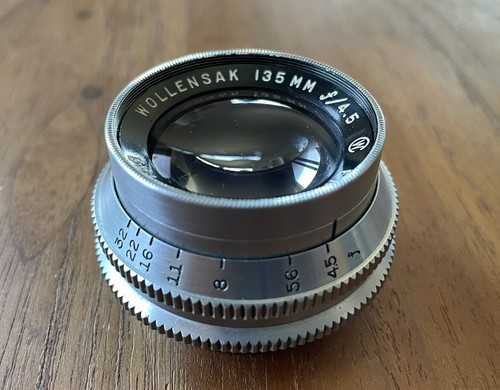

is this a good one:
most of these enlarger lenses are quite cheap.

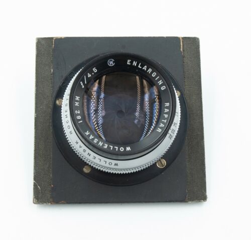

I have both, the this version of the 135, it will not cover 4X5, the 162 was made in either a 4 or 6 element vision I have the 6 element pro version which is a fine lens, saying that the four element version will work well for enlargement up to 11X14 inches, the pro version was designed for up to 20X24 and may not be as sharp as the 4 element in the 5X7 to 11X14 range. In addition to the Wollensake 135 I have a Rodenstock that will cover 4X5. Here is a link to list of enlarging lens that you might find useful.

Although the lens is not for 4x5 and still needs a 4x5 carrier.

Enlarging lens are designed for optimal performance at different magnification, for armatures or home use, most folks were enlarging 5X7 to 11X14. When I taught photography at a community college I had the class do a project by printing from the same negative with 3, 4, 6, element lens and one term a student had an APO lens. These prints were judged in blind showing for sharpness by other students and staff. Every term, the 3 element lens were out performed, the 4 elements were as good or better than the 6 elements lens up to 11X14, past 11X14 the 6 element lens and the APO were much better. As we did not print color the APO lens was not really evaluated for it full potential. I have 4 and 6 elements lens, the one advantage of my 6 element 50mm is that it a stop faster at 2.8 than my Wollensake 50 and is easier to focus, at this point my largest prints are 11X14 so a good 4 element lens works just as well.
No from 35mm. But saying that, Wallensake made both a 4 element and 6 element 162. I don't have the downloads at my fingertips, both Rodenstock and
Schneider had tables that listed which lens were optimized for which magnification. Nikon on the other hand made very few 4 element lens, most were 6 elements along with the 8 element APO lens.
