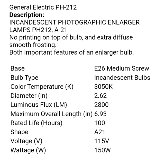

A GE enlarger bulb has these specs, namely 3050K color temperature:

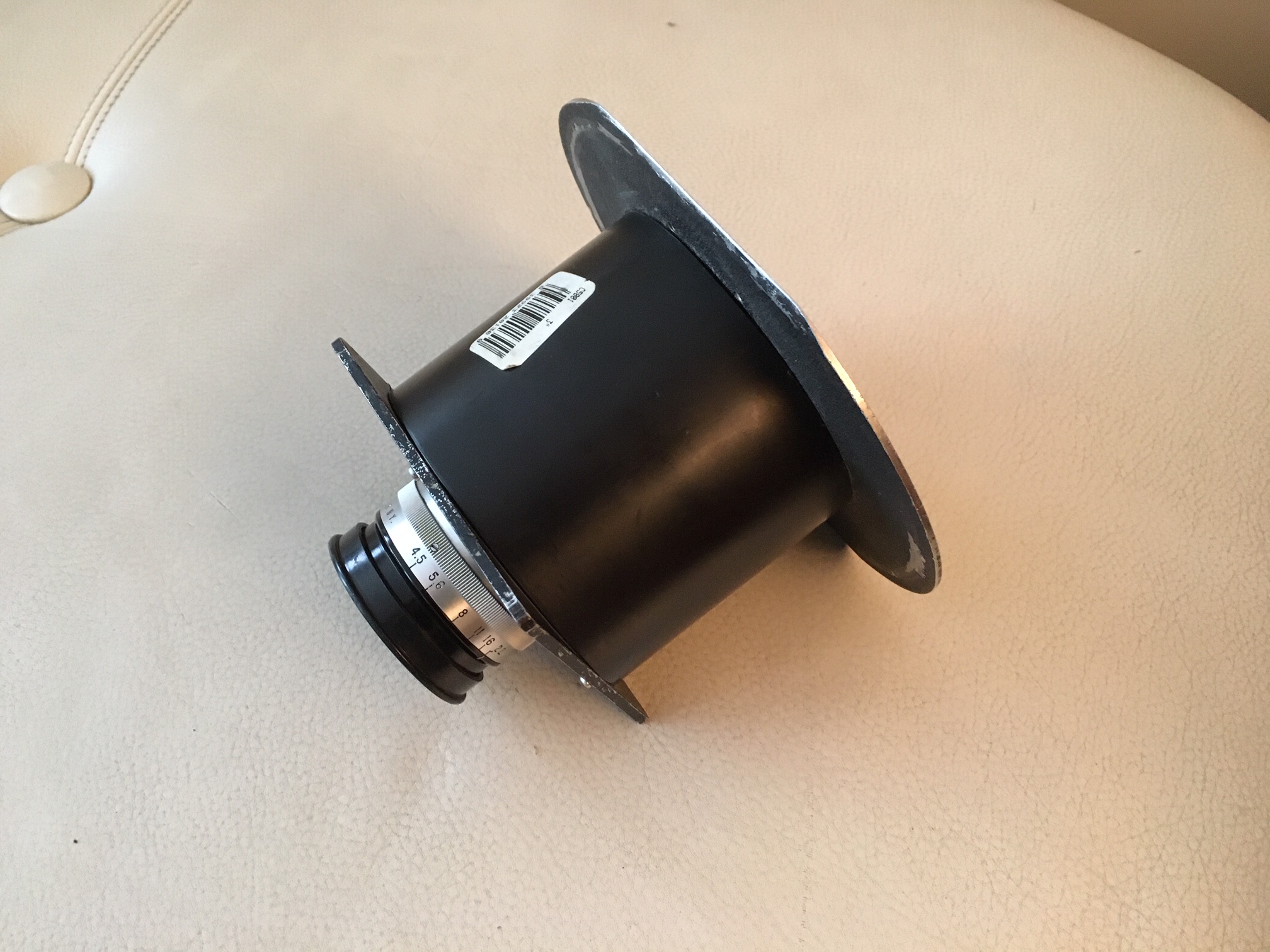

Here is my “sewer pipe” mod For my old d2. I drilled four small holes on the lens board and used #2 wood screws to hold to the pipe. Same for the ring that goes to the enlarger. The sewer pipe is the coupling that joins two pipe together.
