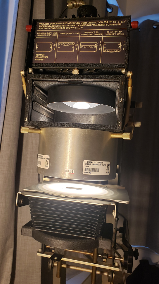

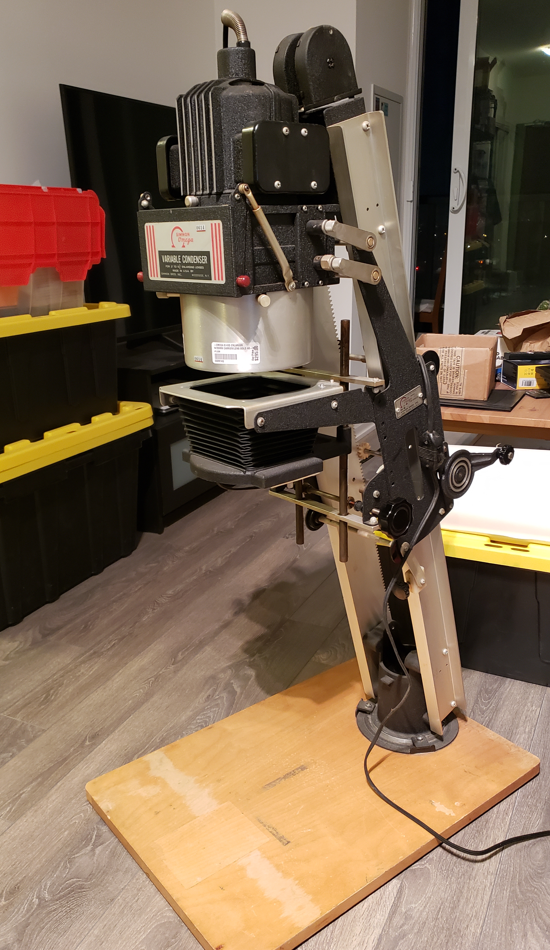

speaking of enlargers, I just got an Omega D2 today, which can take 4x5 negs for $300 CAD. I thought this was a great deal, so I took it without thinking. Here at Downtown Camera in Toronto. The condenser is a lot more beefy than my Besseler 23.
Although the lens is not for 4x5 and still needs a 4x5 carrier.
I think it's a D2

seems to be providing a better light distribution than by Besseler 23 for a 6x45 neg. Not sure why it was sold "as is"

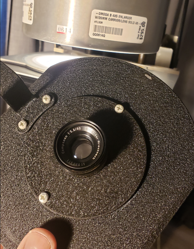

What kind of an enlarger lens would I need for 4x5? It came with a tiny lens, I think for 35mm.

50mm is normal for 35mm. 80 is normal for 6x6. 135-150 is normal for 4x5. You need a cone to move the enlarging lens for 4x5 farther away from the film. Looks like:
(that one is over 4 inches - there are shorter ones that will be fine for the 135mm lens)

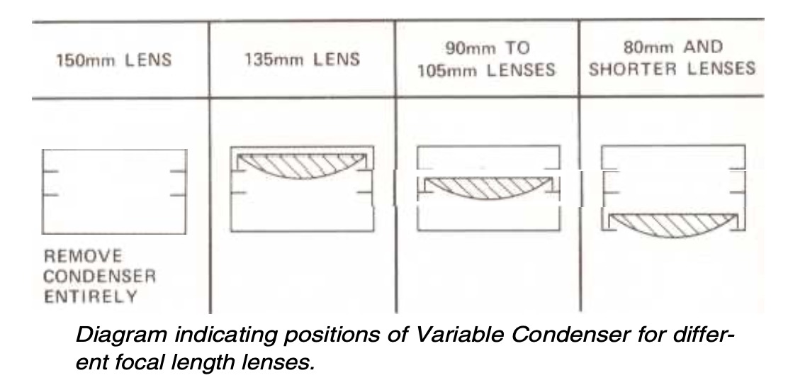

There were 2 condenser heads for the D2, the standard condenser head needed swap out the condenser, the variable condenser head had an adjustable condenser, The door swing up and the top condenser can be moved for 50 to 80mm, middle position for 100 to 135 lens and removed for 150 and longer. Your top photo shows a D2 with the variable head the bottom is a ad for the model with the standard head. The flat lens board is for 50mm to 80mm, then a somewhat longer for 90 to 105 and a longer for 135, even longer 150 and longer. KHB has extensive parts for the D2. Here is a link to the manual.
Then I wonder if @kfed1984 has the top condenser? Anyway, Paul, that's good info for me, since I didn't know that condenser should be in for a 135mm (I almost always have a 150mm on it).

The OP photo shows the variable condenser head. If it is like the variable condenser for the D5, no condenser is needed for 4x5. A 150mm lens is, though, and of course a 4x5 (preferrably glass) carrier.

I just dug out my variable condenser and put it in the slot for 135 (since I have a 135mm lens on the enlarger right now) and I can't see anything that it's doing. I assume it should impact the brightness in the corners - that that is where it would be apparent - but I can't see any difference whether it's in or not.

My Besseler 23 enlarger has an M39 leica lens thread, not sure if there's an adapter for the Omega system. Omega seems to have a different lens board philosophy from Besseler.
This is the lens/board it came with. Just noticed it says Omega B on the price tag, maybe that's why it was mispriced, as this is Omega D.

I have a 135mm that will cover 4X5, but prefer either a 150 or my Wollensake 162, 150s are the most common. The D series can use a number of different boards with different size plates, it is the smaller plate that is attached to the lens board. I have different plates for many different size lens. 39mm is common.

The D2 and the B8 use some of the same lens disks, so that should be fine.
And as you probably understand, the lenses mount to the disks - which vary depending on the thread requirements of various lenses - and the disks mount to the cones or flat plates or recessed mounts - which are customized to the focal lengths of the lenses.
39mm threads are common, but not universal, amongst enlarging lenses.

The light distribution is very even, probably due to more complex diffuser design. My Besseler 23 has a weird little dark spot in the middle, maybe because of the smaller bulb. Also the light is not uniform on besseler, even when playing around with the bellows.
So this will be a perfect light source for contact prints.
