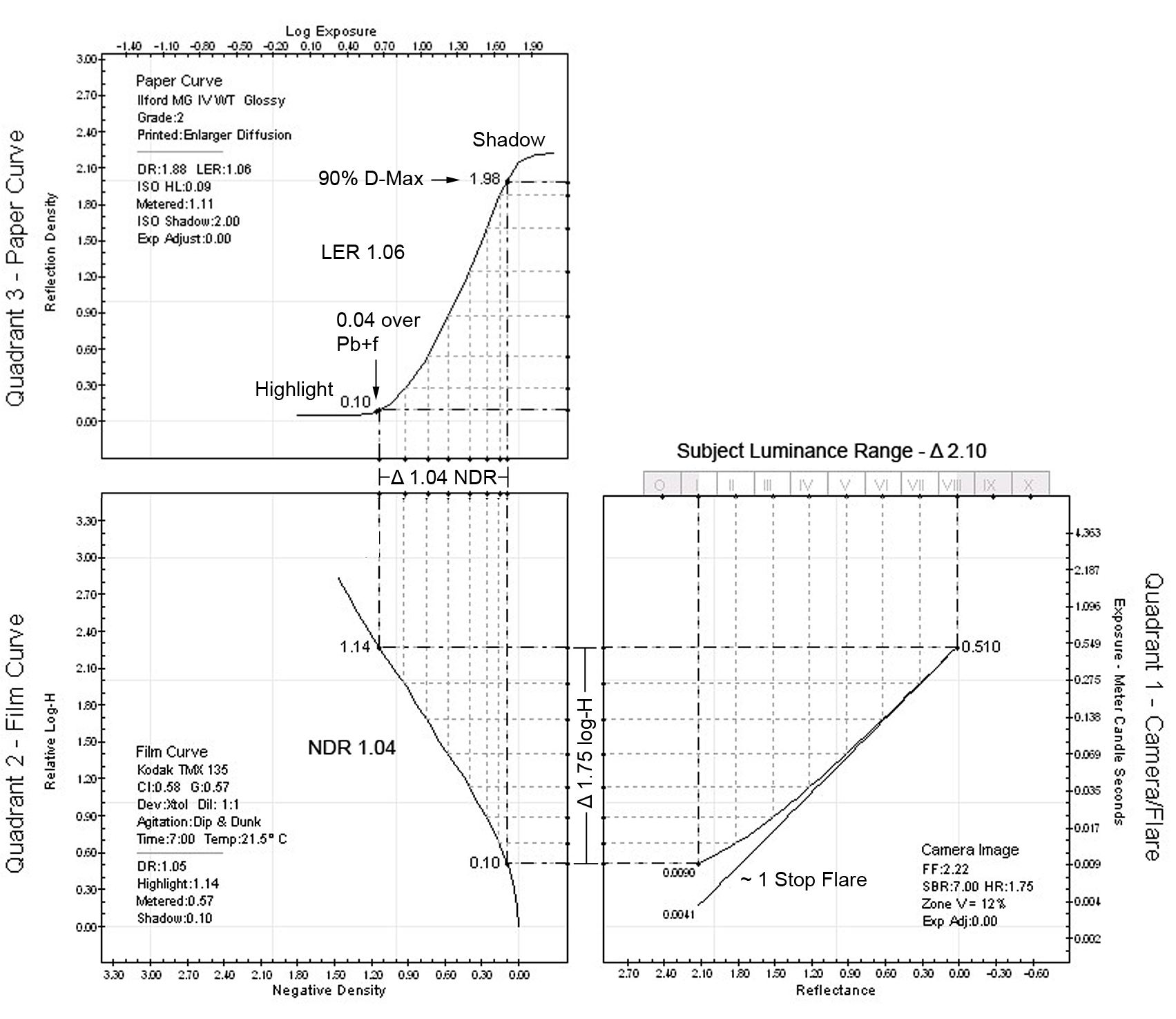

The answer is that testing is done in a no flare environment. This includes Zone System based on how it shoots a single toned target that fall half way up the curve. As normal flare reduces the apparent subject luminance range by one stop, the film doesn't see a seven stop range, but a 6 stop range. To properly interpret the test results, the range to measure needs to be six stops and not seven.
In the two examples below, the top two quad represent a no flare scenario. With a full range subject, it would be impossible to achieve, but it represents the results obtained when contacting a step tablet. The bottom test uses the exact same film and processing, but the camera image has one stop of flare which effectively reduces the negative density range and is representative of actual shooting conditions. In effect, those who do Zone System testing get the values from the top from the testing, but actually obtain the values from the second example when shooting. The subject, negative, and the processing of the negative are identical in both examples. The only difference is factoring in flare.
The next example is how most people tend to measure exposure range on a curve. The two systems use slightly different Luminance ranges, tone reproduction uses 2.20 and Zone uses 2.10. Two different ways to illustrate the differences between interpreting the results with and without factoring in flare.
And a three quad example with no flare conditions. I've included the guideline numbers. The negative doesn't fit on a grade two paper. It's too contrasty. The tone reproduction diagram is an effective way to illustrate the relationships between the different aspects of the photographic process.
The same conditions but factoring in flare. The negative and print match.

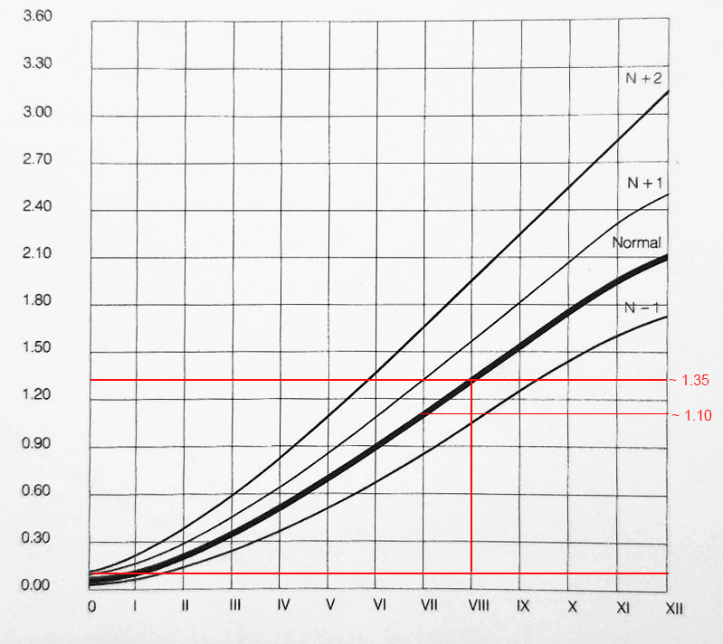

In Adams’ The Print, Introduction, “I have found that many students read descriptions of a procedure in a rather strict way, and are then consumed with the effort to produce exact relationships between subject luminance values, negative densities, and print values.” Could this be partially due to the Dunning-Kruger effect with Adams being the primary or only source for many, and many of the other sources just being a rehashing of Adams? Lacking a broader understanding, Adams is regarded as the defacto authoritarian source. Then there are the apologists who rationalize any claims not supported in tone reproduction theory. They generally claim that Adams really understood the process and simplified it for the average photographer or in some cases the apologist will interpret and twist a concept in order to shoehorn it into accepted tone reproduction theory. This also occurs due to vagaries in Adams’ writings.
My contention is that Adams failed in his explanation of a couple of fundamental concepts which resulted in confusion for many photographers’ decades after this death. Confusion that really shouldn’t exist as the information is readily available. One concept is, of course, personalized film speed, which I’ve talked about. The other is matching the scene log subject luminance range to the negative density range and matching the negative density range to the paper log exposure range.
In The Negative, Adams has the aim densities for a diffusion enlarger as:
Value I: 0.09 – 0.11
Value V: 0.65 – 0.75
Value VIII: 1.25 – 1.35
NDR 1.15 - 1.25
Based on the stated parameters the range of average gradient for a normal negative would be 0.55 to 0.59 which is considered the average gradient range for a normal negative. The disconnect from tone reproduction theory is the aim density range given by Adams is larger than that used by tone reproduction. Since the average gradient range utilized by the two systems is identical, it follows that it would produce the same negative density range under the same shooting conditions. Why the difference? In a word, flare.
Was Adams aware of this? No. He believed flare was part of the testing process and the testing reflected actual shooting conditions. In The Negative, Appendix 2, Film Test Data, there are a number of film curves which confirms the aim density range values are based on no flare conditions.

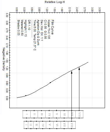

This example shows two functions of a characteristic curve. One is to display the data. This is a graphic representation of how a film responds to sensitometric exposure and development. The other is interpreting how the film curve responds to photographic exposure. This is done by superimposing camera exposure information over the graphed curve. Input is along the x-axis. As we know, the camera image doesn’t have a one to one relationship to the original scene. The camera’s optical system introduces flare which compresses the shadows. This would be reflected in smaller intervals in the shadow portion of the input camera exposure. The example from The Negative has equally spaced intervals which suggests flare wasn’t factored in. If it was, the camera exposure for a normal seven stop range would only amount to six stops of the sensitometric exposure on the film curve. One stop of the subject luminance range is lost to flare.
As the example isn’t incorporating flare into the interpretation, it’s conclusion of the negative density range resulting from a scene with a seven stop luminance range is incorrect. It’s too large. This is a common mistake. To correctly interpret a seven stop luminance range on a sensitometrically exposed film curve, you are effectively working with six stops, or Δ1.80 log-H, or 0.30 to the left of where Adam’s is indicating Zone VIII’s placement. Once you’re aware of this, it becomes apparent and like the frequency illusion, you will begin to see it everywhere. In the paper ISOR. In Kodak’s CI listing with their film development charts. And in cool diagrams in film catalogs, like the following from Kodak’s Publication G-1, Quality Enlarging with Kodak B&W Papers.

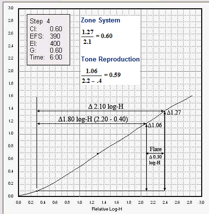

Two caveats to begin with, the intervals don’t apparently represent one stop steps and the diagram uses a 7 1/3 stop luminance range, which is statistically average. The 1/3 stop difference isn’t critical in practice, but it helps with the math coming out cleaner.
What should quickly become apparent is how the Subject’s log subject luminance range of 2.20 becomes a log luminance range of 1.90 in the Optical Image. The note along the right side indicates this caused by a “Moderate Flare Level Lens.” If this step is missed, then the range used on the film curve is off and the results will be off. The interpretation is flawed and doesn’t represent reality.
The negative developed to a CI of 0.56 has a density range of 1.05. It is printed on a Grade 2 glossy paper. 1.05 / (2.20 – 0.30) = 0.553 (Zone: 1.05 / (2.10 – 0.30) = 0.58). Grade 2 for a diffusion enlarge has an LER from 0.95 – 1.15 with 1.05 in the middle of the range. It’s all spelled out including how the negative relates to the print, which Adams never specified.
Yet, the Zone System aim value for a normal negative density range persists even in the face of its inaccuracy.

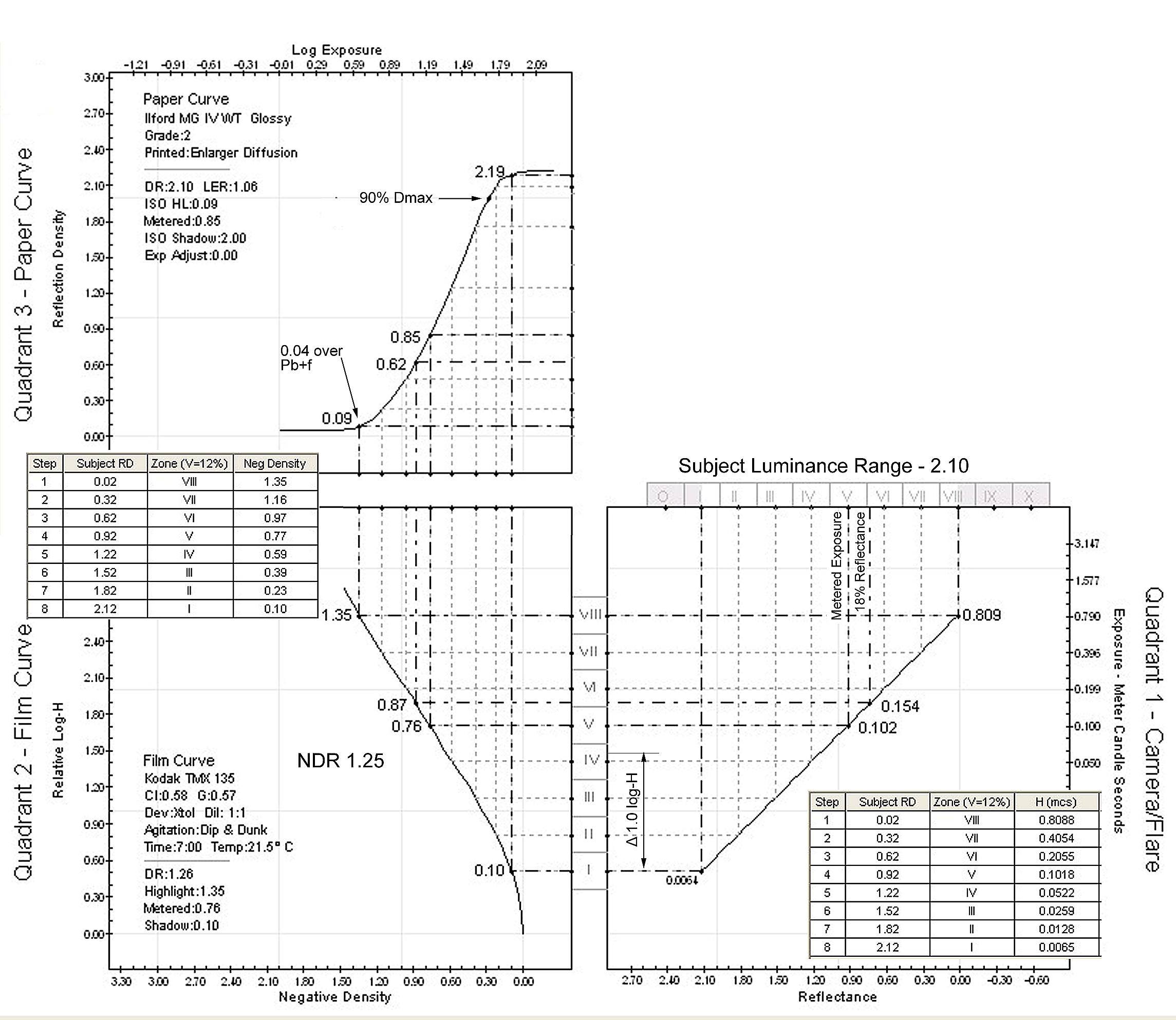

By the way, I finally tested the new Ilford MGV RC paper and ran a simple tone reproduction analysis with TMY-2. I made a print last night using the data from this plot and it worked out well, at least from the technical point of view.
Could you please take a look at tell me if I got anything wrong here? I'd really appreciate it. I am making my way through the code I wrote a while back, and still have some catching up to do. I guess I should have kept better notes.

In the hourglass-like graphic representation the intervals begin with 0.2 log subject luminance range but the absolute intervals are compressed and expanded according to the negative and print curves curves that are applied by the different stages of flare, negative and print.
aparat your four quadrant graphic representation looks correct. In the upper-right quadrant you “could” include the “preferred” tone reproduction curve as a guide (we aren’t aiming for 1:1) (see fig I-8 from Todd Zakia). Stephen, is it more correct to label the lower-right quadrant x-axis as Log Subject Luminance?

@aparat, the four quad looks good. It's clean, readable, and everything lines up. I only have a couple of suggestions. It appears you are including film base + fog with the film curve. You might want to add a Fb+f value in the film info. It will help with the evaluation. In the camera quadrant, you have 1.3 as the flare factor. I'm assuming flare is 1 1/3 stops. I'm really bad at defining math terms so forgive me if I don't explain it correctly. Flare factor is a geometric progression with a base 2. You can include both expressions for the sake of clarity. Finally, you might want to keep the number of decimal points consistent in the reproduction curve's gradient values to maintain a clean alignment. Do you include options on displaying certain values or calculations. For example, is the luminance range and exposure adjustable? Here are some of the options I use with mine.

@aparat, the four quad looks good. It's clean, readable, and everything lines up. I only have a couple of suggestions. It appears you are including film base + fog with the film curve. You might want to add a Fb+f value in the film info. It will help with the evaluation. In the camera quadrant, you have 1.3 as the flare factor. I'm assuming flare is 1 1/3 stops. I'm really bad at defining math terms so forgive me if I don't explain it correctly. Flare factor is a geometric progression with a base 2. You can include both expressions for the sake of clarity. Finally, you might want to keep the number of decimal points consistent in the reproduction curve's gradient values to maintain a clean alignment. Do you could include options on displaying certain values or calculations. For example, is the luminance range and exposure adjustable? Here are some of the options I use with mine.
Thank you so much for taking the time to review this and for your comments and suggestions! I referenced your work when I wrote this, so thank you for that, too.
Yes, it is 1.3 stops of flare, and I will include a more clear info window for that. Yes, I wrote this such that luminance, exposure, alignment, and other variables can be adjustable. Once I am finished working through my existing code, I am planning to add a feature to generate different film and paper curves to make demos, like those you frequently post. I think there's great potential educational value in that. Currently, I can only work with actual film and paper data.

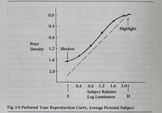

In the Way Beyond Monochrome, flare is mentioned a few times, and the famous Kodak nomograph was printed on p. 140 to help with the flare-corrected CI compensation, along with the conclusion that "I have not found any need to do so with any of my equipment."
I believe that's because it's already factored into his developmental model. It's the same tweak that Adams basically does. The development model in WBM is shown on page 128 fig 2. It appears to use a LER / NDR of 1.20.
Interestingly, these numbers are very close to the ones I've obtained using my practical flare model. Flare reduces the effective luminance, but if you don't use flare to reduce the luminance range variable, then you need to increase the LER / DR variable to compensate. A constant if you will. Working backwards from a normal negative of 0.58, each stop of the luminance range would average 0.30 * 0.58 = slightly over 0.17 units of density per stop of luminance. To keep it simple, a 7 stop luminance range would result in a negative density range of 7 * 0.17 = 1.19. Approximately what WBM uses. As we know in reality, average flare reduces the seven stop luminance range to six stops so the resulting negative density range should be more like 6 * 0.17 = 1.02.
On page 62 fig. 6, WBM has grade 2 as ranging from 0.95 to 1.15 with the average as 1.05. 1.20 falls outside the range of a grade 2 paper. For the math to work when determining a CI, you need to add an extra 0.15 density range to the grade 2 aim density range of 1.05 in the equation or subtract flare from the luminance range. The end result is the same. Only one reflects reality.
