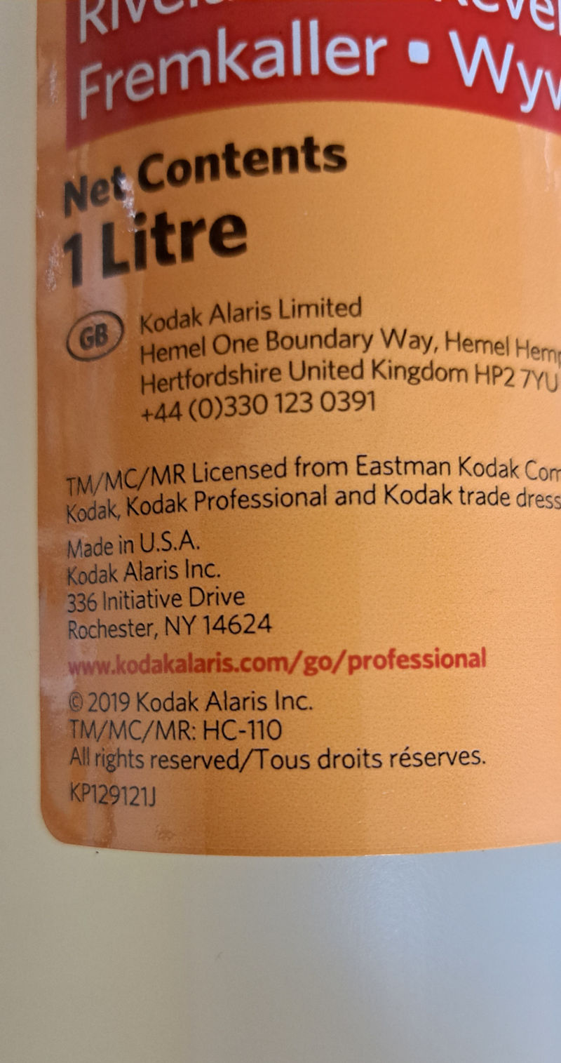

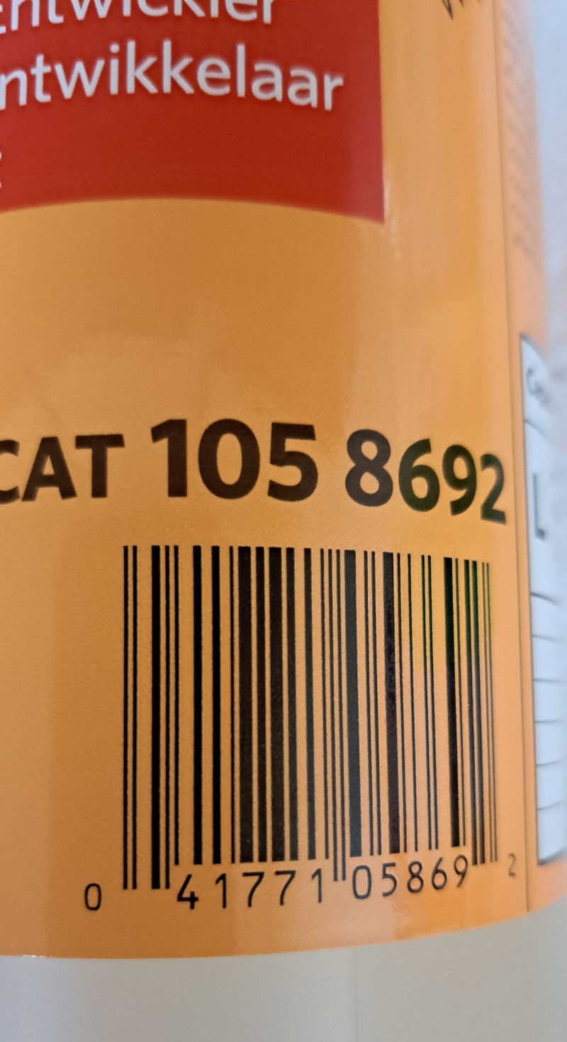

How current is your current HC-110?
Is it the 2019 version with Kodak Alaris' name on it, or the more recent version with Sino Promise' name on it? If 2019, does it say made in USA, or made in Germany?
And if it says Sino Promise, does it say made in Germany, or made in China?

Matt,
The old one was in a rectangular bottle. I dumped it because it was looking nasty, and there was about a third left in the bottle. The new one, I just bought from B&H. Here's the label:
That is an orphan - the 2019 Made in USA stuff that is no longer being produced.
Damn. This is getting pretty messy. No wonder (some) people have lost trust in Kodak chemistry. I wonder if Freestyle sells this version, too. On their website, they list the same product number and say it is made in the USA. The liquid seems much less viscous than the old version. It's actually easier to mix from concentrate. I also wonder about its shelf life. I guess time will tell.

That was Kodak Alaris's short term response to the bankruptcy of Tetenal, who were most likely the manufacturer of the previous product.
It is most likely fairly old now - is there a best before date on the bottle?
Kodak Alaris sold the photochemistry business to its largest Chinese based distributor, Sino Promise in 2020, and then Sino Promise was nearly destroyed by the effects of Covid 19.
There now appears to be some new HC-110 slowly appearing on to the market under the previous catalogue number - some made in Germany, while some is made in China. Its not clear how much has made its way to North America.
Thank you for that information! You are a walking encyclopedia of all things film photography. I always learn something new from your posts.
