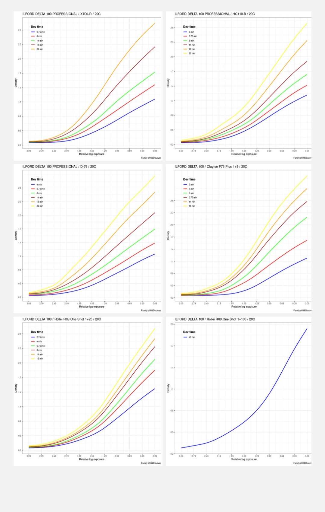

One of the best ways is a chart like this
I like this a lot, too. It's a simple but effective look at the data.
I also think that a family of characteristic curves can help, though it is only one look at the data and should be followed by additional testing, especially with a final product in mind. Here's a quick look at Delta 100 in different developers.
Interesting curves.
A few non-rigorous impressions:
XTOL and F-76, S-curve, especially for F-76
D-76, quite linear, short toe
HC-110, long toe followed by linear
R09, long toe followed by linear, slightly less film speed as indicated by delay in toe toward more exposure.
Any thoughts?

Interesting curves.
Any thoughts?
Yes, all true. I guess the problem is that we currently do not have a clear way to "translate" quantitative analysis, such as the characteristic curve family, into a qualitative description, using terms such as "tonality," "long," "short," "extended," "smooth," etc. The best I can do in my own work is apply tone reproduction analysis, which involves a four-quadrant plot, along with even more data. These are useless to most photographers and I have even heard comments that such analysis detracts from the art of photography. I cannot disagree with that. As I mentioned before, to me, this is not a question of right or wrong. It's whatever works.
Having said that, rigorous quantitative work can help understand why different developers result in different tonalities, how agitation affects tonality, how to get most shadow detail, etc. For example, there's a common belief that stand and semi-stand development result in "compensating" action, whereby there is a lot of compression in the highlights, preventing them from "blowing out." I have not found this to be true, at least not with the handful of developers I've tried. Here's a family processed in Rodinal 1+100 (Rollei R09 One Shot) using a semi-stand agitation: First minute continuous, followed by stand, two gentle inversions at the half-point, followed by stand. I do get about a 1/4 to 1/3 stop more shadow detail (compared to 1+25 with rotary agitation), but there's virtually no compression in the highlights. Still, I happen to like the results with Delta 100 and Fomapan 100.
