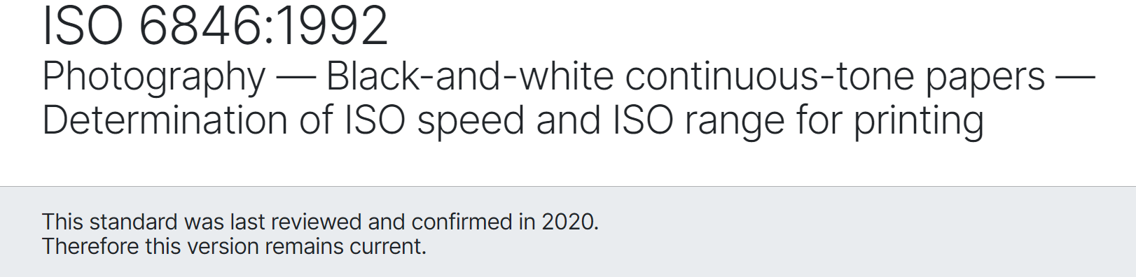

I have a question, if you don't mind. I have been reviewing my code for paper testing, and I came across a function I wrote that calculates ISO paper grades. I just don't remember where I got the formula from. My notes say "1992 ISO standard" so I am wondering if it's this one:
"ISO 6846:1992 Photography — Black-and-white continuous-tone papers — Determination of ISO speed and ISO range for printing"
Do you happen to know if this is the current standard? Thanks! I am grateful for your input. I always learn something new.

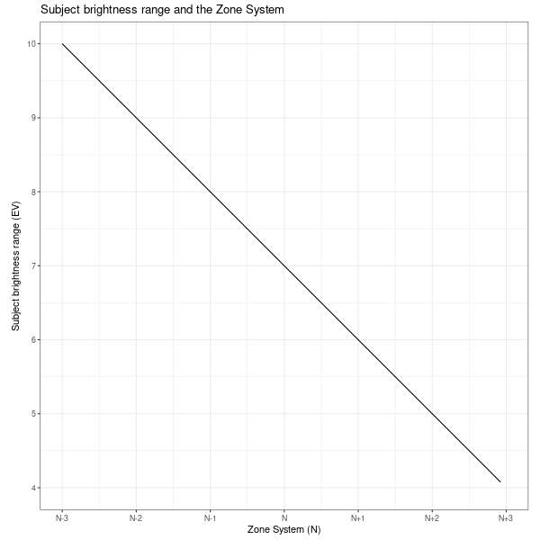

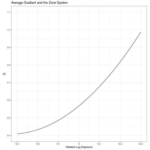

The gist of the WBW model is on p. 128. The idea is that there's a simple, linear relationship between "subject brightness range" and the Zone System (represented by the N-numbers), where seven stops is considered normal, and each stop (or EV) of brightness range in either direction, corresponds to a single step along the N-numbers continuum.
The next important relationship is between the average gradient (Ḡ) and the Zone System (N). It's important to point out that the authors consider a density range of 1.20 to be best suited for a contrast grade-2 paper in combination with a diffused light source. As @Stephen Benskin pointed out, this is not as simple as it appears, but, for practical purposes, it can be assumed to be a reasonable approximation. For a condenser enlarger, a different value may be needed, and the tool needs to be able to accommodate that.

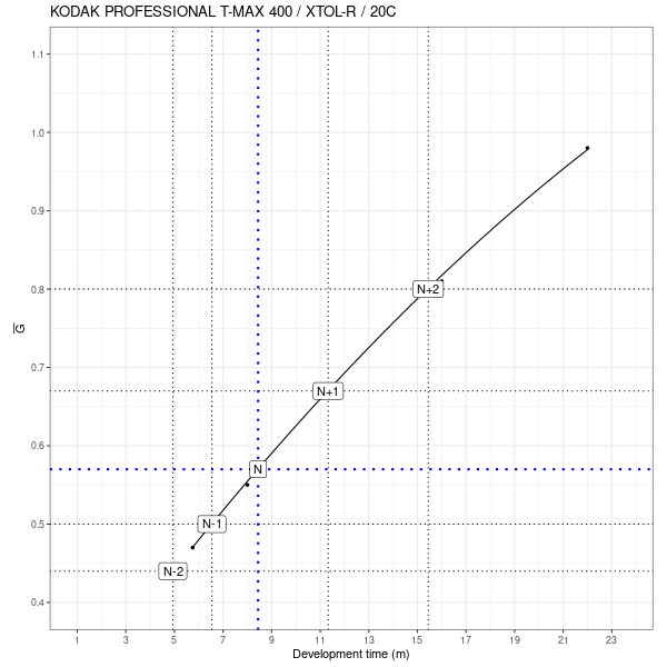

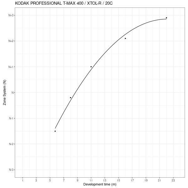

The analysis of the film exposure and development, in my opinion, can be summarized by four plots. I will be using my TMY-2 data for this as an example.
The first plot shows the relationship between the average gradient and development time. The curve represents the actual data, but the N-number labels are derived from the WBW model. Essentially, you can look up any combination of time and Ḡ and compare it to the Zone System (N). The blue line represents the normal development for an average gradient of 0.57. I decided to only include the range of N-2 to N+2 here, but I would leave it up to the user to decide on the range. In the book, this plot is on p. 138.
The next important view of the data in the WBM system is the relationship between development time and the Zone System (N). Here, we can compare the actual values (from our TMY-2 data) and their relationship to the WBW model. We can see that a "normal" development time in XTOL-R is a little under 9 minutes in a Jobo processor at 20C. The same, of course, can be read from the plot above, but that's just a different look at the same data, so to speak.

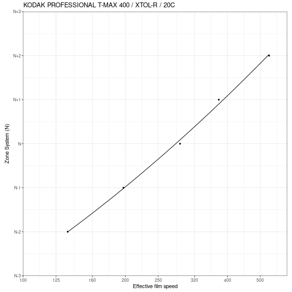

Finally, there's the plot of effective film speeds and the Zone System (N). This plot shows how "sensitivity decreases with development contraction." This plot is supposed to instruct the photographer regarding their exposure and development decisions in the field. Unlike the previous plots, this one does not include the actual TMY-2 data, but, instead, it shows the relationship between the N-numbers and film speed, derived from the actual data. Again, I am not sure how clear this distinction is. Please, let me know what you think.

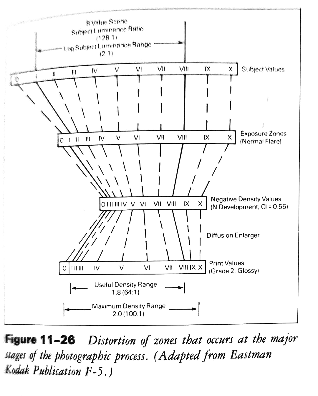

On page 62, the book has a breakdown of the LER for the grades with Grade two being 0.95 - 1.15 and 1.05 being the average. On page 48, the book has a diagram similar to one that I posted earlier. They use the 1.05, but use a different placement on the negative to justify the use of the 1.20 and 1.05, and the book uses 1.20 throughout. The diagram forces the aim ranges as starting on Zone I 1/2 to VIII 1/2 for the 1.20 density range and from Zone III to Zone VIII. How is this supposed to work based on tone reproduction theory? And the diagram actually has a tier showing the affects from flare but yet later doesn't factor it in.
This is a similar diagram from Photographic Materials and Processes:

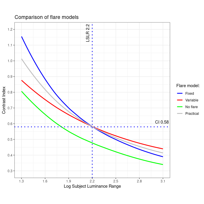

@Stephen Benskin Thank you for this demo! I took the liberty of implementing your Practical Flare model in my own code. Of course, I will always cite your fantastic work whenever I make a reference to it. By the way, I modeled the Practical Flare model by interpolating the Fixed and Variable flare models. I hope that is correct?

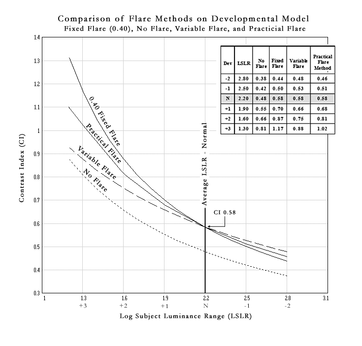

When all the variables are represented, it's easy to apply it to almost any situation. One interesting observation, the results from the variable flare model are close to Kodak's values for "pushing for speed."
This uses 0.40 for flare at the statistical average luminance range, and the variation in flare with the luminance range would hit 0 at around 1.20, so I've locked it at 0.10 at that point. With shorter luminance ranges, where the minimum exposure falls probably is the greatest influence on flare.
