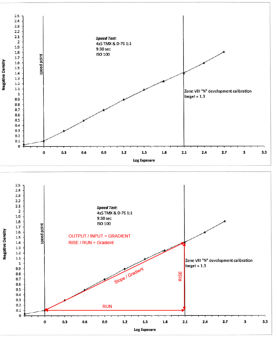

Yes, I am referring to the slope of the straight line of a curve when a straight line is actually present, that's all.
I follow you on all that, no problem-----CI is easily determined ZS useage or not, I only am stating a fact that CI in and of itself, is of little use to me in being fluid with ZS and of making good negatives and evaluating contrast.
I think you read me wrong because I think we are in agreement.
Thanks Bill, that was a clever way to get your message across better, and it worked. Did I read once that you use graded paper? I use VC paper, so Chuck probably won't be wanting to use Bill's paper! :laugh:
Just because you don't personally use some form of average gradient, doesn't mean it can't be used in a discussion or that any point made using some form of average gradient isn't valid because you don't use it.

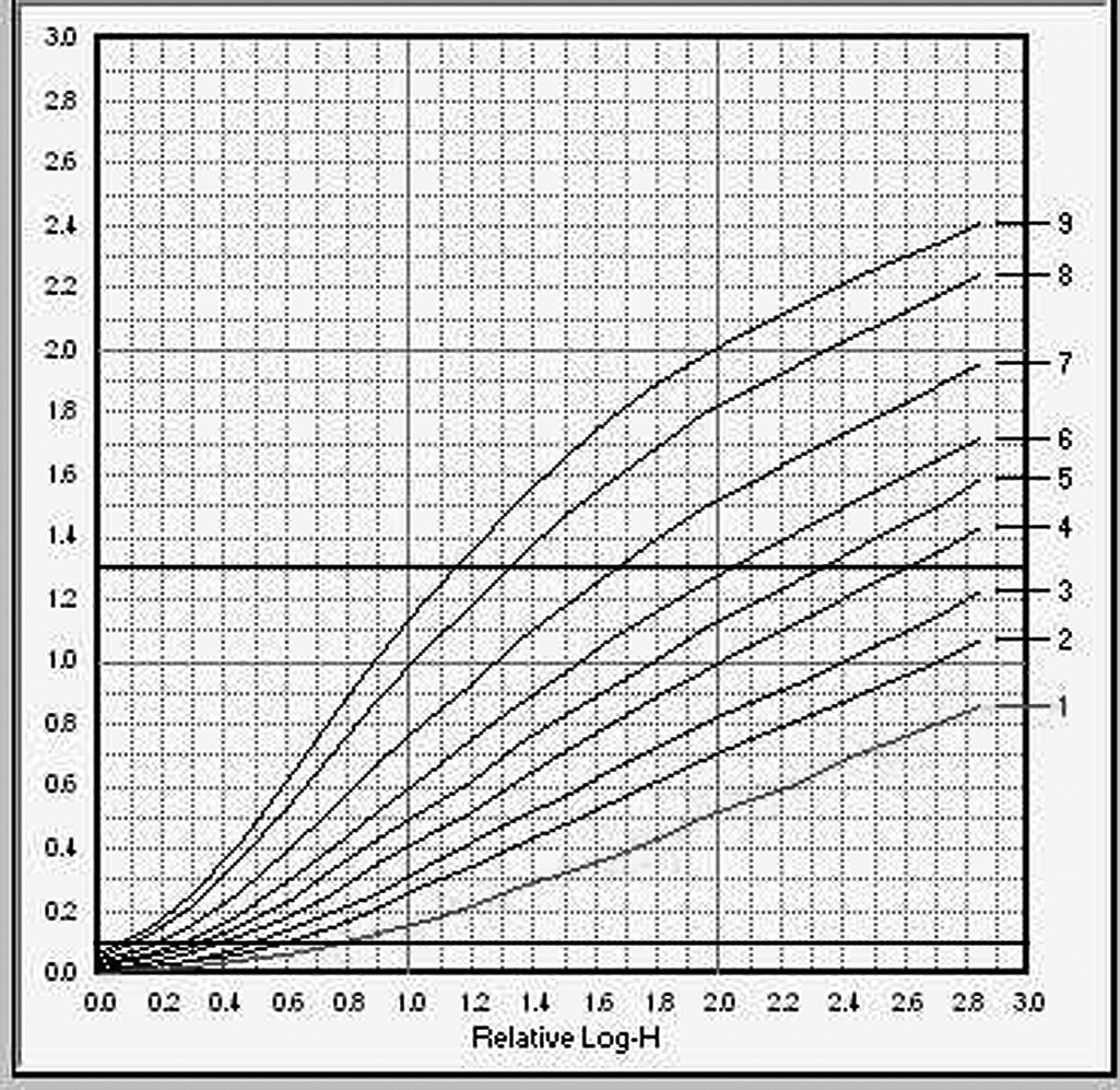

Tell ya what. Explain to me using the example below how you go about determining your development. It's a family of curves with Fb+f zeroed out. I've even marked out a 1.20 NDR. Or upload an example of your own showing how you do it.

Oh, there's no need to be threatened by little old me.......................I'll tell you what, first, prove in my posts where I indicated that it can't be used in discussion because I pernsonnally don't use it and and that a point made regarding average gradient is not valid because I don't use it. It's not in post #101, #107 (this is where I acknowledge there is nothing wrong with CI or using it in the ZS or whatever), it's not in #108, and it's not in #113. You don't get something for nothing in this world :D. You do that and and admit how horribly wrong you are with these assertions and I'll provide you with an answer, gladly.
That's just an attempt to avoid answering the question. Bill and I have explained how gradient is an intrinsic part of contrast determination even if the gradient value isn't determined. This should be obvious to anyone taking the discussion seriously. Yet, you have maintained a position that it's somehow possible to determine contrast without it.
I'm simply asking you to support your statement, otherwise it's just another unsubstantiated anecdotal claim. Put your money where your mouth is, or maybe you're intentionally acting in bad faith, wasting everyone's time, and attempting to derail this thread. Don't they call that being a troll?
Right... Bill has two choices: Grade 2 and Grade 3. I picked a paper, Galerie, over 30 years ago that is still available. How many people can say that?

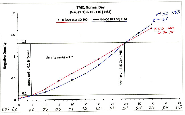

For those who are still here and still interested, I found a previous film curve example of Chuck’s. The top curve is what was originally uploaded. In the bottom curve the parts that I've worked are in red.
It should be obvious to anyone who is taking the discussion seriously that gradient is an integral part of contrast determination even if the value isn't determined. But if you determine it, you'd know that if you measured the curve at a different point, say at 1.80, you’d still produce the same gradient value which means the same contrast. Gradient is also useful in predicting density ranges for different situations.
Let’s say Chuck wants to use a condenser enlarger. According to The Negative, the density range for a condenser enlarger is 1.15. At what contrast would Chuck produce a negative density range of 1.15 for his conditions? 1.15 / 2.1 = 0.55.
Gradient also reduces the need to testing. You do a family of curves, determined the gradient for each, and you’ve determined you processing for silver printing on a diffusion enlarger, but then you want to shoot some negatives for platinum printing, you don’t have to test the film again. If you know the LER of the platinum paper, you just recalculate. My program has a gradient calculator. Just enter the set of conditions, and it gives the gradients for -3 to +3 as well as the processing times. To find the processing times, I use a CI / Time curve. Phil Davis lays this out pretty well in Beyond the Zone System.
Do you need to know the gradient in order to shoot. Of course not. With the shear preponderance of subjects near the statistical average combined with the varying personal preferences of the viewer, you really don’t need to know much of anything to produce a workable negative at least 60-70 percent of the time.
But who doesn’t prefer to have more information? Who doesn’t prefer additional insight? If the tool is available, why not use it when it can be useful? Understanding gradient made it possible to analyze two seemingly disparate methodologies and determine they are not dissimilar at all. They just measure the film curve in different places. The apparent difference between the negative density range of the Zone System’s 1.25 and the ISO paper grade 2 LER value of 1.05 is explained simply by using gradient.

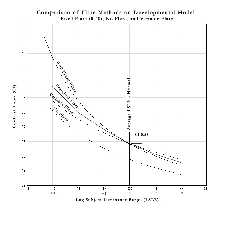

The rule of thumb is 1/3 stop change per stop luminance range. I believe it is only intended to be applicable for a limited +_ range of say 2 to 3 stops.
I've posted this before. It's a CI / LSLR graph of a number of different flare models.
I believe the reason Kodak used a fixed flare model for their chart was due to the unpredictable nature of flare. Next time you are in the testing mood, take two targets, one with a small black square in the center surround by white, and the other with a small white center surrounded by black. Meter a gray card and make exposures of both targets. Check the density range. They have the same luminance range, but will they have the same density range?
Great! Let me see if I can work backwards from "practical" flare and my family of curves. I'll label them as N+ / N / N- for ease of visualization.
The variable flare model reflects the 1/3 stop factor. The practical flare model uses the average between the fixed and the variable flare model. It's designed to include one of the exceptions to the LER / NDR relationship. From Jones, "For the soft papers, the density scales of the negatives should in most cases exceed the sensitometric exposure range of the paper, whereas, for the hard papers, the density range of the negatives should in most cases be less than the sensitometrically determined log exposure range of the paper."
The variable flare model agrees best with reality. I believe the practical will work best with use.

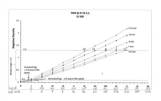

Here is the curve family that I ultimately arrived at for d-76 1:1 and TMX, absent any flare factor of course. What I found interesting with the test for EI is that it actually turned out to be 100 for me as the curve reached the Zone VIII target , just about right on the money. When +2 dev is planned, I reduce the exposure by 1/3 stop due to increased fog density and when -2 dev is planned, I increase the exposure by 1/3 stop due to reduced fog density. The curves don't show enough deviation in fog density at +1 and -1 to make a similar exposure adjustment. To date, these times have worked beautifully for me, of course, all I have to offer is my own anecdotal evidence of my own analysis and I'm not able to offer any more than that.
The "N" development comparison curves just represent, for me anyway, marked behavioral differences between d-76 and hc-110 with TMX in each of the three divisions of the curve (toe, straightline, shoulder). Knowing the CI values of each curve would be informative, I guess, but no decision would hinge on it. I evaluate differences in CI, figuratively speaking, in each major division of the curve when compared to another, in this way, the entirety of the curve is given full attention. Perhaps this explains my somewhat simplified point of view better, IDK.
I'm obviously not a technical minded as you and Bill because my road to the end result, seems just my own, within the confines of this thread that is, but I do take it seriously and find it interesting. If you are dieing to know the development times for the curves you posted last night, I arrived at:
At neg density 1.3, based off of development times from between 4 and 8 minutes and using Zone VIII as my target high value:
+2 dev, Zone VI (at log exp 1.5) = time interpolated at 7:30
+1 dev, Zone VII (at log exp 1.8) = time interpolated at 6:45
Normal dev, Zone VIII (at log exp 2.1) = ~6:00, the curve is within the range of 1.25 to 1.35
-1 dev, Zone IX (at log exp 2.4) = ~5:00, the curve is within the range of 1.25 to 1.35
-2 dev, Zone X (at log exp 2.7) = ~4:00, the curve is withing the range of 1.25 to 1.35
If I knew the ISO, I would break down my evaluation of the EI's for those four curves.

Chuck,
Those curves are beautiful and I think I see where flare is hiding.
As I get ready to draw my TMY-2 curves with flare included, I imagined your curve of N+1 with Zone I a little bit denser. To visualize only, what if Zone I really came out on film at 0.3 instead of 0.1.
You wind up with a camera negative that you developed with an aim of 1.2 NDR, but because of flare it comes out closer to 1.0 NDR.
And how do you deal with that? You don't need to. Your model anticipates flare by telling you to choose an artificially high NDR target. Higher than you really want. On your enlarger you want 1.0 NDR just like me.
Now since I picked a real negative that was really 1.0 NDR - I have to make sure to estimate flare before I decide development time because my charts don't have flare included and my aim NDR doesn't include adjustment for flare.
There may be more to it than that, but that's what I think I see right now.
This is what I've been saying for years! It's about the way the film curve is interpreted. The film curve is created under no flare test conditions, but there's flare in actual shooting conditions. In order to have agreement between the two, a flare value needs to be applied to the no flare film curve during the interpretation process (speed and contrast determination). The other way is to create a false aim value, such as a higher NDR to compensate for flare which is to be used only for the determination of contrast. Both approaches work, but one way reflects use and the other is a "fix" that can cause confusion if the concept of the "fix" isn't readily known. This is the difference that is observed between the Zone System NDR of 1.25 and the Grade 2 LER aim of 1.05. The difference is an illusion created by two different approaches but resulting in the same NDR even if they aren't aware of it. This is one reason why I like to say people aren't getting what they think they're getting.
The use of some form of average gradient in determining film contrast eliminates this potential confusion, in much the same way it was used to explain it.
Chuck are you carrying through specific subjects/zones measured in the scene or are your zones defined at the negative?
What I'm getting at is that if measured at the negative then camera/scene based flare wouldn't be represented, right?
Look alone the bottom of the x-axis. The log-H range is 2.10 (7 stops). That's approximately the normal scene luminance range, not the in camera illuminance range at the film plane (exposure range). The important point is that the combination of the NDR and the log-H range still equates to a normal contrast negative, but that the 1.20 or traditional ZS 1.25 is a projection or construct in order to compensate for interpreting real world conditions on something produced in non real world conditions. This method can be used instead of adding a separate camera image curve or adjusting the log-H range of measurement to reflect the exposure range.
Phil Davis discusses this concept, in brief, in BTZS 3rd ed, Analyzing Film Curves, p 95.

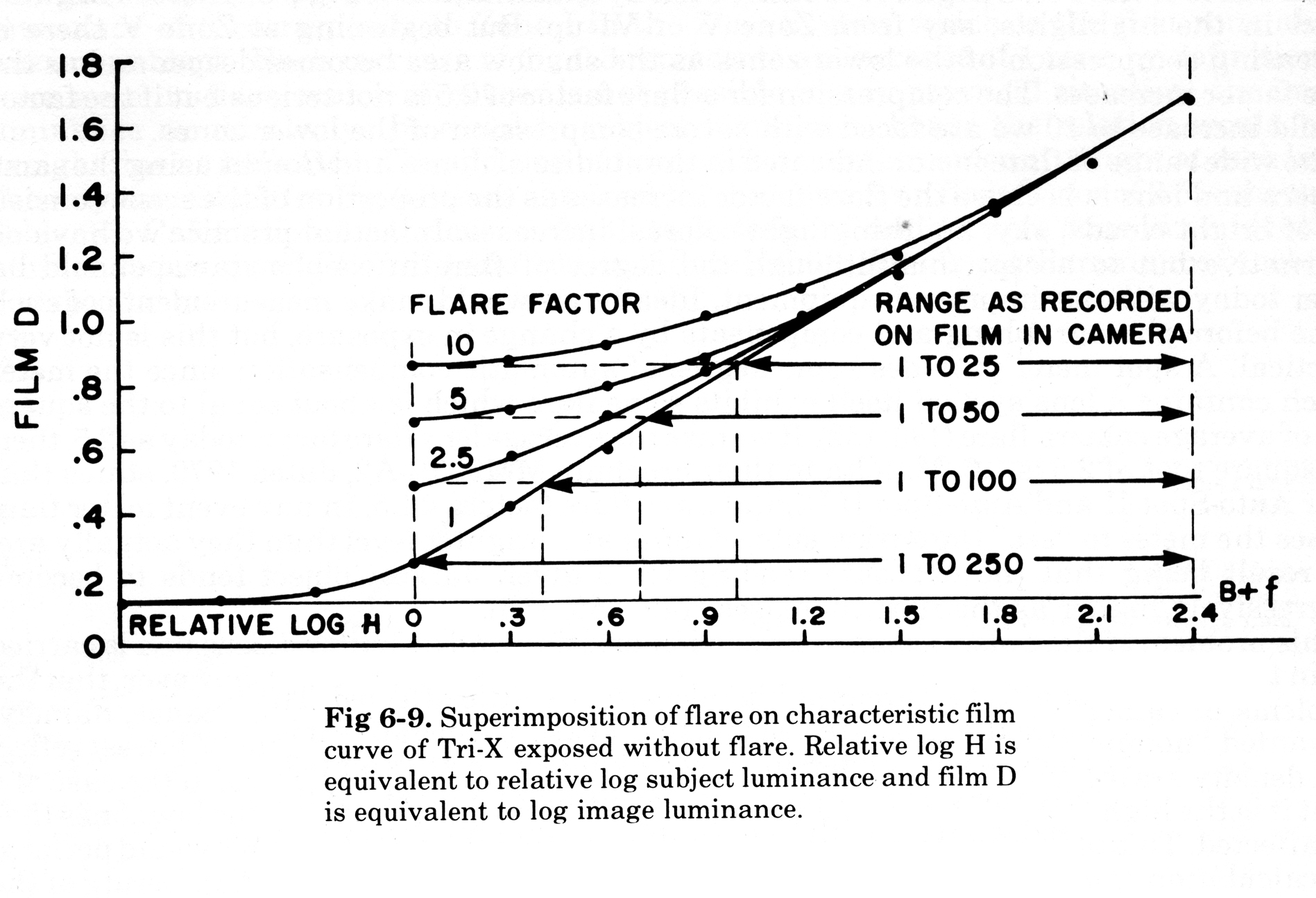

Have you ever seen a film curve that shows the effects of flare like below?
This is a similar concept to ZS contrast determination in that it too is a construct. It shows how flare effectively changes the film density. Putting it all on one graph eliminates the need for a camera image curve, but it doesn't illustrate how flare acts upon the film curve in reality. For that, a two quadrant curve is required.
