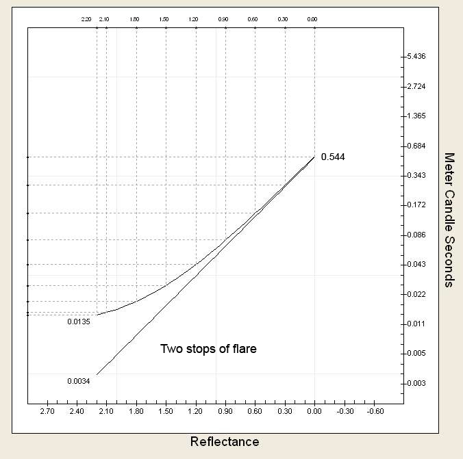

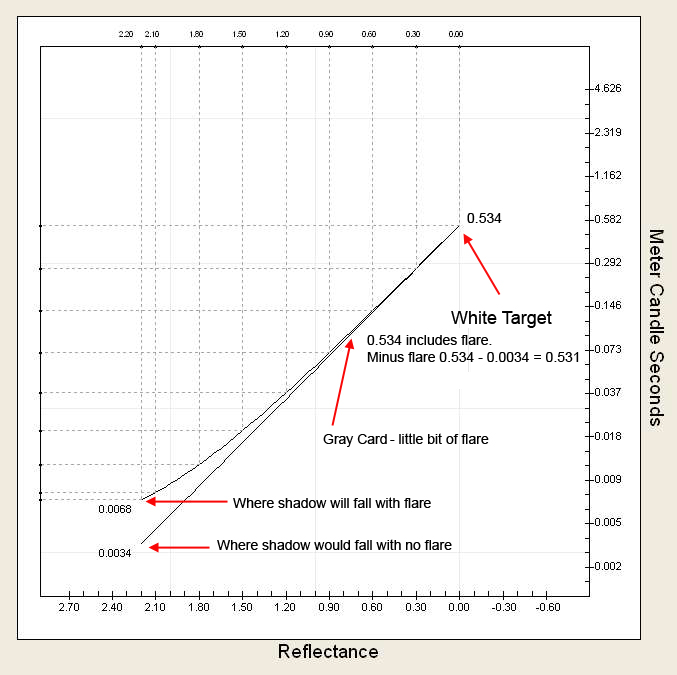

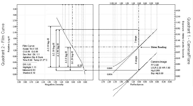

What if the lens is wide open and I'm using shutter speeds to control exposure? Wouldn't flare from a brightly lit white card be in play even though I'm exposing for low values?
In the conditions you've outlined, veiling flare would have to double the highlight exposure to reproduce the effect of one stop of flare, and I don't think it's capable of that. Take a look at the camera image curve. The white card falls at the high end. A one stop flare factor doubles the shadow exposure. An exposure of 0.0032 mcs is added each point on the curve. By the time it gets up to the highlight, it doesn't add much to it value. I would like to point out that this example uses a camera image curve representing a 71/3 stop average luminance range. A white card would be just a small line or a dot.
In camera testing would meter the card and stop down. This just moves everything down.
Just to help make a point, I doubled the amount of flare in the example below, and the highlight exposure almost hasn't changed.
Here is the concept in a bigger context. The difference here is that it is based on testing using a middle gray card. It would be too messy to show the shift from a white card down to the shadow exposure.

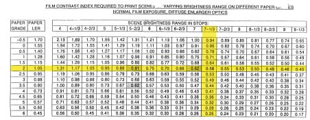

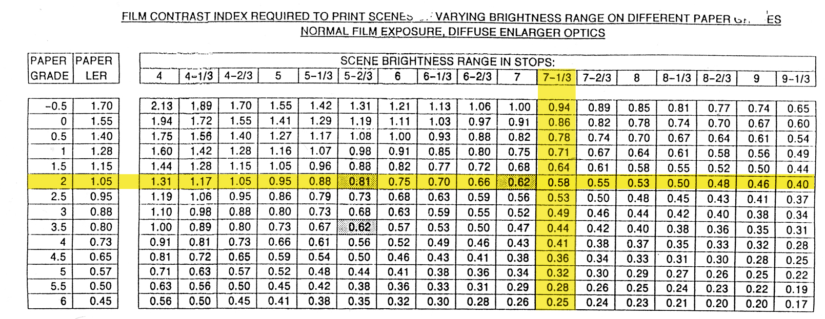

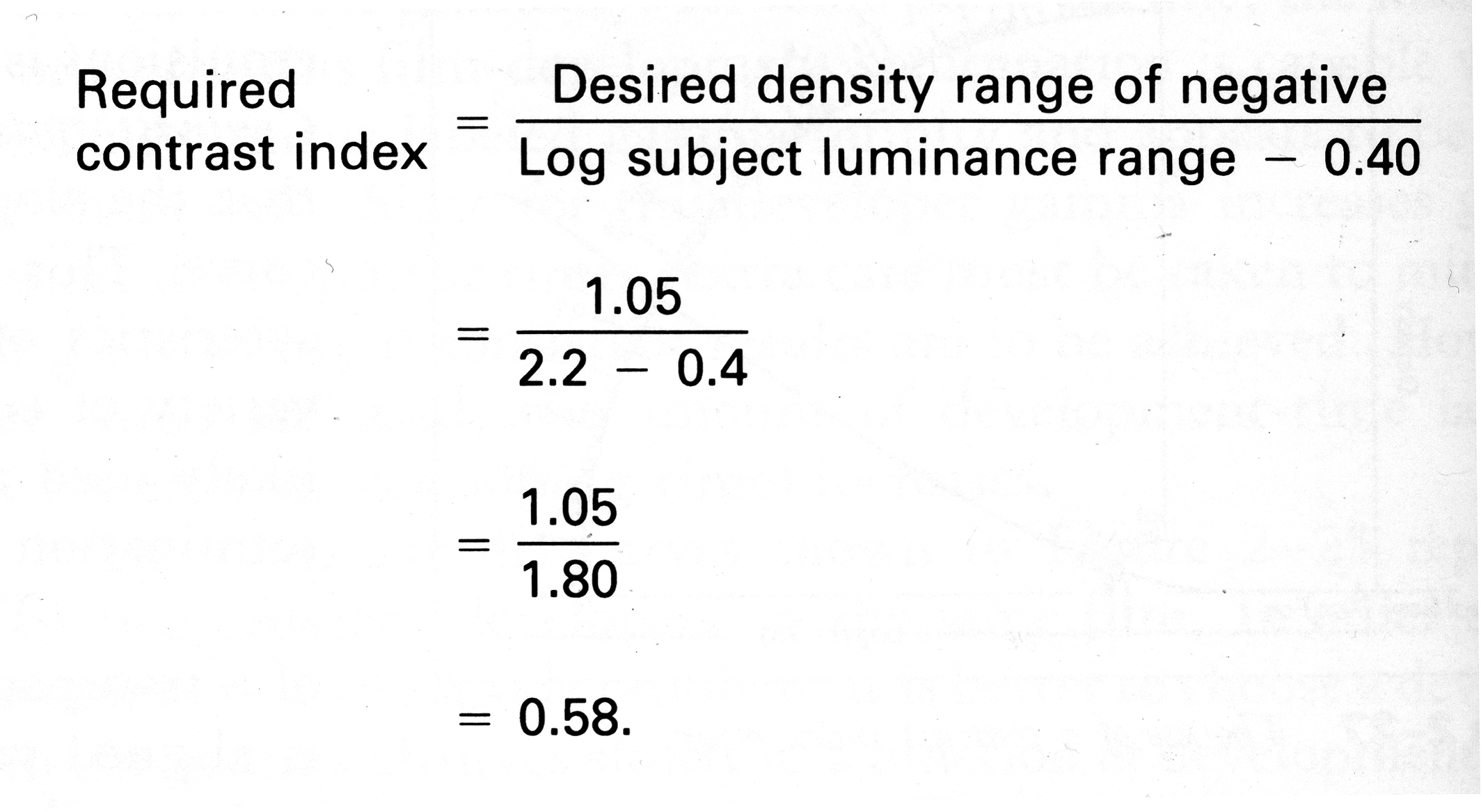

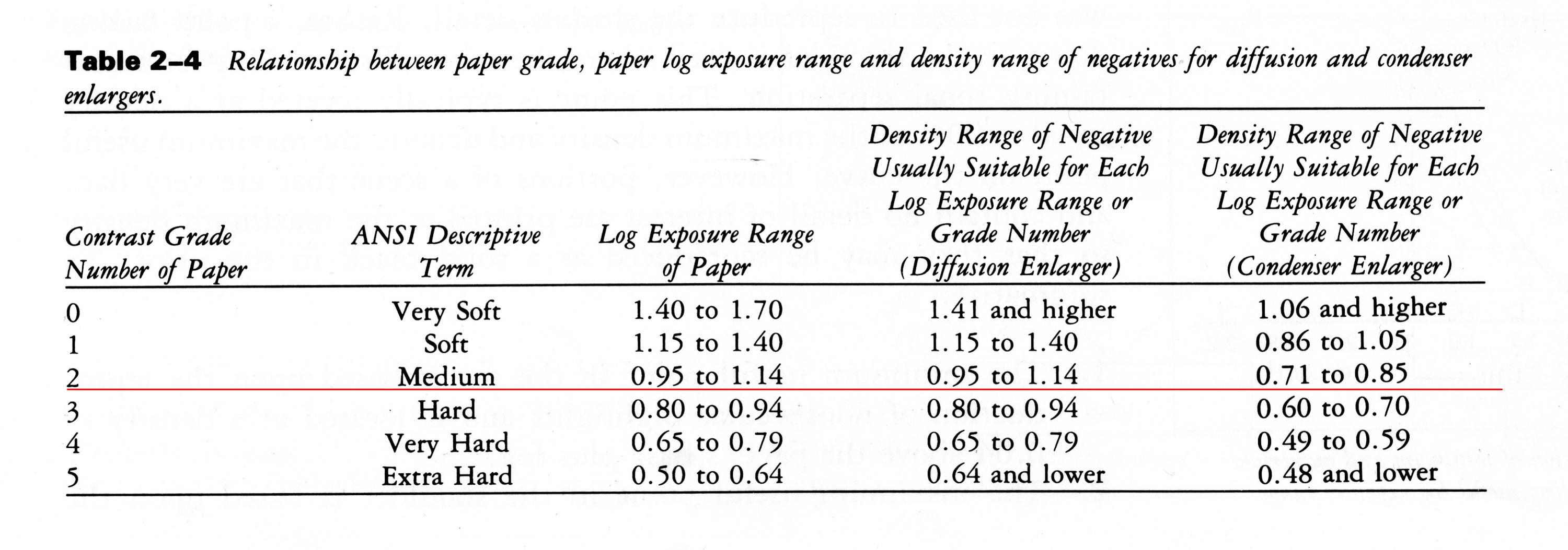

Another bit of information hiding in plane sight. The following equation can be found in Photographic Materials and Processes. It shows how to determine the proper contrast index to produce a desired negative density range in consideration of the subject's luminance range and camera flare.
The part that is hiding is this RIT text book's value for flare is in perfect agreement with what Kodak uses. Below is a developmental table used at Kodak.
I guess it shouldn't come as a surprise considering the close relationship of the two institutions.

Let’s say a 35mm negative is printed in a 4x5 negative carrier without any masking around the negative. What ever the density range of that negative, the excessive flare will reduce the density range the paper effectively sees.
A condenser enlarger has a Q-factor of 1.30. A negative with a density range of 1.05 will have an effective density range of 1.05 * 1.30 = 1.36 at the paper. Turning this around, what would the negative density range have to be for a negative printed with a condenser enlarger onto a grade 2 paper with an LER of 1.05?
Multiply the reciprocal of the Q-factor by the LER.
1 / 1.30 = 0.769
1.05 * 0.769 = 0.81
Compare it to the table in post #91.
The paper LER is chosen for the effective negative density range and not the actual negative density range. That is why there are different suggested negative density ranges for negatives printed on condenser and diffusion enlargers.

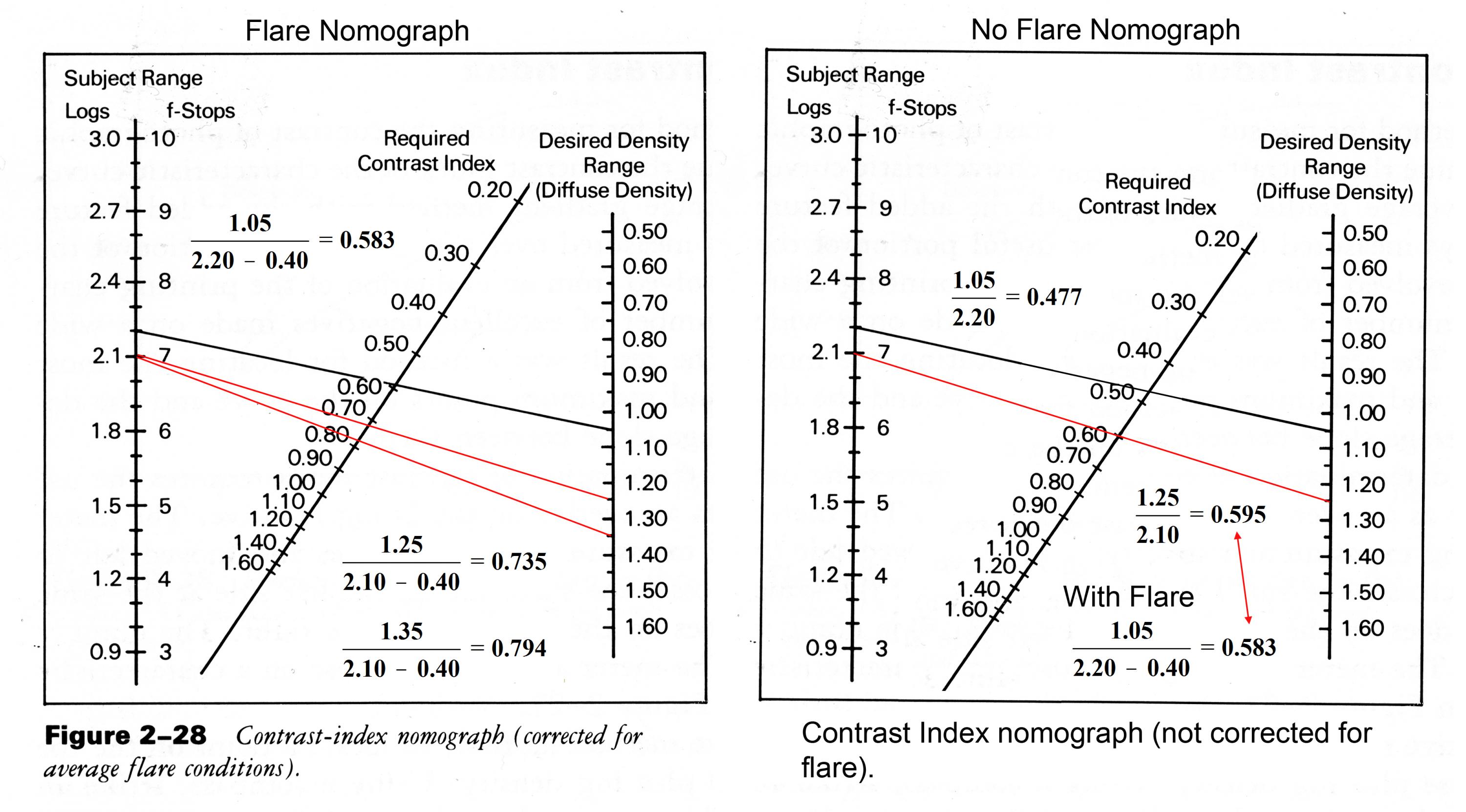

Here's another hidden example. Below are two contrast index nomographs. The film's contrast index can be derived by drawing a line from the scene luminance range to the desired negative density range. The nomograph on the left incorporates average flare and is from Photographic Materials and Processes. The one on the right is the same nomograph but it has been adjusted to eliminate the influence of flare.
In order for the statistically average scene of 2.20 to produce a negative density range of 1.05 under average flare conditions, the negative needs to be developed to a CI 0.58. Under the same flare conditions, a scene with a luminance range of 2.10 requires a CI of 0.725 to produce a negative density range of 1.25.
It's also possible to do the same thing mathematically by using the contrast index equation from post #92.
1.05 / 2.20 - 0.40 = 0.583
and
1.25 / 2.10 - 0.40 = 0.725
Let's compare these numbers with those derived from the no flare nomograph. A CI of 0.477 is required to produce a negative of 1.05 from a 2.20 luminance range scene. For a luminance range of 2.1, a CI of only 0.595 is needed to produce a negative density range of 1.25. The math looks like:
1.05 / 2.20 = 0.477
and
1.25 / 2.10 = 0.595
A contrast index of around 0.56 to 0.58 has long been considered "normal" processing. That eliminates the set with a CI of 0.725 and the set with a CI 0.477 as representing actual conditions.
The contrast index for the 1.05 negative under flare conditions is almost identical to the CI aim for the 1.25 negative under no flare conditions. Both fall around the classic normal CI value. As both indicate the negatives be processed to the same contrast index, the processing will be identical therefore the resulting negatives have to be identical for the same scene. But how can shooting a scene with the same luminance range and processing the negatives identically produce different density ranges as those two sets of numbers suggest? The simple answer is they can't.
Let’s also consider the relationship between the negative density ranges and the paper LERs. A negative density range of 1.05 falls in the center of the grade 2 LER paper range for printing on a diffusion enlarger. A negative with a density range of 1.25 falls near the middle of a grade 1. See the chart in post #91. That eliminates the set with a negative density range of 1.25. That leaves the 2.20 luminance range with flare, processed to a CI 0.58, producing a negative density range of 1.05 as best representing the conditions of use.
The only way all the established aim values fit together is through flare, and the answer is right there in the nomograph if you look for it.
