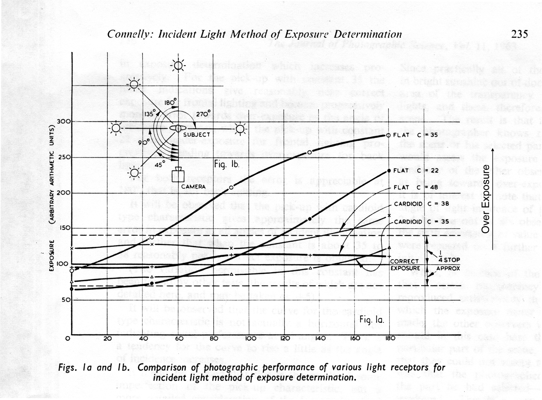

Another interesting tidbit of information from the paper is that the value of C can change with the thickness of the receptor. Here's a graph from the paper Comparing the photographic performance of various light receptors for incident light method of exposure determination. The bottom axis is the angle of the sun in relation to the direction of the camera. The exposure meter is placed in front of the subject pointed toward the camera.
The findings:
"From the curves shown, it would appear that the flat pick-up does demonstrate an error in exposure determination which increases progressively. For the pick-up with constant 35 the meter indication give reasonably near correct exposure for frontal lighting and become progressively more in error towards over-exposure as the angle of incidence increases, whilst the pick-up with constant 22 give under -exposure for frontal lighting progressively tending towards over-exposure for back lighting.
For both receptors the error is appreciable at 180 degrees, that is, for back lighting.
It will be observed that the pick-up with cardioid type characteristic gives approximately the same error in exposure at all angles of incident illumination and further that when the constant is about 35 to 38 reasonably nearly correct exposure is obtained."
The conclusion:
"...the results of the test as summarized in in the curves of Fig 1 demonstrate that the receptor with cardioid type pick-up characteristic can give satisfactory exposure determination by means of a single reading for any angle of incidence of the maximum illumination on the subject.
For this condition to be met, the photographic constant C as defined and determined in standard ASA Specifications must be about 35 to 38, whilst a tolerance of +-5 is permissible on the figure adopted.
The flat plate type of receptor an be seriously in error when the angle of receptor is over about 90 degrees but may give reasonable results for angles less than about 90 degrees."
The ability for the cardioid receptor to produce acceptable results in in all conditions was probably why it was adopted as the primary value of C. The next question is why the difference between the recommended value of 35 and the adopted value, in the ANSI 1971 standard of 30. Interesting enough, that standard appears to switch from the cosine value of C to the cardioid value instead of keeping the value for the cosine receptor and creating a separate value for the cardioid receptor.

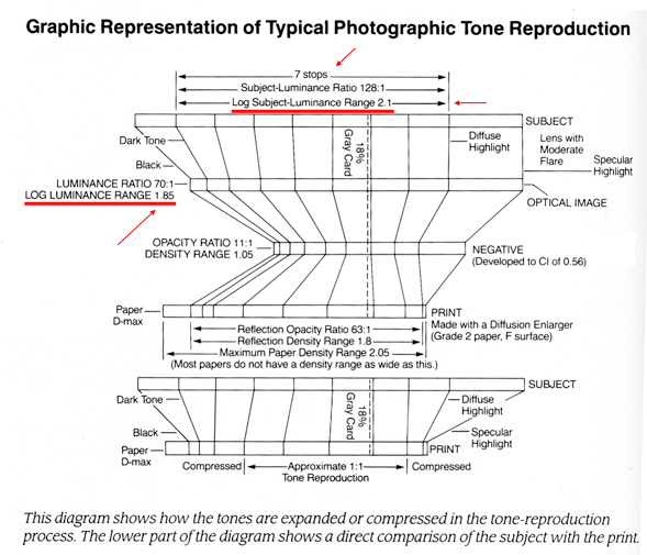

Flare not only changes where the shadow exposure falls, but also reduces the scenes luminance range at the film plane. In Bill's example flare changes a 1:32 scene into a 2:33 scene at the film plane. 2:33 can almost be reduced to 1:16.
Take another look at the Kodak diagram from post #1.
At the top is the subject. It has a range of 7 stops or log 2.10. Flare reduces this range within the camera. Here they call it the Optical Image. It now has a range of 1.85 logs or a touch over 6 stops. The film is then processed for the six stop range, and not the original 7 stop range. Mathematically it's very simple. To find the illuminance range of the subject at the film plane, you subtract the amount of flare from the subject luminance range. In the case of the Kodak diagram: 2.10 - 0.25 = 1.85.
The next example is from Photographic Materials and Processes.
I was told it was the text book for first year students at RIT. Quadrant I, the lower right quadrant, represents the camera image. At the top are the Subject Values or original subject. Here the stops are equally spaced. Flare from the optical system changes the relationship of the original subject values. The values that strike the film, the dividing line between Quadrant I and Quadrant II, are no longer equally spaced as flare has compressed the lower values.
