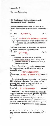

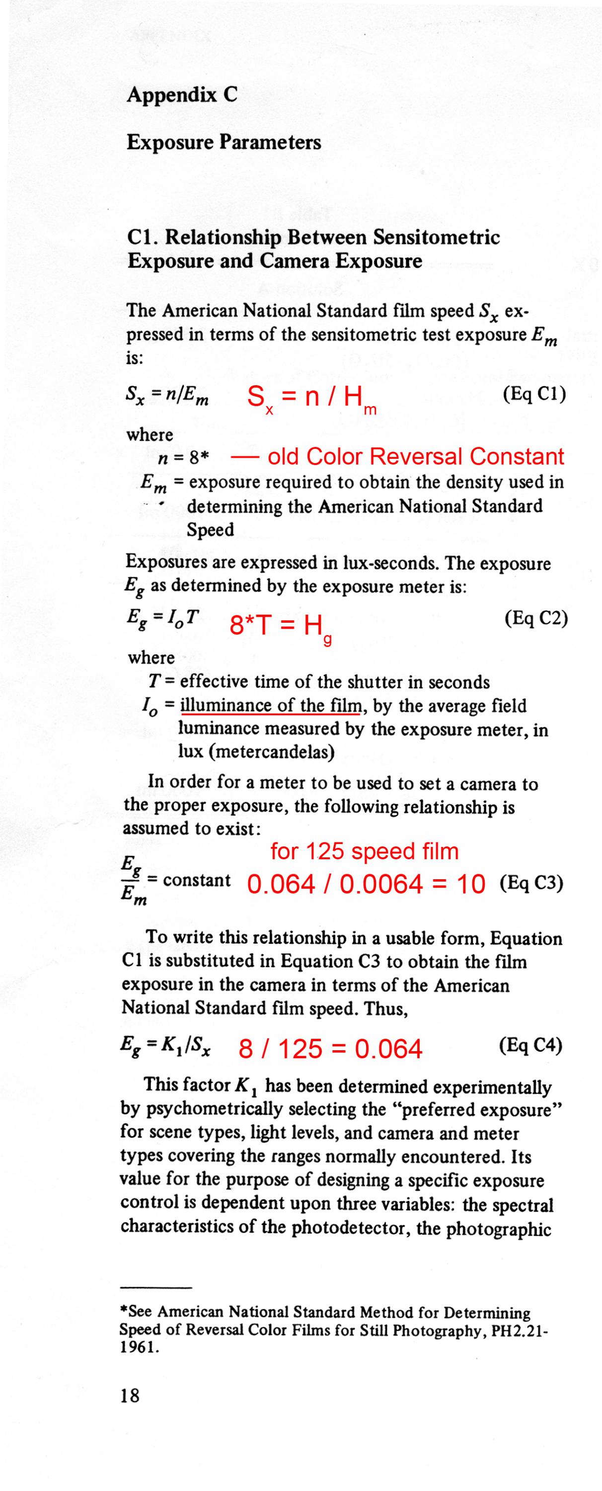

The excerpt below is Appendix C from the 1971 ANSI Exposure Meter standard. You should be familiar with the values and equations.

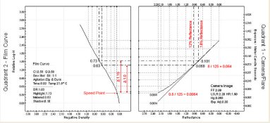

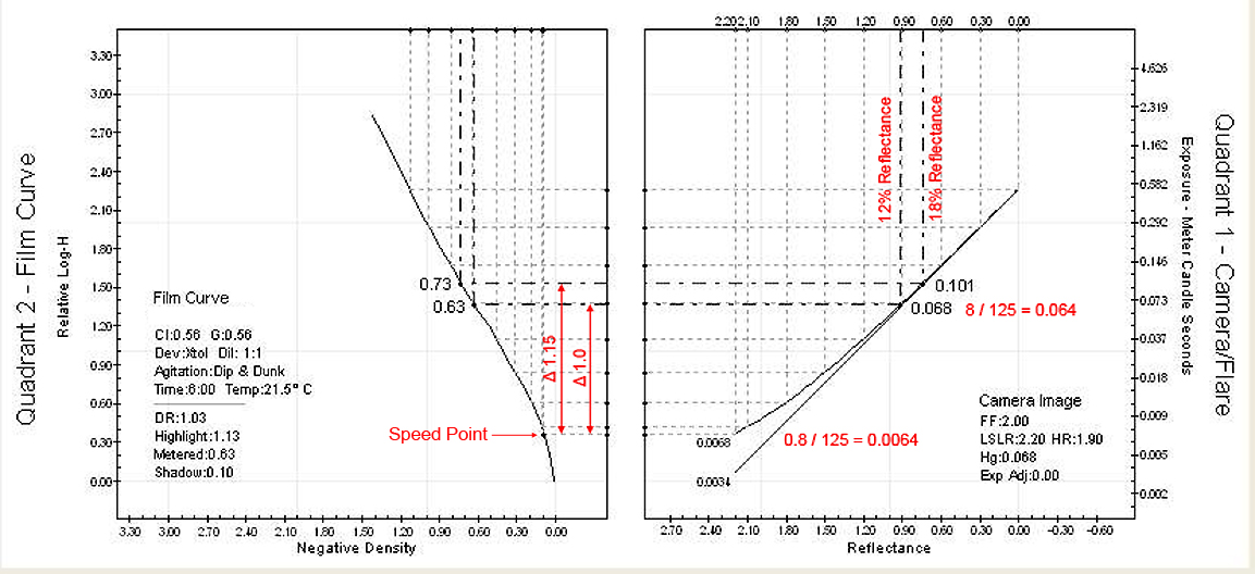

Bill, I'm not sure how to do a diagram to illustrate K and C. I might be able to go step-by-step though. As for 12% and 18%, I think I might have a way of looking at it.
The first graph is keyed to 12% reflectance. You can see that the relationship between the speed point and the metered exposure is 10x (1.0 logs). 18% reflectance falls 0.15 log-H further up the curve.
The second graph is keyed to 18% reflectance. The shadow exposure, including flare, now falls 1/2 stop further down on the curve.

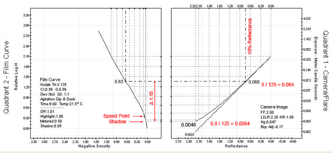

The 18% graph is somewhat of a cheat. It supposes the same luminance distribution as the 12% model. Of course, this would lead to a different film speed / metered exposure ratio between the two. But what if 18% was middle grey and had the same luminance distribution as the 12% model? The 18% curve would look identical to the 12% one above. One big difference. The math doesn't work for an 18% grey model.

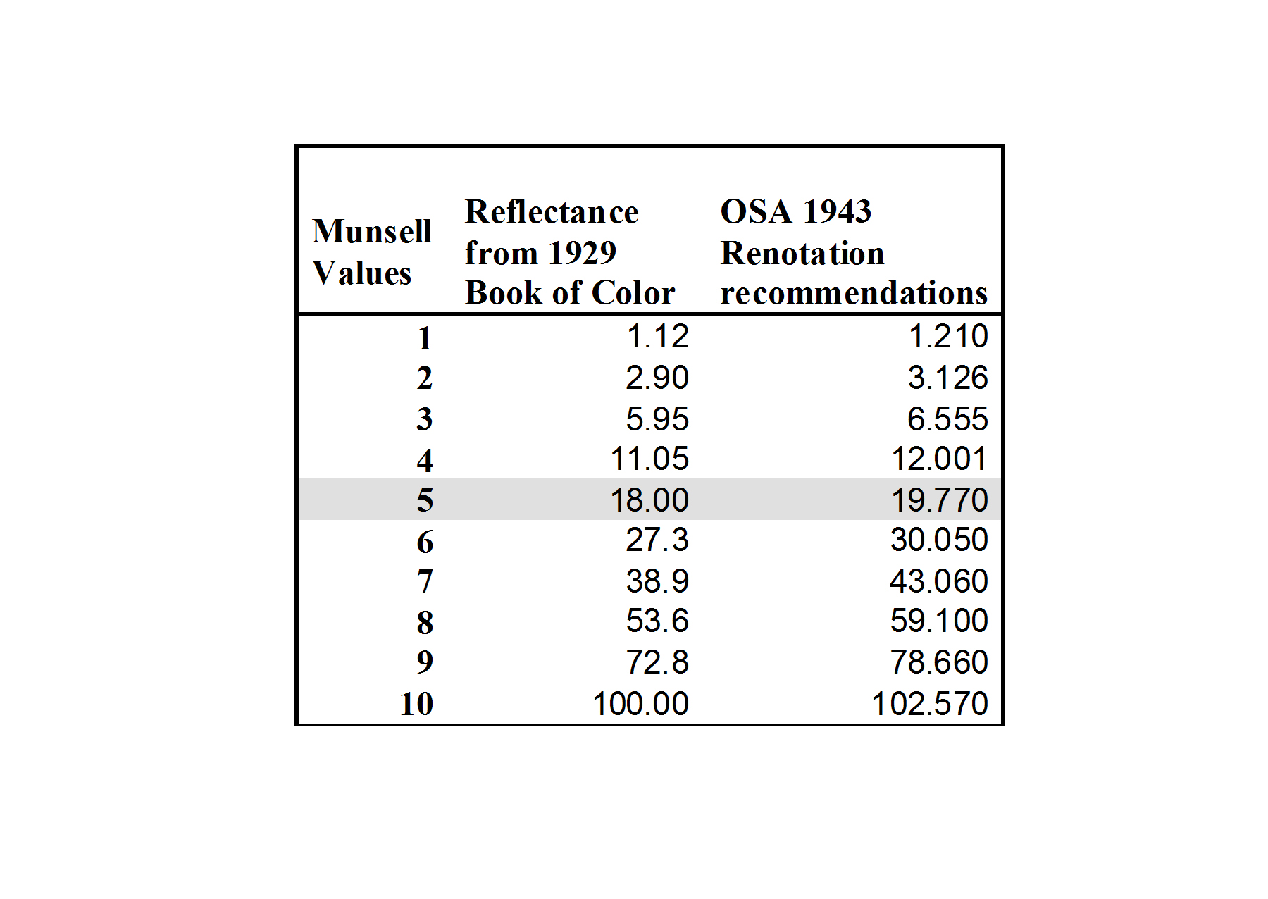

I believe the use of 18% gray in printing and two dimensional art has it's origins with Munsell.
Munsell's steps are based on perceived equally spaced steps between black and white with the middle step being 18% gray. Kodak's Gray Card Plus has a white and a black area included. According to their information, the white has a 90% reflectance (RD 0.046), and the black has a 3% reflectance (RD 1.52). The mean is (1.52-0.046) / 2 = 0.739 Reflection Density or 18% reflectance. So 18% can easily work as the average for a two dimensional subject.

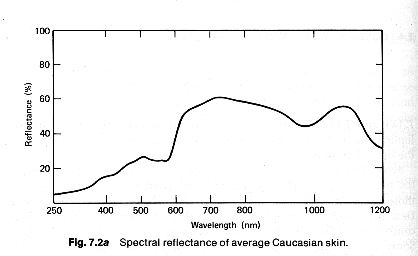

And metering off the hand? Here's a spectral reflectance graph of Caucasian skin. Looks like a high level of infrared reflectance. I guess metering off the hand is more a rule of thumb.:smile: sorry.

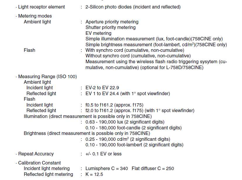

Here's the technical data for a Sekonic meter.
K = 12.5/10.76 * pi = K = 3.65
C = 340/10.76 = 31.6

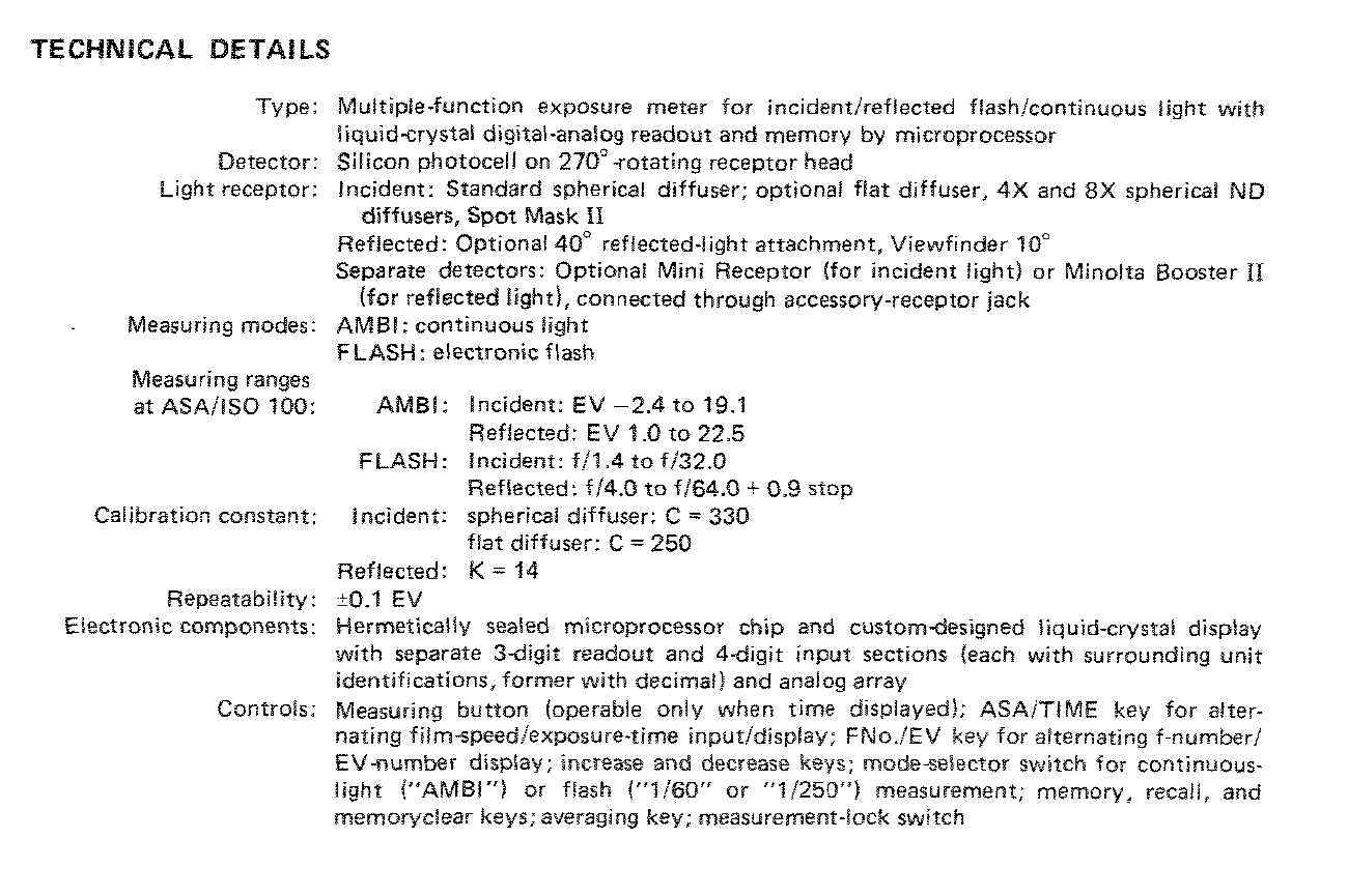

The technical specifications for a Minolta Meter III
K = 14
K = 14/10.76 = 1.3
K = 1.3*pi = 4.08
C = 330
C = 330/10.76 = 30.6
Hemisphere
14*pi / 330 = 13%
Cosine
14*pi / 250 = 17.6%
Again, the early standards don't distinguish the type of receptor for the value of C. Did they use ranges to incorporate both types instead of separating them? Is it valid to use the K/C equation for a cosine receptor? If it is, it apparently helps to support the idea of 18% reflectance for flat art.
No matter what the exposure meter "sees", it puts it all on the same spot on the film - 8/ISO. I believe one of the reasons why the question of the percentage of what the exposure meter reads has so little written about in the more technical publications is because of the variance of conditions and that most falls within tolerance.
