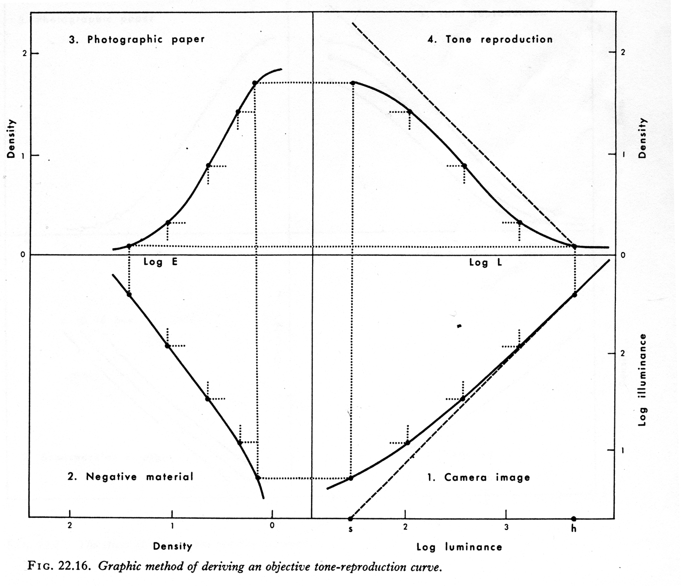

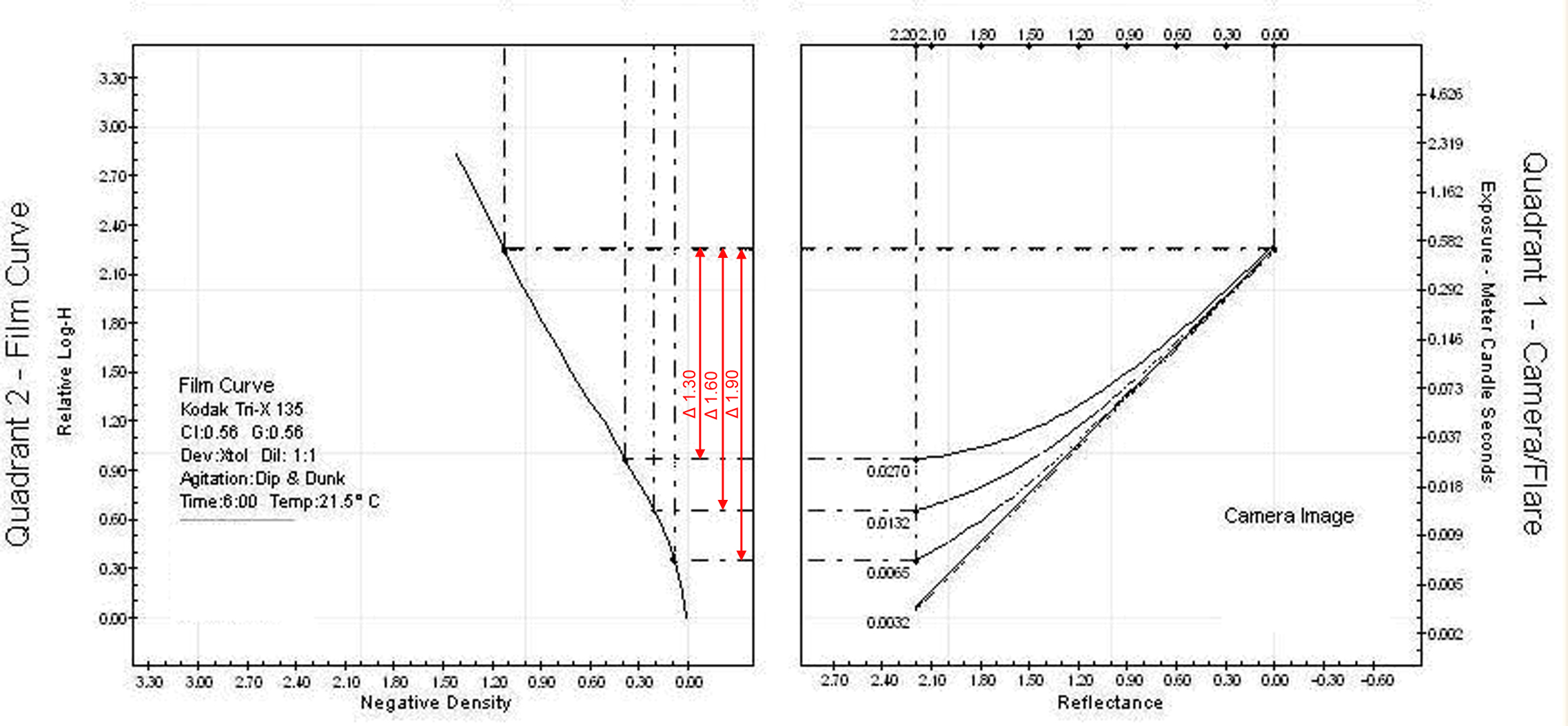

Michael, This is a really big subject. Maybe if the questions are a little bit more specific or something, I could be more specific with my answers.
To me the last graph you posted (post #131) is really what it all comes down to when we talk about flare. This is really the kind of "flare overlay" we all need when we plot curves. The question is, how? It is too variable.

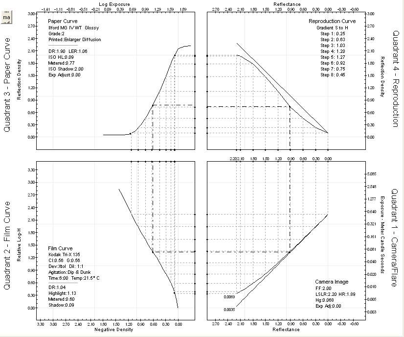

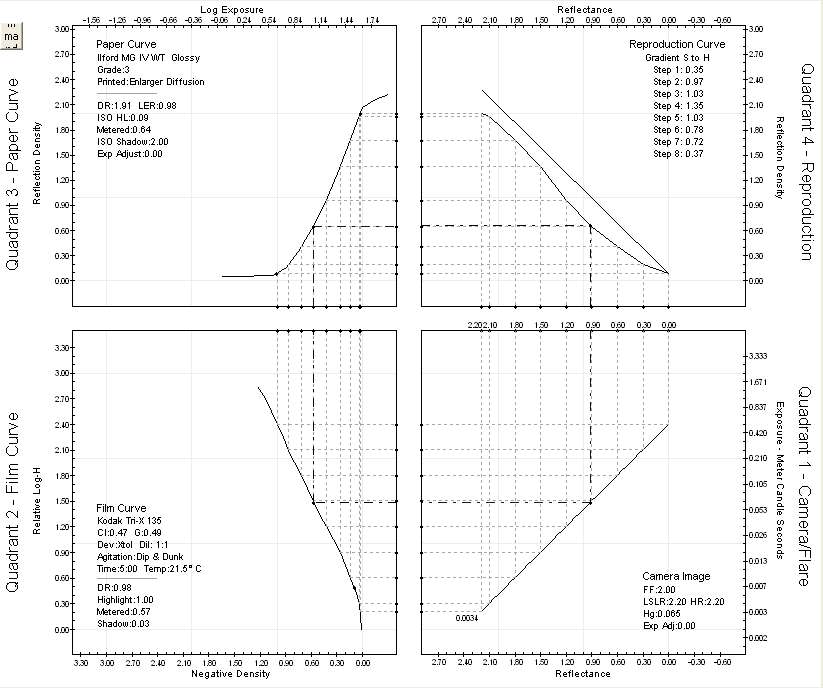

That graph isn't really how flare works on the film curve, below is how it really works.
Now, you don't need a camera image / flare curve to make it work. Simply use the exposure range from combination of the scene's luminance range and flare and apply it to the film curve. It sounds like you are already doing this.
Is flare too variable to have to do this? Yes and no. Yes, no matter what it's always going to be a guesstimate. No in that phenomenon tends to have statistical averages and follow a bell curve, so you have a better chance to be within your target range if you factor some of it in.
Odds are you are already factoring it in depending on how you measure the film. This is something I've discussed ad infinitum. The manufacturer's published processing times have flare factored in too. So most people incorporate flare into their film processing whether they know it or not. And if you are already incorporating a stop of flare into your process, and if the flare factor is plus or minus another stop or so, this difference can easily be off-set by a variety of factors like scene luminance range, the nature of the subject, how the tones are distributed, choice of paper grade, and personal taste.

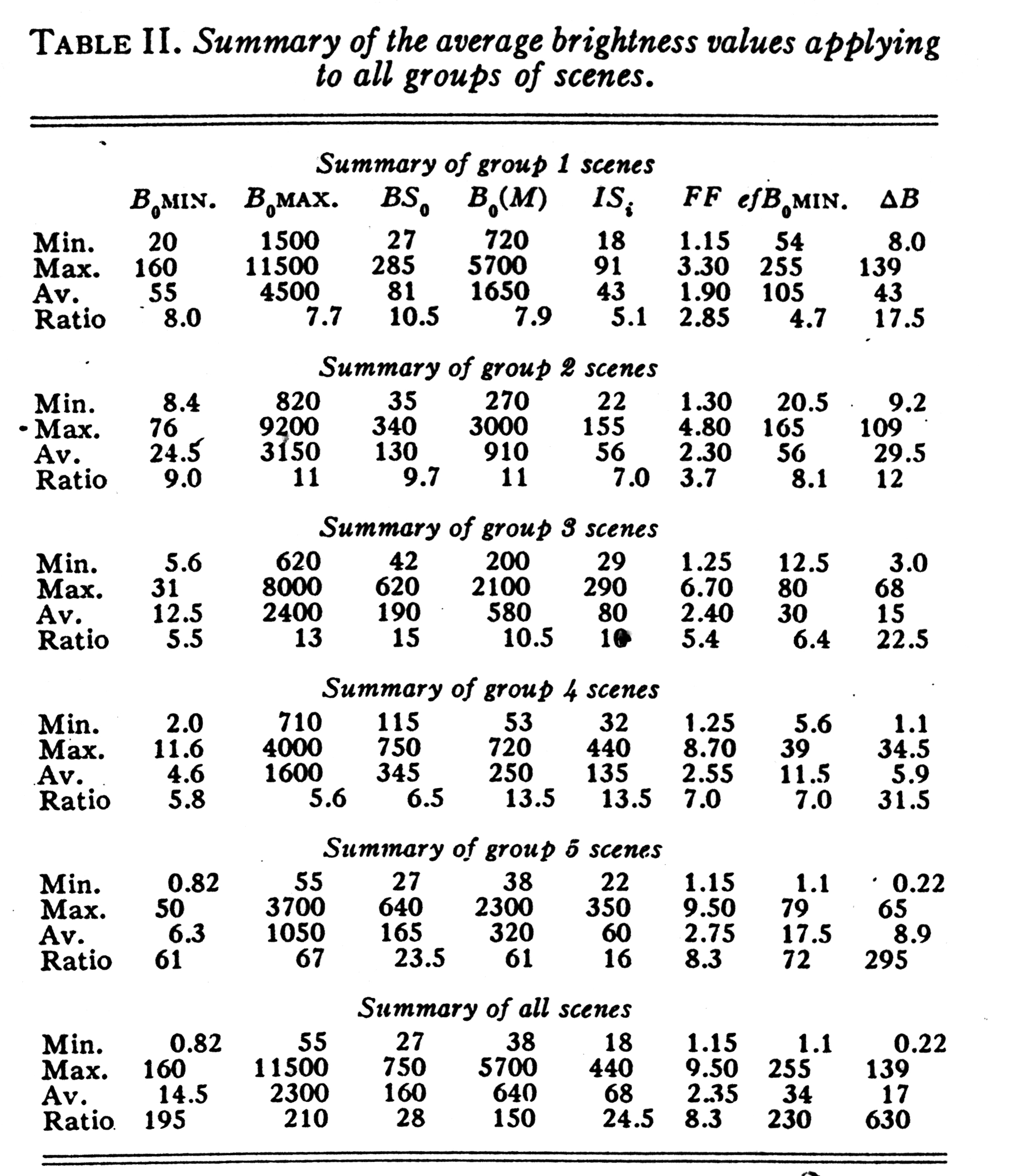

I found something in Jones’ Brightness Scale paper that speaks to your question about flare in various situations. There were a predominance of front lit scenes used in the testing. That means the data set contains a more limited luminance range and range of flare than can potentially be encountered. He divided scenes into four subdivisions: 1) distant, 2) remote, 3) near-by and 4) close-up.
1). Distance – Landscape
2). Remote – They use a street scene as an example
3). Near-by - They use a single house
4). Close-up - The example shows a full shot of a boy sitting down.
Jones writes, “It is interesting to note that the average Bmin (min luminance) value decreases progressively and in an orderly manner from groups 1 to 4, inclusive. The average brightness scale (range) increases progressively in these groups.
The flare factor increases systematically from group 1 through 2 and 3 and 4. The value of delta B (luminance) however, decreases progressively from group to group. These two facts taken together mean that while, in general, a distant open landscape results in a higher absolute value of flare light on the focal plane, its effect in reducing the illumination scale (range) of the image is less than in the case of a group 4 scene. This follows from the fact that the shadow brightness (luminance) of a group 4 light results in a greater proportionate reduction of the illumination scale (range) of the image corresponding to an increase in the flare factor.”
And later, “It will be seen that the flare factors vary enormously from scene to scene. This variation is due largely to the variable brightness (luminance) distribution found in these scenes and in their environments. From the summary of the entire group at the bottom of Table II, it will be seen that the flare factors vary from 1.15 to 9.50.”
If you want to know what that is in log-H, simply convert it to logs: log(9.5) = 0.98 or 3 ¼ stops.
I like the idea of the degree flare effects the image depends on the minimum luminance value. Darker tones from distant scenes will arrive at the camera lighter because of atmospheric haze and something called the blending distance. The effects of flare have little effect that high on the film curve.
“The average flare brightness scale (luminance range) also increases progressively through these four groups and, as a matter of fact, there is a good correlation between the average flare factors and the average brightness scales (luminance ranges).”
Some of the Summary
“1. The maximum and minimum brightness (luminance) of 126 exterior scenes of a wide variety of types has been measured. Form these data it is found that the average brightness scale (luminance range) is 160.
3. For the average type of small portable hand camera used predominantly in the amateur field, the average value of the flare factor is approximately 4.0. This value is based on a large mass of statistical evidence not published as a part of this communication. For the equipment used predominantly in the amateur field, therefore, the average value of image illumination scale (illuminance / exposure range) is 40.”
A 160 luminance range is 7 1/3 stops or 2.20 logs. A flare factor of 4.0 is two stops. Coated lenses cut the value in half.
Below is Table II.
B min and B max – minimum and maximum luminance value in footlamberts.
BS – Luminance range
IS – Illuminance or exposure range - if no flare is present IS will equal BS
FF – Flare factor

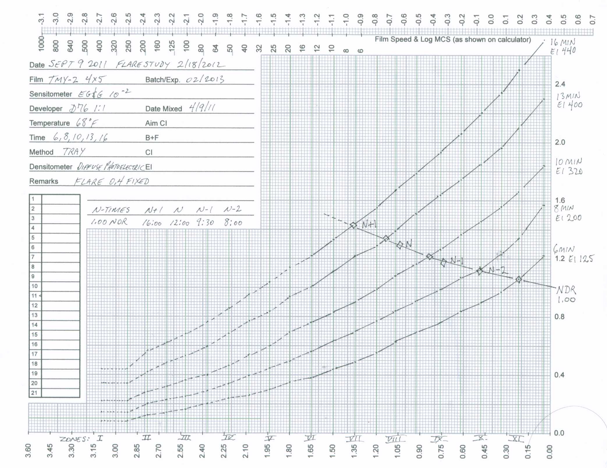

I have created an unusual graph that on the surface looks like any other curve family.
This curve family includes 0.4 fixed flare (dashed lines are flare-influenced), and shows my target 1.00 Negative Density Range (solid line that slopes about 20-degrees downward).
The low densities Zone I and Zone II are not precisely predicted in this graph so they are horizontal dotted lines. For this first iteration I picked Zone II as the anchor for the influence of flare.
To see where it came from, this is the curve family without flare.
http://beefalobill.com/imgs/Sept9TMY2.pdf
To get the flare "curve" you turn the Log numbers to mathmatical values.
At the speed point for ASA 400, the Log value is -2.7 (as used on a calculator with log functions) which translates to mathematical 0.002 mcs (meter-candle seconds). The amount of light that hit the film in non-flare conditions.
Stepping over to the right 0.4 log units is the speed point for ASA 160, Log is -2.3 translates to mathematical 0.005 mcs. The amount of light estimated to hit the film when flare becomes involved.
Amount of light estimated to hit the film minus amount of light that would have hit the film without flare, 0.005 mcs - 0.002 mcs = 0.003 mcs added to the entire sheet of film due to flare.
To graph flare, then becomes a simple graphing task.
For every data column, get the mathematical mcs number, add 0.003 mcs to it. Convert it to Log to find the actual mcs that would have arrived at that column. Then using the actual curve family for each dot of the plot, take the dot from the graph underneath the new column.
So I started with the nearest data column to the ASA 400 speed point, the speed point for ASA 250, -2.5 Log mcs, 0.003 mcs.
0.003 mcs non-flare exposure for that column + 0.003 mcs flare over the whole sheet of film = 0.006 mcs exposure really hit the film under the speed point for ASA 250. This is -2.22 Log.
Thus on the graph for the column under the ASA 250 speed point, instead of plotting the test results, I use the plots from under the effective exposure that I find on the non-flare curve family graph under -2.22 log.
The boring process is repeated: For each data column mcs, add 0.003 mcs for flare, find the Log and then look at the non-flare curve family and take the points from that column. Basically the non-flare curve family graph tells you exactly what density you get when you hit the film with a certain amount of light.
For the flare study you try to estimate how much light would hit the film in a camera when flare is involved. So where you expected Zone II you get Zone II + 0.003 mcs which is pretty significant on the toe. It starts to get down to no effect as you go higher, for example there is less than 0.1 Log flare at Zone IV (0.015 mcs) + 0.003 mcs = 0.018 mcs.
I hope to be able to take this flare study curve family to the field and use it for planning exposure and development, and have a reasonable expectation that the negative densities will fall where I placed the metered exposures. This wasn't happening for me when I used non-flare curve family. I was getting greater densities in the Zone II than I predicted.
This chart is how I plan to deal with flare. I expect process variation, errors and other realities to cause +/- 0.10 density of what I aim for.
Other ways of dealing with flare can get you just as close. For example, Chuck, I bet your N-times for TMY-2 are very close to mine even though I aim for 1.00 NDR and you aim for 1.20 - the difference is very close to the effect of flare.

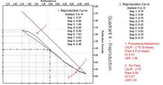

Also, as I said in an earlier response to Stephen's question regarding whether the flare is helping with a long SBR, I don't see why it is helpful, other than because you don't need to reduce development quite as much. It shortens the negative density range, but who cares about that if local contrast in the lower values is compressed?
No one desires to have a lot of flare but there are some advantages when it is in moderation. There's a average flare today of around one stop, and before lens coatings, two stops. This encompasses the entire history of photography. Most people aren't even aware that any exists. So, it obviously isn't disastrous.
Film speeds would be one stop slower without flare. For proof, simply look at the EI values that come from Zone System testing (no flare testing and not factoring in flare during speed determination), and ISO speeds.

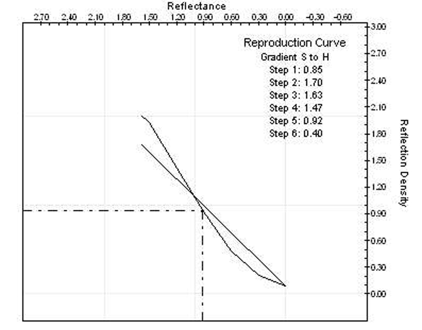

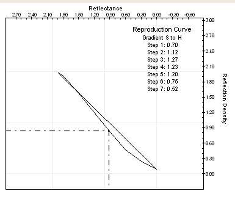

Now, we can compare the difference in effective film gradients between a film curve without flare and with flare and point out the compression of the tones from flare. But that doesn't tell the whole picture. It doesn't take certain other factors into consideration. Chief among them is what we perceive when we look at an image. I'm not talking about if a person can see the difference in tonal separation but what is considered a good print. Even if it were possible, an ideal print with a 1:1 tonal relationship with the original subject wouldn't be considered pleasing. In reality, camera flare reduces the shadow contrast and enlarger flare compresses the highlight, but that's okay, because as long as the mid-tones are printed slightly more contrasty than the mid-tones of the original subject, the resulting print is considered to have a certain level of quality.
There are many more factors that are involved and considered including personal preferences, subject matter, and printing choices. But with careful testing a statistical model can be determined. Of course, it doesn't speak to the creative interpretation of a subject but about what generally will tend to yield more consistent high quality prints.

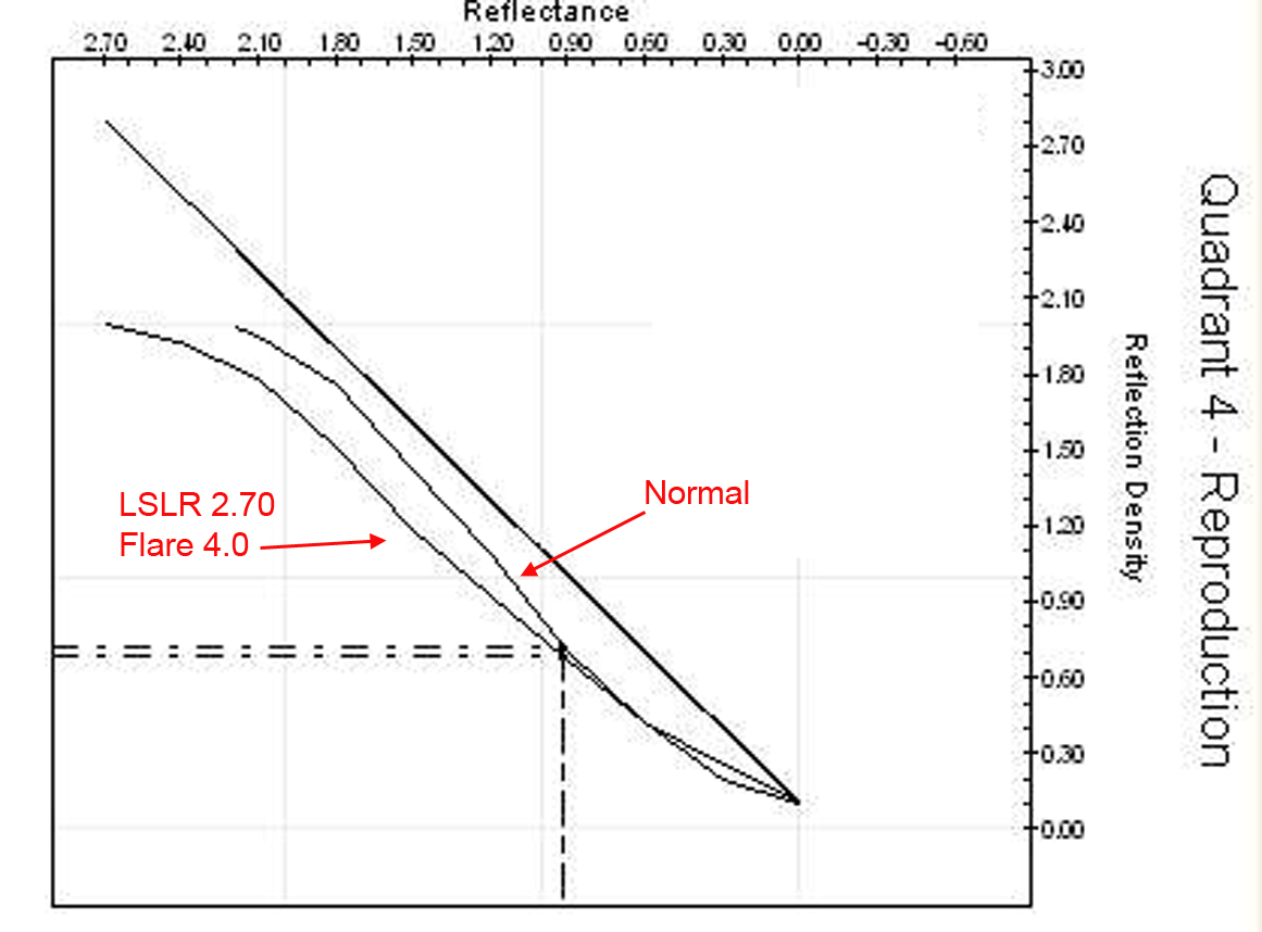

In the example below, the two tone reproduction curves that will give potentially good subjective tone reproduction prints. One can be considered coming from the classic set of conditions, average luminance range, one stop flare, CI 0.56, and a paper LER 1.05. The other is from the same luminance range range, no flare, CI 0.47, and a paper LER of 0.98.

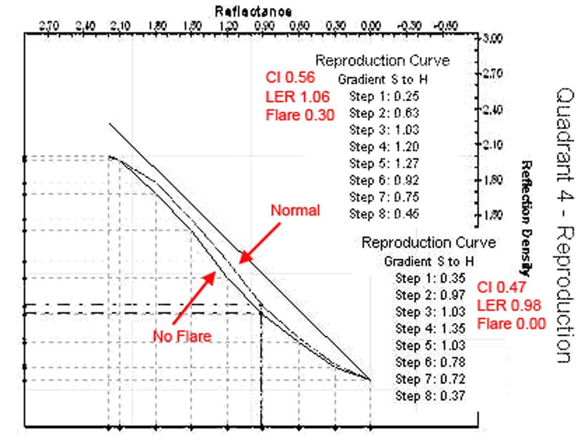

My point is just that the film is only part of the photographic process. The tone reproduction curve in quadrant four takes into consideration paper, exposure, camera image, and the original scene. Below are the two complete tone reproduction diagrams that were use for the example in post #156. I'm going to post another example of a 9 stop luminance range with two stops flare a little later.
...One can be considered coming from the classic set of conditions, average luminance range, one stop flare, CI 0.56, and a paper LER 1.05. The other is from the same luminance range range, no flare, CI 0.47, and a paper LER of 0.98.
So I assume the "non-flare" curve is not realistic?
I have been interested recently in the fourth quadrant curve of the "preferred" curve - that the 45-degree angle perfect curve is actually not attractive and there is a curve that is psychologically preferred. You may have shown that in recent posts? As I recall it is up and to the right of the 45-degree line but similar to your "normal" curve here. Is that right?

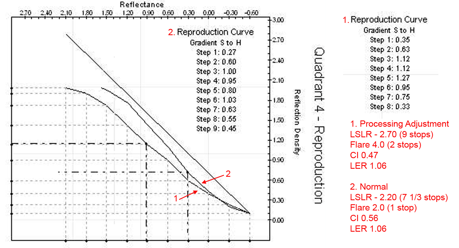

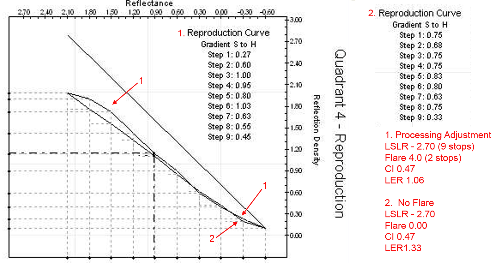

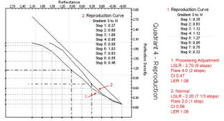

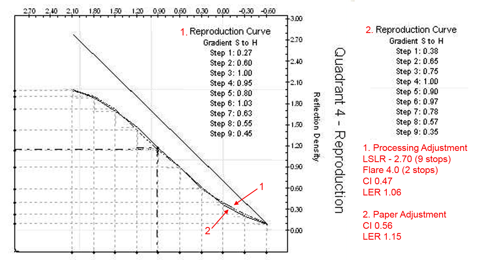

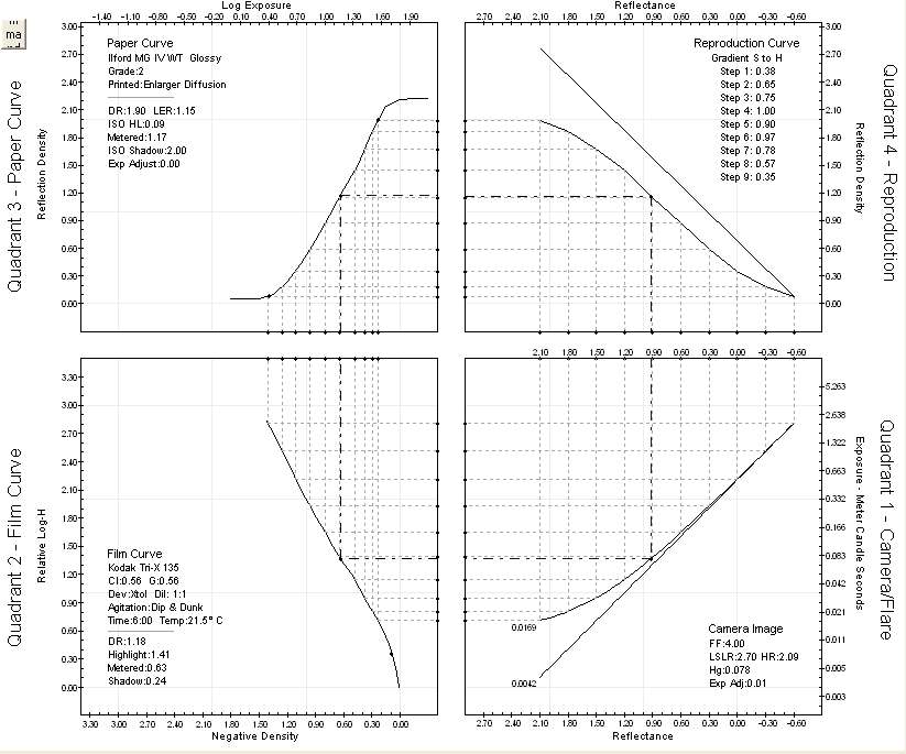

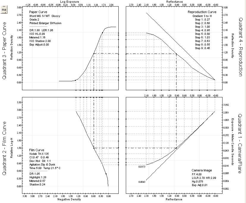

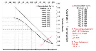

Here are three more tone reproduction curve comparisons. They are:
Comparing Film Processing Adjustment and Paper Contrast Adjustment
LSLR: 2.70 (9 stops)
Flare: 4.0 (2 stops)
Exposure Range: 2.10

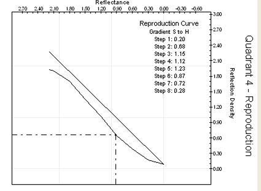

Comparing Film Processing Adjustment and Film and Paper Adjustment with a No Flare Curve
Exposure Range for 4.0 flare: 2.10
Exposure Range for zero flare: 2.70
Comparing Statistical Normal Conditions with Film Processing Adjustment Example
Exposure Range (2.10)
A few quick things to point out. Two stops of flare for a 9 stop scene is higher than normally is found with that luminance range, but it is not unusual. The two stops of flare brings the effective luminance range of the 9 stop scene down to a 7 stop scene at the film plane.
As Normal processing is based on a 6 stop exposure range at the film plane, the film still requires reduced development, but not to the same degree. In this case minus one.
In the third example, the primary difference in the shadow gradient comes more from compressing the 9 stop range down to fit onto the paper compare to the degree of processing required to fit the normal 7 1/3 stop range onto the paper.
Your third example, Comparing Statistical Normal Conditions with Film Processing Adjustment Example, looks like a very clear illustration of what N-2 and N would be. (Plus you've adjusted for flare which I like because it looks like a real world example.).
It's more of a guide for comparison. Yes it would be near impossible to match the values, and you wouldn't want to even if you could. I'll do a post on that later. Maybe in a new thread.

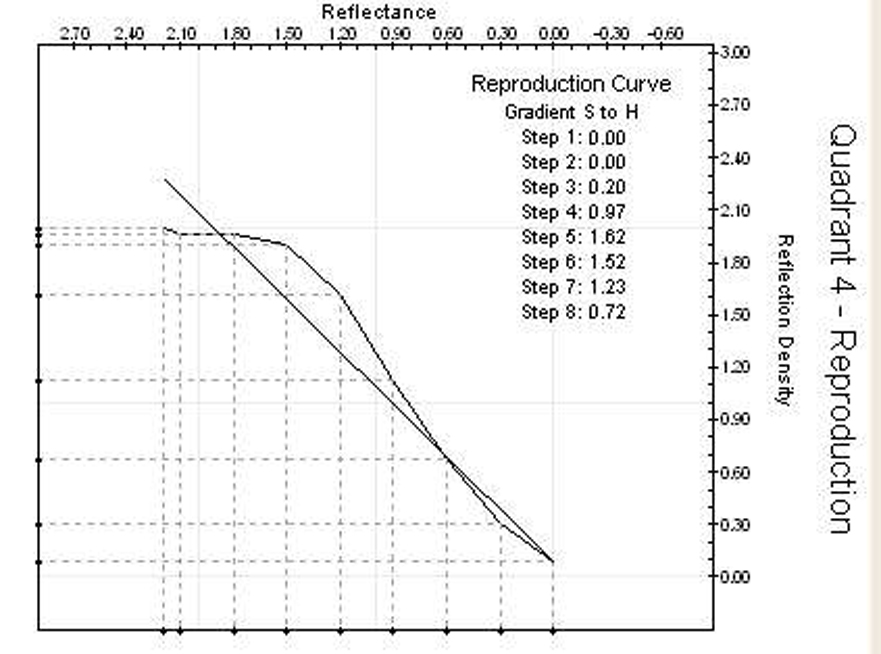

The curve in the normal 4 quadrant is what you want. Lighter than the original scene with a mid-tone gradient slightly higher than the original.
In case you want to see whole thing, here are the two 9 stop 4 quads and the normal one from the examples.
9 Stops 2 stops flare - processing change.jpg 9 Stops 2 stops flare - paper change.jpg Normal four quad.jpg
This is kind of interesting. In normal and nine stop comparison example, I aligned the curves at the highlight. Here is how they look without the adjustment.
Sorry, the example below has the same alignment as the first example of the normal to 9 stop comparison, but instead of readjusting the tone reproduction curves to align them with the highlight, I've adjusted the placement of the 9 stop luminance range so that both examples have the highlight to equal 100%. This way the metered exposure guide (dark dotted line) aligns correctly.
Of all the potential factors that have an influence on the photographic process, the elimination of one would greatly simplify the process and make it fairly straight forward. All you would have to do is match up the negative density range to the paper log exposure range and the final print will match the original scene’s luminance range. That factor is us. How our eye and brain works adds an additional set of rules, variables, and exceptions on top of the simple curves we attempt to interpret. This area of study is subjective tone reproduction. I’ve included an excerpt from The Theory of the Photographic Process.
“The theory of subjective tone reproduction is concerned with the problem of reproducing the brightnesses of the original scene. [Brightness, in the terminology proposed by the Optical Society of America and adopted in this book, is the magnitude of the subjective sensation produced by light and luminance is the magnitude of the stimulus (light)] If the brightness of each point in the illuminated photograph is equal to the brightness of the corresponding point in the original scene, the photograph and its associated illuminance and surround are considered to be a combination that provides exact, subjective tone reproduction.
The achievement of exact reproduction of the scene luminances in an illuminated photograph does not necessarily mean that exact reproduction of the scene brightnesses will be obtained. If the angle subtended by the photograph is the same as that of the scene, and if the field of view surrounding such a photograph contains luminances that place the eye in the same state of adaptation and inhibition that it was in when the original scene was viewed, both exact luminance reproduction and exact brightness reproduction will be realized simultaneously. But the surround luminances that exist in viewing a photograph (as, for example, in viewing a slide transparency projected in a darkened room) are frequently very different than those that existed in viewing the original scene and, hence, the eye is seldom in the same state in the two situations. Very often, therefore, exact luminance reproduction would not produce exact brightness reproduction.
The illuminance on the photograph generally must be greater than that on the original scene if exact luminance reproduction is to be obtained. The reason for this requirement is that the semispecular reflections from shiny objects in the scene, such as hair, eyes, certain areas of the skin, jewelry, certain types of cloth, glassware, ceramics, fur, shiny leaves, rippling water, and many metallic objects, usually have a luminance greater than that of a diffuse white object in the scene. If the diffuse white object were to be recorded at the maximum reflectance of the photographic paper (approximately 90%), the shiny areas of the scene could not be reproduced at the required higher luminances. For true reproduction, therefore, the diffuse white objects in the scene must be recorded at a reflectance less than 90% so that the shiny areas in other objects can be recorded at 90% and thus have a luminance higher than that of the photographic record of the diffuse white objects. If, for example, the diffuse white objects in a living-room scene lighted with 100 foot-candles are reproduced so that they will have a reflectance of 45% in a photographic print and the brighter, semispecular objects are reproduced at a reflectance of 90%, the illuminance on the photograph must be 200, rather than 100, foot-candles. Similarly, the illuminance on a photograph of a sunlit scene must be considerably more than 10,000 foot-candles if exact luminance reproduction is to be achieved.
One of the important problems in photographic tone reproduction is that of reproducing the appearance of average outdoor scenes lighted with sunlight plus skylight. The illuminance on these scenes usually lies between 5000 and 10,000 foot-candles, depending on the angle between the sun and the principal plane of the main subjects in the scene. The photographs of these scenes, however, are usually viewed in homes, offices, classrooms, or art galleries where the illuminance is usually in the neighborhood of 50-100 foot-candles or less. The luminance of a white area in the photograph is then roughly one-hundredth the luminance of the corresponding white area in the sunlit scene; it is, in fact, roughly equal to the luminance of a nearly black object in the scene and yet it appears to be a satisfactory reproduction of a white object! It is only because of the remarkable ability of the eye to compensate for the low level of lighting, by increasing its sensitivity, that photographs can be viewed satisfactorily at the levels of illuminance commonly used in buildings. Exact luminance reproduction of sunlit scenes is not ordinarily attained in viewing photographs and, because of the properties of the eye, it is seldom required for satisfactory subjective tone reproduction.”
“The gradient in the middle tone region was always greater than 1.00 (usually 1.10 – 1.20) for the preferred point of all the scenes studied. Whenever the middle tone gradient was less than 1.10, the prints were unanimously rejected as being “too flat.” Whenever the density level of the prints was great enough so that the curves closely approached the 45-degree reference line, the prints were unanimously rejected because they appeared too dark.”
This should be relatively easy to represent in the fourth quadrant graph... And it would be interesting to see the film and paper curves that contribute to the preferred result.

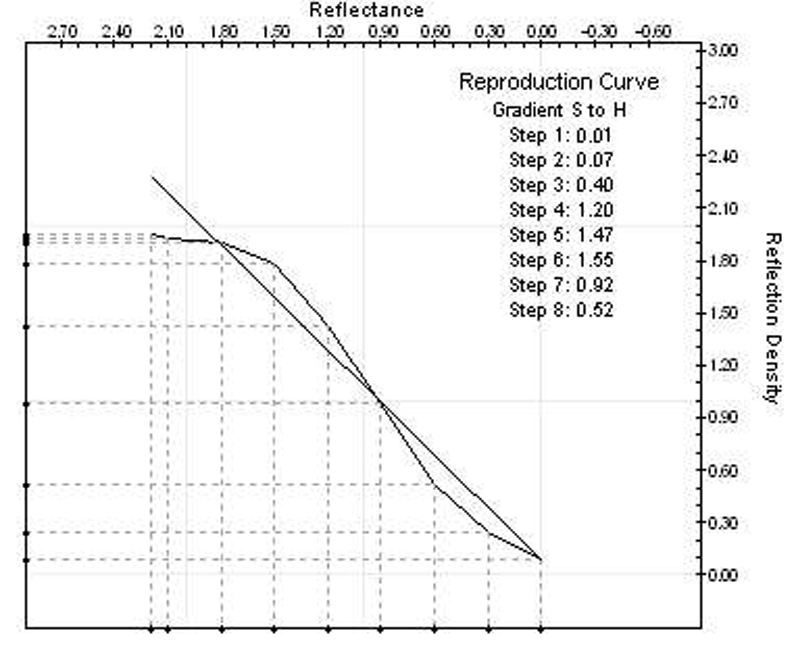

That's the reason why I decided to include the gradient table in the forth quad. Here are some examples going the other way: Normal, plus one, and plus two.
And for those who like to over rate their film. This is a two stop underexposure, with development compensation.
But it really isn't a two stop underexposure because the increase in development will shift the exposure some.
Here's the four quad from Theory of the Photographic Process.
