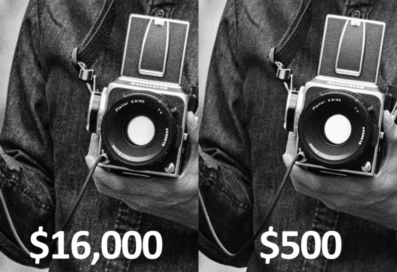

It doesn't at all look like JPEG artifacts (why would you compress the hell out of a scanned image anyway?) and should be the same for the Coolscan image, unless you used very different compression ratios.
Filesize for web. Besides, it's "real world" not pixel peeping evaluation.
You can't discount the poor optics either, or use them as a proxy for a low pass filter.
Why do you say that the V700 has a poor optics ?
The "higher resolution" lens resolves 2900 dpi effective horizontally over a 5.9" scan width, this is 17.110 pixels. You find not many lenses around having the capability to resolve 17000 pix in a row !!!
People stating that the Epson has bad lenses don't know much about glass or about scanners... 170002 is 300MPix in a 5.9" square frame, I can tell you that to resolve that one should use really fine glass working at optimal magnification for the glass.
It's an artifact in the same family as interference patterns.
Sorry, but you are a bit lost... the noise you see in the V700 scans at 6400dpi is mostly from vibrations in the vertical displacement of the carriage, combined with the dual row arrangement in the sensor. Any expert in scanning identifies that at first sight.
No aliasing: zero aliasing in the Epson.
Discounting field curvature
What field curvature?
The V700 lens is optimized for extreme flat field, curvature can be in the film, but not in the lens field. The new ANR holders do ensure film flatness if being careful.
A problem in the Epson is that it covers 5.9" with the lens, even when scanning a single 35mm strip the lens+sensor cover the 4 strips, so lens is x4 times better that what you see.
For this reason the Epson stars for MF and up, being decent for 35mm.
Other scanners have a "zoom system", the Epson avoids the zoom, but the lens works pretty well at it's optimal magnification.
Lenses in the Epson are extremly good, it delivers not more effective dpi performance for 35mm because covering 150mm when scanning a 24mm wide frame, not because the lens has any flaw.
Well, you are doing quite a bit of pixel peeping in your test already. And there is quite bit if difference between the Coolscan and the Epson.
No one is saying anything about webuse where you're at most going to really ever "need" 8 MP.
It's always about print, and printing medium or large at that.
LOL, Sorry but you are a bit lost... the noise you see in the V700 scans at 6400dpi is mostly from vibrations in the vertical displacement of the carriage, combined with the dual row arrangement in the sensor. Any expert in scanning identifies that at first sight.
Extremely good is very subjective. Can we agree that it's at least worse than the one in most dedicated scanners? Even with perfect focus, it still has a lot of space to cover up to the nearest Nikon or Minolta scanners lenses. And those scanners aren't even that good.
You can say that as much as you want, but there is still amble, and in my eyes irrefutable, evidence of GA in all Epson scans.
Whether it is by vibration and displacement of he carrier, or some other cause (which it looks like to me) makes little difference if that is an unavoidable disadvantage of scanning on the Epson.
57 lppm is pretty piss poor for a lens made to do one thing at a limited aperture with known backlight.

Extremely good is very subjective. Can we agree that they are at least worse than the one in most dedicated scanners? Even with perfect focus it. still has a lot of space to cover up to the nearest Nikon or Minolta scanners lenses. And those scanners aren't even that good.
17000 pixels effective resolved in a 5.9" row of the V700 is not subjective, this IS objective technical information. The nikon 5000 resolves only 3650 efective pixels in the scanned row. Still the 5000 haS a superior dpi effective because the row is 1/6 of the Epson row size.
At 17000 pixels per row the Epson lens can only be very extremly good, if you don't understand that...
The question is at what enlargement you see that noise in a print, for sure at 10x you don't see that noise at all. Of couse the Epson is worse for 35mm than a Coolscan for 30x but absolutely not worse at x10.
Anyway we cannot speak about aliasing when there is no aliasing, but another thing, because such a coarse mistake would discredit what we say.
Do you thing film resolves more ?
TMX (a sharp film) resolves 200lp/mm in 1000:1 contrast but around 60 lp/mm only at low contrast.
1000:1 are 10 stops difference between white an black bars, a situation you never find in real photography at 200cycles/mm on film, at the end system resolution (film+lens+shake+DOF+etc) usually resolves no more than the Epson, only special shots in the optic lab may resolve more in the negative.

Not hypotetical, me I've tested that 9000dpi effective can be obtained with a DSLR and a reversed lens, the question is how many shots would benefit from (say) better than 3000 effective dpi scanning perfomance. Not many in 35mm ! and almost none MF and up.
Single reason I find to go that high is grain structure depiction...
It's well known fact that you can "get away" with a worse lens the larger the format is. For example a stopped down triplet in front of a 4x5 piece of film, will still kill a Double Gauss of the highest quality on a 135 camera WRT resolution.
Nothing new in that.
You seem caught in a loop of repetition and truisms.
Less resolution is less resolution.
If you want resolution, the Epson is not where to get it.
And stop comparing to the Flextight. That scanner brand was never optimal for either 135 and esp, not for large format.
Not terrible, but not optimal either.
Only if you've sandpapered your corneas. It's horrendously obvious if even the slightest sharpening is applied.
Have you ever seen the MTF curve for a sensor?
For your amusement - see pg. 123 specifically. A collapse to 50% MTF response at only 650ppi is not good by any metric.
Shows why the Epson fails so badly. And why the Coolscans aren't great either.

After (2.5pix radius 50%):
https://www.largeformatphotography....rum-Scanners&p=1479178&viewfull=1#post1479178
No overshot, no problem. Matching results. Note that the other scans came from two Creo and a Scanmate 11000 drum
Don't tell me that you are not able to do that in Ps !!!!! :smile: (also please take this with some humor)
Let me add that at lower dpi radius has to be lower, and other films (E-6, BW) require other settings and may be a bit more difficult to optimize, but please ask if you are not able, I'd be happy to show you how it can be done and what limitations the V850 has, those limitations are not a concern most of the times.
Coolscans are very good, but you should learn that there are several generations, with different collimations (Callier) in the illumination, the ED version is fine.

Discounting field curvature and having an even, clean backlight and spot on focus, you could in theory get better results by just taking snaps of the film with your phone and stitching them.
Absolutely hilarious. This thread is the gift that keeps on giving.
It looks that you may need some teaching about sharpening :smile: :smile: :smile: (please take this with some humor)
Let me show you an easy recipe, for Portra scanned in the Epson at 6400dpi just apply a 2.5pix radius 50% sharpening and you get the same than a Drum scan or Creo high end flatbeds:
Before:
https://www.largeformatphotography....rum-Scanners&p=1479176&viewfull=1#post1479176

Rather than trying to hide behind the most low level of unsharp masking techniques, how about reading that article I linked to & considering its implications for your claims?
Lachlan:
Before:
These are facts, totally trustworthy evidence. No words necessary, just view images.
Any clue about why those image crops do match ?
Lachlan:
Before:
So to be clear, you took Pali's screenshot of those 4 comparisons and sharpened it? You didn't download the original files and look at them?
Have I to guess that you don't understand that side by side ?
Ok, see this one, perhaps there it's better explained: https://petapixel.com/2017/05/01/16000-photo-scanner-vs-500-scanner/
This is the full image
This is a crop of a 1m enlargement, so a 15x enlargement as you see it in the monitor from 6x6:
Yes... the X5 image is a bit better in that 15x enlargement side by side, but a mild sharpening in the Epson image made by me allows a Perfect match:
Try 0.1pix / 56% in the Epson image of the posted crops and you have the same, even at 15x. (Download crops from Petapixel web site)
I understand it perfectly. And the implications it makes about your technical abilities, honesty and understanding. Do you understand this?
Once again, Did you perform that operation on the screenshot or the original files? Do you understand what the implications are of not trying the sharpening operation on the original files?
