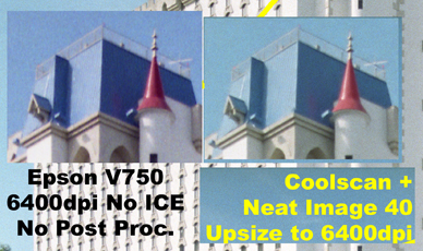

Here's one from Coolscan+Nikonscan compared to Noritsu minilab of the same frame of Kodak Gold 100.
Full res version of Fuji 100 scanned by Epson V700 and Coolscan 5000 http://www.fototime.com/535A4899F477014/orig.jpg
Yes... of course in this case the Epson works worse than the Nikon 5000, because 35mm is the format the Epson makes the worst and slide film is sharp. Instead with Portra and MF result would be mostly equal. The Epson shines the more as the format gets larger.
Probably more important to me is good workflow and color/contrast results in full auto mode. I've scanned tens of thousands of various frames of all types of films with the Coolscan+Nikonscan and only hundreds with the various other scanners. I've never had a bad result from the Coolscan but have encountered many just awful from the others such as this one from Kodak Ektar 100 below.
I also agree, sure that the nikon nails auto exposure. But Frontier and Noritsu have way better Pro image intelligence than the nikons.
Anyway a high quality edition should depart from taking all histogram in 16 bits/channel and manually adjusting curves.
So yes... the Coolscan works better for 35mm than the Epson, specially for slide film, for MF probably we have not much difference, and then the Epson has the advantage that makes 4x5", 5x7" and 8x10" very well while the 9000 only reaches MF.
Not a surprise that the Nikon 5000 is better for 35mm as the scan only covers 24mm when the Epson covers 149.9mm scan width, it's near a miracle that covering x6 more width results are those.

"Real world" test using Fuji 100 color negative and scanned by Epson V700 and Coolscan 5000.
This image perfectly illustrates one of my main gripes with the Epsons (and most consumer scanners really, to a lesser degree though).
Not only is the resolution much lower, than the actual resolving power of the film, which is expectable and something you could learn to live with.
But what is unacceptable, is the false grain structure known as grain aliasing, especially apparent in the sky on this image.
In the rest of the image, it masquerades as false detail., while less noticeable, still contributes very negatively to the overall feeling of the image.
It's a function of on one hand the sensor being too low resolution, and imposing that low resolution regular matrix, on the irregular grain of the film.
But also on the other hand, the lumps can be attributed to a lesser but still significant degree, to the optics being low resolution, and of generally bad quality.
That often results in detail at the edge of resolving power of some lens types, getting what can be described at boost in contrast. Not in a good way though.
This of course also transfers perfectly to any size of film you throw at the scanner since the grain structure and size is much the same.
So all that wonderful detail and smoothness in your medium format and large format shots is going to get tainted with excessive grain, long before the actual resolution limit of the film is reached.
On top of all of the above, I can't be the only one who see clear artefacts of the scanning action of the sensor in the Epsons in the final image. There are clear, what I can only describe as drag marks on the image, noise and other artifacting seems to get smeared across the frame.

Helge, this is totally wrong, you may find other defects in the Epson images but you won't never see aliasing.
First, please review what aliasing is: https://en.wikipedia.org/wiki/Aliasing
Then consider that the Epson is an optically limited system, as it is a 40k pixels sensor covering 5.9" the sampling outresolves the optics by a 2.2x factor, and in that situation aliasing simply is not possible.
Consider what hapens a in a DSLR incorporating a LPOF, in the V700 case the optics works like a ultra strong LPOF cancelling any aliasing.
if you want we may review the math suggested in the wiki article.
Please review the #132.
At 10x the noise in the Epson scan is not seen at all, and beyond 10x the image is soft anyway because film/optics/etc so that noise is only seen in when pixel peeping at not useful image enlargements, so that noise is totally acceptable.
One question... why do you hate the Epson in that way ?
It may not be aliasing, rather it may be compression artefacting from on-board compression in the scanner hardware or shortcomings in the bit depth of the Analogue Digital Converter - which is then all then dumped into a 16-bit tiff container. You have to remember that the usual test threshold that mattered in the mid-90's was making a 250% enlargement at 175lpi - ie 2.5*350ppi = 875ppi, normally from a well exposed 4x5 transparency of very fine grain. At those specifications, compression artefacting etc would be less noticeable because the file at those settings has very little visible granularity - this is the same reason why Netflix etc can claim to stream 4K, but struggles so badly with grainy film and intensely busy action sequences.

I'm perfectly aware of what aliasing is and it's definition.
You might want to look up grain aliasing (<click).
It's an artifact in the same family as interference patterns.
You can't discount the poor optics either, or use them as a proxy for a low pass filter.
Bad optics often come at a price higher than just a lack of resolution and digitally correctable apparitions.
Some of the high frequency information still makes it through the lens. If you are lucky in attenuated/low contrast form (still enough to cause GA), at other frequencies in accentuated untrue form.
You just have to look at the image in the example above, or the many examples in the grain aliasing link, to see this perfectly illustrated.
Discounting field curvature and having an even, clean backlight and spot on focus, you could in theory get better results by just taking snaps of the film with your phone and stitching them.
The image you're referencing shows two things that I'd never try with an Epson: scanning 35mm and scanning with the Epson at 6400dpi, both bad ideas with the Epson as far as I have read, so if the point of the image is to show using probably the wrong tool for the job and using it badly, well job done. :smile: (No offense intended to Les, I think he's just maxing out the machines and showing us what it looks like)
I agree with your point about most consumer scanners showing this behavior and other problems too eventually if you stress them enough.
My question for the scanner experts follows. Take a medium format image, say 6x6 Provia. Scan it like an adult would, after reading the instructions for both the scanner and software and using appropriate settings for the best quality and resolution for each scanner. (In other words don't hobble your scanner by setting it for 10,000dpi if it can only deliver quality at 2,500.) Print the results using the best printer on the best honest to goodness paper. At what size will the quality gap appear on paper between scanners? Specifically I'm referring to normal viewing distances, with the naked eye. No magnifying, No loupes, no friggin' microscopes, just be normal and look at the print.
My gut tells me that up to 15X15" it doesn't matter what scanner you use for medium format because the prints will all be grainless, sharp, and very nice indeed. But maybe I'm wrong. What do the experts think? Could you see the difference at 5x5"? 10x10? 20x20?
Regarding the artifacting in my shot of the Excalibur building, it is likely jpeg/compression artifacting and not intended 1X magnification viewing only. Apologies for not posting this disclaimer.
It doesn't at all look like JPEG artifacts (why would you compress the hell out of a scanned image anyway?) and it should be the same for the Coolscan image, unless you used very different compression ratios.
The lower spec 500 shows the same artifacts. The grain aliasing would be the same for any format.
It's problematic because it makes medium format look like it has more grain than 35mm. It also makes sharpening and other image editing very troublesome.
Bitter experience tells me that you might get what looks like a nice enough 10x10" - until you look at it beside one from a higher end scanner (not a coolscan etc). It's most frustrating when you have a long printing job ahead anyway & you have to add in re-scanning negatives rather than getting on with running what were supposedly supplied as print-ready files.
Yes, very much so!
