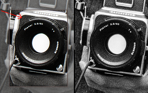

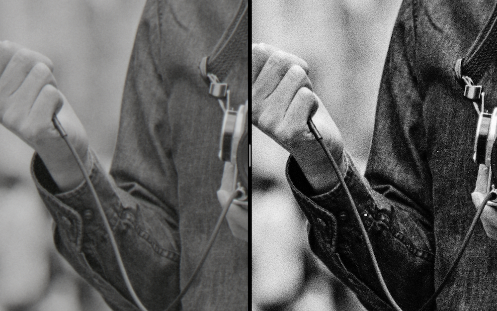

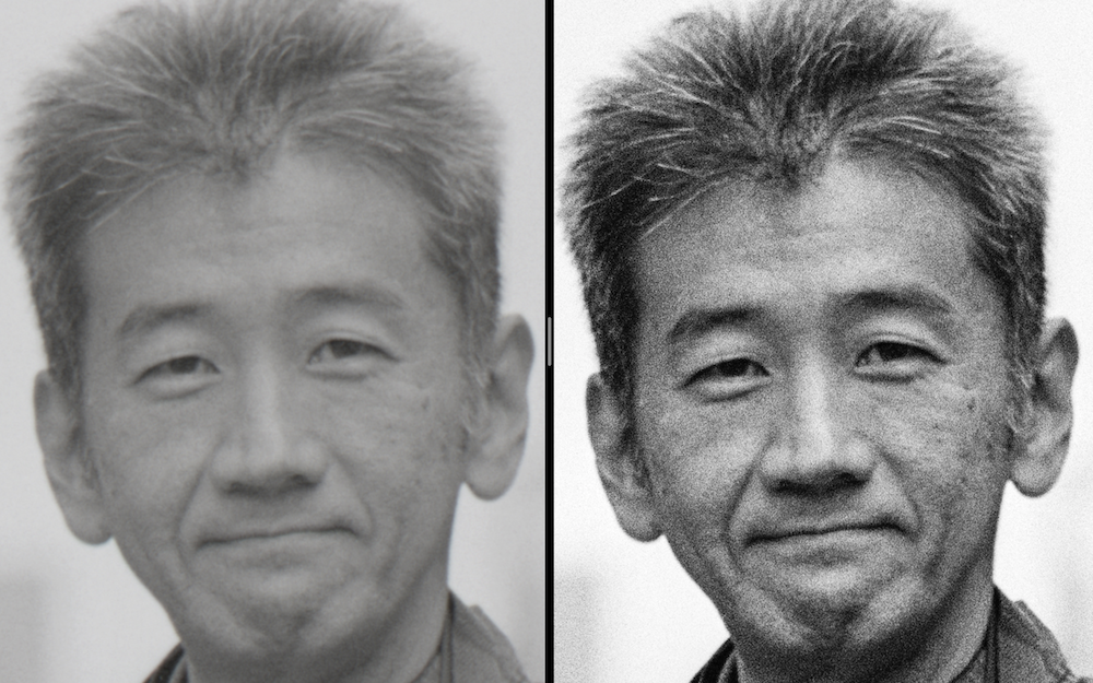

Well, I tried to do some crops that are fairly equal without making it a job, just to show to the casual reader what difference in dataset we are actually talking about.

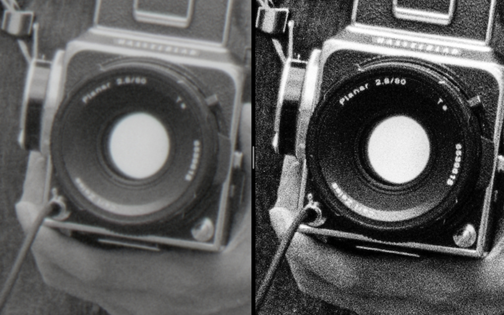

V700 one the left and Flextight on the right.
The Flextight obviously has a much better view of the grain, but still doesn't out resolve it. You can see that grain conforms to the pixel matrix in many cases.
There is something awry with both scans. For example, one thing that is immediately noticeable is that the shadow detail is poorer on the Flextight which shouldn't be technically possible.
Of course I had to scale them to upload them, but still I think it shows just how much PP went on and how much detail the sharpening had to infer.
Have a quick look at the original files if you are interested, it is actually fairly interesting.
Now some of the obvious differences is obviously down to contrast/backlight type. But I hope we a familiar enough with those pitfalls here to look through them, and see the real huge difference.

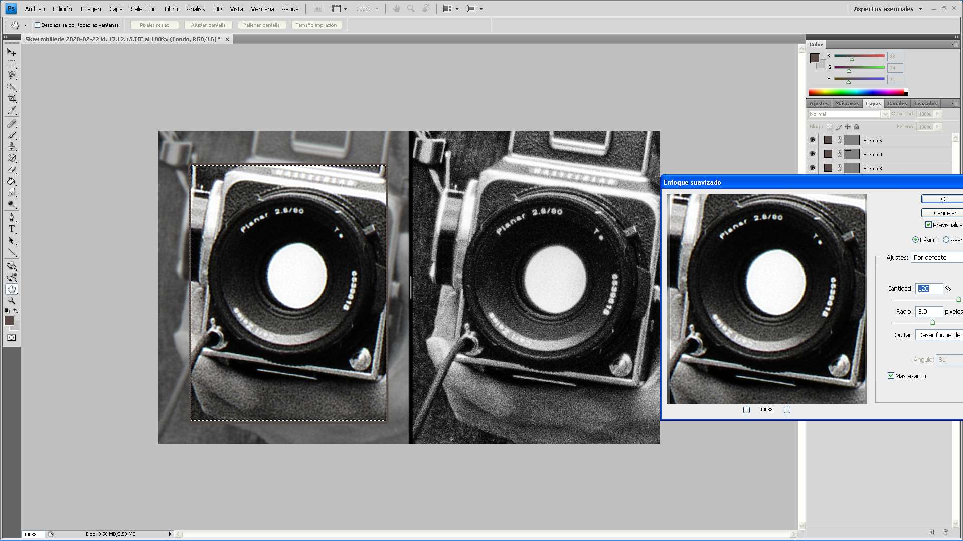

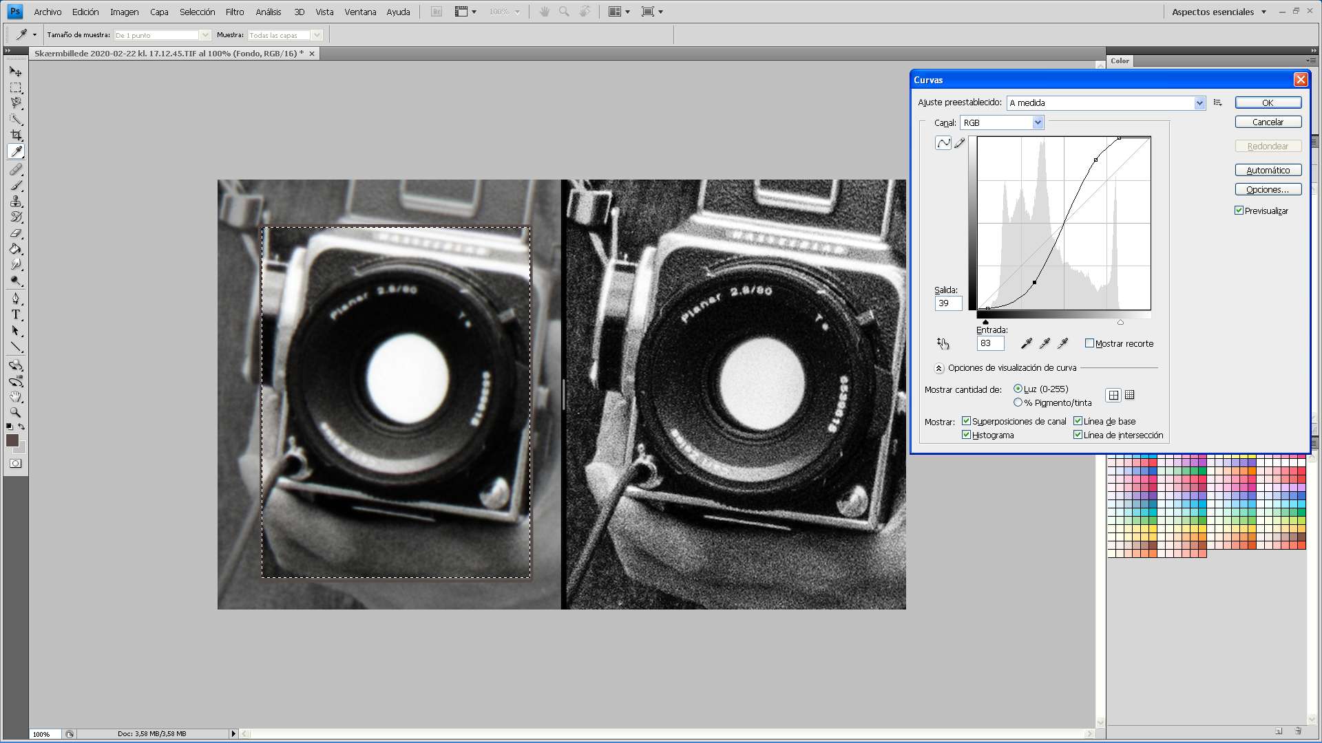

After processing V850 the scan in this way, a curve and a sharpening:
We get this:
Both images are equally sharp but grain depiction is very different at 20x enlargement.... The texture pointed by the red arrow is better in the Epson.

Your condescending assumptions reveal that you haven't looked at what I posted, or ever done the work yourself to any worthwhile extent. If you had, you would know what resolution the Epson file was posted (as opposed to scanned at) at & that my downsample was coincidentally actually closer to the binning ratio you claim than yours would have been.
I based my analysis off using the actual full resolution un-inverted files. Not some load of concocted claims on a screenshot like you so blatantly did. I gave the Epson the best possible chance by downsampling everything else to within its supposed performance envelope and still it failed. If it had been a smooth neutral tone image with fine detail, it would have failed even faster.
That my results don't comply with your silly agendas aren't my problem. The point still stands that the Epson is not up to the job with films below the grain visibility threshold for its optical system and really not up to the job with films above that threshold.
I care about reasonably accurate, sharp representation of the grain and film sharpness characteristics (like in a good darkroom print) - and the Epson cannot deliver it. Period. It is likely because of the severity of the point spread function caused by the method by which it tries to blend the overlapping sensor lines. Because of the sensor shortcomings elsewhere, this cannot be easily corrected for. A pixel shifting CMOS sensor should comfortably outdo the Epson if competently used.
Lachlan, Fact: at 10x from MF the Epson and the X5 shows the same, at 20x the grain looks different but both images are equally sharp.
x10-jpg.240627
x10-jpg.240627
I know what that level of sharpening looks like on a print and it's UGLY. Disgustingly, obviously so. And the X5 scan is still clearly actually resolving better throughout, especially of fine detail. The results of which will be painfully obvious in a print. Quite apart from the X5 scan pretty clearly having been done with the USM still switched on which doesn't help matters.

Well, now that we can exactly match the crops in the monitor you argue that the print would be different... :smile:
I never had a poblem to print nicely those images that look nice in the monitor, you should review your workflow.
OK, I concede that there are nuances, but the Epson makes a close match to the X5 for MF, no doubt.
The funny thing happens in 4x5", while the Epson keeps exactly the same performance than for MF in the X5 case 4x5" performance is the half than in MF. Weren't you aware ?

The Flextight scan is just way too contrasty. Even though you can see the that there is extra detail, it's very hard to bring forward because there simply isn't the tonality.
Did the author bork it on purpose?
