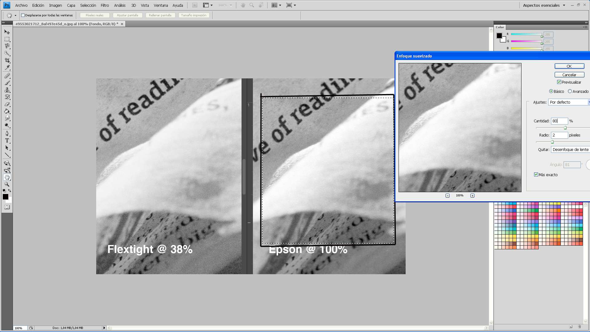

Phil, here are two images that might help. I use MF mainly, and have tried Epson and Flextight. I didn't try anything better than the Flextight as I don't take advantage of the resolution of even the Flextight for most of my work/play so there is no need.
Here's the negative (scanned by me with my Epson V700).
Note that I've left the scan fairly flat here so you can see darker details. The final file was made punchier by the staff at the printer and the prints of this image turned out to my satisfaction.
Next is the comparison image. Note that the Flextight hasn't been downsampled, I just manually zoomed out until the Flextight image was the same size as the Epson, which turned out to be 38%.
Neither image has been sharpened, but I adjusted curves to equalize the images. The Flextight is better to my eye, and of course has resolution to spare. If I needed to print very large then the Flextight is the way to go for me and I'll use it again.
But the Epson scan is 5,300 pixels per side, which is a detailed and sharp 17" print @ 300dpi, and that's sufficient for me 90% of the time.
Hope that helps with your decision.
If you see the Flextight image it has more noise from a digital sharpening (perhaps made automaticly by the machine), in the Epson image I made a mild touch in the curve and a mild sharpening (posted) to end in a neraly perfect match:
The Epson is a great device that in the right hands is able to challenge very expensive machines !!!

Yes I didn't mention the sharpening but of course the Epson (or any scan) would need some before printing. I wasn't aware of sharpening in the Flextight, but I wasn't present when they scanned my negative so maybe you're right. Generally this printer applies sharpening as one of the final steps before printing.
But think that Pro machines may make a really good optimization internally while the Epson delivers a raw image, for a fair comparison both the Flextight and the Epson images have to be both optimized to their best,
The flextight image cannot be sharpened much without having overshot, while the Epson requires that sharpening.
I made that matching with only two clicks, but by spending a bit more effort you get a totally perfect match. This discredits totally those that had been machinegunning the Epson, one said in this thread that the Epson only allows 2x enlargements, well... for MF it allows the same than the Flextight, if anyone has a doubt.

Sorry, but for your MF negative the Epson offers the same quality than the Flextight, after optimizing both images...
I concede that for 35mm the Flextight is way superior to the Epson, but for MF I don't see much a difference, even if pixel peeping.

jawargen made a good v700 scan, Post #109, so with a simple 2pix radius 80% sharpening in Post #110 it practically matches what a high end scanner does.

I only tried Vuescan early on and conducted this test with Kodak 160VC that it has a specific film profile for. I also used the various modifiers from Vuescan compared to a fully automatic scan from Coolscan+Nikonscan.
