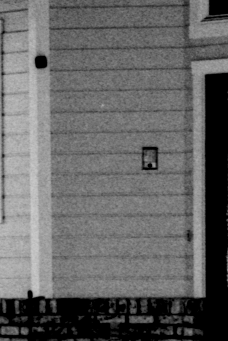

Here's a screenshot of an image from this roll of 35mm FP4+ developed in HC-110 dil. B. Most of the image is of blue siding on a house. The siding is smooth without any noticable texture.
Looks grainy to me, and this isn't a huge blow-up of the image either.
HC-110, DK-50, D-23, D-76 are just the wrong developer to use with 35mm. Learn to handle and use PMK Pyro or Pyrocat-HD and you'll never look back.
@SodaAnt Your question then is about the Epson, not the film or your developer. You need a much higher resolution equipment to be able to evaluate grain. This is a complex technical topic, but TLDR of it is that grain gets digitally boosted and distorted differently at different scanning resolution levels. You are not looking at FP4+ grain. You are looking at an algorithmic output. Tinkering with chemistry is going to be a guessing game.
As your scanning resolution goes up, grain gets finer. I do not have any FP4+ in 35mm, but I shoot Fomapan 100 in that format.

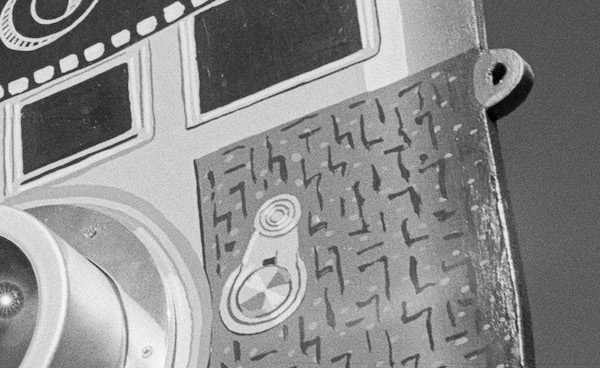

Here's what the full frame looks like:
I did not know what enlargement ratio your image above is, but you said "this is not a huge blowup", so I took the liberty to crop a piece which I would describe as "not a huge blowup":
Scanned at ~5,000dpi. This is Foma in Rodinal and as you can see, the grain is finer. Your bottleneck is not film or the chemistry. It's the Epson. My advice is to bump your scanning resolution.
I scanned that negative at 6400dpi on the Epson. Should I be scanning at a lower res?
I would test the various resolutions and compare them with each other by upsizing and downsizing. You should find out the point of diminishing returns pretty quickly. I’d also test how to remove any scanner sharpening. It usually isn’t very good and may be what’s making the grain appear so harsh.
On my Epson 4870 it never gets better than about 2200dpi so I scan at 2400dpi at the most. And even then it’s nowhere as good as my drum scanner or camera scanning at the same resolution.
Another possibility is you are overexposing the film. That can accentuate the appearance of grain.
The smaller the film, the smaller the sampling size. So the better the scan you need. 35mm film on an amateur flatbed scanner is hardly a diagnostic approach. We end up comparing accidental artifacts instead of anything of substance regarding the film itself.

I tried scanning at 3600dpi and 2400dpi and the grain still looks like the screenshot I posted in post #51.
I agree with your comment about harsh contrast. That's what I see in my negatives also.
You Epson cannot scan at 6400 dpi. Their marketing overstated the specs by a landslide. The true maximum optical resolution of your scanner is somewhere between 2,200 and 2,400dpi, and even that is achievable only after you find the optimal focus distance for the film holder. Moving that DPI slider doesn't do anything useful: it gives you a bigger and blurrier file without any additional detail. When I said "bump your scanning resolution" I meant getting a film scanner suitable for 35mm film, or building a scanning rig based on a digital camera with a good macro lens with a flat focus field.
It is easy to spend a lot of money chasing maximum scanning resolution. I think it's healthy to define what is good enough for your needs. You already dicovered that 2,200 dpi for 35mm is too low for you. But keep in mind that scanning equipment gets progressively more expensive as you go up in resolution and supported formats.
I have found that scanning really accentuates the grain, so not a great way of evaluating the film. The scan process seems to add grain that isn't really there if printed optically.
That is only true when scan is done at low resolution. As you increase scanning resolution, grain appearance begins to approach a wet print, eventually becoming indistinguishable from it depending on magnification. There is, of course, the ever looming variable of scanning skills of an operator, but let's leave this out for scope. But I will say that digital tools, including scanning software, often have the overly aggressive sharpening setting by default, for example.
Soda - It might be fun to compare a semi-thick emulsion grain structure with more depth to it, against a more flat tabular grain structure like TMX. Darkfield is wonderful fun, but not as good when it comes to distinguishing precise edges. But to appreciate grain clustering, you want somewhat lower magnification anyway.
If you’ve got harsh contrast, you have over-developed, and that will make the grain larger and more apparent. No need to blame the film.
I don’t think so. I developed the roll in HC-110 dilution B for 9 minutes at 20C per the Ilford datasheet, agitating per the instructions.
It’s still possible it’s over developed. Try the old test of seeing if you can read a newspaper through the film. You could also send the negative out to be read with a densitometer, have it looked at by someone with experience, or printed in a real darkroom where the could tell you the grade it needed.
The V850 has a maximum actual resolution of about 2300 which is insufficient to resolve the grain. To achieve the 2300 resolution, you'll need to scan at 4800. If you scan at a lower rate, you will not achieve 2300. If you scan at a higher rate, you will not achieve more than 2300. I initially scanned my 35mm negatives using a V700, which has the same resolution as the V850, and was not happy with prints at even 6x (6"x9"). They looked like mush. I got a dedicated film scanner. It has an actual resolution of 4100 and resolves the grain.
