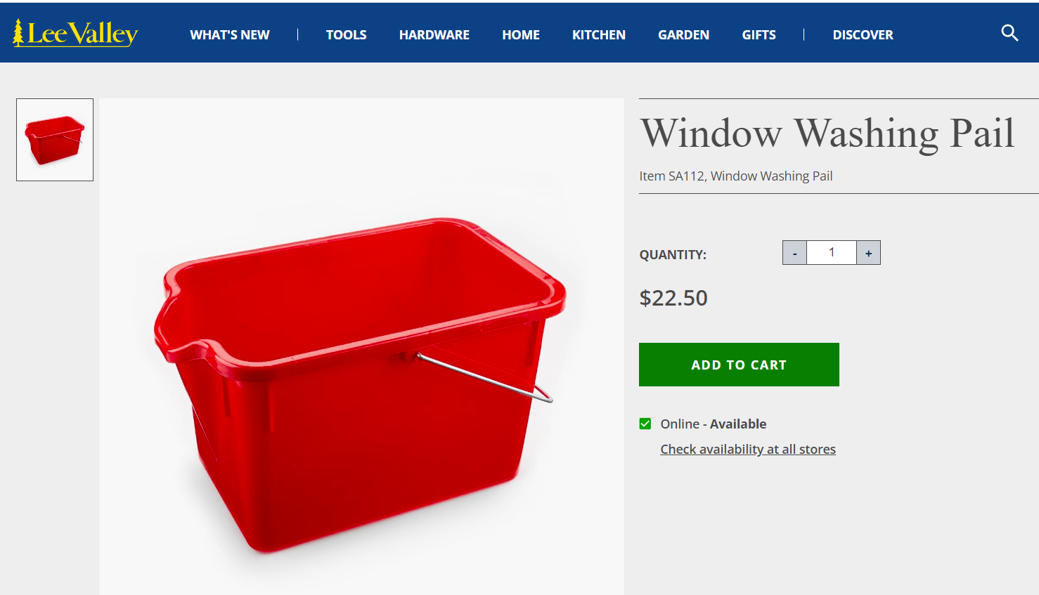

Just so those south of the border don't think it's all Canadian Tire, Tim Hortons & igloos up here, there are other generic hardware outlets. I don't get any pushback from mixing my PF 130 in this:
Sirius Glass
Jan 18, 2007
50,814
Southern California
I use a white paint bucket from a local paint store which I marked for 4 liters and 5 liters with a marking pen.
MattKing
Apr 24, 2005
55,135
Delta, BC Canada
Hey, I would have used an illustration from the Lee Valley website, if I wasn't too cheap to spend that much :smile:
The pour spout does look handy though :smile:
