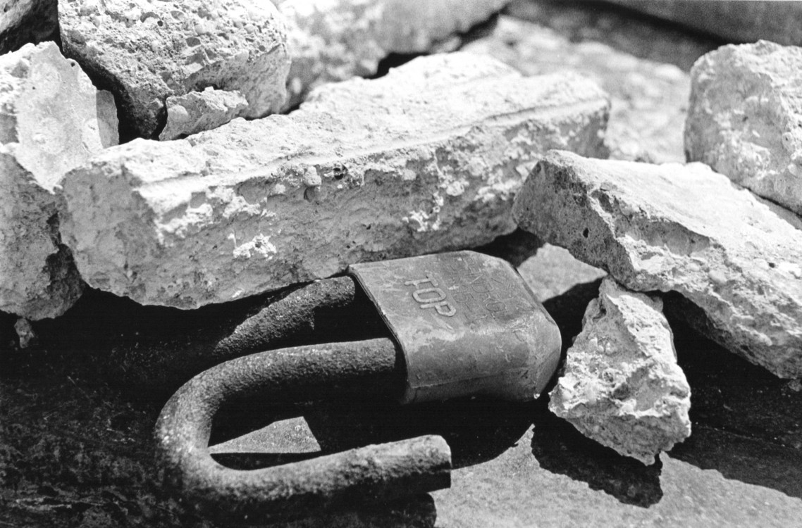

Handheld 35mm Tri-X, scan of 8x10 silver print (it's all about how it's exposed and developed):
Well, yes, you can have Tri-X photographs that don't have conspicuous grain. Development and proper exposure will help, but won't make it a fine grained film. It helps if the image has a lot of texture, which will hide grain, but given some uniform areas, grain will become more visible. If your image looks bland with a normal paper grade and you have to bump contrast, grain will inevitably become more visible. Anyway, I don't exactly disagree with you, but if Tri-X is fine grained, then what would TMax/Delta 100 be?

So "fine grained" isn't the same claim as "no visible grain". Referring back to the image I posted. There are some areas with little or no texture - the top of the lock, the out of focus areas upper center right. You can see some grain there, but it's not really visually distracting.
The reason exposure matters is that it's one of the components that drive contrast. As you point out, having to bump contrast can exaggerate grain. But, similarly, how you develop matters a lot too. Tri-X in ordinary development schemes can show pronounced grain. In this case, a very long, dilute development with few agitations kept the grain under control.
ASIDE: Note that the image I posted was from a straight scan of an 8x10 silver print. The only post scan manipulation was to try and match the densities of the scan to the print as best as I could. There is no further image fiddling. With more digital fiddling, much of the grain, lack of DOF, and so on in this image could be re-rendered to look nearly perfect.
