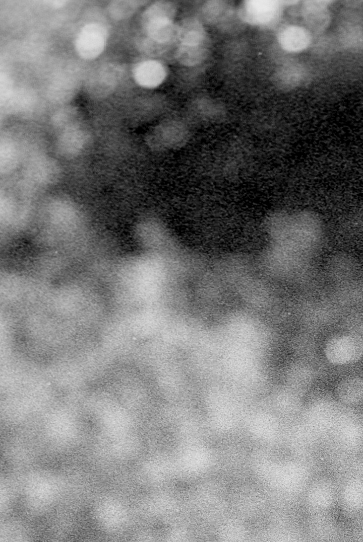

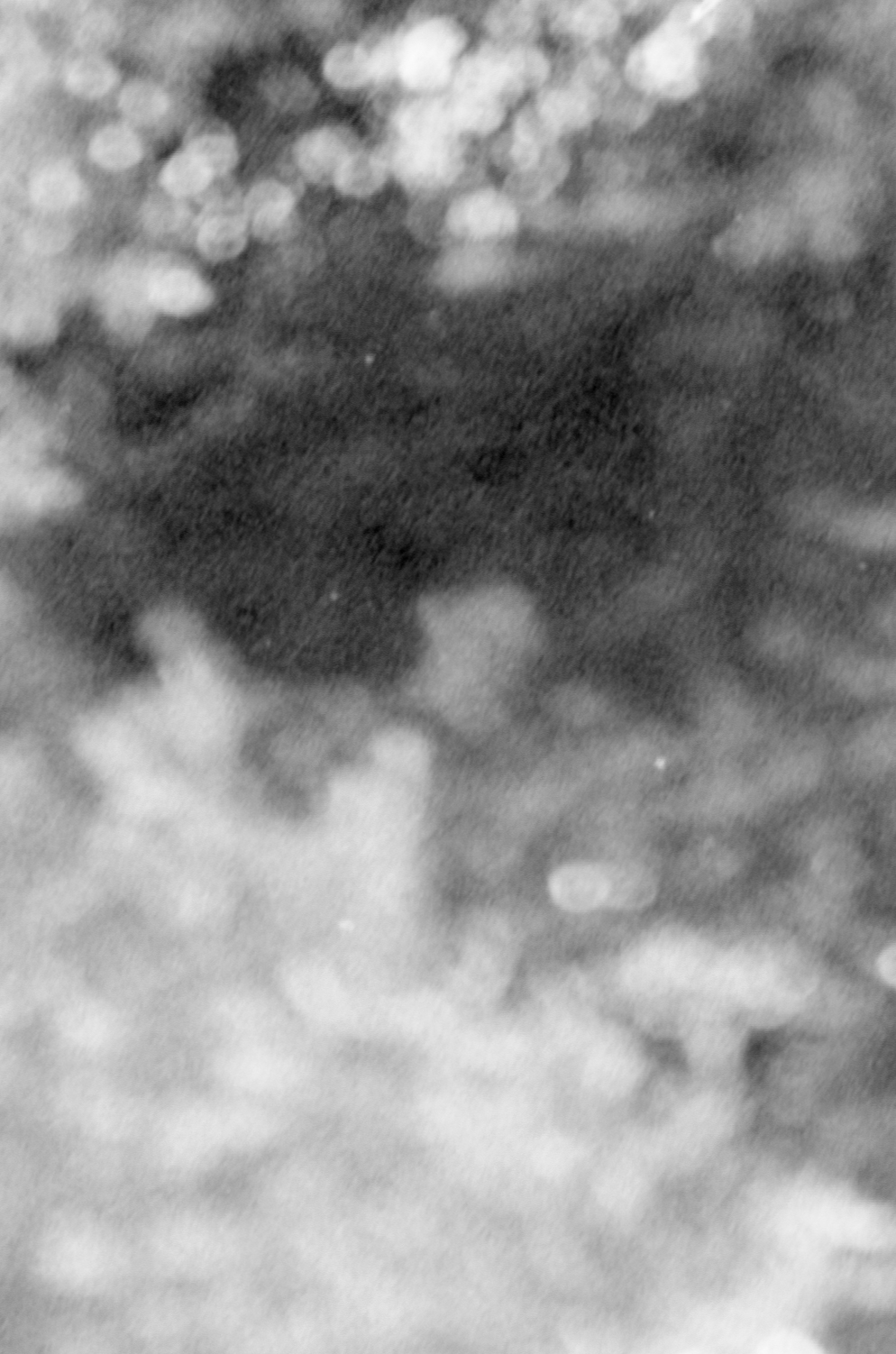

We the OP means is imho not about film and development but about scanning with a flatbed scanner.
i made 2 quick scans, one with an Epson 850, one with a Minolta 5400. What you see is a 40x enlargement of an fp4+ negative. It’s part of the unsharp background, to see more grain. Not a very scientific test, but I hope you see what I mean.
