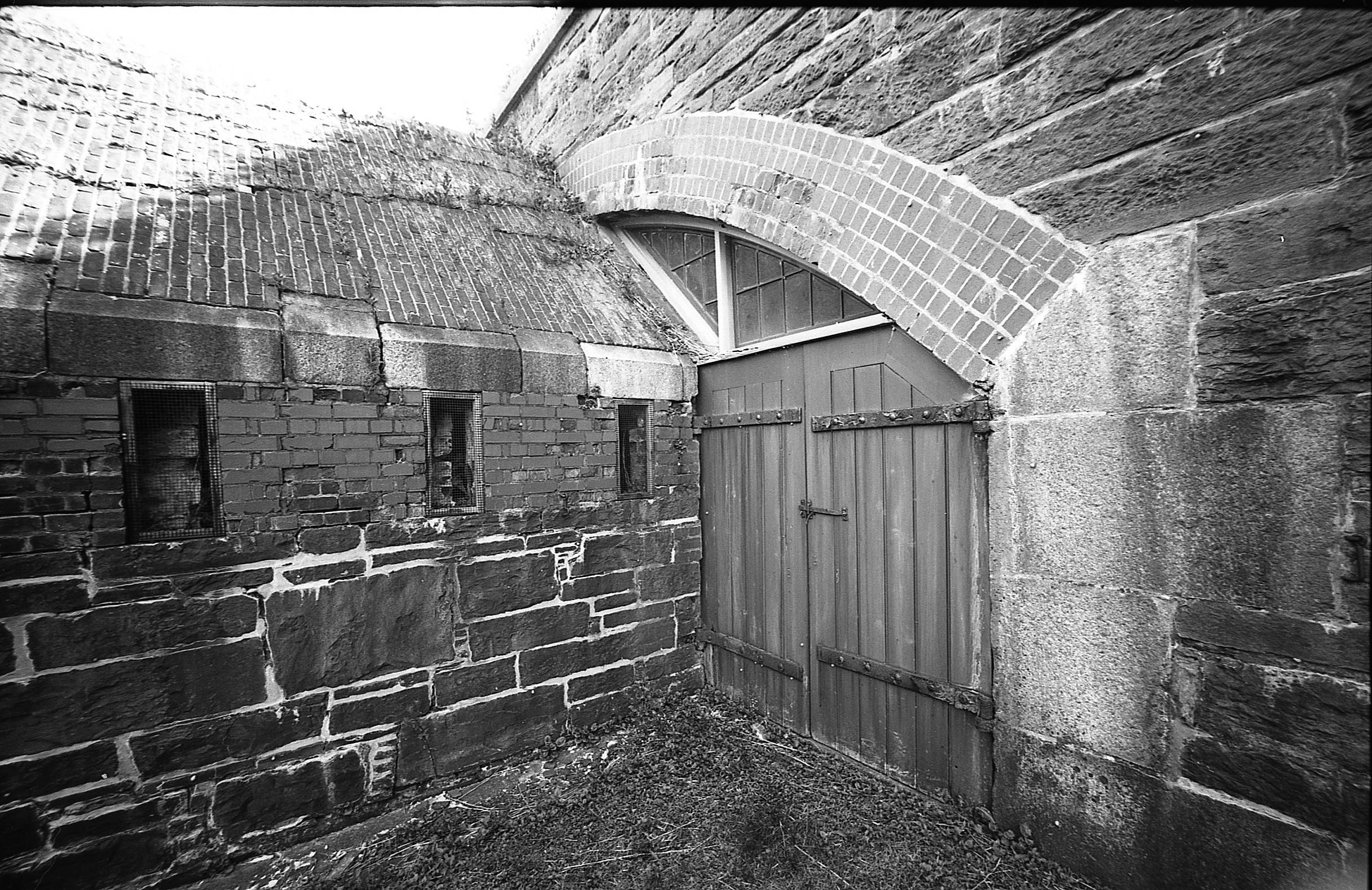

Shot at box speed. Developed in D76 1:1 at 20c for 13 min, small tank with 5 agitations every 30 seconds.

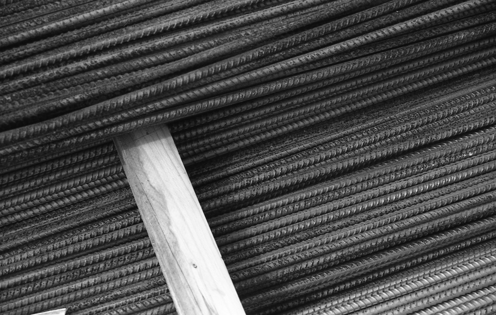

Black rebar with yellow markings

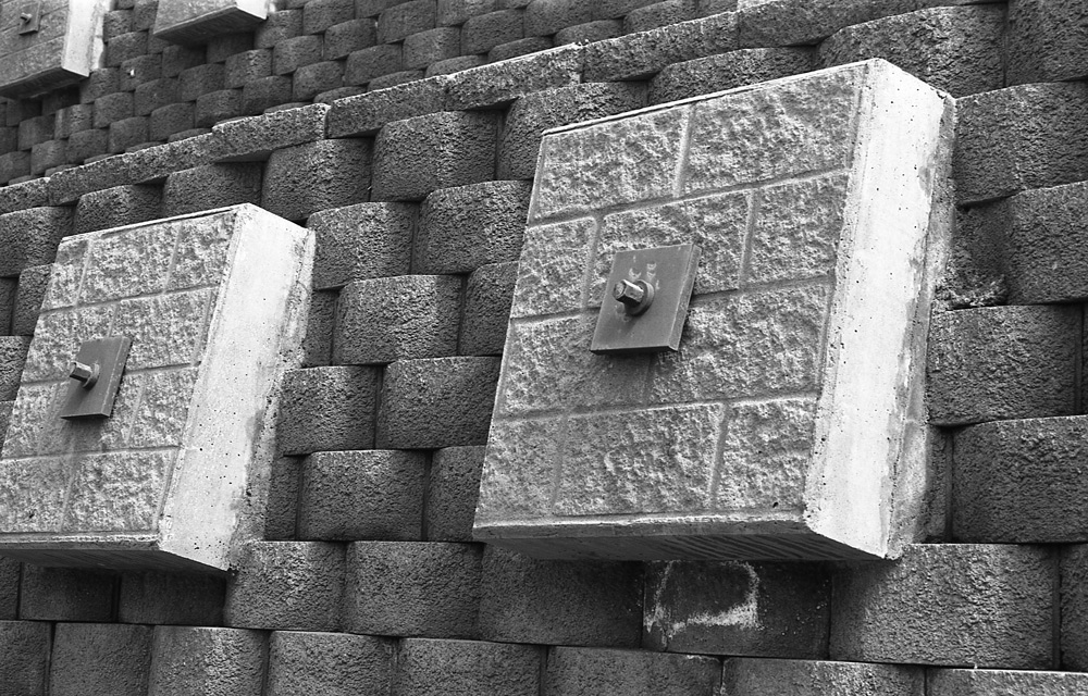

Typical American red landscape blocks.

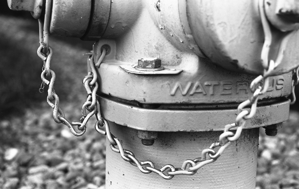

Yellow hydrant.

"Shot at box speed. Developed in D76 1:1 at 20c for 13 min, small tank with 5 agitations every 30 seconds"
"Shot on Sunday. EI of 80. Developed in D-76 for 7 minutes at 68 degrees, agitation ten times/ minute. Incident might meter"
Does this seem strange? could it be a different dilution?
Both look great, just wondering
I believe one is D76 1:1 and the other is D76 stock solution. Yes, different dilutions.

I think you're right. The highlights on the sides of the big square blocks don't look as blown out. The hydrant chains have more detail. Overall, I think all 3 are a bit darker.
