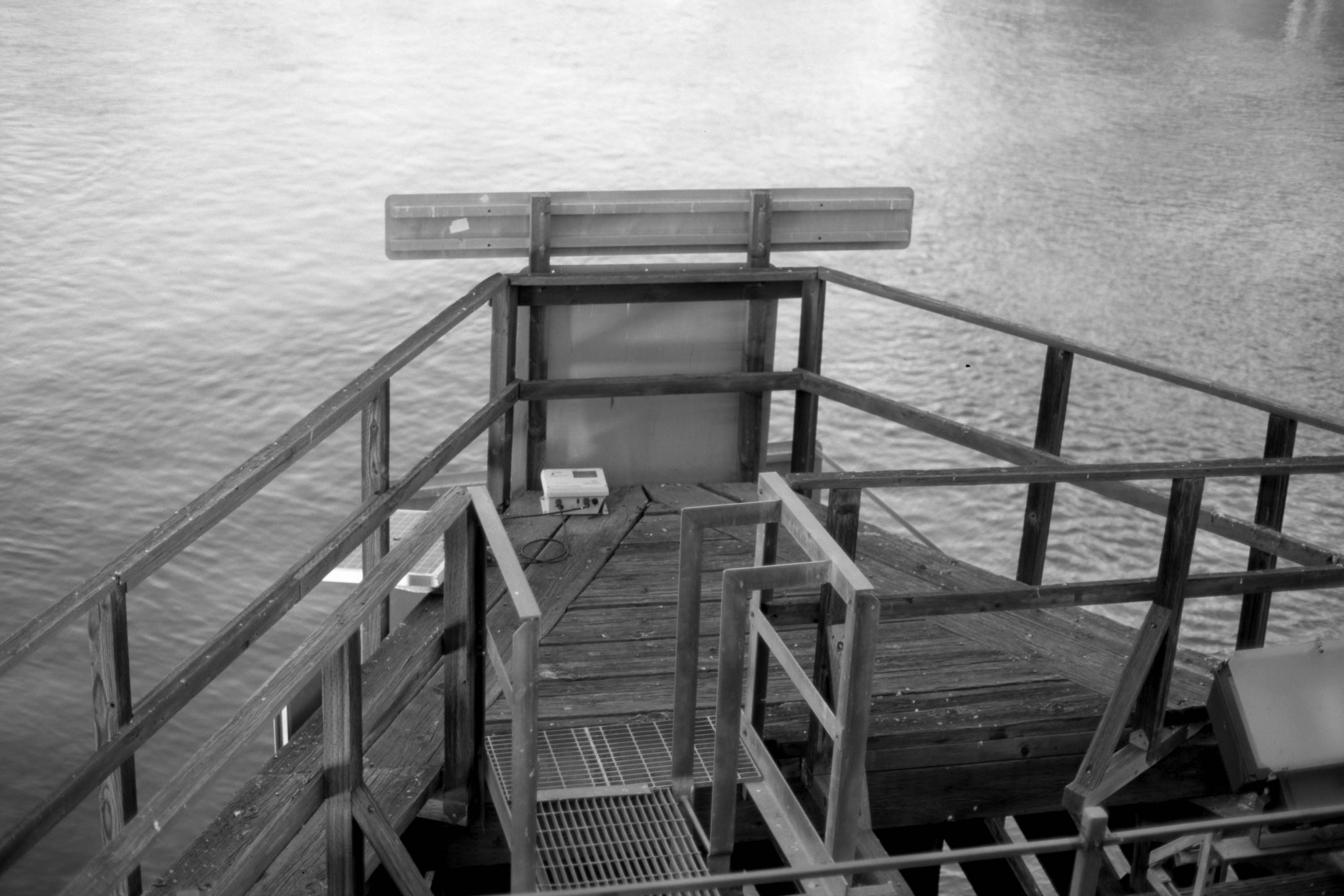

These photos were processed in a rondinax 35u, using the default jerk motion on the rotary knob every 2 seconds. The developer is kodak D-96.
With all these different developers, I would have rather had the P30alpha sent in rolls of 10 as opposed to 36 for easier testing.

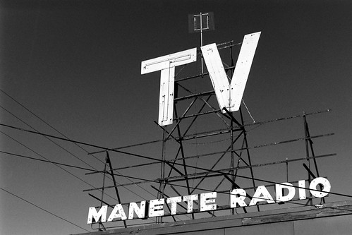

These were developed in Rodinal 1:50 for 8 minutes. I didn't realize they changed the recommended development time to 14 minutes, I'll try that on the next roll.

None of my business really but if this is what you get on 8 mins and this especially applies to the TV picture which is really good, I'd be sceptical if another 6 mins which is 75% more development time can improve on this.

I'd agree with PE here - your first shot doesn't show any signs of being underdeveloped. Good dense highlights and you can see plenty of detail in the letters. Very typical of what I've seen with P30 so far. Second example is tougher to determine as most of the highlight is blank sky area. Most other 100 speed films I develop in Rodinal 1:50 are usually between 11 and 15 mins (Acros 100, TMax100), so 14 mins SHOULD seem reasonable for P30 at ISO 80. You sure you only developed for 8 mins? Was your developer temp around 20C?
