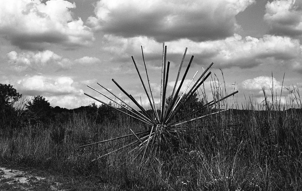

I just finished scanning the second roll. I made some D-96 and processed in a Rondinax, 8 minutes continuous agitation, water stop, TF-4 fix 4 minutes, dry in a long, enclosed suit rack.
These are then scanned in a Pakon F135 to raw, converted to 16 bit tiff, inverted using colorperfect monochrome mode and a medium contrast curve is applied in photoshop. Lightroom for catalog, sharpening is 25/1.0/25/50. I didn't do anything like dust removal or excessive cropping. I lost a few shots because my F4 EL button got stuck in the on position while shooting and I didn't notice for a few shots.
All shots using Nikkor 50mm f/1.4 AI-S, 28mm f/2.8 AI-S, 105mm f/2.5 AI-S, 60mm Micro and Nikkor 80-200mm f/2.8D.

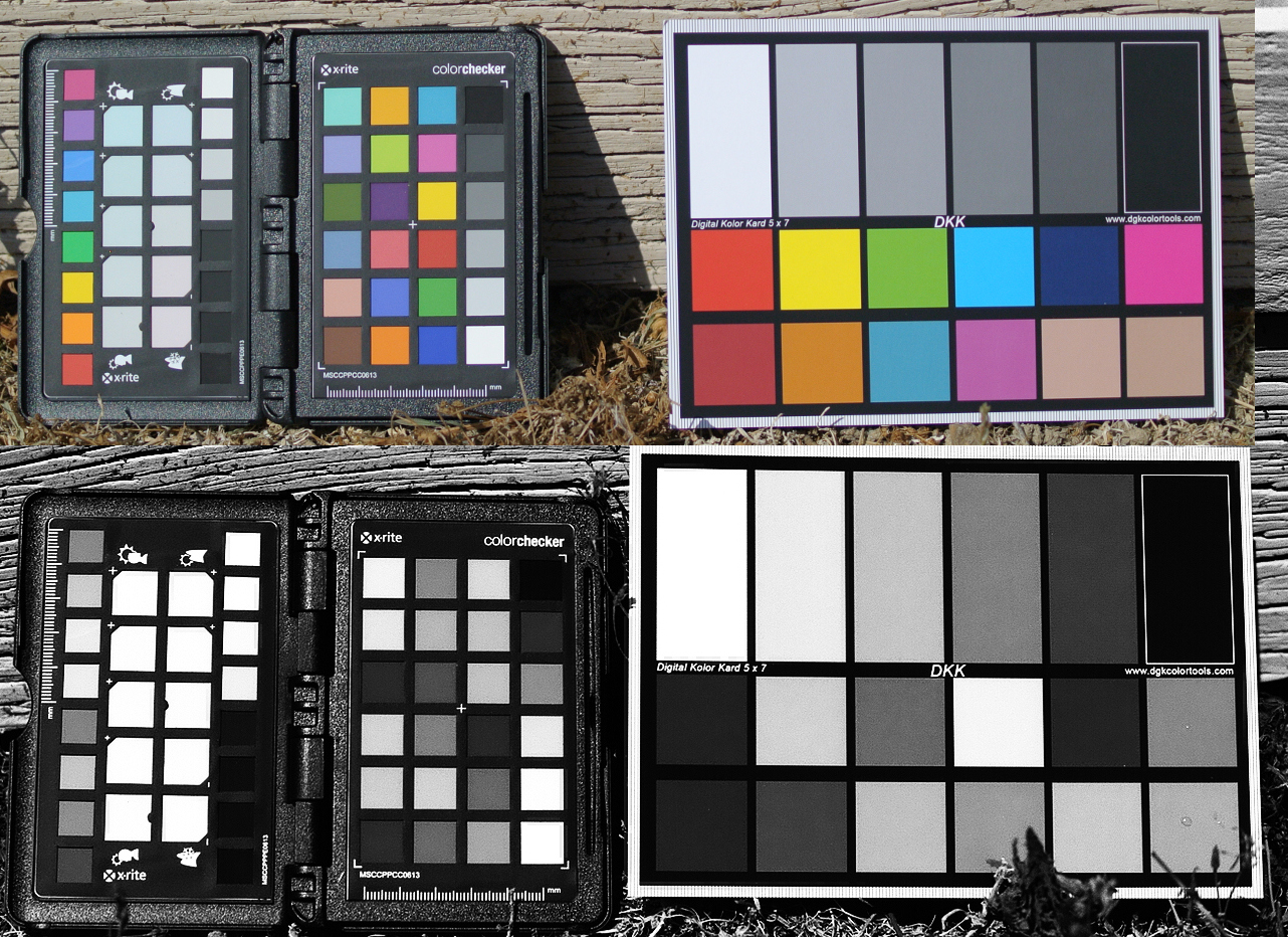

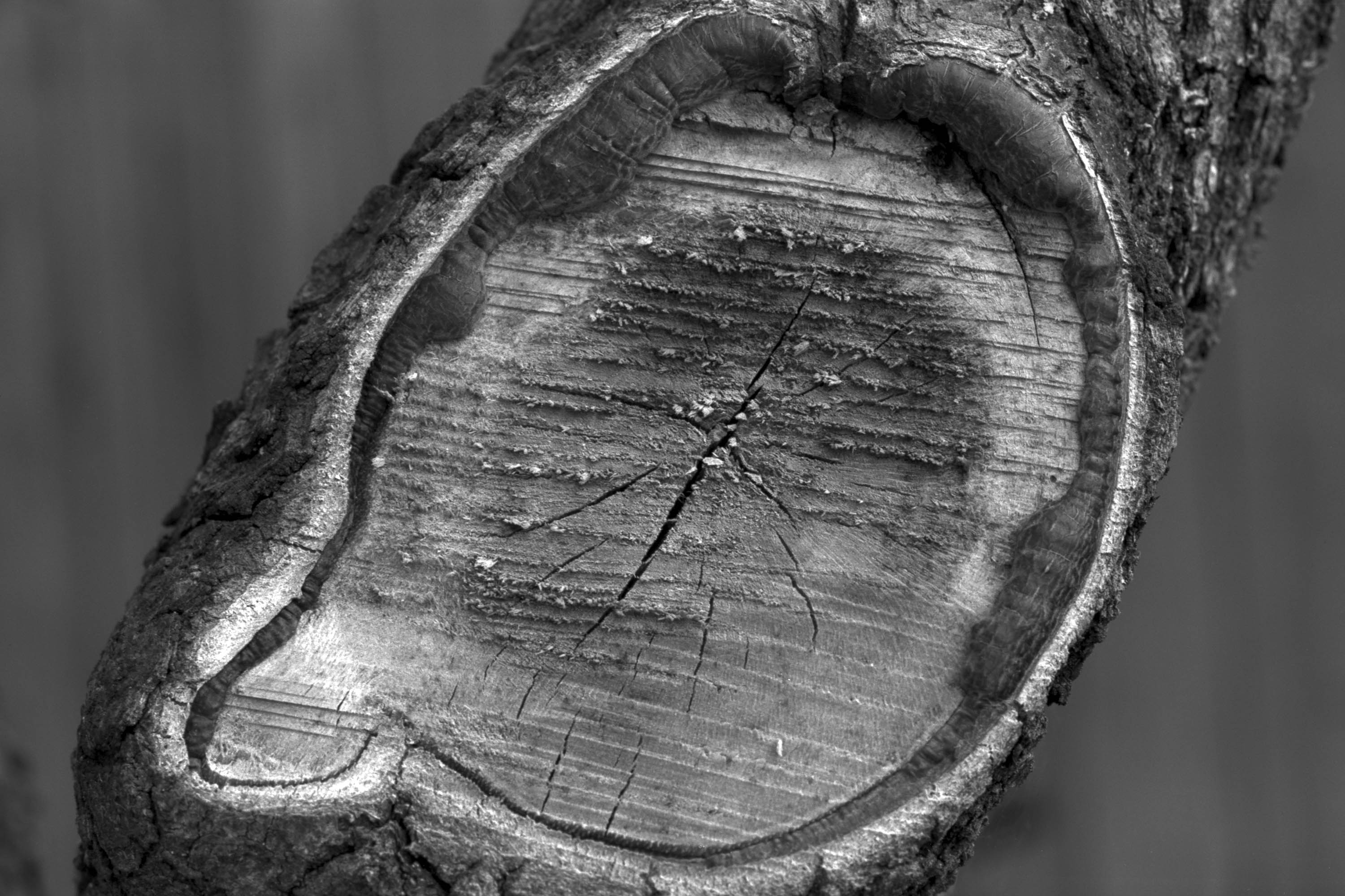

Here is a colorchart and one sample. I don't want to spam this feed, so I'll put the link to the flickr album for these.
https://www.flickr.com/photos/thekurgan/albums/72157683560148332
All-in-all, I like the way the negatives look, not thin, but not too dense. I do some macro photography and go to car shows so I got good practice with this film for those as well.
Feedback is always welcome and I can send the raw 16 bit tiff if anyone wants to play or get digital/creative with them.

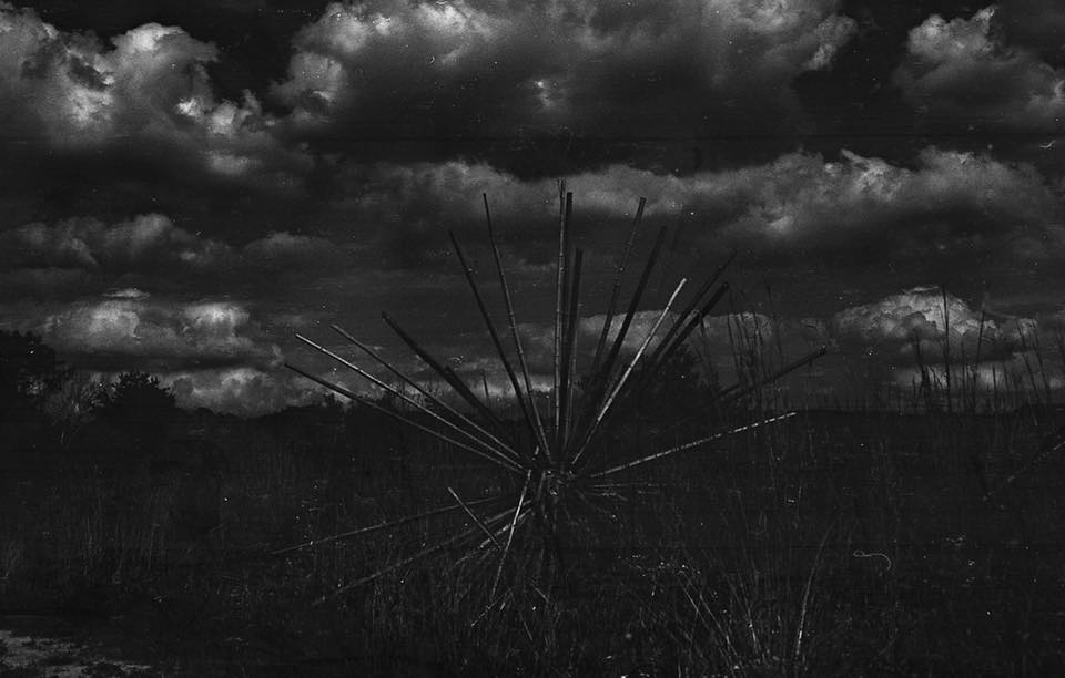

Did a little experimentation in the midst of a roll with deep-green and red filters. Not sure if the Red is a flawed exposure time or not, but will definitely try this experiment again on the next roll.
Pardon the dust on the last image scan - negative was very dim.

How were you metering these? It seems odd that your foliage would be darker with a green filter.
Meyer Trioplan
Nov 28, 2014
248
Frederick MD
TTL Metering. That said, I'm also not sure the scanning didn't try to compensate. There was no post processing done after the scans.
On the next set, I'll be using an old Altix, so I'll have to compensate manually, and can see what differences might exist.

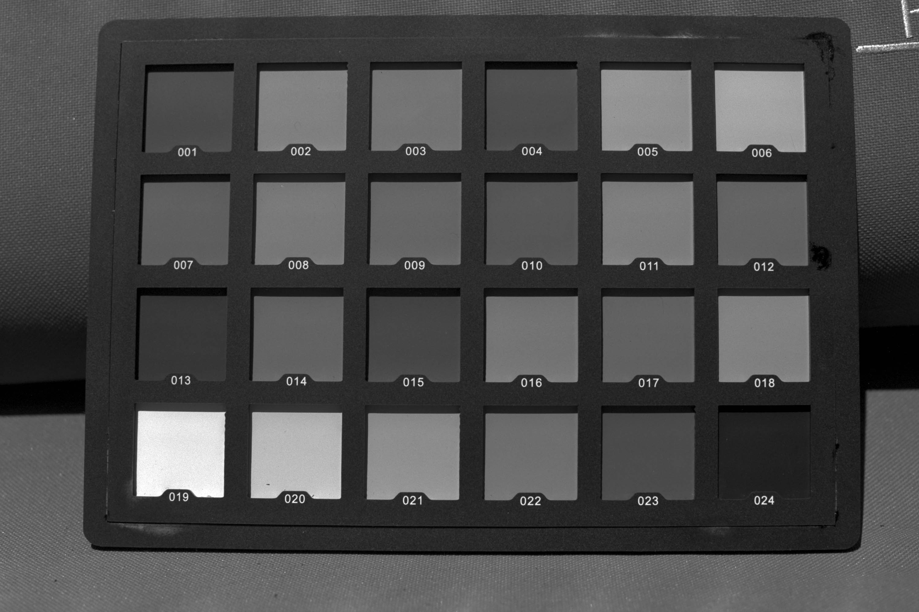

To add to the colour sensitivity debate, here are my shots of some colour charts. Definitely some lack of red sensitivity, and enhanced sensitivity to blue.
Very helpful! The blues really run the gamut on tonality it would appear.
I did a few more experiments yesterday with the Red 25 and Green PO 1 filters using filter factors to compensate, but haven't had the chance to develop them yet. I also have an 80B I need to try at some point for comparison's sake.
When it comes to densitometry discussion, I'm way out of my depth, but the grey response looks off.

As far as spectral sensitivity is concerned many panchromatic films have a slightly reduced red sensitivity. It all has to do with the effectiveness of the red sensitizer(s) used. However this does not make the film any less a parchromatic film.

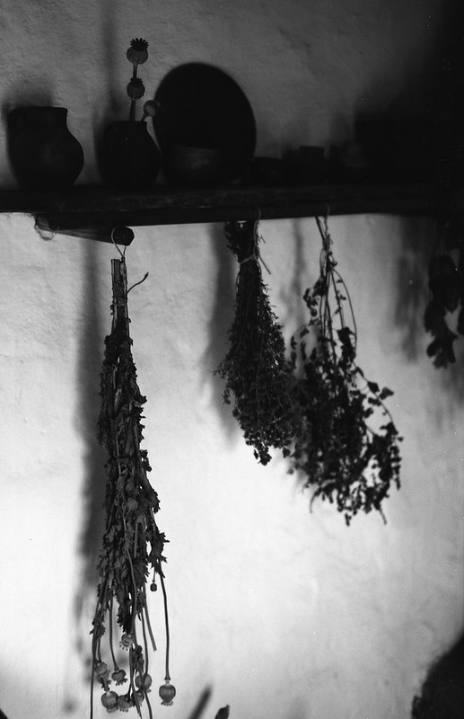

Thank you, at the risk of being tiresome here are a couple more because a point I would like to make is that the impression I have, and this is not criticism it is comment, is that shooters seem to want to "bend" P30 into a "normal" run of the mill film with a look just like Tri-X/FP4+ etc and not embrace the "look" of the film for creative purposes. Now I'm being pretentious attributing this work as creative I know but I knew what the film can do, I know I was in low light, very, and I got what I wanted. Full tonal range here would just not reflect the scenes as I saw them and wanted to show them, I had Acros and FP4+ available in the bag P30 was a creative choice based on its known properties.
Drying Herbs
Child flute player model
Both from the Stilt Village reconstruction museum at Unteruhldingen on M2/Sonnar 50mm Beutler
