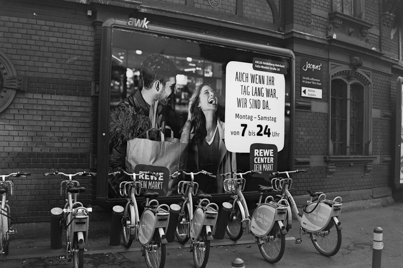

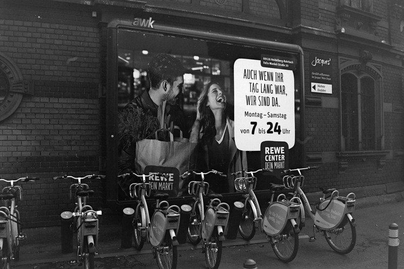

I got 2 P30 films from a friend. This is my 2nd attempt with the rest of the 1st film. Black- and whitepoint were adjusted equally, no further edit. Developed 12 minutes in Caffenol-C-M(rs), this is a rather tame variant: 12 minutes, 20 °C, agitation first 30 seconds, then 3x every minute. Exposure indexes 20, 40, 80, see pics.
The second film will stay untouched.

The recent P30 has a real speed of ISO 20 - 40 imho, see the link above to the densitometric curves or my sample pictures. If you underexpose the film at EI 80, the reds of course are even darker, you can see that also on my sample pics in post #178 and compared to the color pic.
