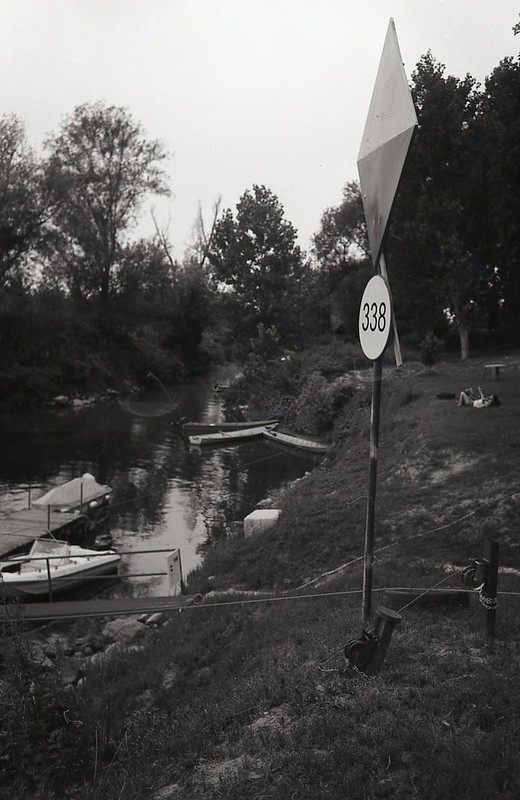

Ferrania P30 @ 80 iso, Adox Adonal 1+80, 16min 30sec, 19 °C.
(Kiev 4A - Jupiter 12 - Sverdlovsk-4) 1/50 - F4 .
I also made some shots with different red objects, but I did not notice anything
insensitivity to this color ... (I will post tonight more shots).
Certainly a particular film, but I'm sure the negs are easily printable.

The example of a red house on a sign #102 looks to be pretty convincing proof that P30 does have a very low sensitivity to red. Later another poster refers to it as orthochromatic but I have also seen the word panchromatic being used to describe it. Your post suggests that it isn't insensitive to red and you have evidence of this in the form of shots with red objects. It would help if we can see those. Thanks
So, what is the truth here? Presumably there are specs that show its sensitivity to the colour spectrum and it is this that will reveal the truth. Can anyone point me in the right direction?

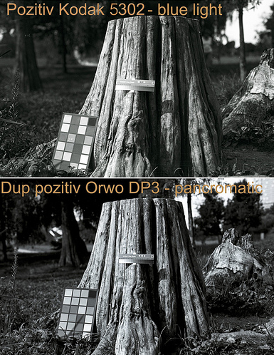

  • comparativ Pozitiv Kodak 5302 (blue light) si Dup pozitiv Orwo DP3 (pancromatic).png

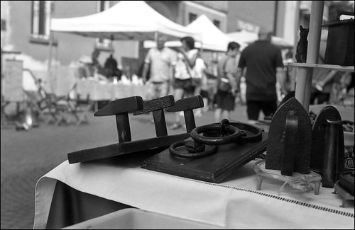

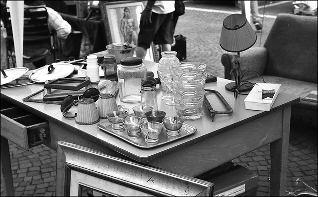

Which objects are red? The ones on the table?
Thanks
pentaxuser

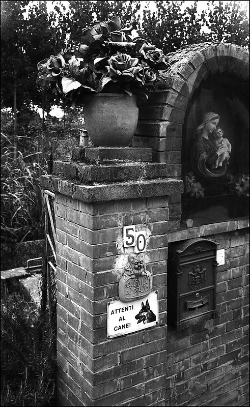

Ciao to all !
In a few hours (09:00 pm clock Italy) attached 3 photos taken deliberately to a red brick wall (old building) and a red brick wall (new construction) the third image is a nautical sign split into two parts; white and a red (Red Ferrari).
I did this test (empirical ?!?!) because I also read of the low sensitivity to red color. I was pleased with the fact that in the shots this situation did not happen. The Italian detractors of this film, have accused the story of Orthochromatism (and other unpleasant accusations) and speed (12iso !!). I did not find anything of this.
Probably because I click with Soviet material ??? Which as we know well, is sensitive to ... red ! :tongue:

Thanks, schyter. It looks to have close to normal sensitivity to red to me from these shots which leaves #102 from Chris Livsey as a puzzle. If this P30 is indeed a replica of 1950s Italian movie film then I'd have thought that such films were in fact panchromatic but short of a graph of its colour sensitivity to colours this is just my opinion.
pentaxuser
