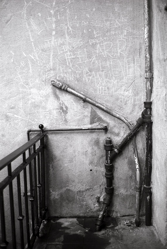

Here's a few from my first roll of P30. Taken with a Nikon F (FTn) and 50/1.4 pre-AI and 35/2 AI lenses. These are scans of the negs, a close approximation of my straight prints at grade #2
Film rated at 80 ISO and developed in D76 full-strength for 9 mins, with 1 inversion per min.
I noticed a different "look" to the negs as soon as I hung them to dry, at least distinctive from what I usually see with Tri-X or HP5. Contact sheets showed relatively high contrast, but didn't necessarily seem to be under or over-exposed.
Personally, I like the look of this film. It seems really punchy, but in wet printing, I have been able to pull detail out of the highlights and hold back the shadows without them getting muddy. I'll try D-76 1:1 for the roll I just finished, then try shooting @ ISO 50 for the next one, as some here have recommended.
