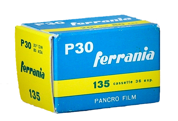

A big difference Petraio Prime P30 is just
"leaned on " original film P30.
Therfore my question to other emulsions
because Ferrania was a european leader
in the early 60th ( absolute hight tech. to that time)
with regards
Herr we got it again (the original)
Source : The online darkroom
with regards
