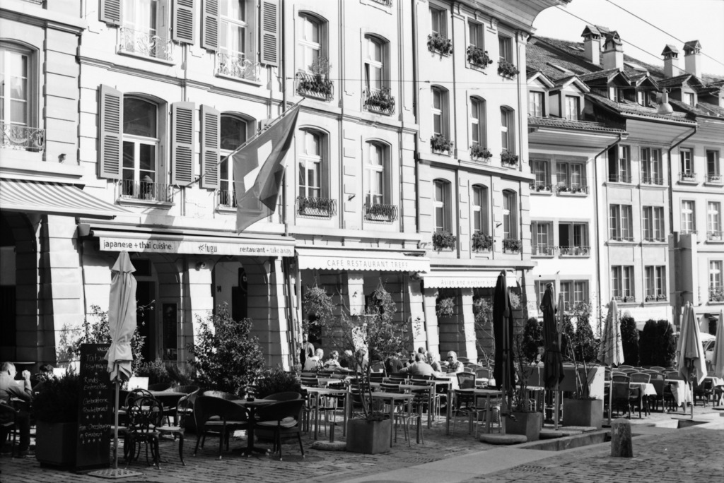

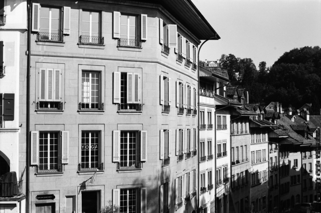

After some experiments, I finally tamed the beast to a tonality of my liking. 25 iso in Beutler for 5 minutes did it. I'm also happy that the Swiss flag did not come black!
