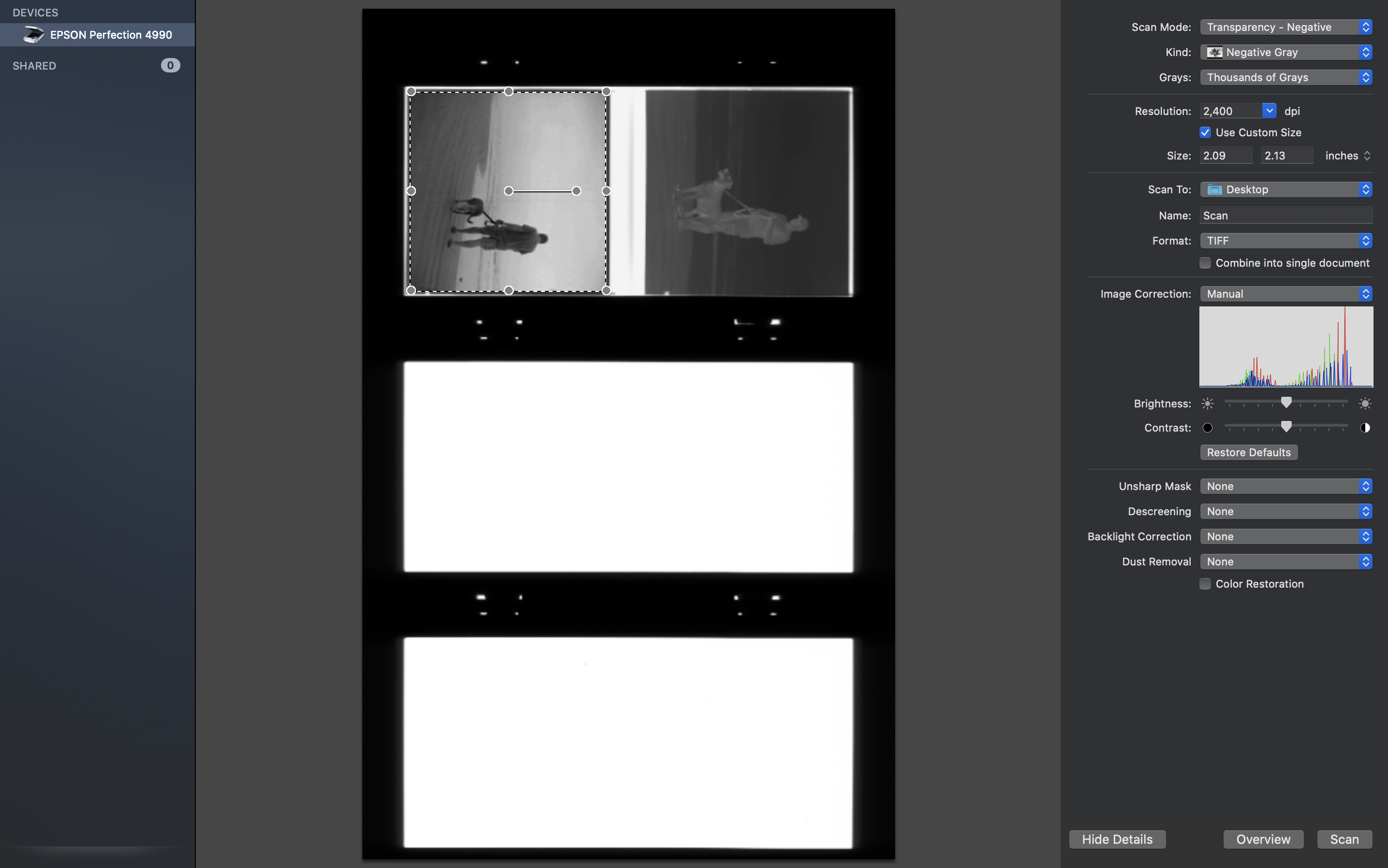

that’s what I thought too, but there aren’t any image editing tools. I’ll post a screenshot of it. It’s basically Epson scan “dumbed down” I think.

This is what Image Capture looks like.
Looks like the majority of the tools in the "Expert" mode of Epson Scan for Windows.

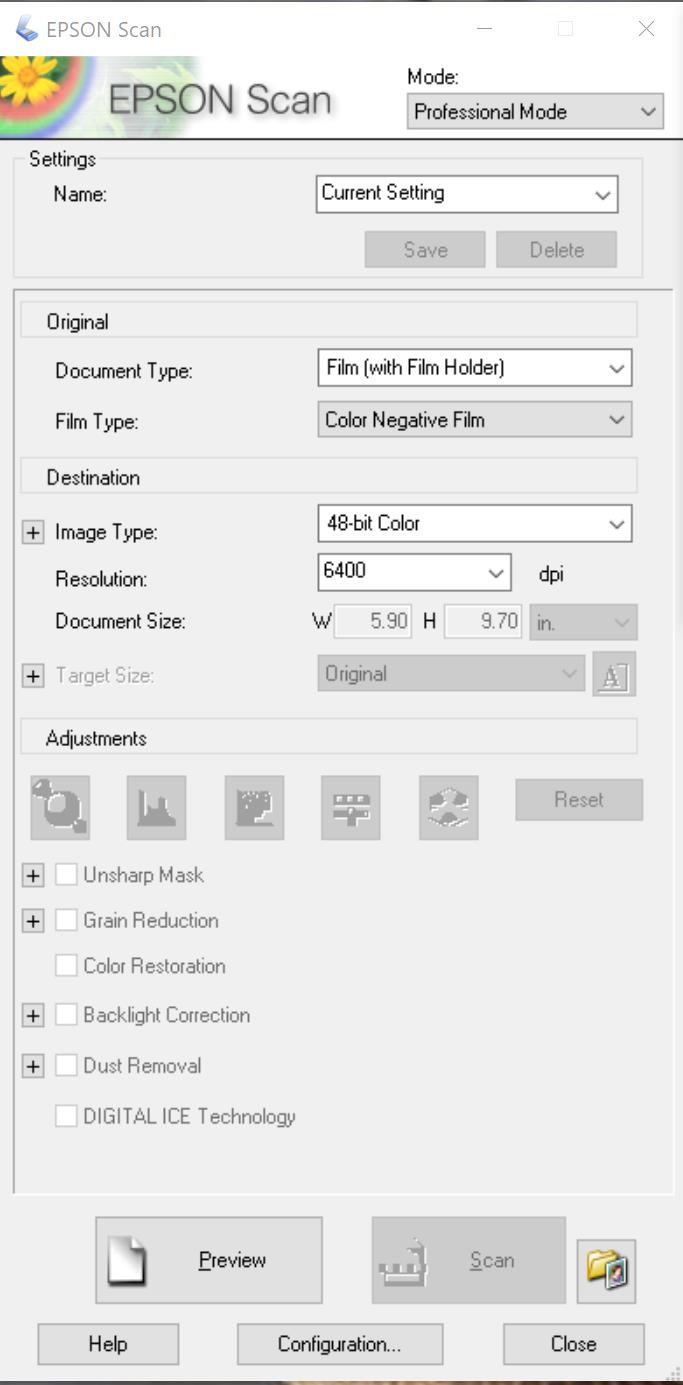

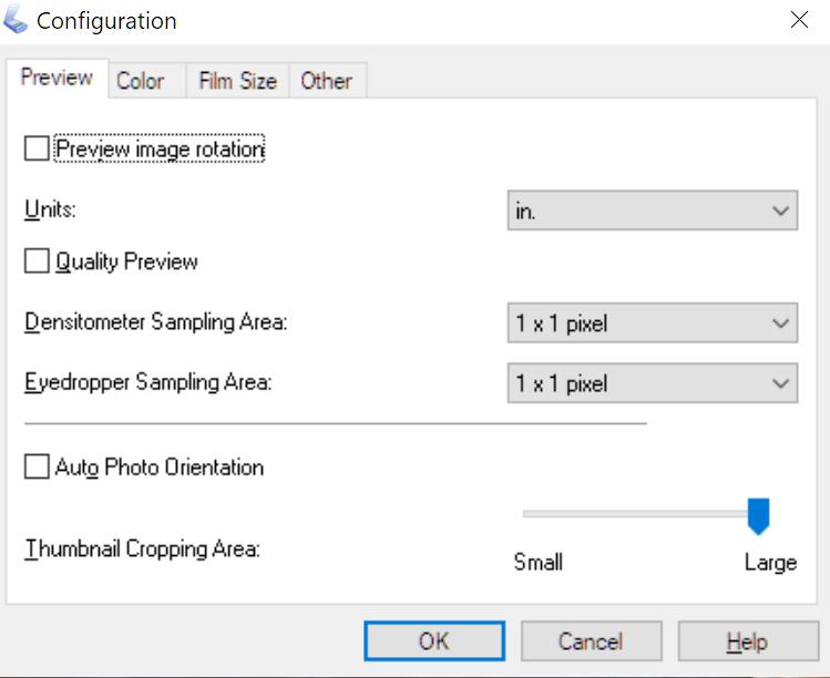

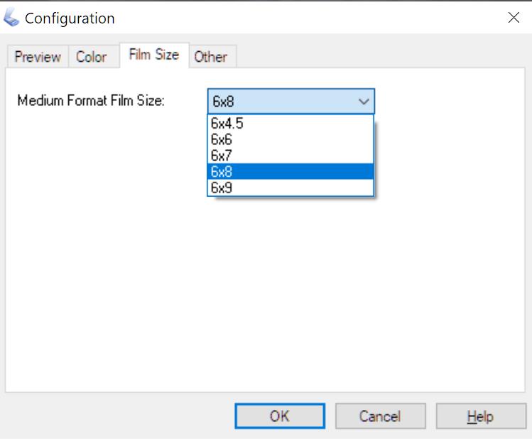

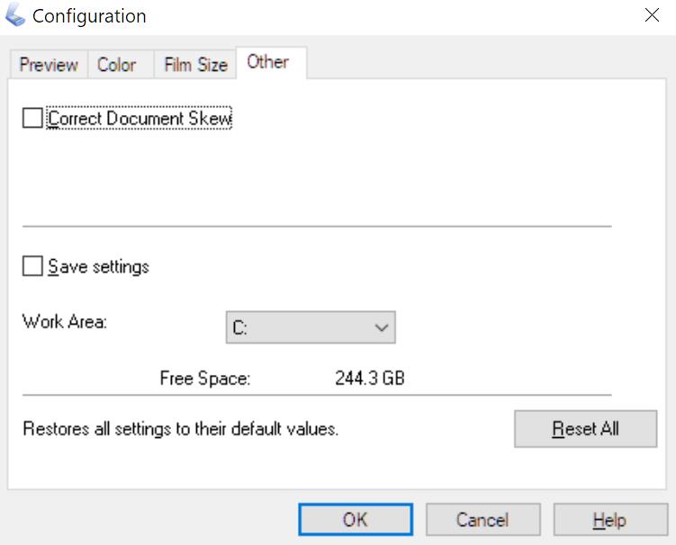

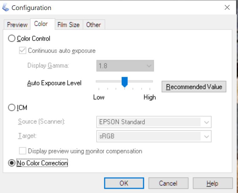

I use a Mac running Sierra (10.12.x) to keep compatibility with Adobe CS6. My version of Epson software is Ver. 3.07A. Attached images show the version, and typical scan controls. As someone else pointed out, finalization is done in another program, for me Photoshop.
