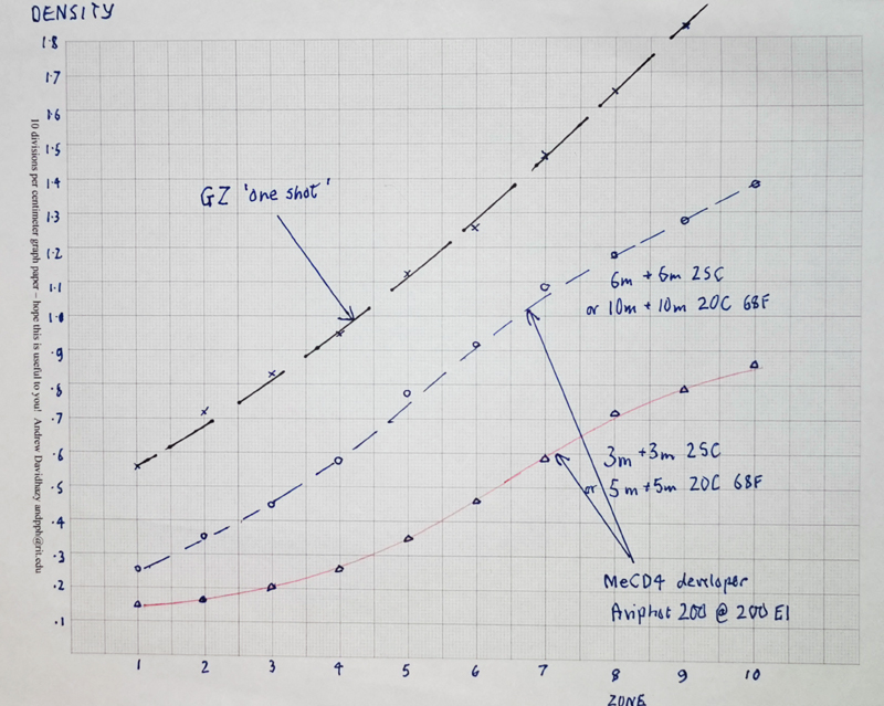

Greg kindly sent me his densitometer results which I have put on the attached graph.
The lower red curve is for Aviphot 200 @ EI = 200, as per post 141. The approximate contrast index is 0.27, which gives a histogram nicely filling 1-255 on my scanner.
The upper black curve represents his results from post 182, I get an approximate contrast index of 0.53 for this, for silver gelatin , hope that is correct.
The middle blue curve was an experiment in which the times in MeCD4 were doubled and agitation increased, CI ~0.5.
All the curves are quite a bit straighter than that for Aviphot 200 in D-76, mentioned in post 177, CD4 seems to work in flattening these.

If you use Allens’ formula from post 141. 2 bath developer. For 10 min. In A and in B . At 50 ASA. You should be able to get n-2 for silver gelatin print. Try it should get close. I use vertical Tank for testing. You can also use this for roll film. The straight line is pretty nice.
