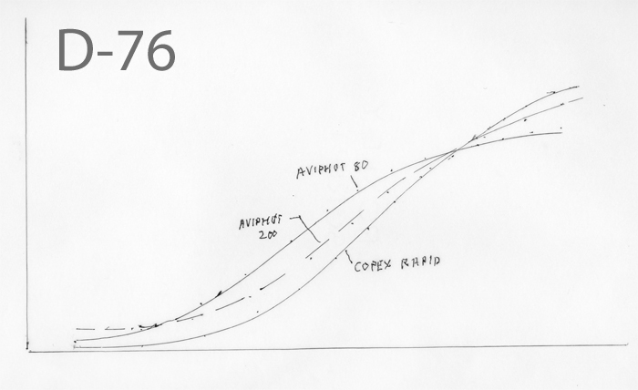

The guy who posts on Youtube as "the naked photographer" presented D-log E curves for Rollei Superpan 200, Rollei RPX 25 and Agfa Copex rapid [among others he is in process of presenting].
If the liberty is taken of assuming these are Aviphot 200, Aviphot 80 and Agfa Copex rapid and they are roughly sketched on the same diagram, the attachment results.
My main conclusion is that the microfilm Copex rapid has the greatest overall contrast in D-76. But since it has the best resolution of fine detail it is worth further investigation in MeCD4R.

Hi Alan,
give me some insights here . . ... why are you comparing these films in d-76? i'm confused? IMO D-76 is one of the least effective choices of developer for these films. Im not sure where you are going with this???? "this" train of thought.. . .
It’s probably that D76 is the standard developer for many. It kind of establishes a floor or Rosetta Stone against which you can make guesses about what is film and what is developer.
I compare them in D-76 because that is the only developer that has data for all three.
I want to try copex rapid in 35mm because of its high resolution of fine detail and this is the only guide how it might compare with the Aviphot films.

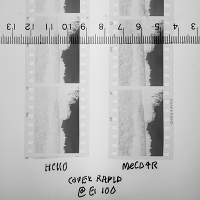

I repeated the experiment ,post 189, in which the same scene on Aviphot 80 was developed in MeCD4 and in the version with added Resorcinol ,MeCD4R.
It was just possible to see from 2 prints that the mid-grey was slightly lighter with added resorcinol.
This second test suggests that the first test [posts 189-195] exaggerates the effect of adding resorcinol.
It appears that for practical purposes the original and simpler MeCD4 version is good enough.

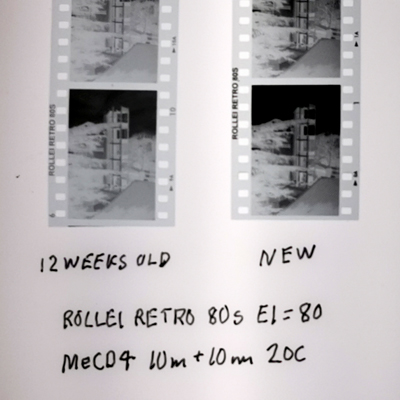

After 12 weeks in a part full plastic bottle, old MeCD4 part A gives thin negatives compared to a freshly made sample, attachment.
This is possibly due to oxidation.
I will keep the fresh sample in a glass bottle under inert gas.
The old version gives more grain and higher contrast, too much imo, as here:
Times nearer 10m + 10m 20C ,post 173, will be tried.
