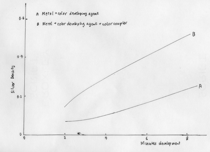

Some time ago Rudeofus mentioned to me an interest in adding a color coupler to a single bath developer and I have applied it to the two bath MeCD4.
The idea was based on a paper by LFA Mason [post 141] and attached is my copy of part of a graph in his paper, showing a notable increase in the density of the silver image when a color coupler was added to a metol - color developer mix.
He did check that the increase was not due to an interaction between the color developer and color coupler.
This will comprise the theory part of this experiment.

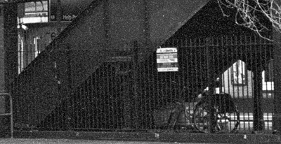

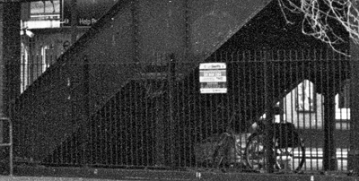

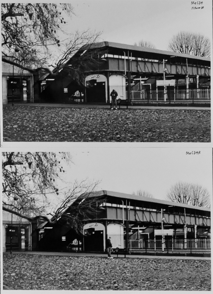

Noting this developer MeCD4 works for aerial films and copex rapid microfilm, here are the results of adding a color coupler.
MeCD4 part A [post 141] was prepared and 20g/L of the color coupler resorcinol added. By pH paper there appeared a hardly detectable reduction in pH.
This developer with added resorcinol is denoted by MeCD4R.
The attachments show results from Aviphot 80 developed in MeCD4 and in MeCD4R.
(1) Negatives from MeCD4R appear somewhat more dense.
(2) Inkjet prints from MeCD4R show lighter color of the dark greys on the print, eg the grass.
(3) Histograms from the scanner show less in the shadow area of the print.
Conclusion- This first test suggests that addition of color coupler increases the density of the negatives as predicted from Mason's results. Here is MeCD4R with Copex Rapid @ EI= 100:

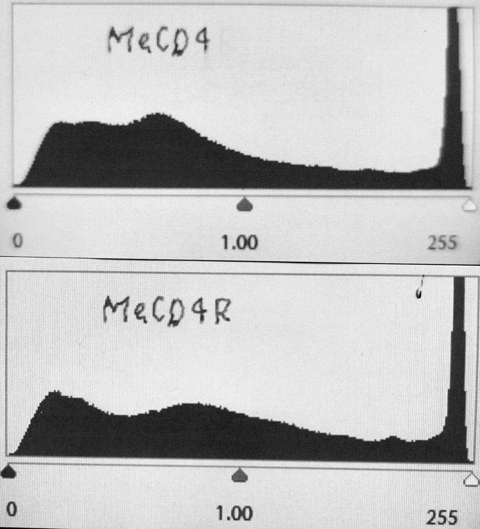

From this first test it does appear that MeCD4R version gives a less contrasty print. This seems to be supported from the tones being more uniformly spread out in the histogram.
I have not made a test to see if there is any change in the effective EI but as you indicate there is not much sign of it in the results so far. It would depend on the effect of the color coupler.

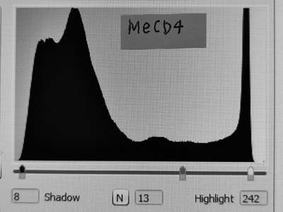

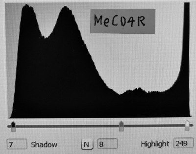

I repeated the scans from the negatives of the identical scene developed in MeCD4 and, with the color coupler added, MeCD4R. (attachments)
The scanner left on auto reports these as "after image optimisation", I assume these histograms represent the distribution of tones to be output.
IMO, with MeCD4 there is a lot of tone on the LHS, ie the low density part of the negative, and a lot of tone on the RHS, high density on the negative, and not much in the middle.
The D-log E curve would probably be S-shaped.
With color coupler added, MeCD4R, the tones are more evenly distributed.
The D-log E curve would probably be closer to a straight line.
So addition of color coupler flattens the S-curve and should give better pictorial results from aerial films and from microfilms.

the questions I have. . . . does the color coupler add speed? A.k.a. more shadow detail. assuming developing from the same formula/time/temp, of course with the addition of the color coupler.
second question, since adding the color coupler, does the highlights develope more dense with the same time/temp.?
if the color coupler added to the developer gains more shadow detail ( get more speed), how does that effect time and temp.? possible to adjust for highlight density?. as we all are looking for a straight line that is printable. so densities need to be in a range of 1.1.-1.3. Can this be achieved ?
(1) The color coupler does appear to add speed, with it the shadows appear lighter, see the attachments showing scans taken from a dark area of the scene with negatives developed without LHS and with RHS color coupler.
(2) Yes, I can clearly see this holding the negatives up to a light, with color coupler is more dense in the highlights.
(3) The effect of time is illustrated by your results with Aviphot 200 3m and 6m 25C shown in the graph post 173, very likely true with added color coupler too. You already got a density of 1.4 at 6min . The highlights do appear slightly more spread out in the attachment for MeCD4R ,post 192 but it is not possible to say if this would give sufficient flattening of the curve for your purpose.
(4) I use the Ilford chart to correct for temperature, development is either controlled by chemical reaction or diffusion and the rates of both increase with temperature.
