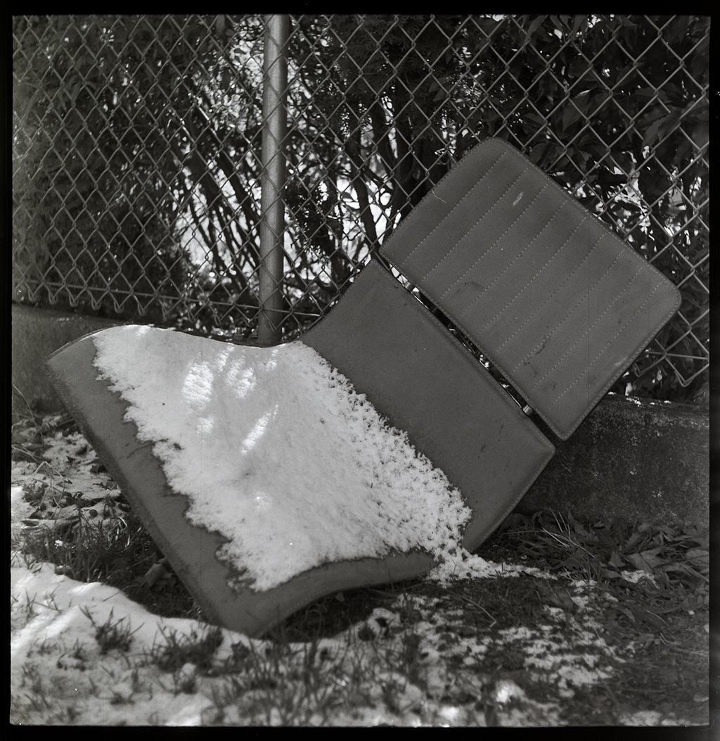

This gave negatives of normal density with Rollei Retro 400s (Aviphot 200?) exposed at EI =400
An against the light shot shows detail in highlights and shadows (attachment):
https://www.flickr.com/photos/98816417@N08/51032281702/in/dateposted-public/
The sky is now satisfactory. I have not compared with other 400 ISO films but just note that Aviphot 200 will provide infrared shots with filters and, with other developers, high contrast shots.
The numbers given are not optimized in this first test.

Hey Alan, these results look good! If you want to get better speed you might try out the 2B-1 two bath experiment I did (that you advised on). I have been seeing better than box speed on most films, without any substantial unevenness issues in skies. https://www.photrio.com/forum/threads/advice-on-my-two-bath-developer.181701/
51012378561_74596a646b_h.jpg This was box speed Silvermax, but the skies look good.
Yes your skies are indeed OK and it is good to see that more than box speed can be obtained. It is possible the sky problem only occurs with unusually contrasty films.
