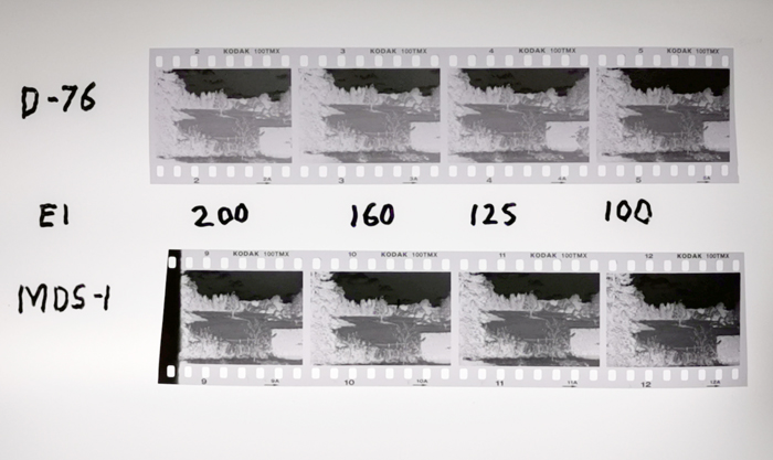

Using 100 T-Max film, the speed increase with MDS-1 vs D-76 was measured.
Development in both parts of MDS-1 was 4.5m 20C, agitating in part A 30s at start then 2 inversions every 30s. In part B 2 inversions at start then 2 inversions at 2 min.
The shadow detail in MDS-1 at EI = 160 was similar to that in D-76 at EI = 100,(pic) a speed increase of 2/3 stop for silver gelatin printing.
Scanning and processing gives an increase of about 2 stops on the results given by Henning, see eg Adox HR-50 at EI = 100:
https://www.flickr.com/photos/98816417@N08/51221997316/in/dateposted-public/

Alan, based on the pic of the two strips, when I compare D76 and MDS-1 frames at 160, there seems to be more detail in the shadows of MDS-1, but the contrast is different. Similarly, when the frames at 100 are compared, the shadows of MDS-1 seem to be more developed than those of D76 but again the contrast is different. If the two strips were to be developed at the same contrast at either 160 or 100, would you still notice the difference?
Alan Johnson
Nov 16, 2004
3,389
You should compare D-76 @ 100 with MDS-1 @ 160 but your point is still somewhat valid, the contrasts are not identical.
I actually evaluated the relative EIs by looking at the shadow areas ,especially the hedge on the lower RHS, holding the negatives up to the light and looking at them through a loupe.
This gives D-76 @ 100 = MDS-1 @ 160 - 200 for shadow speed.
MDS-1 is somewhat similar to Emofin and Diafine substitute part B and these two are generally, with some dissenters, regarded as speed increasing. I will rely on this analogy to claim a speed increase with MDS-1 rather than repeated testing intended to get the contrasts exactly equal. In any case the curve shape with D-76 will be different from two bath developers.
