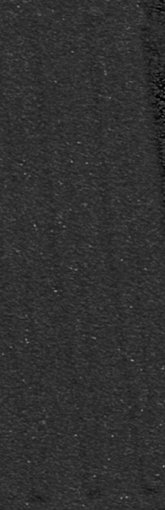

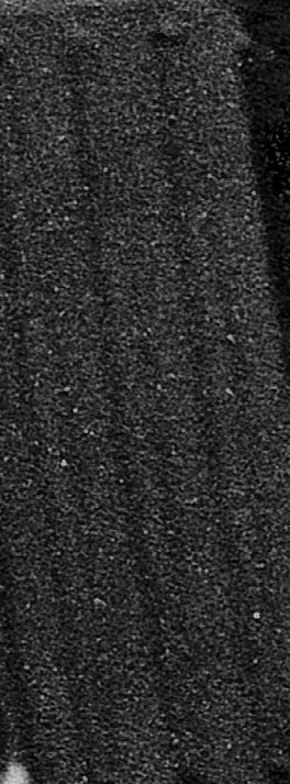

I investigated if small spots at high magnifications were caused by underexposure.
A near-black object was photographed on Rollei Retro 80s (~Aviphot 80) at EI =25 and EI =80.
The sections shown are about 1.2mm wide on the negatives, ~50x magnification on my screen.
Small spots visible at EI =80 (RHS) are still visible, along with some grain, at EI =25.(LHS)
The spots do not appear to be caused by underexposure, they are the result of high magnification.

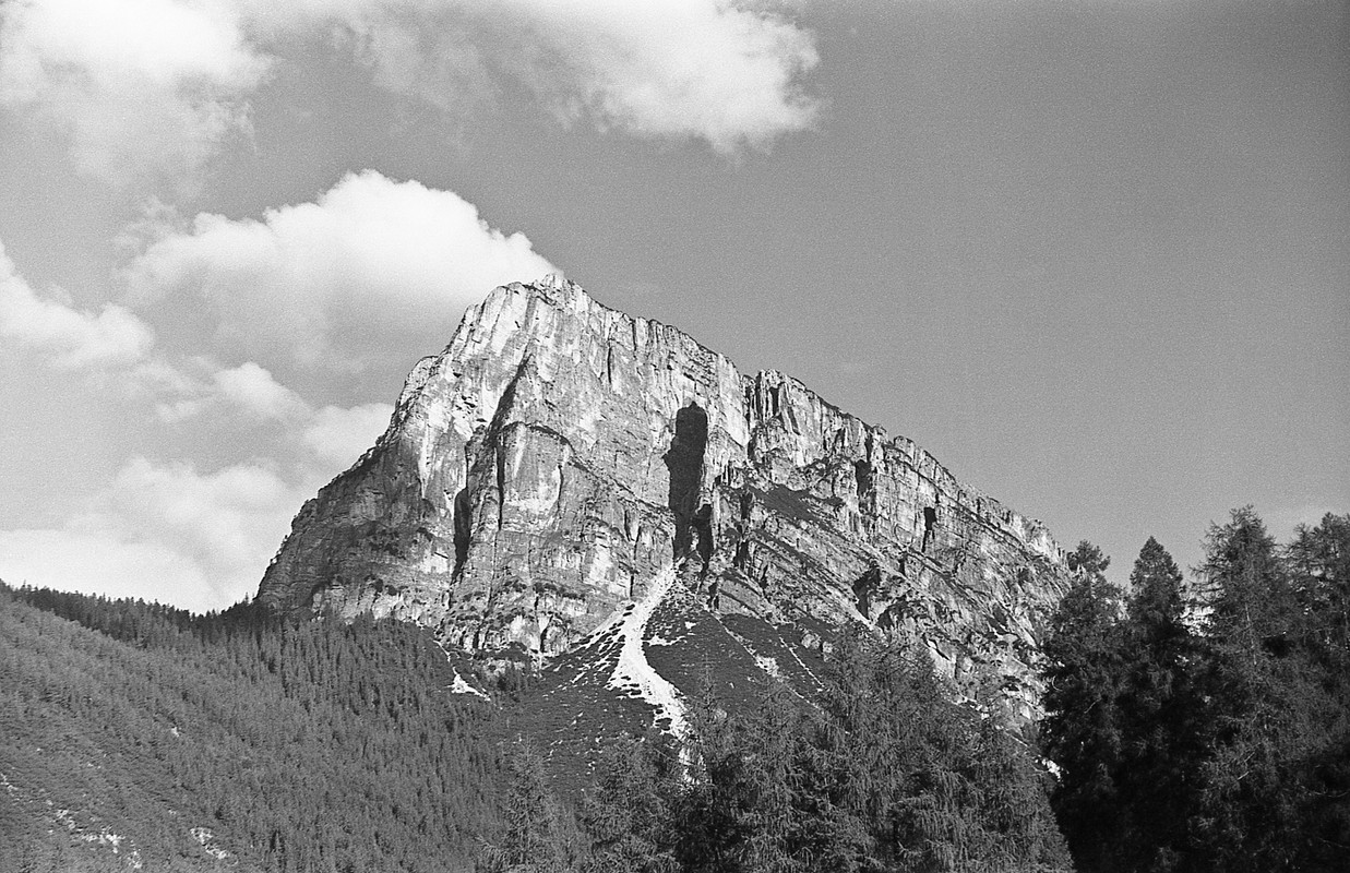

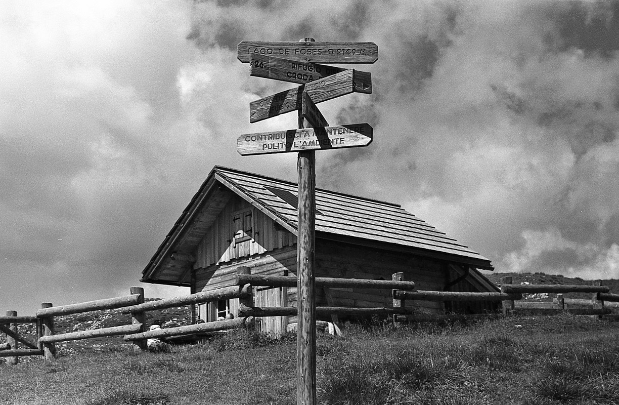

I just finished scanning the Agfa Aviphot 200 with the Thornton double bath.
Already at a superficial view, the negatives seemed to me to be correctly exposed and developed. I got a good confirmation after the scan.
Now you will need to try to print under an enlarger. Taking into account that I have used old Soviet equipment, I can be satisfied.
Leningrad camera, Jupiter 3 1.5/50, yellow filter
