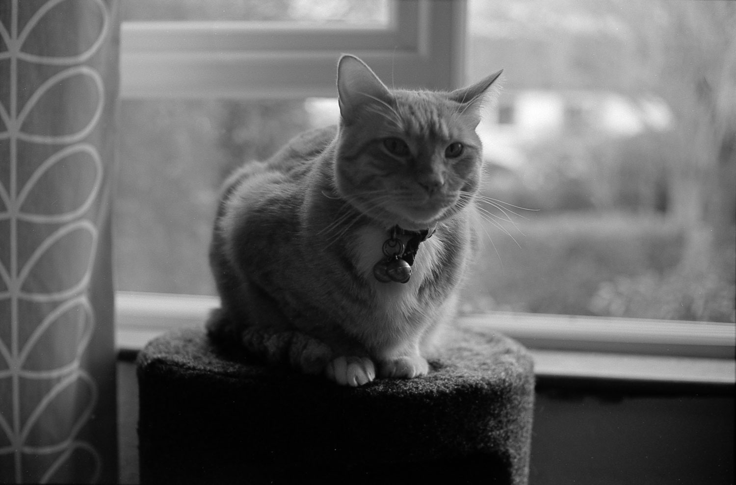

I am not sure how informative it is about @Alan Johnson 's original question, but here is ADOX Scala 50/HR-50 (Agfa Aviphot 80/Rollei Retro 80S) in my 2B-1 developer at EI50 (Box speed for ADOX). I purposely found a high contrast scene in the house, with backlighting. I think the results came out pretty well. That being said, I'd be shocked if this actually hits EI50 in a standard developer other than HR-dev, becaue 2B-1 has been over box speed on several other films.
The grain is extremely fine and I think the pictorial contrast came out quite well. I don't know how much ADOX's Speed Boost has to do with that. Even so, there is a huge black hole in the shadows.
EDIT: This was developed for 6 mins A and 4 mins B in 2B-1.

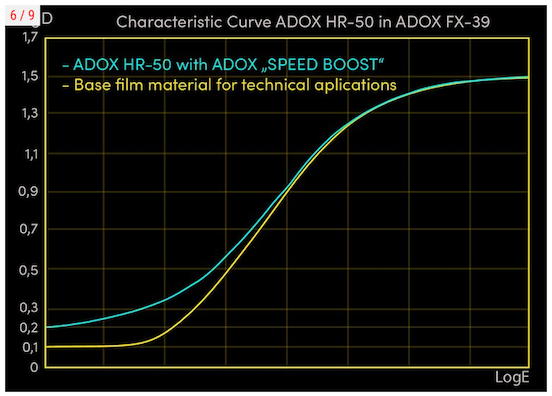

Speed Boost = Pre-flash?
You will not get an answer. Because the technology is a company secret.
I have seen it in the ADOX factory, I have done tests of it, it really works very well, and I can ensure you that it is a unique technology only used by ADOX. The industrial implementation and production is very clever and sophisticated. Lots of tests were needed to achieve the very high industrial standards ADOX is obliged to.
It is also a technology you could not do at home on such a consistent high quality level, and not at such very low costs. The price-performance ratio of ADOX HR-50 and SCALA 50 is really excellent.
