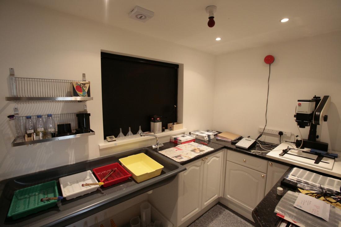

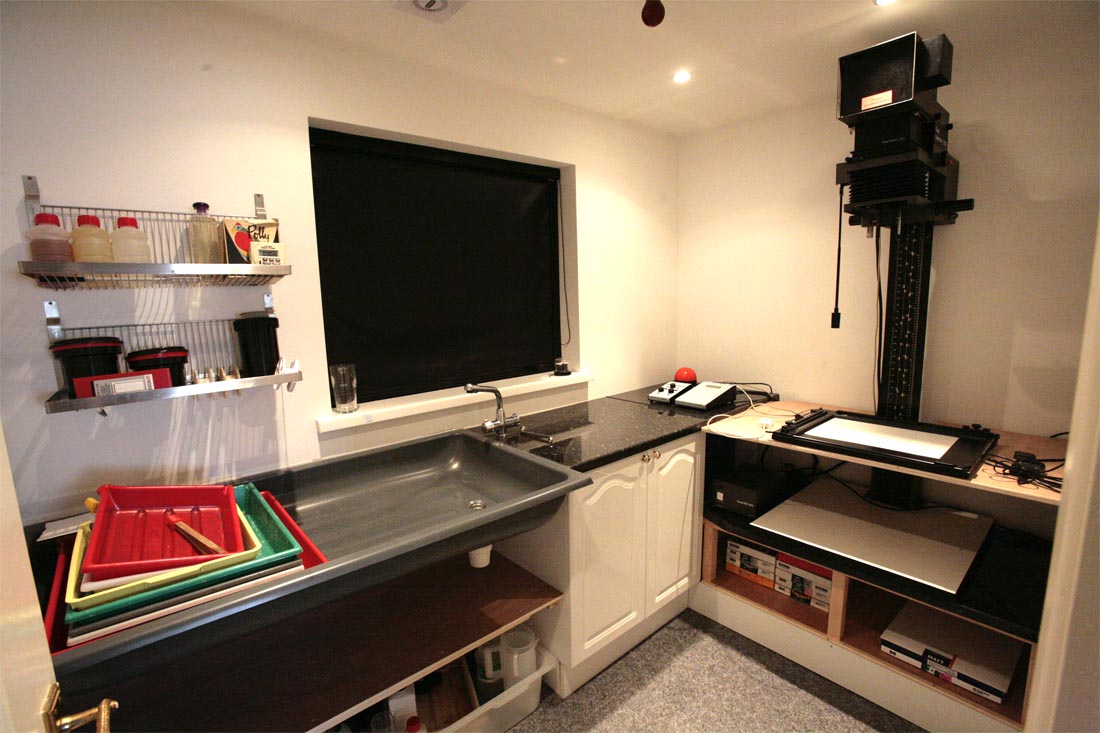

Darkroom extreme makeover, before and after pics. Stepping up to 5x4 was never going to be easy! :tongue:

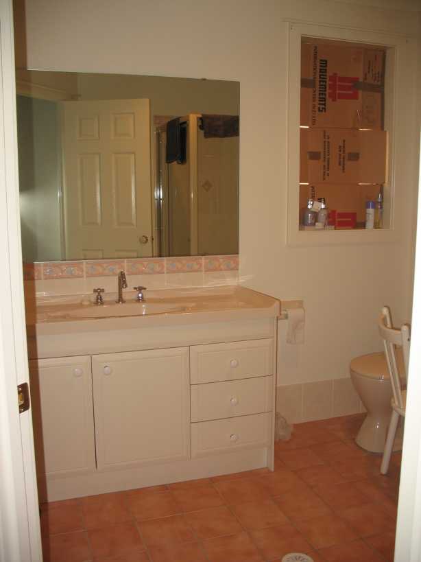

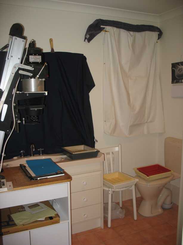

We've recently built a new house, but I still couldn't get a permanent darkroom past the bank manager, so I have to convert the bathroom for each printing session... Here's some before and after pictures.
The D2V is sitting on a microwave trolley that gets wheeled in and out, while the trays are on the vanity/chairs/bog.
Amazing what you can do with sheets, towels, blankets, cardboard, thermodrape and rodinal!
The biggest problem has been light bouncing round inside the roof cavity (from the downlights) and then coming through the penetration for the ceiling fan ...
Fortunately there is another bathroom in the house so wife and kids do not need to "go without" ...
Works for me (sort of).
Cheers
Carey Bird, Sydney, Oz

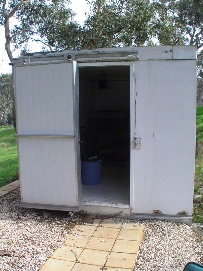

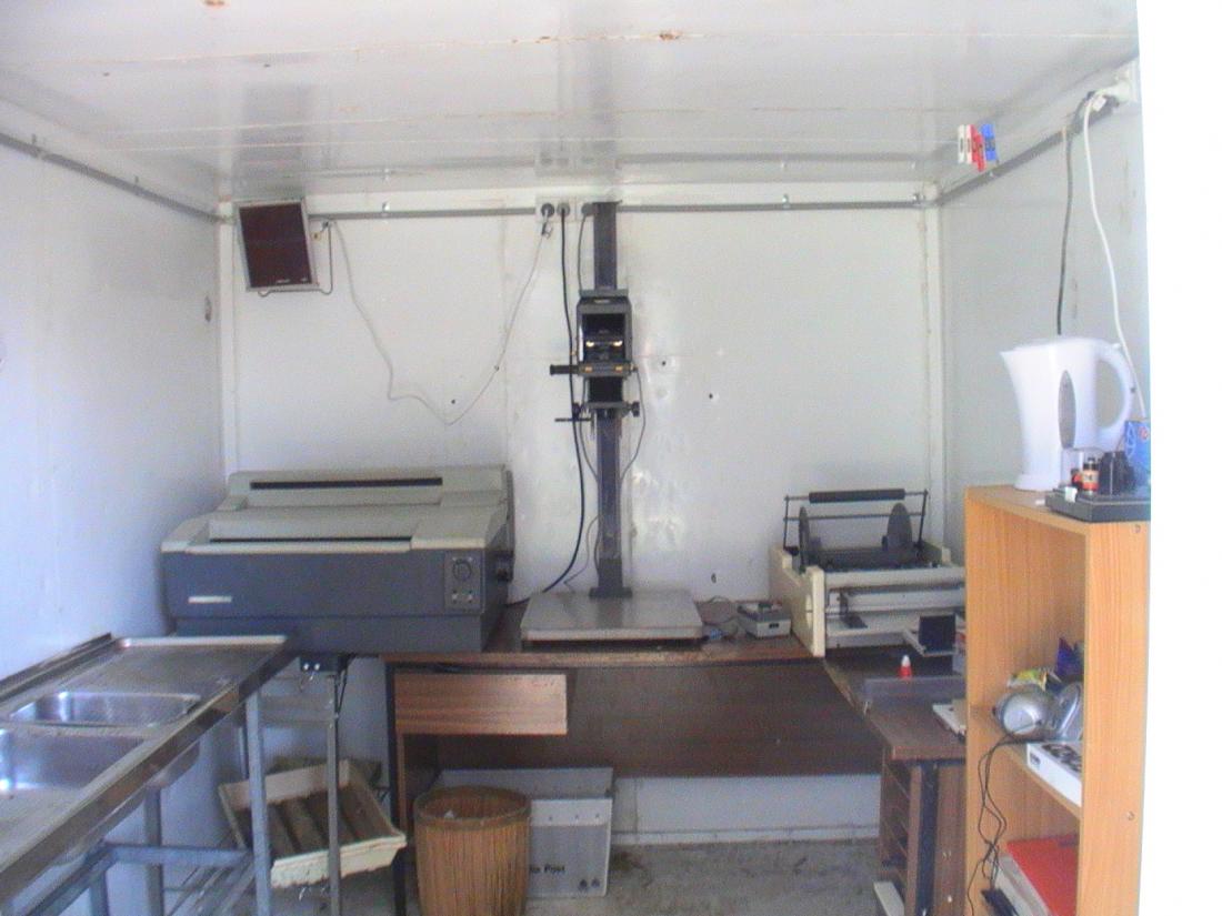

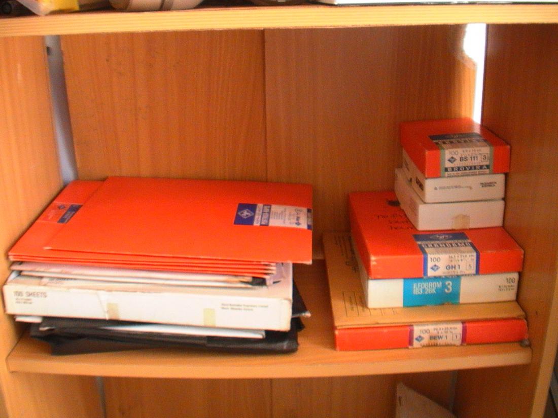

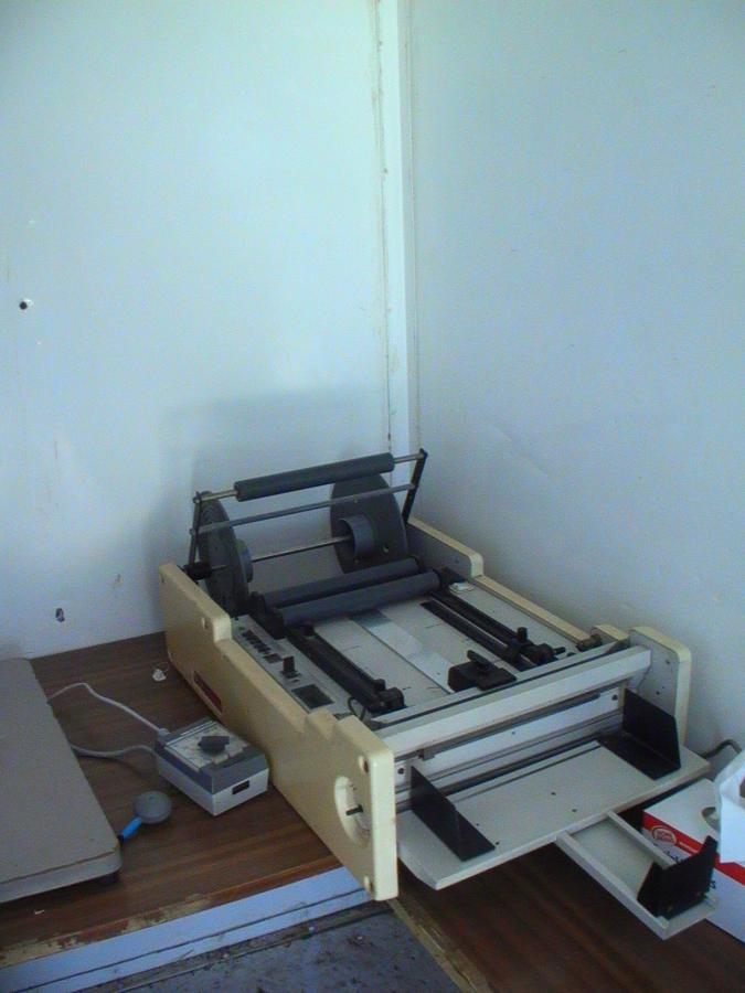

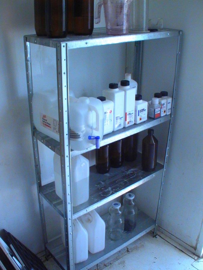

Time for an update on my ongoing quest for my own darkroom. My parent purchased an old cold room from a pub, without the motor, to use as a store room for produce from the garden and orchard. I suggested I could use it for a darkroom until I went off to university...well I'm at university and still borrowing it when I come up home. It's not 100% light tight, the door comes off it's runners rather often, and running water (let alone water of a set temperature, hah!) is a lovely dream. I'm getting by though, and the repairs I make to it will help it in it's next, more productive role.
The Ilfolab 2150RC is just a large paperweight until I have somewhere to plum it into...came with the Beseler 4x5 (not pictured, needs a new light source), roll paper cutter, roll print easel (not pictured, #$^&ing huge), and the desk, for a grand total of $320 Australian.
The extraction fan is pretty mean, but my mum worries.

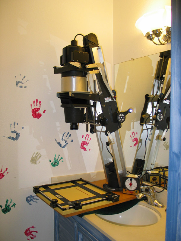

Here's the "dry side". This room serves as the hall bathroom when the family are around. They're gone this week so...it'll be the dark room all week!

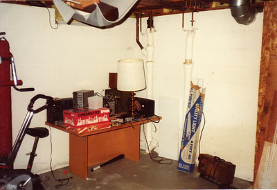

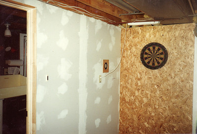

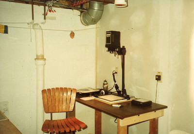

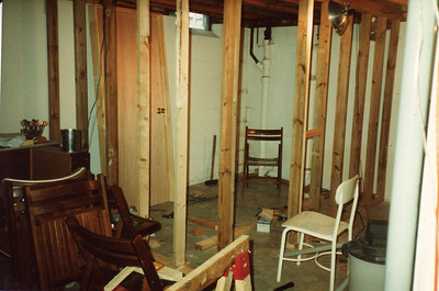

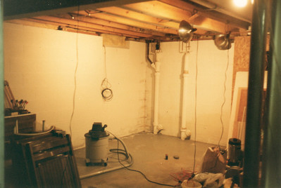

I built my first darkroom in 1988 the summer before I started high school. My father was supposed to help me - but a case of appendicitis sidelined him for the project and I ended to tackling it all myself. I had been saving all the profits from my paper route for two years to finance it and ended up doing everything from framing the walls to wiring and plumbing.
Most of the construction photos are here but here are a few highlights:
Before:
Cleared out:
Framed:
First use:

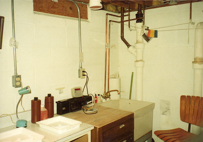

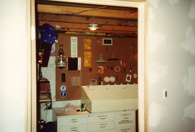

Over the summer I continued to improve the darkroom. I built a sink out of 3/4" plywood with several layers of paint and polyurethane over it. Brought in some old kitchen cabinets that were collecting dust in our basement, and before I finished the outer drywall added light traps in the walls for ventilation with a built in fan. I modified one of the drawers in the kitchen cabinet to be a paper safe and even added an adjustable shelf off the side of my table for doing bigger prints. Though the limitations of the Beseler cadet meant I never really used it.
(Continued in next post due to photo limit)

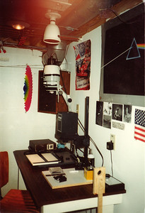

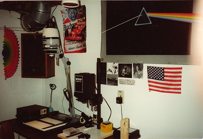

By the next summer my darkroom was pretty much ready to go. I was deeply involved in our schools photography club at that point. I became head photographer for our school paper and by my senior year was president of the club and head photographer for the yearbook. My darkroom got a lot of use by both myself and other club members when deadline times came around!
I can't find any photos of it...but I actually used liquid light to put a print of a photo of myself working in the darkroom on the door. The image I used for that is the middle one hanging on the wall behind the enlargers:

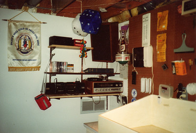

You can see one of the built in vents under the shelfs in this image of the all important darkroom tunes. I removed all the lights from in the stereo and then plugged the Schlitz beer sign that's on the pegboard into a switched outlet on the back of the stereo. Put a safelight bulb into the beer sign and I had way to remember if I had turned the radio off without fear of fogging paper:
Here's the intake and built in fan for the ventilation. The doorbell switch went to a doorbell inside so people could let me know they wanted in. I also wired a switch upstairs in our pantry that my parents could use to let me know they needed me without having to come down to the basement:

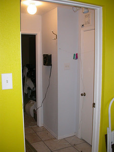

Our house has a 3rd bedroom which was an addition and is only accessible through the laundry room. It has only one window (and a dog door) and it's own A/C unit. We have plans to expand the room at some point in the future and those plans now include a bathroom that will have some special features allowing it to double as a darkroom. But for now we have a temporary setup that is functional.

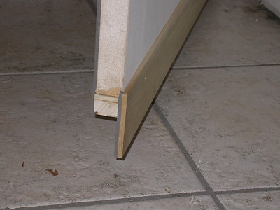

Some aluminum foil and aluminum tape took care of the one window. The doors had almost 2" gaps under them - so a little bit of wood working and a good amount of weather strip was required to get them light tight:

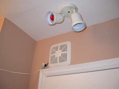

The tiny laundry room had two lights for some reason...which never made sense before. But now works out perfect with one converted into a safelight. I have to finish wiring it - but a bathroom fan was added that exhausts through the water heat closet to an old unused dryer vent:

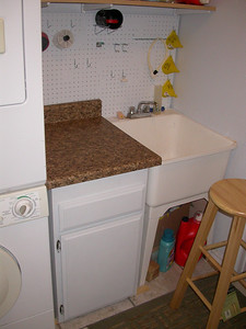

And a small piece of counter top was installed next to the wash tub to make room for some trays...it's a tight squeeze...and I only had 2 trays so we had to improvise for the stop and wash:
Dead Link Removed
It worked well enough that the next weekend we did some upgrades. A used cabinet was bought at a local thrift shop for $15. We painted it and the laundry room, hung some peg board over the sink, hung a spare timer on the wall and had a much nicer though still cramped setup ready to go:
