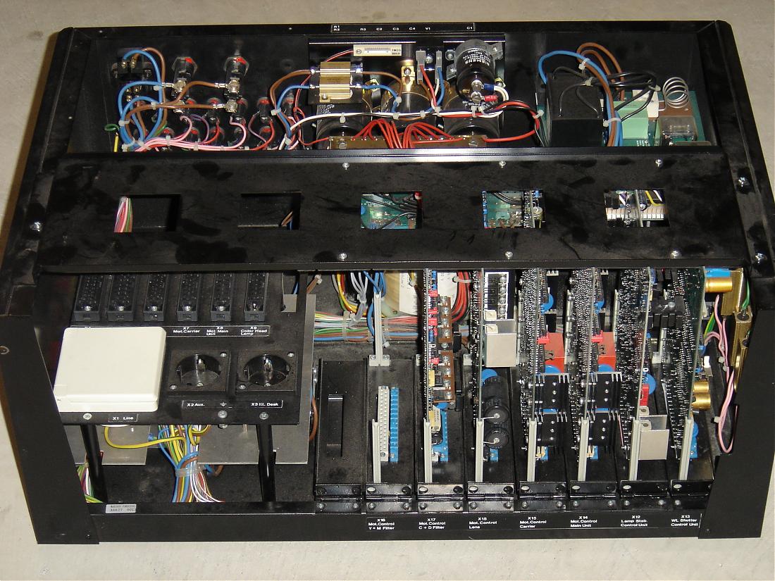

I not only got spare boards, but I got a second entire system. See the photo below.
I saw your other thread on rebuilding your 1840. The 4093 nand gate they used is not your normal nand gate. They made a gated oscillator with it which is not uncommon and is shown on the data sheet. A very inexpensive way to make a square wave oscillator that you can turn on and off.
Dave
Yea, they are showing an "Astable Multivibrator" which is the same circuit. I missed that when looking over the sheet. I was just placing an order to Mouser.com for another project and wondered if there would be any benefit in putting in a new 4093? For, example, how do you think it fails? Do the specs drift off, or does it just go 'poof'? It does seem to be working fine right now.

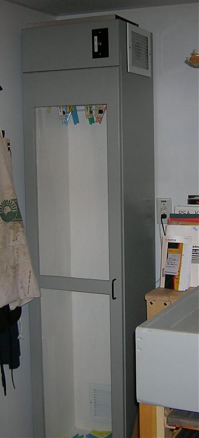

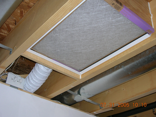

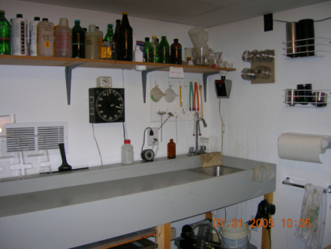

It just occurred to me that I had made some pictures of my setup a while back but had never posted them. So here goes. From left to right:
- the corner enlarger station with the Omega DII
- the film drying cabinet
- the ventilation system (with the fan OUTSIDE the darkroom)
- the wet side. Print drying screens slide under the sink.
- overall floor plan

Nice and clean. Did you make your own drying cabinet? Forced air?
The drying cabinet is made of MDF with a plexiglass insert in the door so I can see what is happening. There is a fan behind that white louver at the top that draws air into the box through a sheet of air conditioning filter material. The air then flows down through a second filter (this time, a standard furnace filter), past a 200W light bulb (mainly a source of heat) and over the film, and then out through a louver at the bottom. The film hangs from a rack made from a cut-off scrap of ClosetMaid shelving.

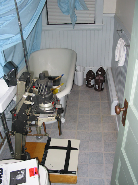

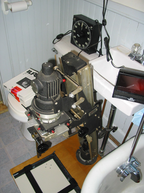

Well, it's not pretty but, gotta start some where...LOL Here's my humble addition to this thread. I played around with other set-ups but, this seems to work the best for me for now. Trays are in the bathtub and just outside the bathroom door is the kitchen sink where I do my washing. I had originally planned on making kind of a table top to put over the tub for my trays and then put my print washer in the tub. However, I forgot to take note that the faucets in the tub and bathroom sink are old school and I can't attach the washer to them. So I opted for the easy route of just putting the trays in the tub. I had also wanted to get a cart for the enlarger but, that didn't quite work out either. This seems to work fairly well for me for now though.

That last one is great. People who don't have a dark room and are browsing here should realize there no way to tell if a print came from a converted bathroom darkroom or a full-featured dedicated darkroom.

Thanks ic :smile: and the best part is it only takes about 5 minutes tops to set-up and about 10 minutes to breakdown and clean up.

Xia, looks very usable. Maybe get yourself a small table so you can raise up the enlarger a little to save your back and make priting a bit easier.

Hi pes. I tried using a table but the problem is room size and layout. Really the only place to put it on a table would be up against the far wall. Unfortunately, there are few problems using that far wall I hadn't planned on when in the beginning. One, the outlet is at the opposite end, over the toilet. Another thing was that I need to work around the table for using the trays in the tub. Also, I have a 2 blade easel which over hangs the baseboard depending on how I'm printing. In that corner, if I used a table, the baseboard would be flush up against the wall :sad: It just seems to work best for me this way and I don't mind working on the floor.

Xia, maybe a board over the tub and a rack for the trays that stacks them up vertically and slightly diagonally?

I simply put the enlarger on the toilet seat and a sheet of plywood over the bath with two wooden strips along one long edge (either side of the bath's top edge) to stop it sliding off. Then I chopped the legs down on an old chair to give myself a comfortable seat :smile:. Saved my back!
Your enlarger looks a bit too large for that (mine was a small Meopta 35mm only one) but an hour with some wood could provide a small table that fits over the toilet seat, providing a larger surface.
Now I have a "proper" darkroom, but I certainly had plenty of fun in my make-shift bathroom one! Whatever you do, enjoy!

Thanks guys, the more I think about it, the more I think I'm going to keep it simple as it is right now. I have no problems working in there now comfortably. Any thing else bit for it just means more to breakdown/set-up and also more I need space to store away. Anybody who has lived in a small apartment knows space is a premium. The only limiting factor for me at the moment, is my eyes. I find about at the 2 hour mark my eyes have had enough from straining in the low light. I start to get a good headache and have to call it a night. Though it could just be that I'm turning on the lights after every print to see how it turned, so my eyes are constantly having to readjust.

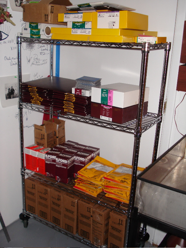

Getting Ready for April 21 - Global Darkroom Day
I did a little darkroom cleaning yesterday and went out and got this rack.
This is a little more than half of what I have.
Not pictured are the 5 liter jugs of Ilford chemistry and about a dozen or so boxes of Ilford 16x20 fiber paper.
