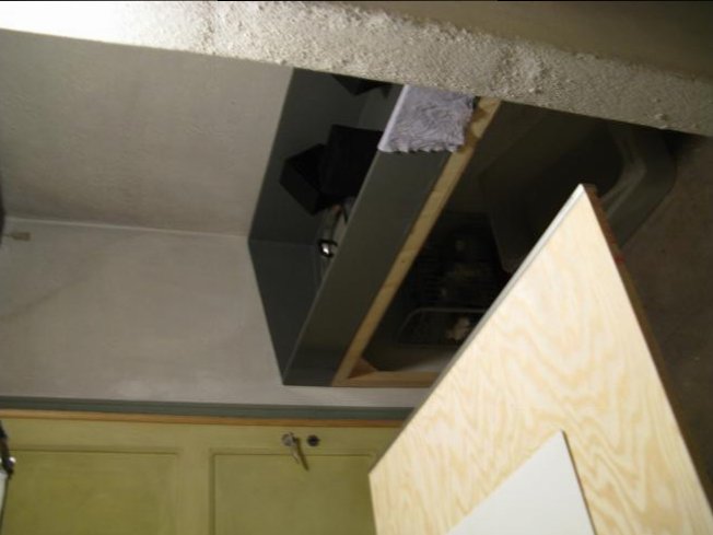

My darkroom is 200 cm across and 160 cm deep. This is also where I keep most of my cameragear and other stuff.
But the important thing is that I have a permanent place to work in, that it includes running hot and cold wate, that it does have a vent and that I can easily crank out 16x20 prints any time. I have just upgraded my enlarger from an old Durst-C65 to a LPL-7700 which makes it a lot easier to make big prints (the lamp on the Durst is a wee bit weak compared to the powerful halogen on the LPL). I have new lenses comping in shortly. With a pile of negs to print - life is good.
My past two darkrooms (from when I lived in San Francisco a while back) were not permanent. In one flat I could set everything up in the bathroom. In the other the kitchen was the best spot.
Now if I could just find some place in the house for a dry-mount press...

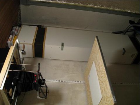

Until now I have built five darkrooms. But there are still things to improve. And everytime I study other peoples darkrooms, I learn one or two nice tricks.
Would you mind posting some images of your darkroom? I'll start with mine. I use it one day every week. And even after about twenty years of darkroom work, I still want to change things. (That's why I got the idea of this thread.) My desktop is very cluttered because I'm in the middle of a rearranging my darkroom.

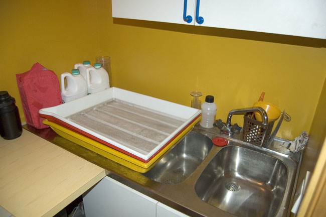

1) My darkroom sink. I adapted an existing sink to do all my film developing, and washing. Above the sink chemicals are stored child-safe. I built my own sodium lamp.

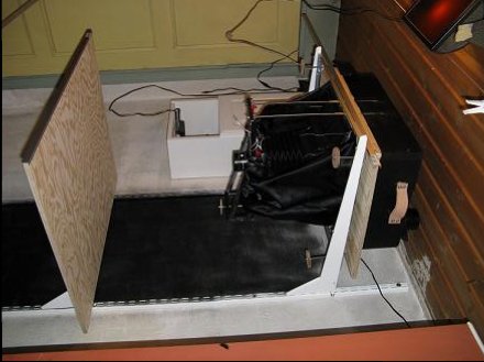

2) An Omega D5 XL enlarger for 4x5 inch negatives
3) A Durst M605 enlarger, my darkroom books and negatives.

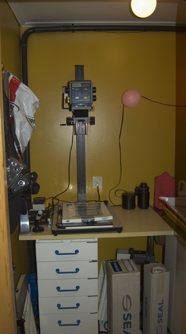

4) The wet bench with photographic paper to the left, and film tanks underneath.
5) Bulk chemical storage and processing clock.

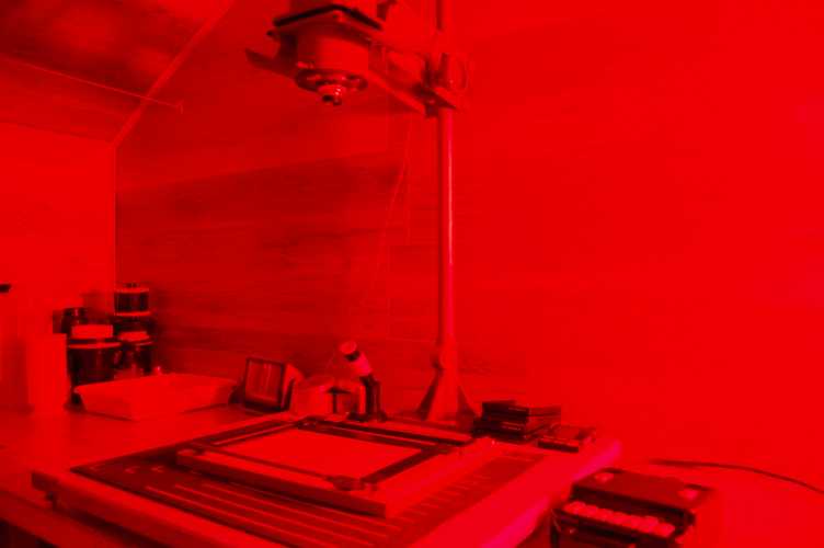

My small darkroom/bathroom. Enlarger head is above the easel, but too dark to see in the picture. The dark towel on the right is used to block stray light coming through the door cracks. The enlarger is a russian suitcase enlarger UPA-601.
Both pictures were taken during a darkroom session, with safelight as the only lightsource.
Stop-bath on the right, fixer in the middle, wash tray on the left (with a print in it). Developer tray is in the sink, not seen in the image.

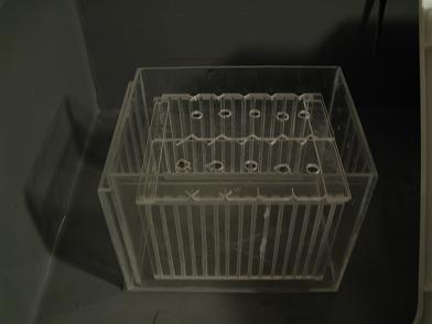

The 4x5 film washer is Plexiglas glued together with loctite attak. I then went over the joints with fish tank silicone.

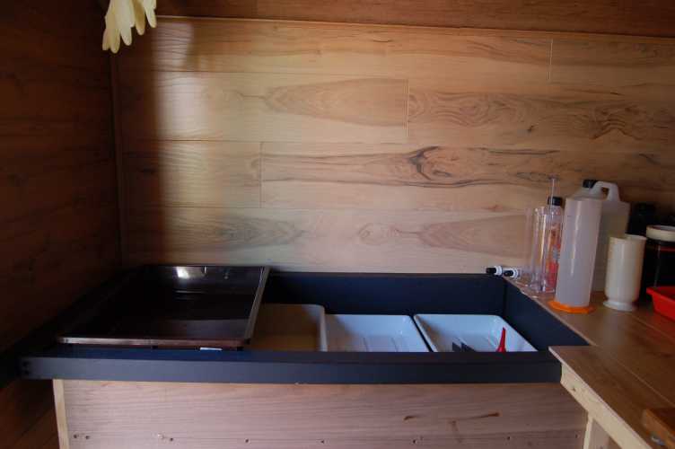

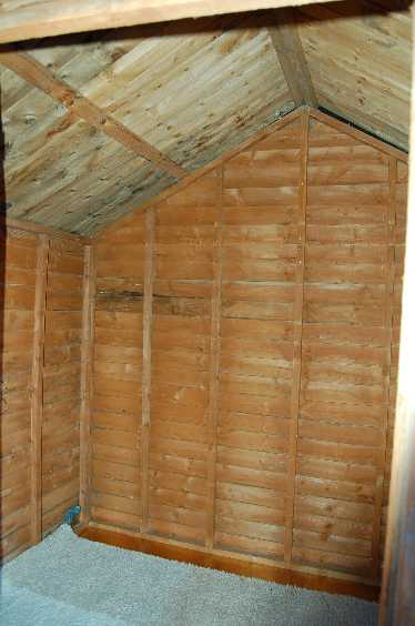

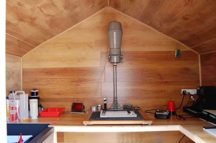

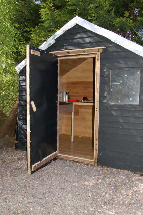

I too could not have completed my "Darkshed" without this thread and the help of everyone here. I've spent many hours trawling through posts, taken on board all advice and recommendations and even built the sink with the help of Appugians.
So thanks to everyone who contributed, and specially to Fintan for all the equipment and for hauling it to Cashel for me!
Síle
Here's a few pics of before and after :
