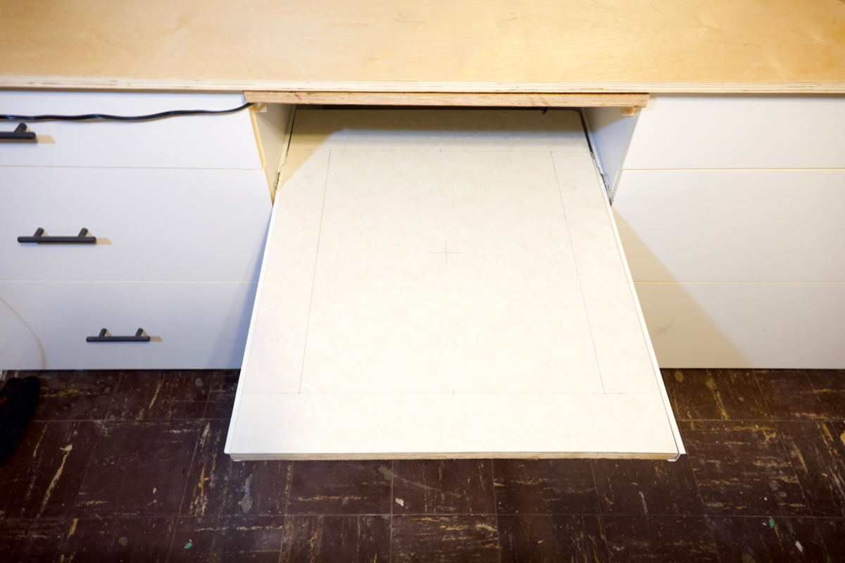

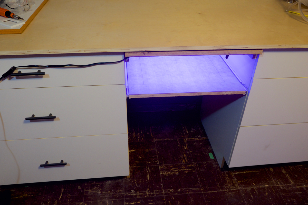

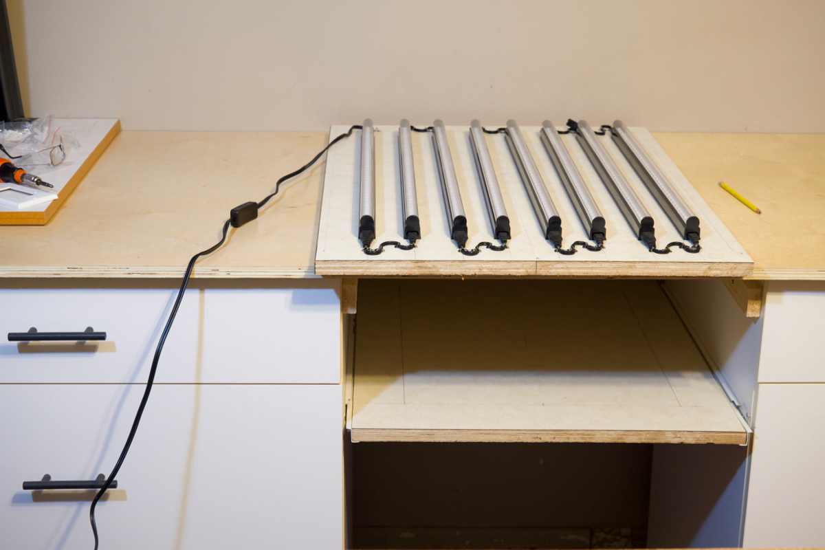

Under the counter UV LED light source in place with a pull out drawer for heavy sheet of 16x20 glass contact printing rig.
Poached idea for LED light bars from Tim Layton: https://www.timlaytonfineart.com/bl...printer-for-platinum-printing-with-led-lights
Inching along...
Do you not have to defuse the leds? Or is it completely even? I have a big floodlight UV bulb I use on the rare occasions the sun isn't out.
Check the link to Tim Layton’s website in post #556....he didn’t need a diffuser and got exposure times of 4 minutes for his Pt/Pd prints. He’s since doubled up the number of LED light bars and has ridiculously short exposure times.
I’ll be testing for even light distribution for sure.

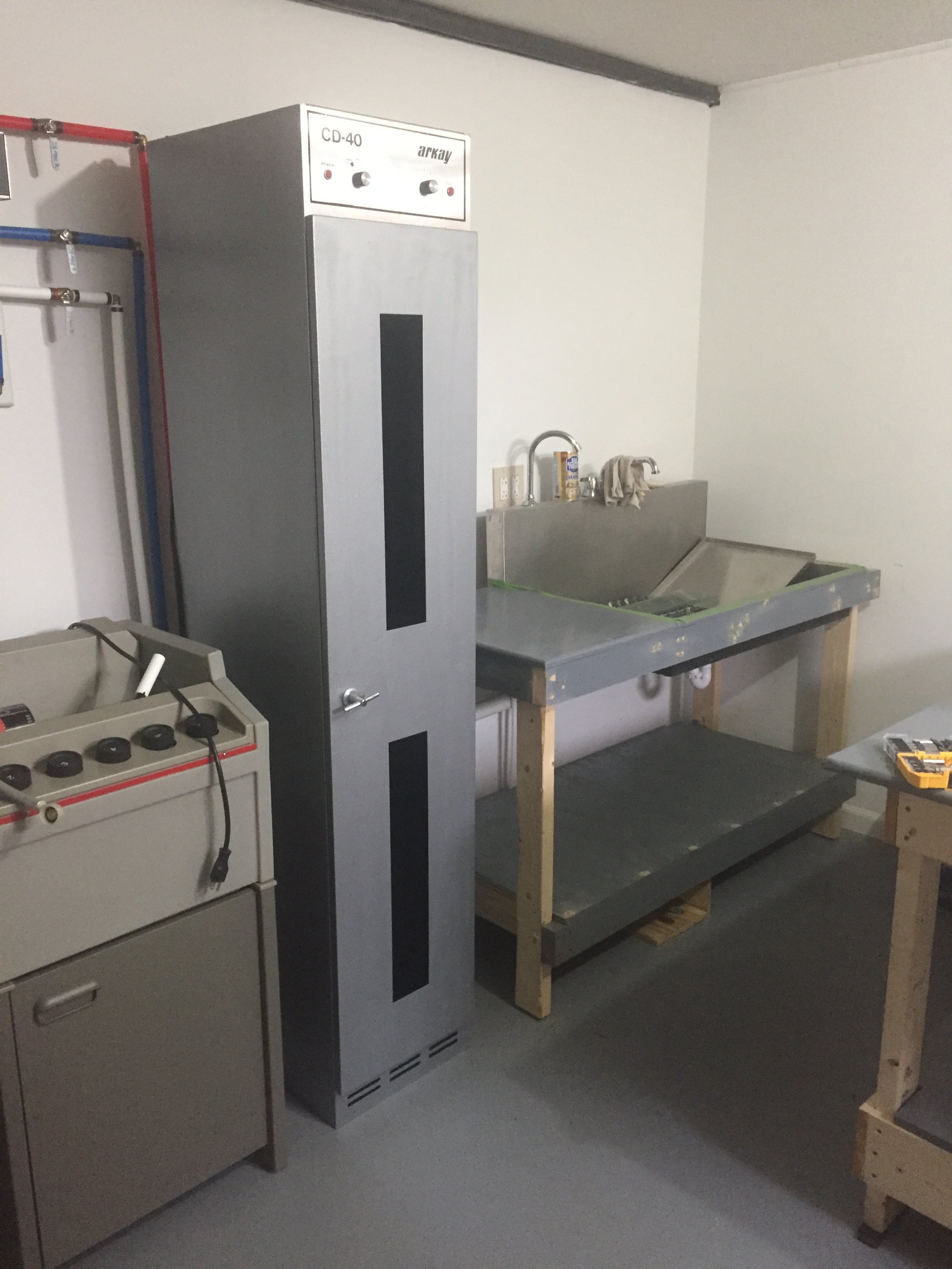

Hoisted my rusty, crusty Arkay CD-40 film dryer outside today, threw it on some saw horses and ground all the rust and flaking paint off the body after removing the glass.
I wanted the "antique pewter" finish hammertone paint, but it is out of stock everywhere I went. Grrrr...
Sprayed on a couple coats of Silver Hammer Tone paint to cover it's sins. Not perfect; but at least it's not looking like a plague victim in the Middle Ages anymore.
Oh man, everything I have been storing for this darkroom needs to be refurbished. It's a slog, but I am getting there...

Nice. What does it comprise of? I was thinking about making my own.
It's about 1/8 inch mild steel, so it's quite heavy! It has a heater coil with a paper filter and a fan in the top with a timer and temperature adjustment knob. IMHO its drastic overkill and I ran it mostly without the heating elements turned on, as it can over dry the film very quickly. If I had not picked it up over a decade ago for $25, I doubt I would even consider purchasing it today.

A similar sized box (or even smaller) made of hardboard tempered panels, a computer muffin fan, a furnace filter, a drip pan and a 60 watt light bulb would do just fine unless you are pumping out over 40 rolls a day..
Yes thats what I was thinking. I have a suitable cupboard. Maybe incorporate a dehumidifier to store lenses when not drying film.
A local photographer adapted a school locker into a film drying cabinet for under $20
That's a great idea.
Even easier and less expensive, adapt a zip-up portable wardrobe from a local home store - that's what I did. I mounted a film dryer head inside on top (I picked up a Prinz head off eBay for $15), and used block used thick cushion foam to air and dust seal the bottom along with some duct tape - simple.

I believe the main problem that they solve for us darkroom enthusiasts is minimizing dust, being a closed controlled area. To that effect I have been debating building something as I live in a 100 year old house, not well known for low dust. Then again I do have space to spare right now so that is a consideration, if you lack the space that can change that.
I'm not against using a film dryer, just am recommending you DON'T put your efforts and money into acquiring one of the big Arkay's unless you intend to do a boatload of film at a time, have a commercial darkroom or find it for a stunning low price (which is what I did).
A small unit, like any of the above is more than sufficient...

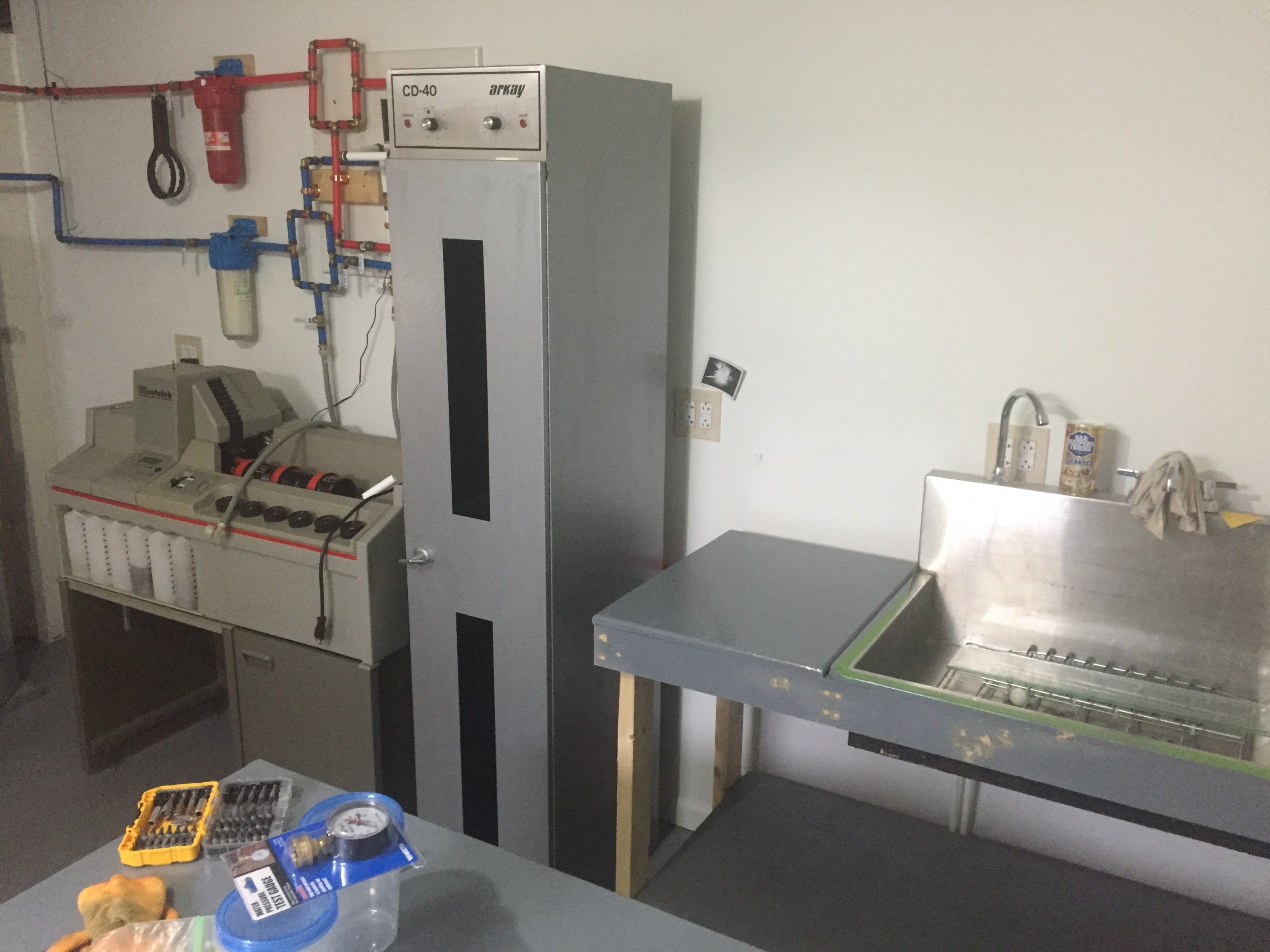

Edit: Put another coat of oil based paint on the enlarger and sink lower shelves and installed adjustable leveling feet on my enarger bench. I then had to order another set for the Arkay because they come in sets of 4 and my bench used 6. The feet on the dryer were missing except for one rusty bolt, so I had to cut that out with a grinding wheel in anticipation of putting the feet back in.
My darkroom floor is a basement floor, sloped for drainage, so everything that needs to be level will require these type of feet...

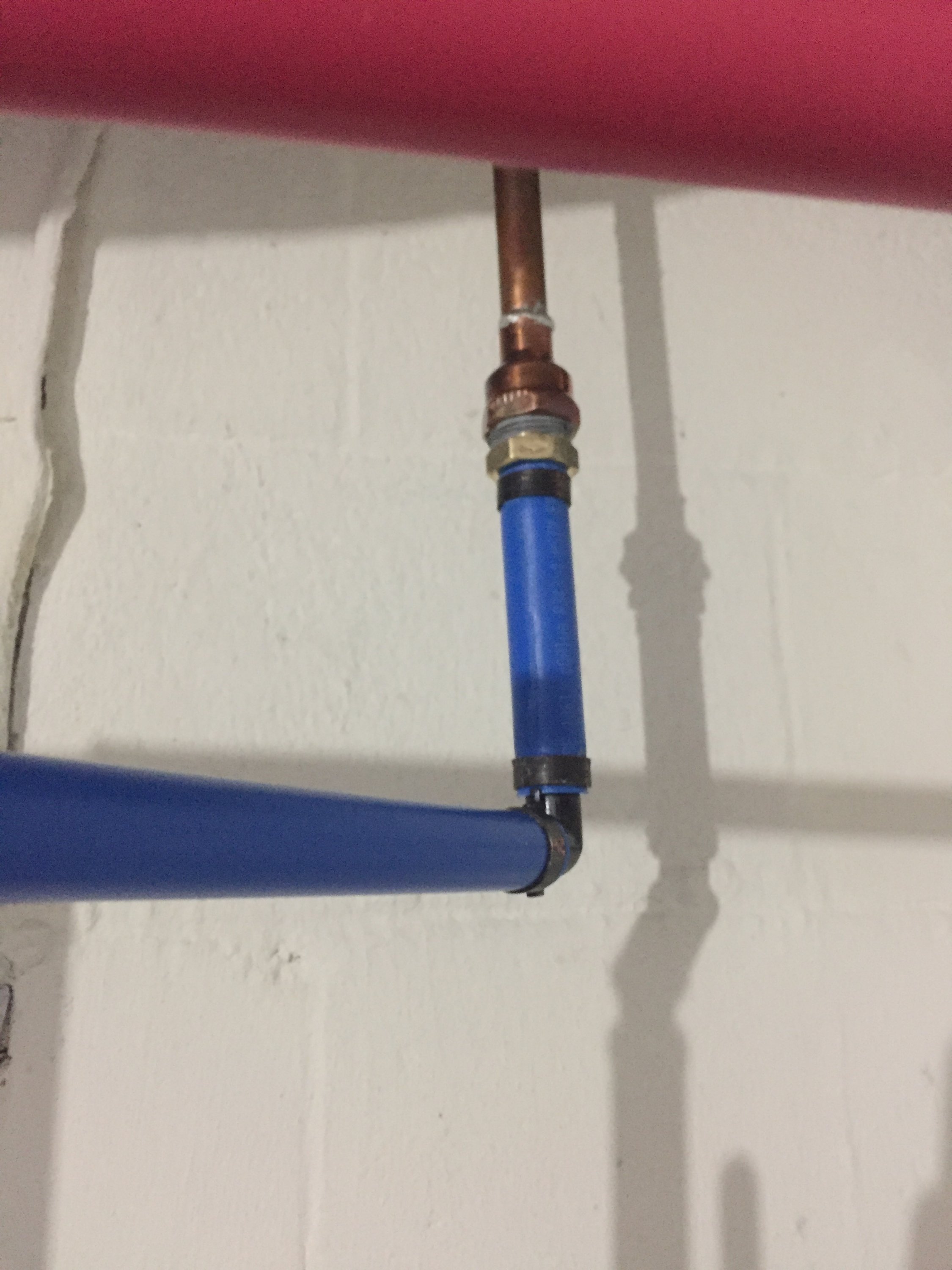

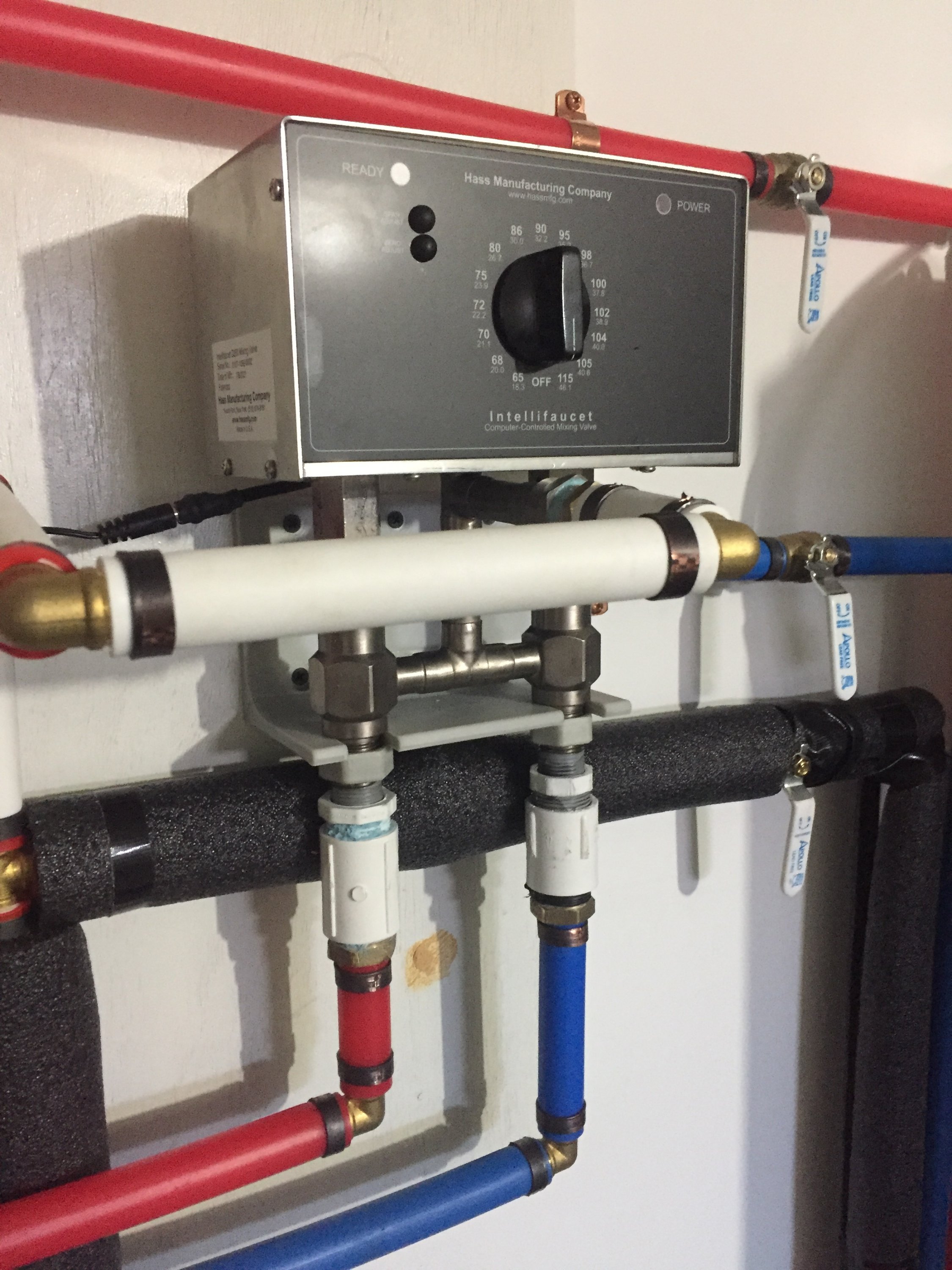

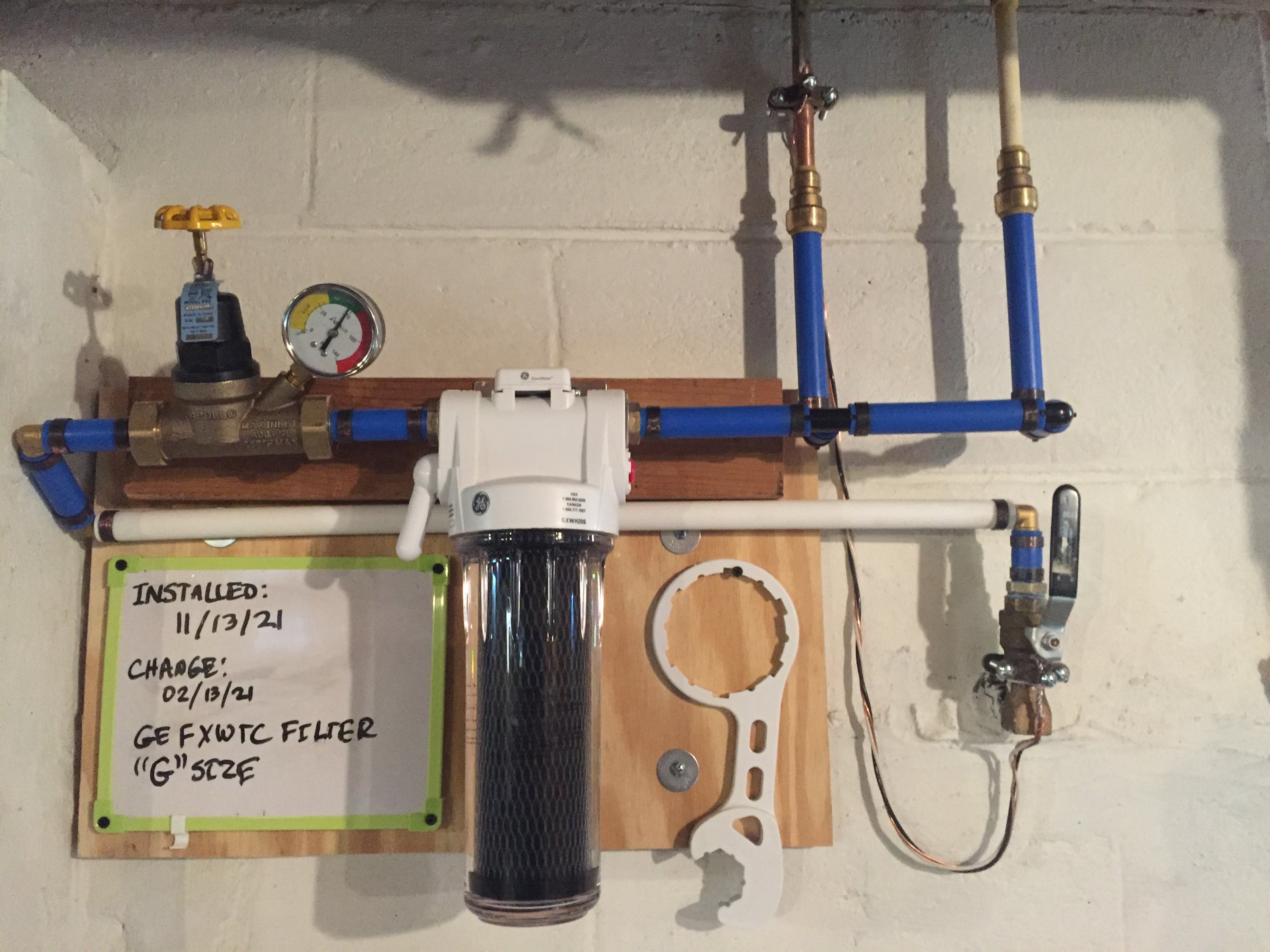

However, this morning, I did get my whole house filter and pressure regulator installed, my dripping cold water joint sealed and my mixing valve installed WITHOUT LEAKS! Hallelujah! I might actually have a darkroom soon!
Nice bit of plumbing, very patriotic.
Totally unintentional. I followed the convention of red for hot and blue for cold, so the only other color of pex for tempered water was white. Not a fan of vibrant primary colors in a visual working space, especially if I do color printing, so I might cover them with insulation.

Re-glued my felt seals on the film dryer, installed the glasses, wiped the interior down and plugged it in; works great.

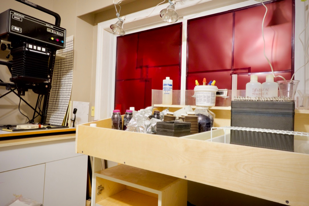

Bit of an update.
Some photos of the enlarger and under counter top UV LED areas. Have never used the enlargers light source or the Analyser Pro enlarging timer which were purchased about 15 years ago...Life & health created a bit of a pause on finishing the darkroom, but I'm back in the saddle now. The 6x7 enlarger on left will be used as a copy stand for 4x5 negatives enroute to being digital enlarged negatives.
Also, in keeping with my early retirement + reduced pension = tight darkroom completion funding situation; cheap NOMA GFCI extension cords for the sink areas and a DIY water panel which is waiting for parts to arrive. Chart next to Zone VI Compensating Timer is emergence times, various development factors, and resulting development times for matching prints in different printing sessions. Clip on bullet lamps have small LED safelight bulbs in them, except for one which has a 25 watt incandescent bulb for print viewing.
