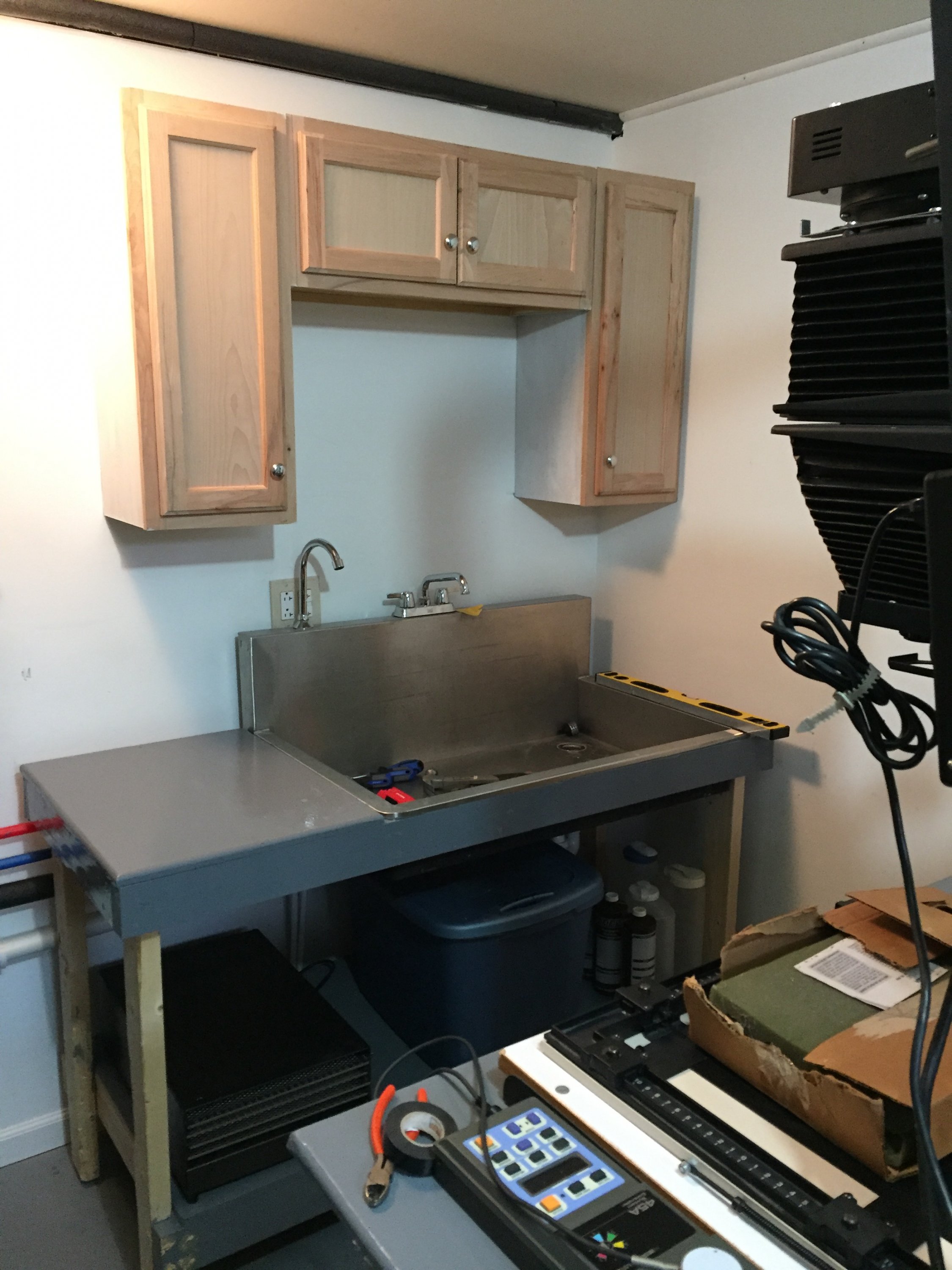

Got some cabinets installed over the sink, but I'm not sure I like them. Probably should have stuck to open shelving, which would have given me more storage space, but I was convinced I needed enclosed storage for my raw chemistry and lab ware. This is going to interfere with my slot processor too unless I turn it sideways and process front to back. Might have to relocate the print dryer and extend the sink shelf a bit. Dang...

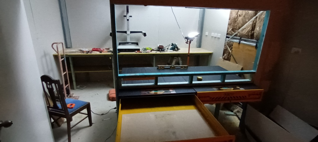

Finished the enlarger bench 3.9mtr Lx 1 Hx 0.8 D.
Will easily fit my L1200 and 1000 Dursts as well as a Meopta 3 and a copy stand.
Nice to have a bench at a proper height.
I bought 2x industrial slide out draws that will hold the trough they are 1mtr wide, 1.2 D and 0.2 H. Be able to store large photo paper mat board and other sheets. Also will be able to use the draws as a work bench.

Nice, nice!

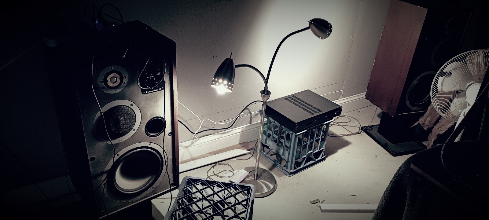

Also more importantly have the start of my hifi.
Unfortunately it's only yucky digital after I connected a router. Cat plugs are a pain.

I like the idea of cabinets; makes the place feel less cluttered, keeps dust out. I opted for shelves in my newish darkroom because of expense and the time it would have taken to build them.

Wow.....what speakers are THOSE.? :smile:

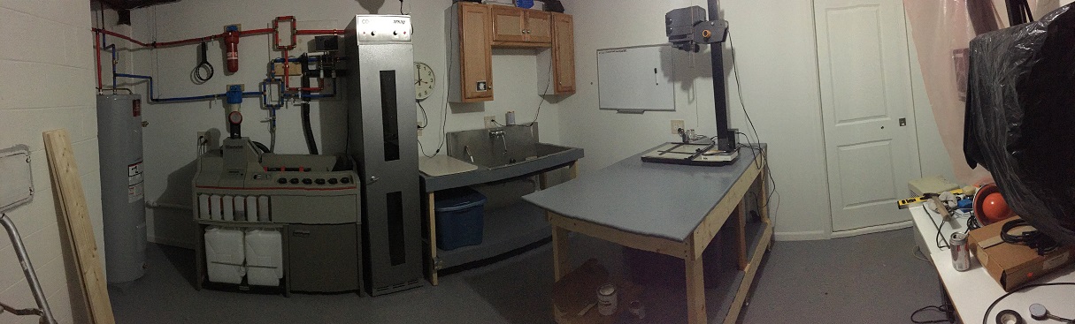

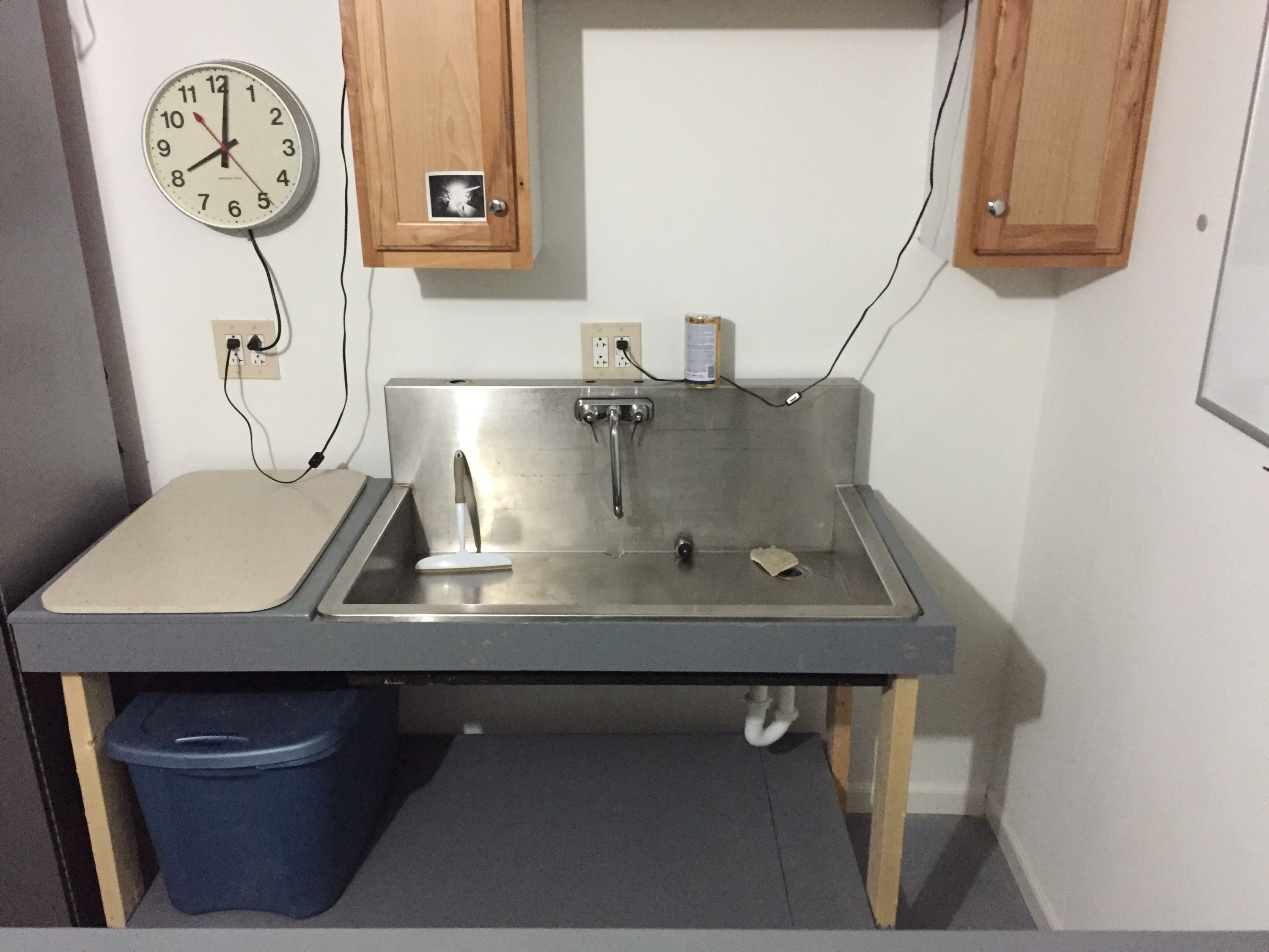

Getting real close to basic functionality on the wet side. Cut out my foot pedal valve, shortened my drain line and shoved it over about a foot. Relocated the faucet to the front of the sink panel (yes I have to cut off the faucet end to make it straight) and will fill the gap with a plywood cabinet for trays and other tall, skinny stuff.
Starting to feel like a darkroom to me...

Looking great, be a shame to dirty it up.

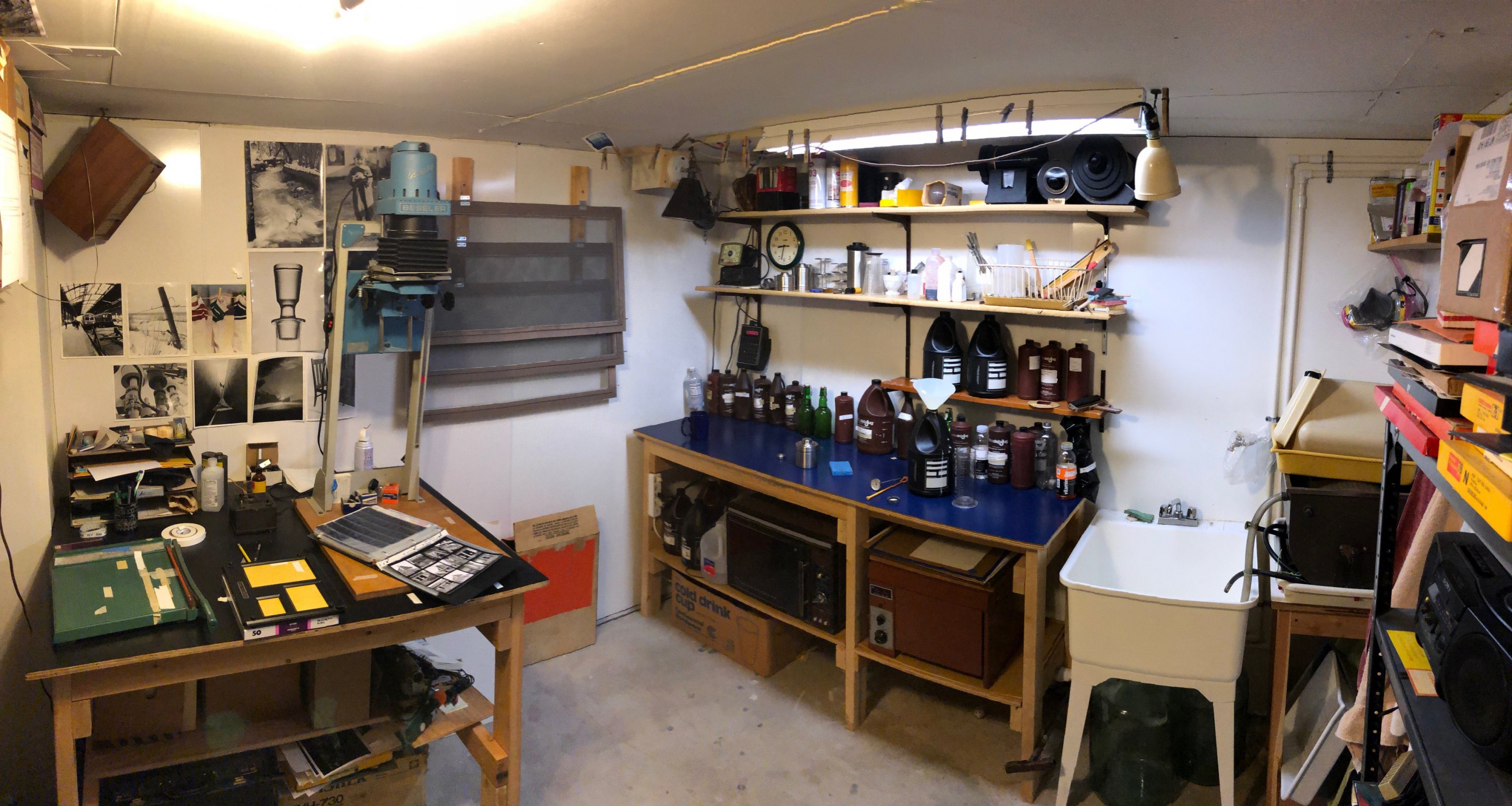

I finished replacing all the windows in my house (a multi-year project) and saved back a couple screens and repurposed them as print drying racks in my darkroom, shown in the middle of the photo on the back wall. They are hinged and I hook them to a chain that hangs from the ceiling. All parts recycled.

Very nice! Looks like a good working space. I am all for recycled items!
