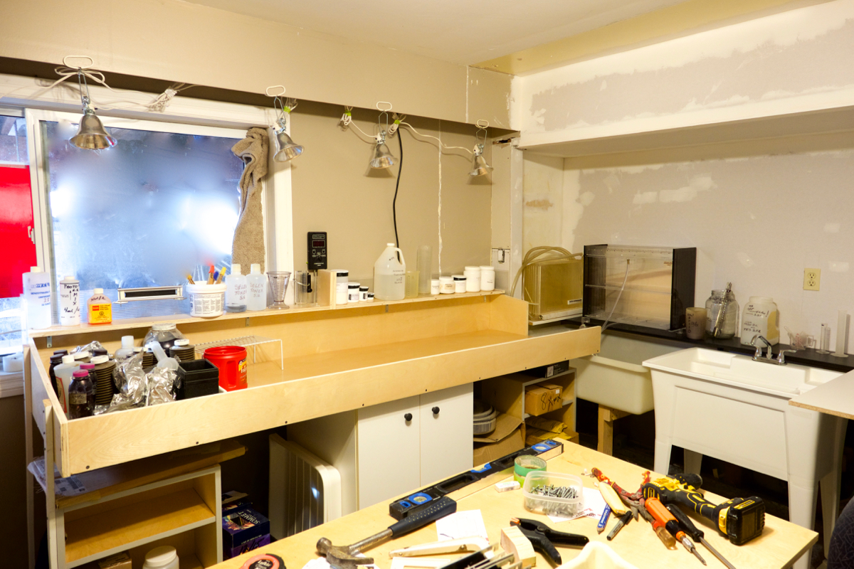

Nice! You have room for a desk! Remains to be seen if I can jam one into my space.
We put an addition onto our duplex a few years ago, which freed up the old master bedroom. Absolutely spoiled in terms of square footage.
This is about my 5th darkroom and is following the "You build your first darkroom for an enemy, the second one for a friend, and the third one you build for yourself" trajectory.

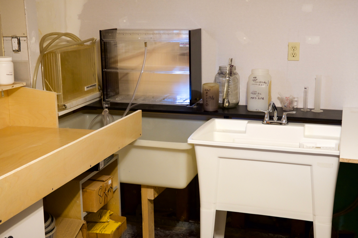

The foot operated water valve is pretty slick!
Your foot operated water valve is pretty slick!

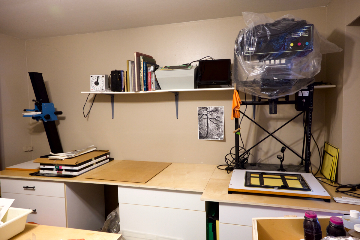

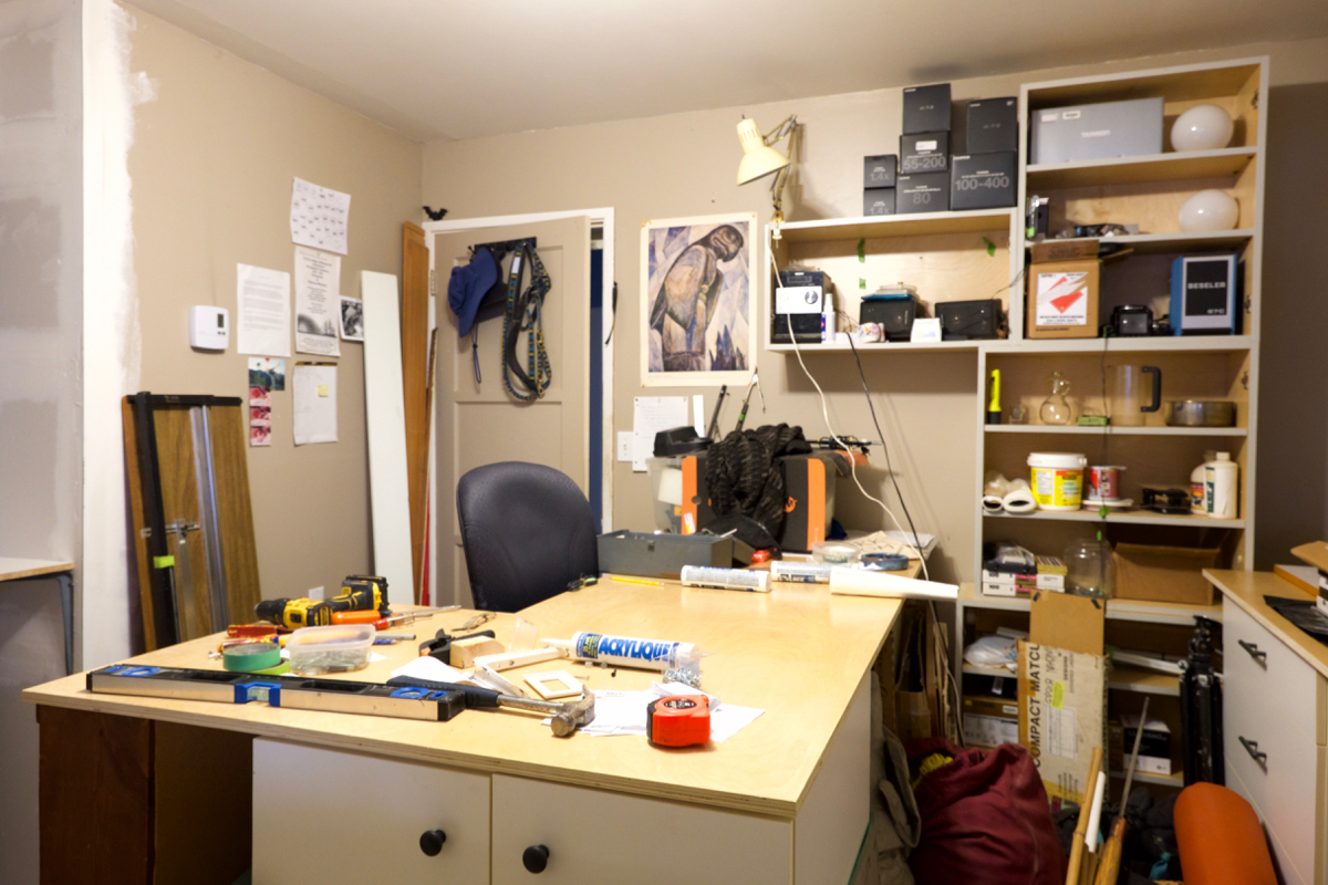

I hear you. This is my third "real" darkroom, not counting all the temporary bathroom setups I have endured in the past. It will undoubtedly be my last one I build, so I am trying to get it right, if not pretty.
As for the foot valve, the jury is still out on that; it might be a good idea or not but I had to try it after finding the valve on Amazon for cheap.
In total agreement on the functional over nice concept, which explains the three tier cascading into one drain Franken-Sink. It meshes with my Wabi Sabi nature. Water panel yet to come.
While drywall compound was drying, I just had to cobble thinks into place a bit. It'll look much nicer once everything has somewhere to go.
The gap between enlarging bench cabinets is where the UV light source will be going, with a heavy sheet of glass on a slide out shelf for contact printing.

I built my "last" darkroom at least twice now :D. Never say Never. I use a utility room today, it's huge, but can't really have drywall. I have 4x8 interior commercial restroom, white, panels. I'm lucky to have plenty of plumbing options. I have 2 big sinks with mixing valves. I need to insulate the hot water lines and run a pump to circulate hot water throughout my house. It's not bad in the darkroom, but I need to run 3+ gallons to get hot water to my kitchen sink. Drives me bats.
Yep, no drain. I figure if I can empty the drum every few uses, it won't be a hassle every time..
I've thought of running a hose through my yard, into my basement window, into my drain with a pump... Might be a bit much tho. :smile:
Also this will obviously be a darkroom only used for non freezing cold days, since the water is above ground hose. Still better than what I had me thinks.
I run a garden hose over to the clean-out cap on my sewer line from the 14 gallon drum I have the sink drain into. I have a sump pump in the 14 gallon drum and I threaded a 4" piece of 3/4 pipe into the cap. A pipe thread to garden hose adapter and problem solved.
I have been using a darkroom with no plumbing for years. I bring in water in 1-gallon jugs, used chemicals are put in jugs that I then send for hazardous waste disposal when I have a dozen gallons or so. I hold fixed prints in a large water bath tray until I am ready to wash them. Film and print washing is done outside near a hose & drains into the ground.
Same here! I put prints into water bucket after fixing to wait for wash. I mostly print under 8x10" so prints fit there fine.
Darkroom without running water is totally OK.
In total agreement on the functional over nice concept, which explains the three tier cascading into one drain Franken-Sink. It meshes my Wabi-Sabi-ish nature with garage sale finds and left over materials from other projects. Water panel yet to come.
While the first application of drywall compound was drying, I just had to cobble things into place a bit. It'll look much nicer once everything has somewhere to go.
Looks great to me.
How did you waterproof your trough? I used waterproof pond paint on my last one, think I will do the same again.

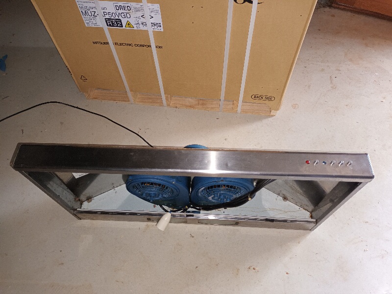

What are you using for ventilation? I picked up an old stove range hood with 3 speed twin exhaust fans for $10, should do nicely.
Looks great to me.
Pond paint sounds like a good idea to me, so might follow along with you on that one. I got a good deal on 3/4" lacquered both sides birch plywood, so that's what the sink/trough, enlarger bench, and desk tops are made of. I'll leave the bench & desk as is because it's a really nice surface for that, but the sink/trough will need something.
I use a Glycin developer and it stained my old darkroom sink with diffuse brown splotches, so maybe I'll look for a matching or darker brown paint.
As for ventilation, I hadn't given that much thought yet.
Is very nice timber shame to mess it up. Thought you might of been using something clear. Pond paint has worked well for me, just do a recoat every 18mths. You may want some slats so the trays dont wear through the water proofing.
Maybe you could fit an exhaust fan on the sliding window on a wooden panel.
...Maybe you could fit an exhaust fan on the sliding window on a wooden panel.
Good idea. Will give it a ponder...the temperature will be dropping to -20C in a few months so it would have to be designed not to let that kind of cold creep into the house when the fan isn't running.

Also you need to keep the light out as well. I don't have a problem with it being too cold. I'm going to have to work out a light trap, but I think this should work well.

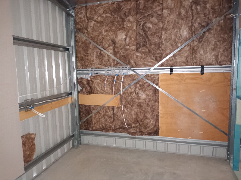

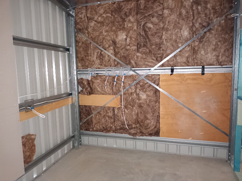

Also the Sparky came today to run the wires around. Next week I will hopefully have some power and air-conditioning. :smile:
