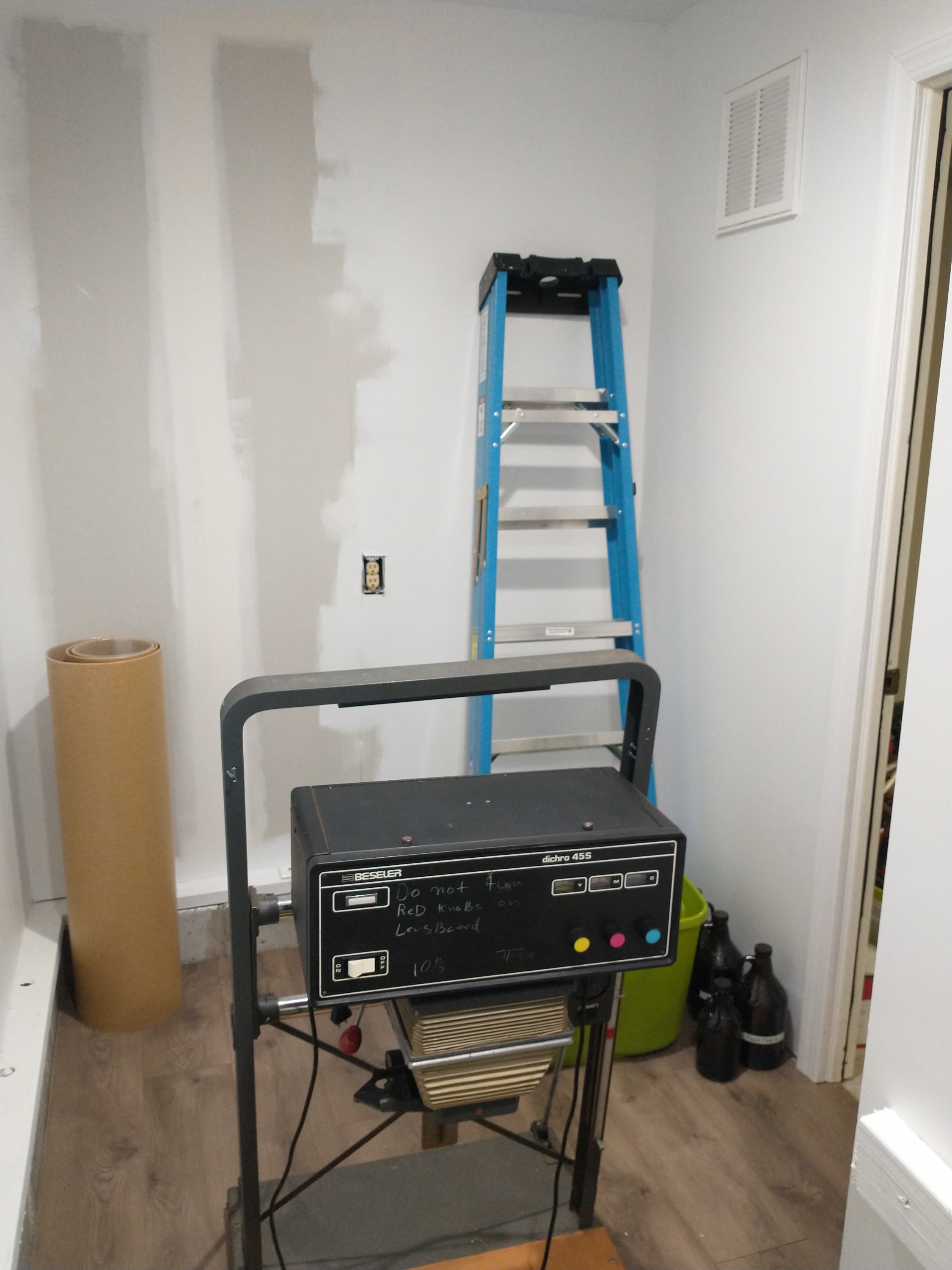

Do you really "care" what your walls look like.?
That is ...............if you just fire-tape what you have up, and then prime and paint the walls, will it matter to you that the drywall is not "Finished".?
As long as it doesn't collect dust, why not leave it just painted.
Don't take this the wrong way but, after 50 years of making do with crap facilities and makeshift equipment, I would like to have something nice I can take a bit of pride in owning.
Don't take this the wrong way either, but most of my darkroom time is spent in the dark, so it doesn't matter much to me. Darkroom time with lights on is for inspection, mixing chemicals, processing film and of course cleaning.
This will be a multi function room, so it needs to be more presentable if to no one but me.
After building and finishing it, you will probably want to just sit in it and smile with happiness....
So it may as well be nice looking!
Keeping in mind, that of all the drywall finishes, smooth-wall requires the most skill...........
.......... just go ahead and sand it. and sweep/vacuum the dust.
"Wet-Sanding" was never meant to be a replacement for "normal sanding".
It is fine for a small areas, or something up high.....places you will not see too easily.
But if you want this to look nice, just go ahead and sand or...............do you have a compressor.?
You do not need to sand. Tape and Top, Knife it down if needed...Rent or buy a hopper and just splatter texture the walls...no sanding necessary.
Good Luck :smile:

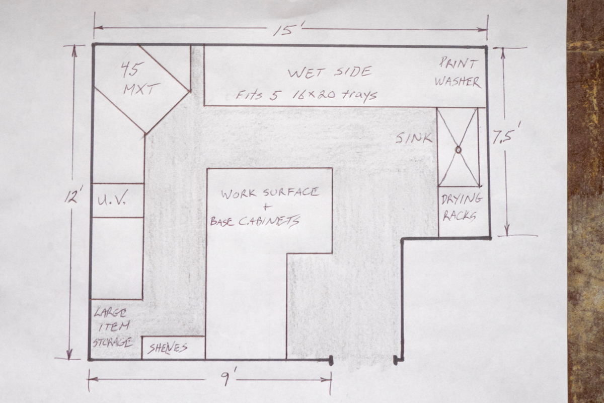

We built an addition onto our house which freed up the old master bedroom for a darkroom. It backs onto the laundry room, so water will be easy. It's main use will be for alternative printing/exploration, but silver gelatin prints will also be doable.
Been chipping away at it for a while...putting photos here is an official firming up of the commitment factor. Must be sure to maintain forward progress now!!!!
Basic layout
Enlarger will be in corner, sink will be about 4' to right of print washers
UV light source & contact printing frame is going between cabinets under books. Will use 16x20 max paper size.
Looking into sink area which was the old bedroom closet.
Now all I need is a cheap plywood source for the cabinet tops...

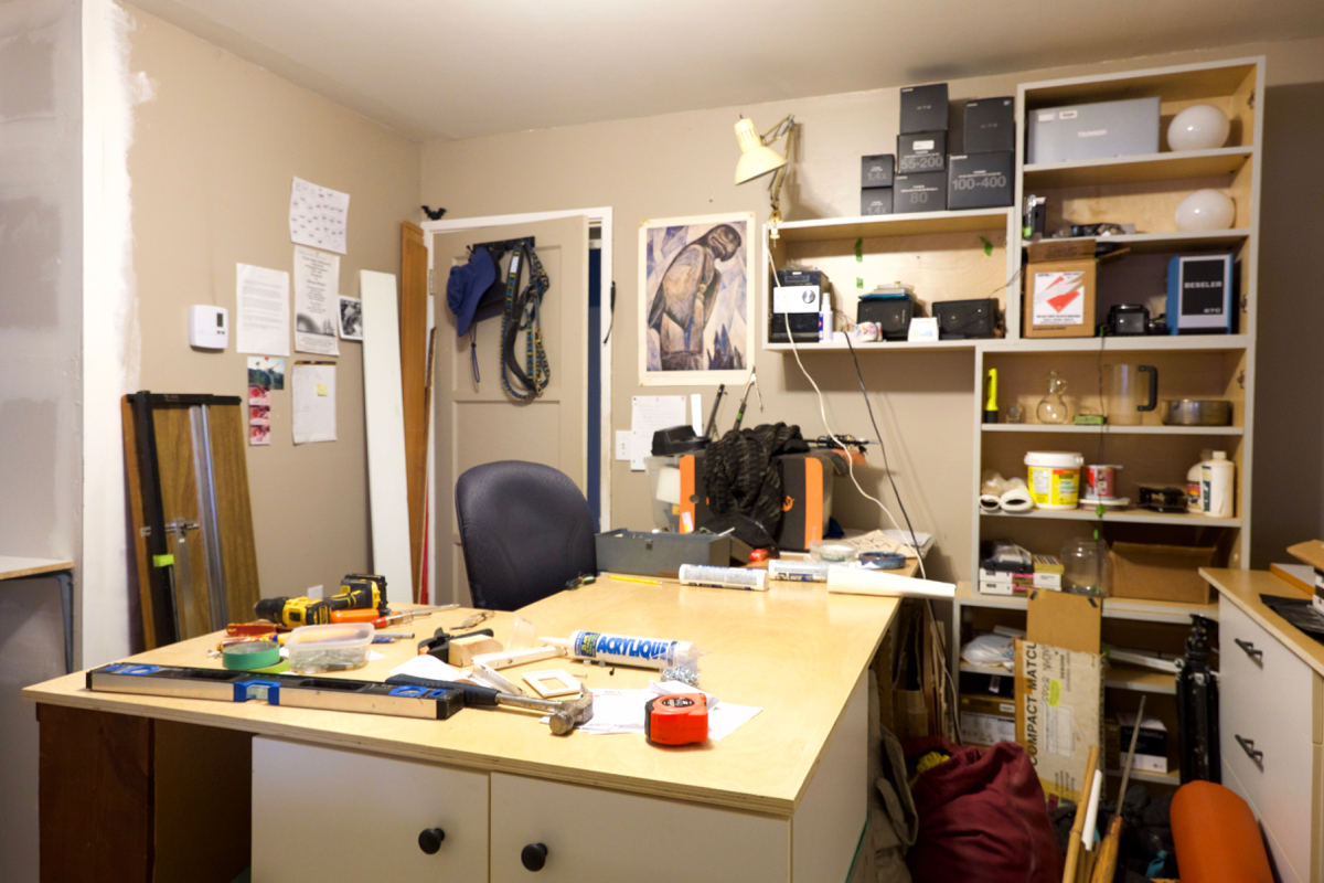

Update:

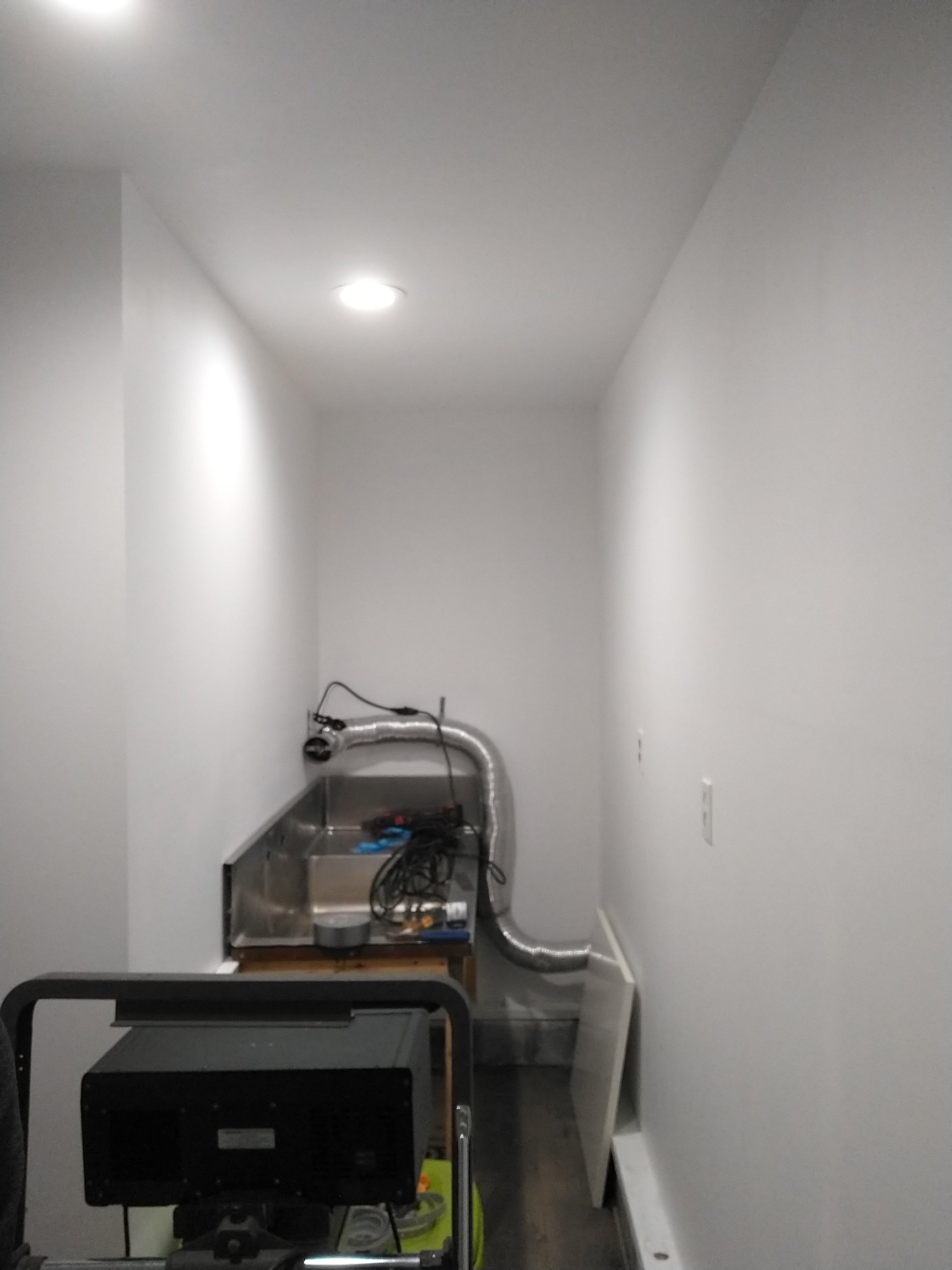

- extra shelves here and there, warm air outlet for AC, walls painted in the enlarger area
20210613_170446.jpg 20210615_140009.jpg 20210627_005509.jpg 20210627_005159.jpg 20210627_004920.jpg

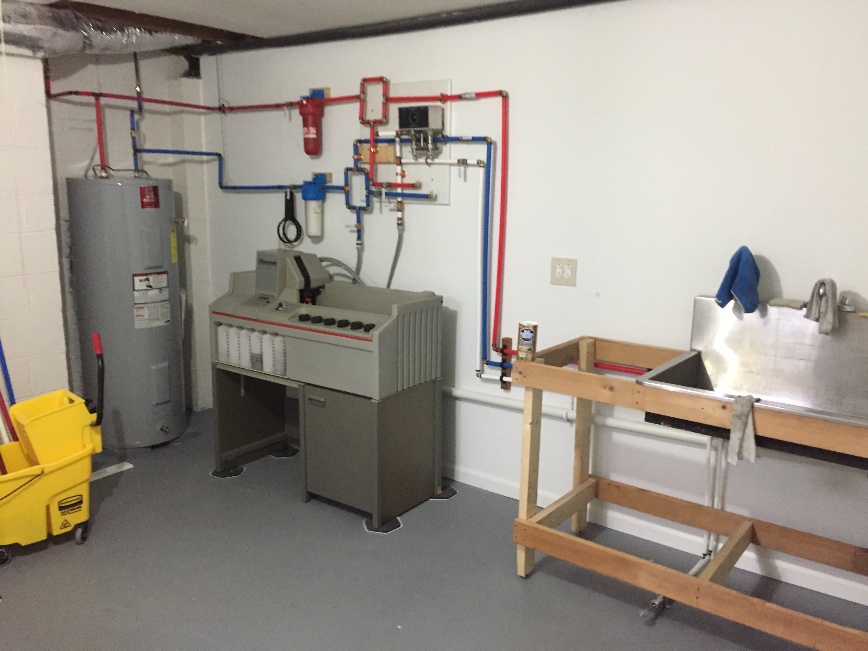

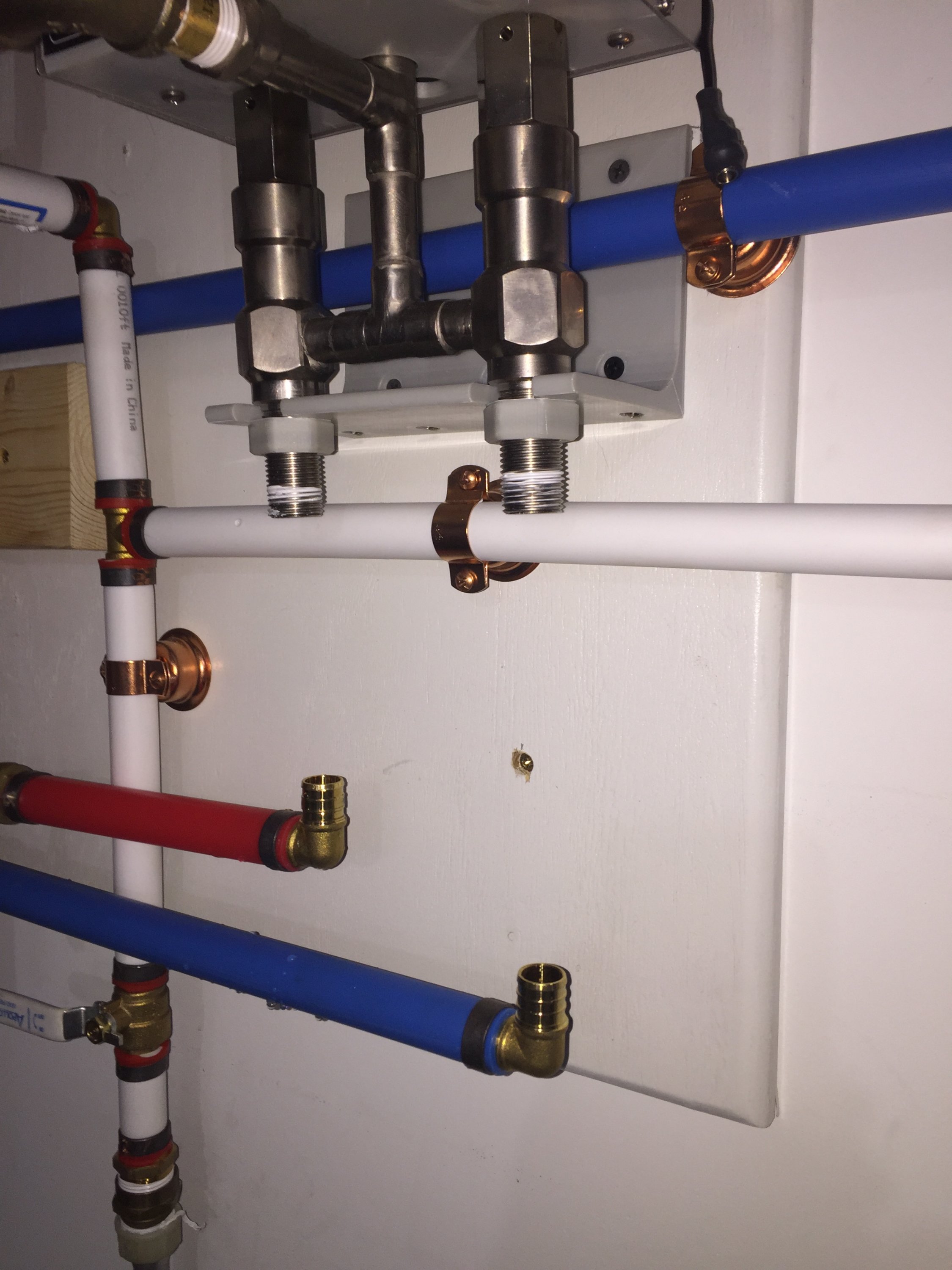

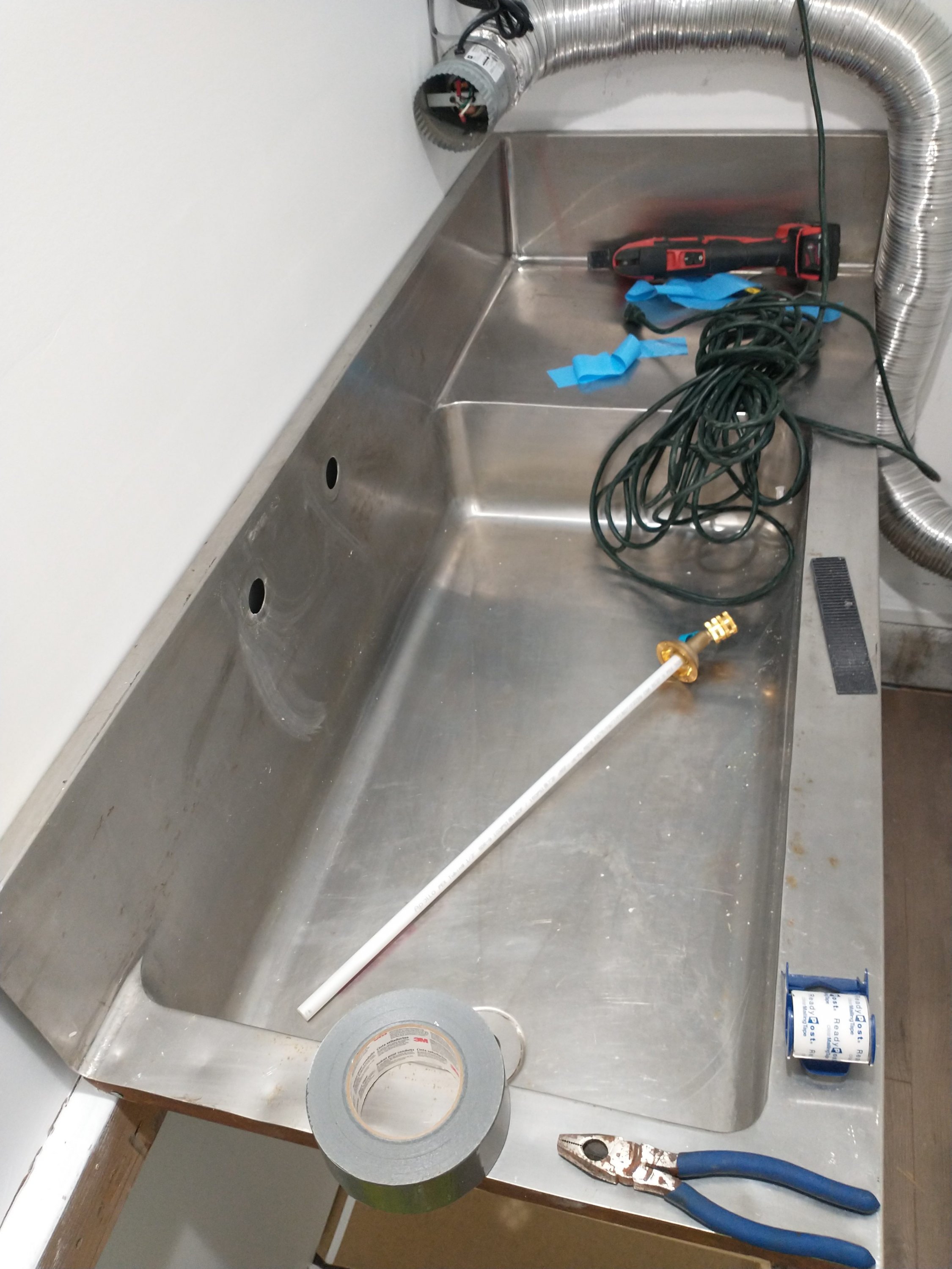

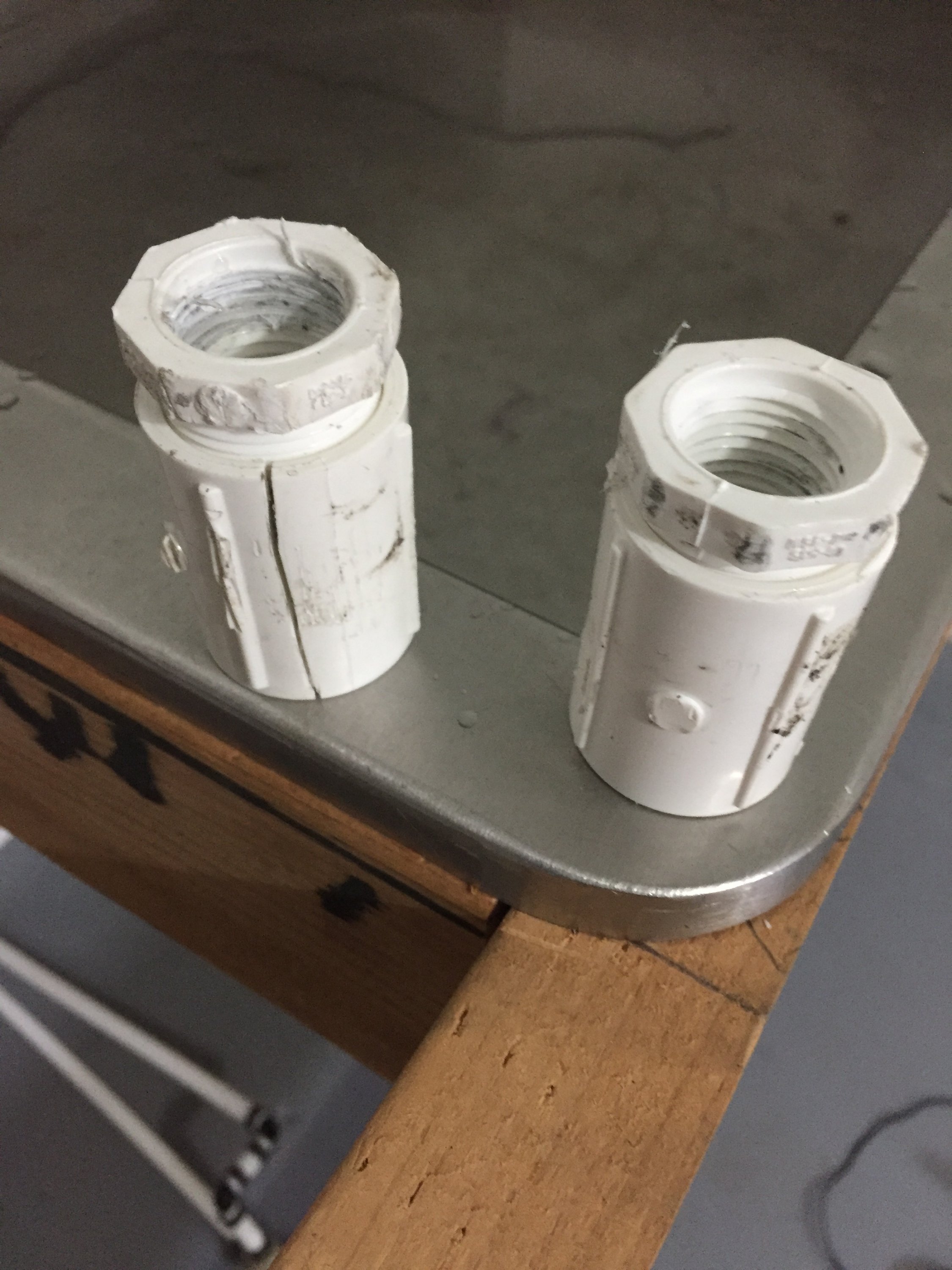

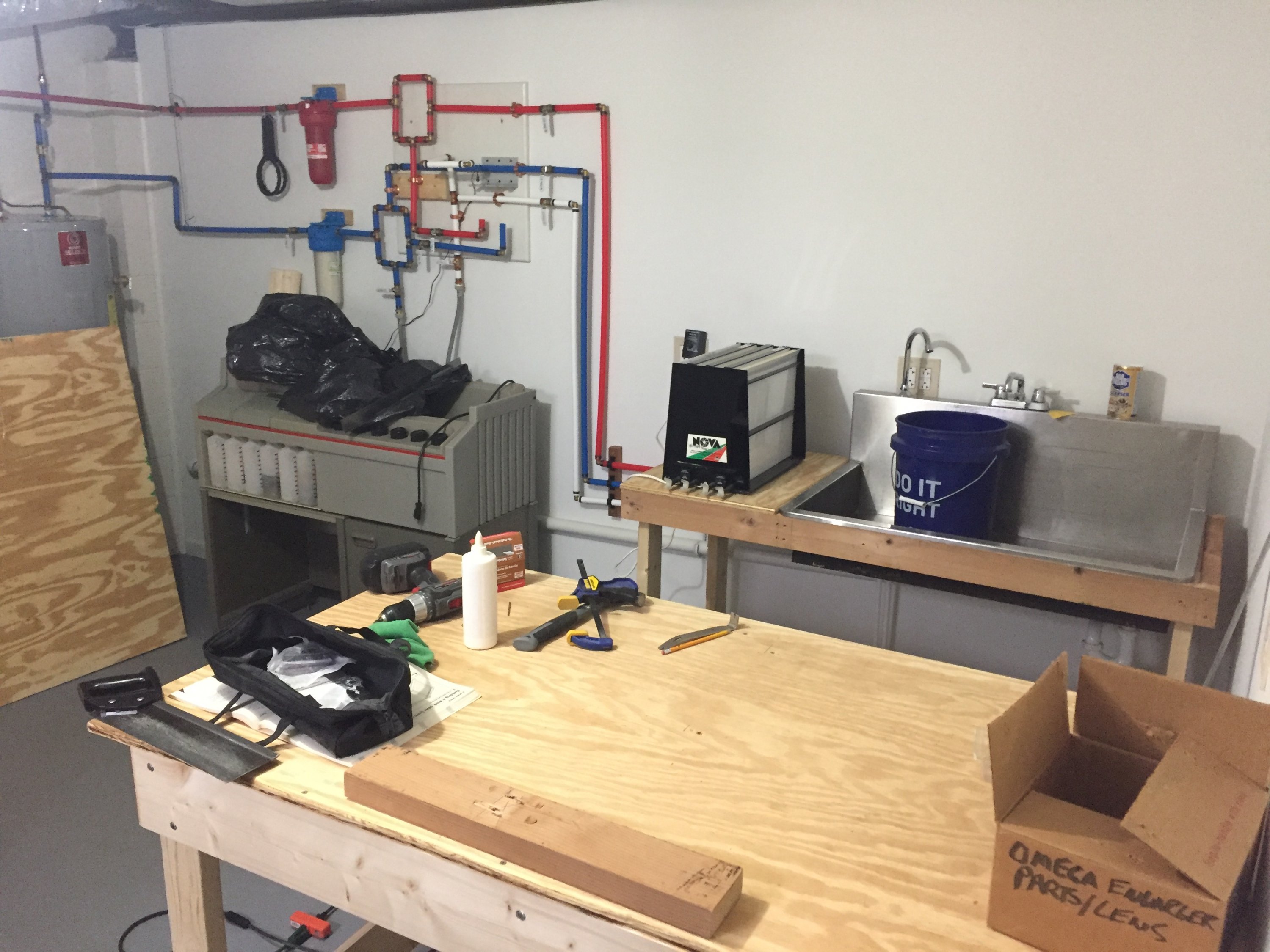

Taking far too long, but at least I have a temporary sink, running water and a functional drain in the room. I had several adventures with faulty check valves, burst connectors and other plumbing fun. Thought I was nuts putting so many shut off valves in the mix, but am glad I did because the PVC connectors on my mixing valve had cracked during installation unbeknownst to me and I was able to isolate it and shut it off instantly when the water started flying.
Now I just have to replace these PVC connectors to be fully functional (I hope). Very sorry I couldn't run the Jobo through it's cleaning routine, but that should happen within the next week.
Tons more to do; cabinets, shelving, enlarger stand, and so on, but just having the ability to process a roll or two very soon is encouraging...

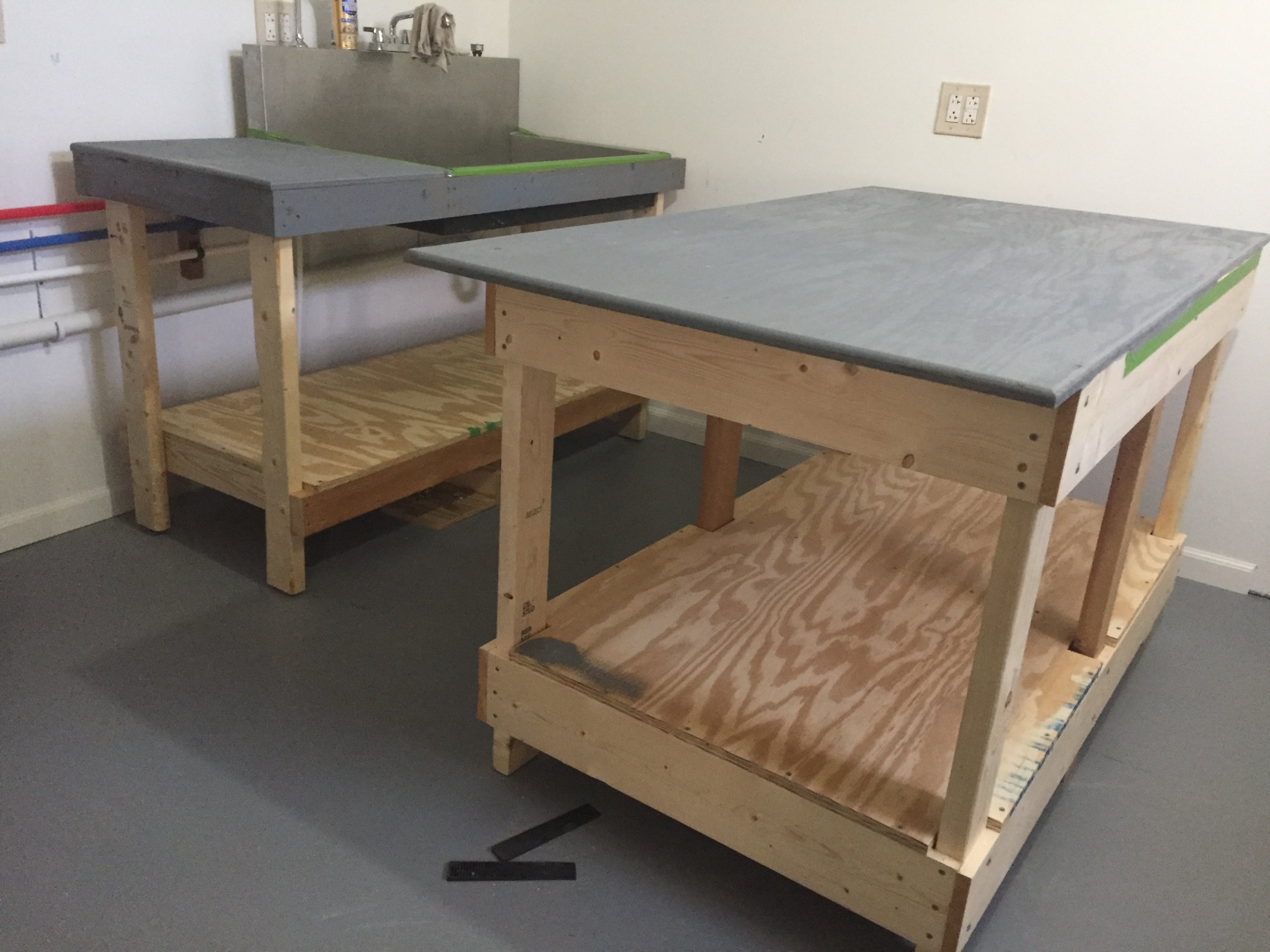

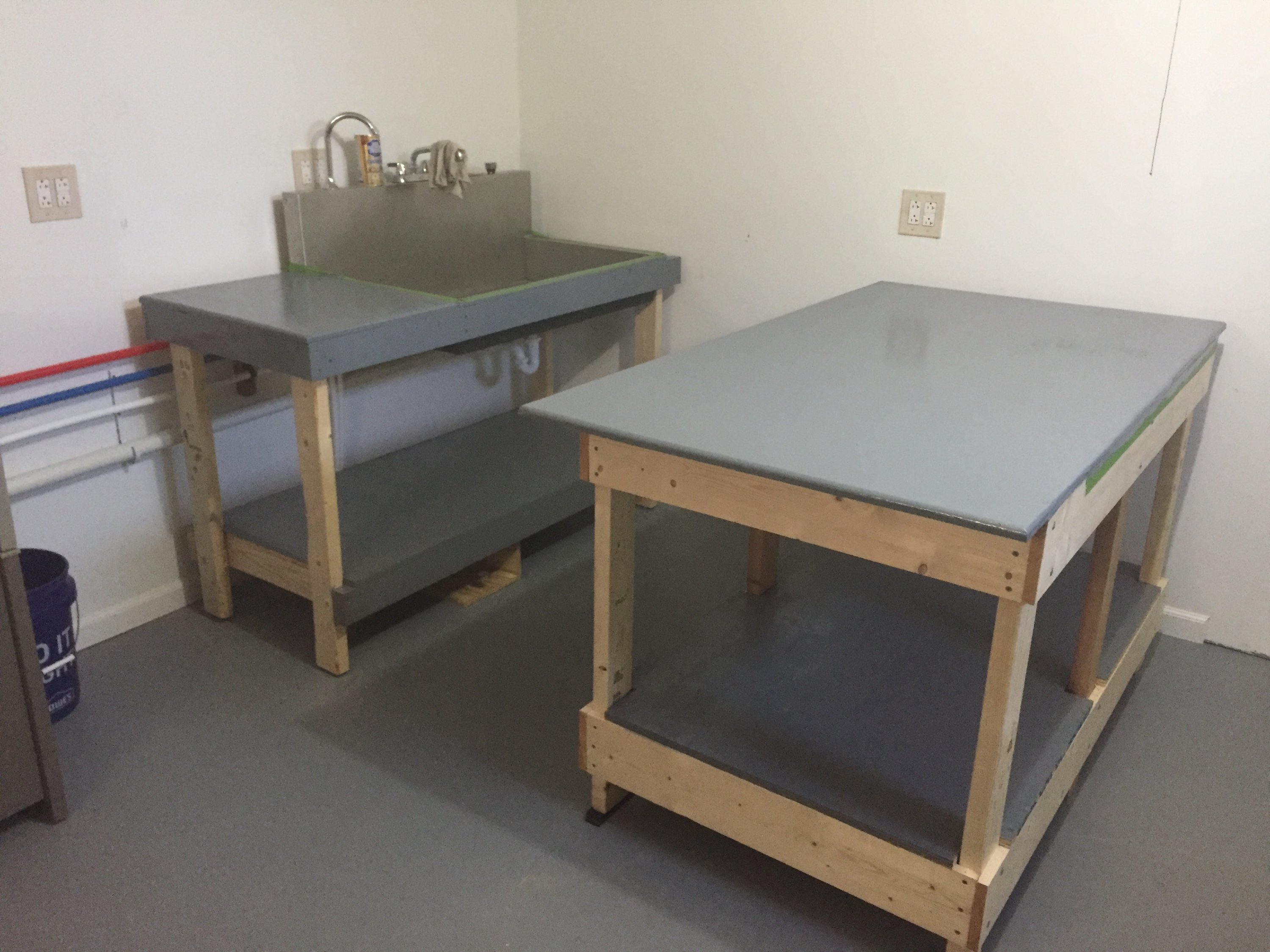

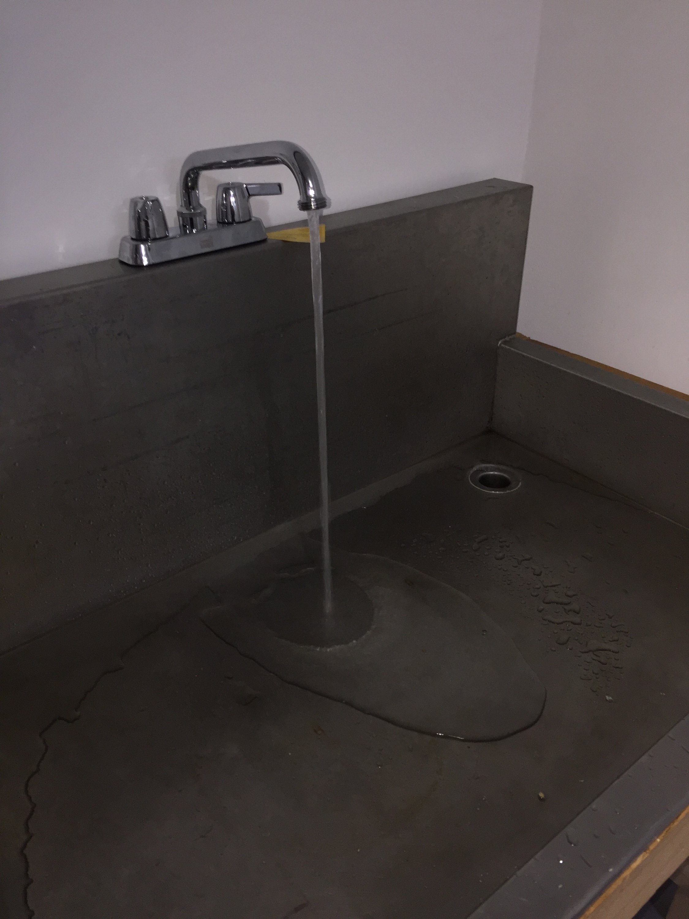

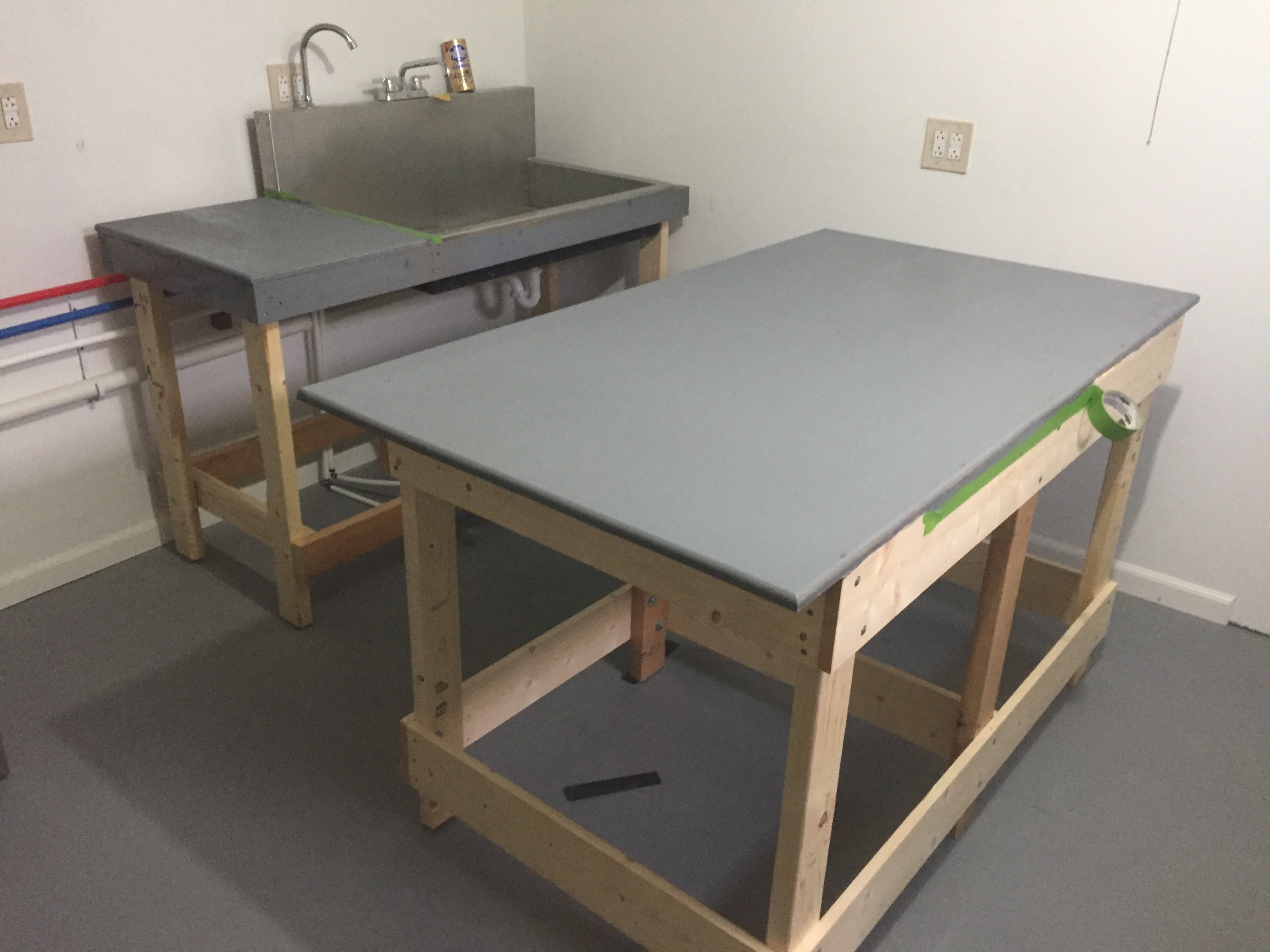

More progress. Gave up on making it "nice", going for functional. Got my enlarging bench constructed and the first coat of paint on it and the sink top. Waiting on the return of my Intellfaucet from Hass. Had to send it back twice for leaks; hope they fix it this time. Shouldn't happen with a new valve...
View attachment 289571 View attachment 289572 View attachment 289573
Looks great. Slot processors are genius! Intellifaucet once right will be amazing. Nice Jobo!

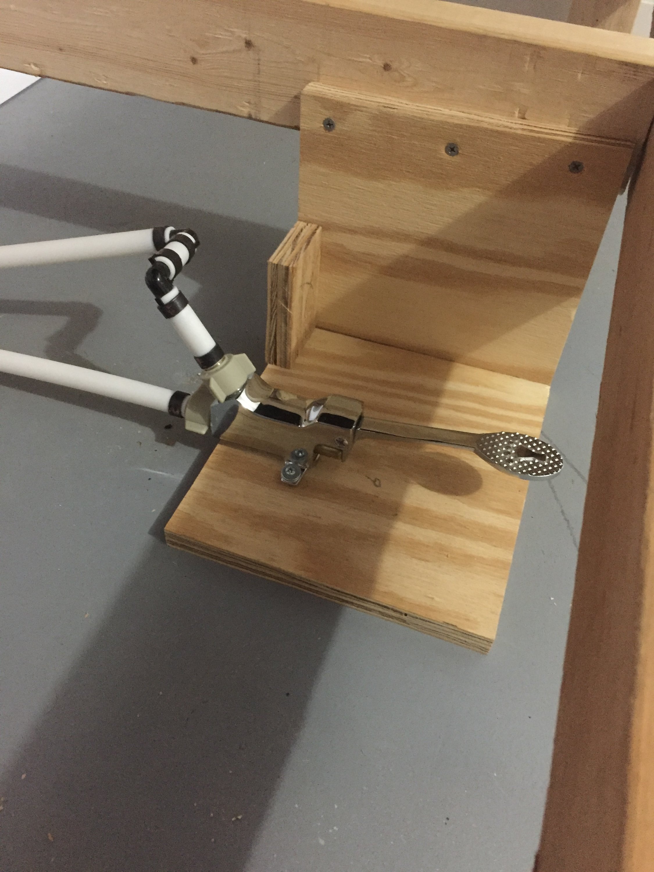

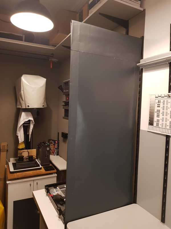

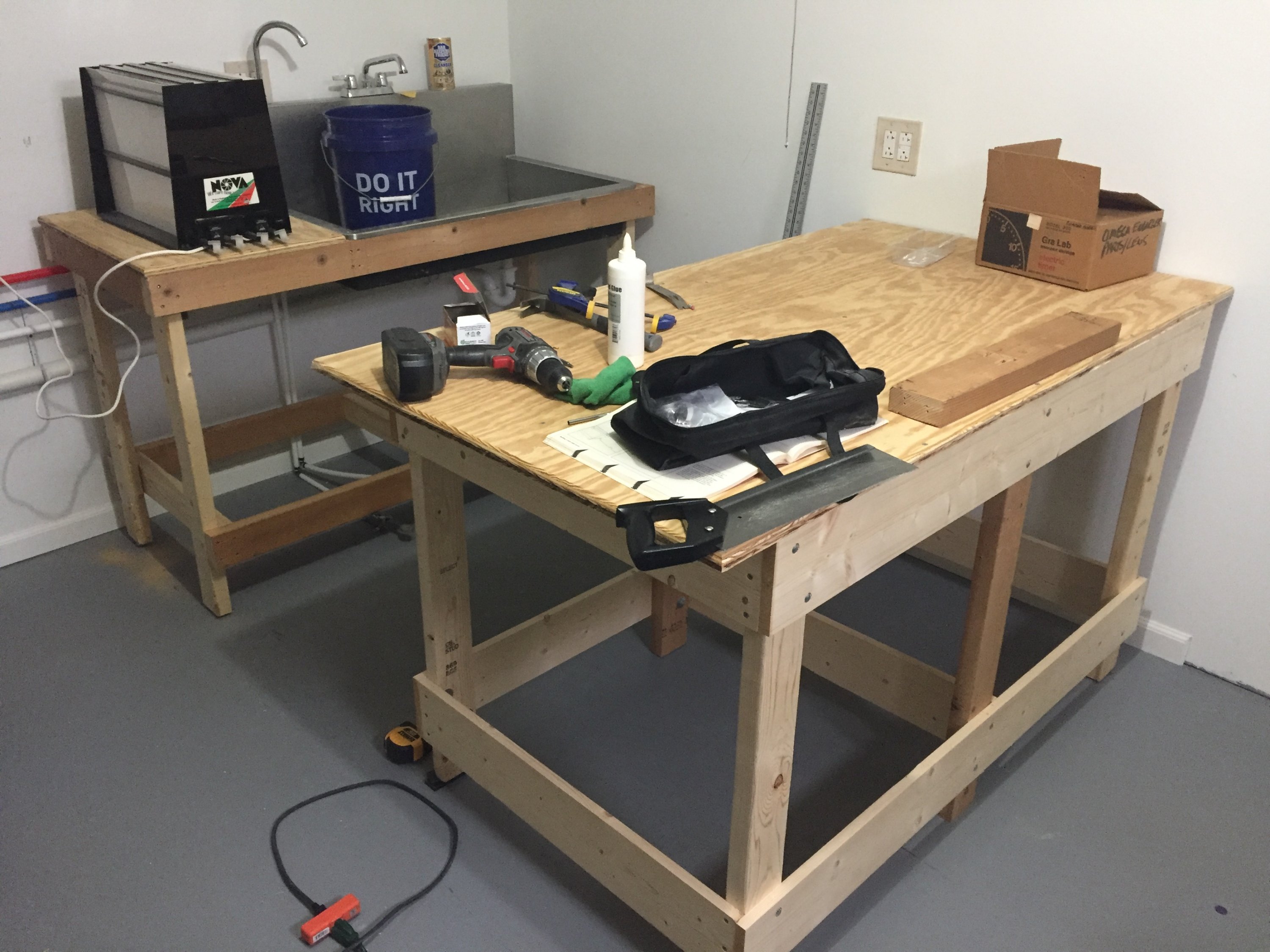

OK, final update for this weekend; fabricated a mount for my foot-pedal water valve that will dispense tempered water to the sink and cut/installed and put the first coat of paint on the bottom shelves for both the sink and the enlarger table. Talk about over-engineered; 18mm (23/32 in.) plywood and a bucket full of drywall screws. I could park a tank on the enlarger bench and it wouldn't blink! As long as I don't have Earth tremors, I should have a stable enlarging platform...
In total agreement on the functional over nice concept, which explains the three tier cascading into one drain Franken-Sink. It meshes my Wabi-Sabi-ish nature with garage sale finds and left over materials from other projects. Water panel yet to come.

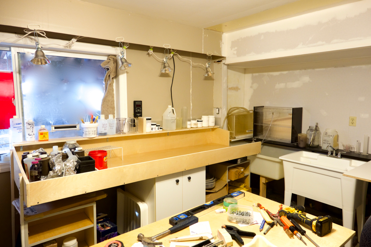

While the first application of drywall compound was drying, I just had to cobble things into place a bit. It'll look much nicer once everything has somewhere to go.
The gap between enlarging bench cabinets is where the UV light source will be going, with a heavy sheet of glass on a slide out shelf for contact printing.
