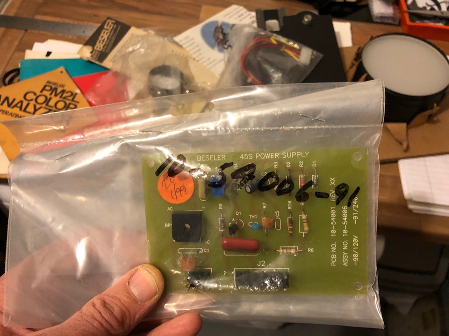

I have the new board unfortunately! But, I was thinking along the same lines as @CMoore about bypassing all the white light stuff etc and just controlling the lamp from a timer especially as the fan still works. The solution from @John51 seems worth looking into though I have no electronics/ electrical knowledge!

The "can" part pictured by @mshchem appears to be a bridge rectifier, which would be the black square with a clipped corner on the new style board. If the failure is the same (and rectifiers like that do fail; I have to replace one every so often on hoist motors I repair), it shouldn't be difficult to get a replacement for the black one -- the old "can" part might even fit (hard to be sure what the pin spacing is in two different photos, never mind without seeing the solder side of the board).
I THINK it is more of a LDR or some kind of Light/Opto activated switch.?
Opto-isolator, perhaps? Those were a lot smaller by even the 1990s.
The part is a Vactrol, made by Vactec, catchy with their naming, aren't they?
Inside it is made from a lightbulb and a CdS cell. They were the opto-isolator of the 60's. Naturally, the light bulb burns out over the years.
https://www.datasheetarchive.com/pd...b2c065aa725cddb49b897e3238&type=O&term=VTL9B8
Used in guitar amplifiers to provide soft limiting - the lightbulb is driven by the amp output, if it glows brightly then the input is turned town by the CdS cell. (Or, maybe it was the other way 'round - keeping the music LOUD (insert smiley as needed - I hate the things)).
I used to know what function they served in this head but it quite escapes me. It could have been as a simple opto-isolator.
If someone else has a replacement available then that is by far the best solution to the problem.
The can is an optoisolator there are 2 on the old version. Beseler repaired some of these with as you have noted a little black cube. All this is on the older heads. The head in question, of Mr Miller's is a newer head, Beseler did a nice job on these. I don't think there's a iso in the newer version.

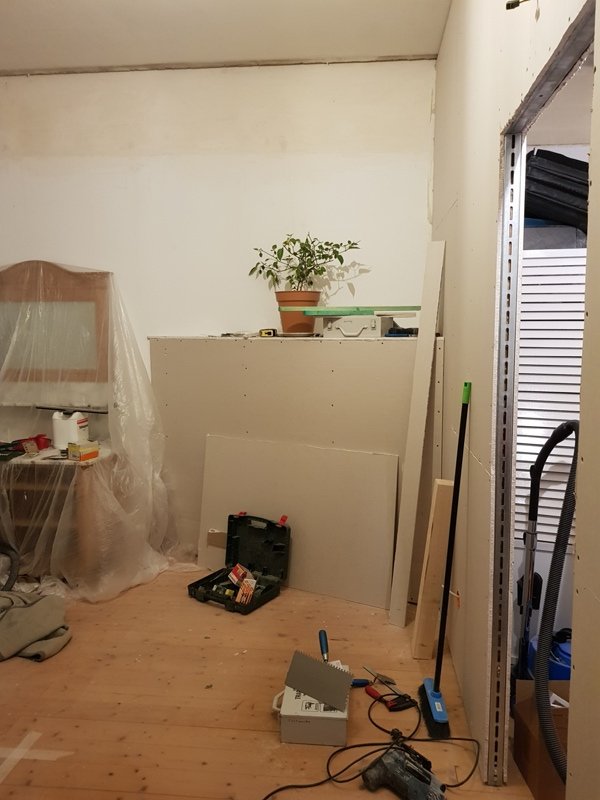

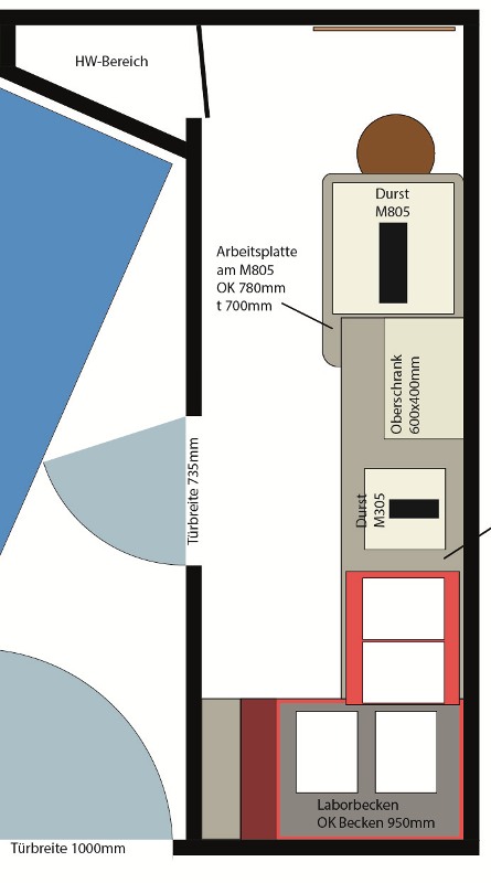

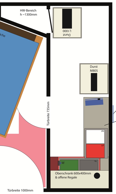

I startet building my darkroom in November last year. Measuring just 14ft x 4 1/2ft space is quite limited. But it´s app. 10ft high, so I´ll build storage space under the ceiling. And the right wall is the wall to the kitchen - water and kitchen hood in easy reach!
The original plan showed mostly benches, but I decided for more flexibility with only a minimum permanent workbench and all boxes, enlargers, workspaces on wheels for a maximum of flexibility.

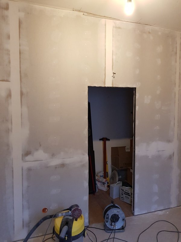

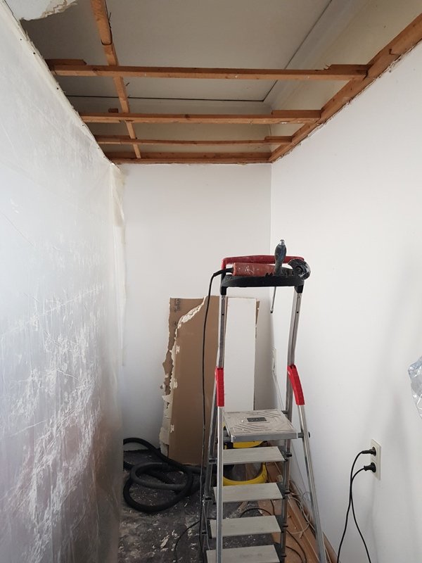

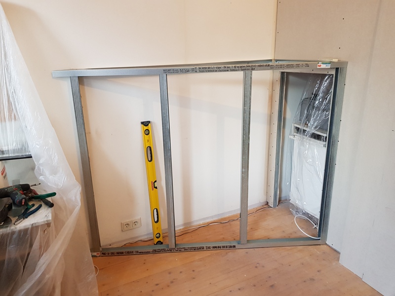

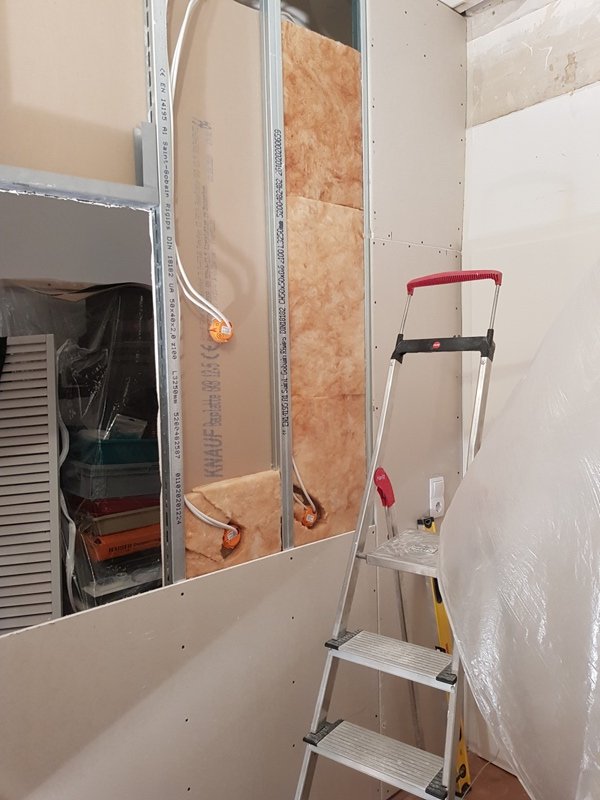

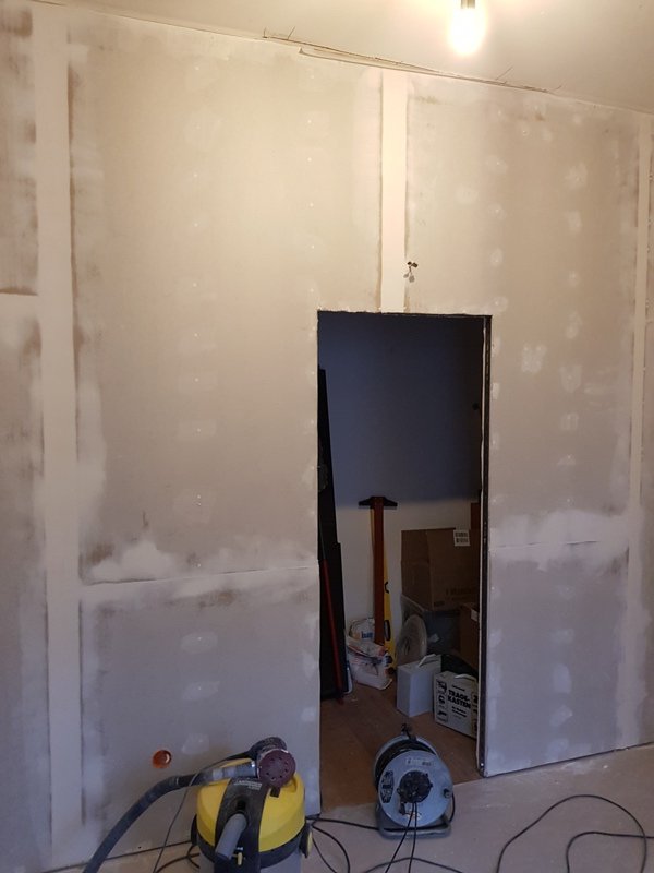

First practical steps were removing the old suspended ceiling and building the drywall construction including wiring, pastering walls etc..
20201108_103858.jpg 20201121_192226.jpg 20201121_211855.jpg 20201128_154054.jpg 20201128_204754.jpg 20201206_105005.jpg

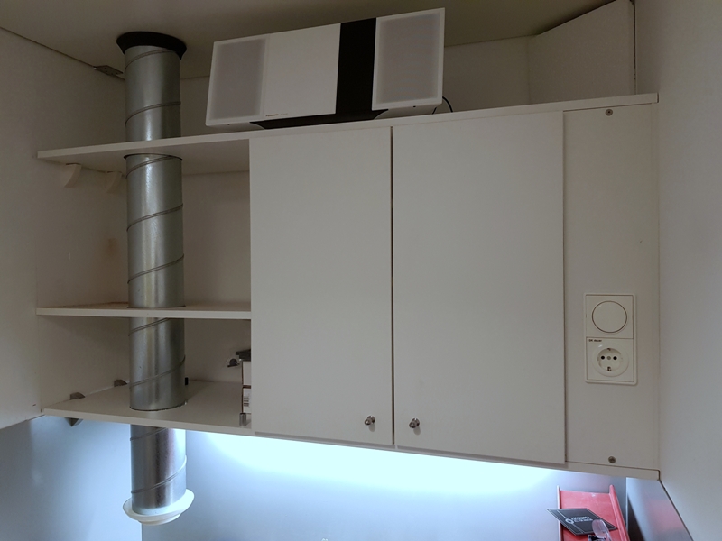

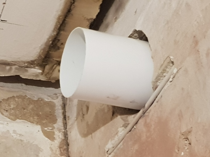

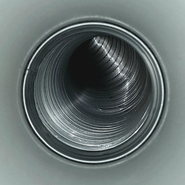

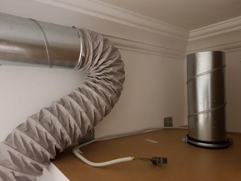

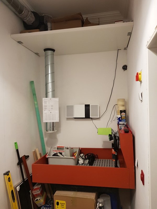

December 2020 - air exrtraction. The kitchen hood (which ends outside the building) is just behind the wall, so...

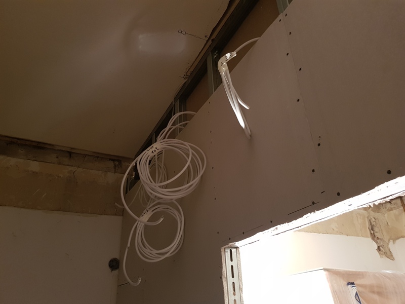

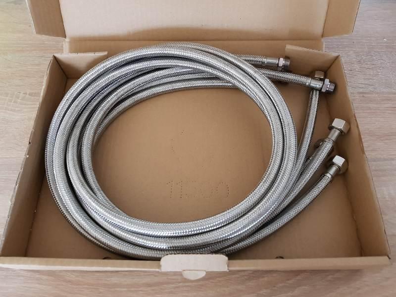

Installing the hoses...
WhatsApp Image 2021-01-06 at 17.02.59.jpeg WhatsApp Image 2021-01-07 at 20.12.54.jpeg 20210109_122714.jpg

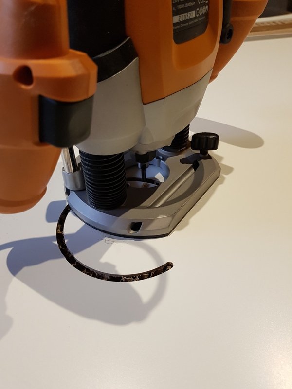

Cuttibg holes in shelves for the hoses...

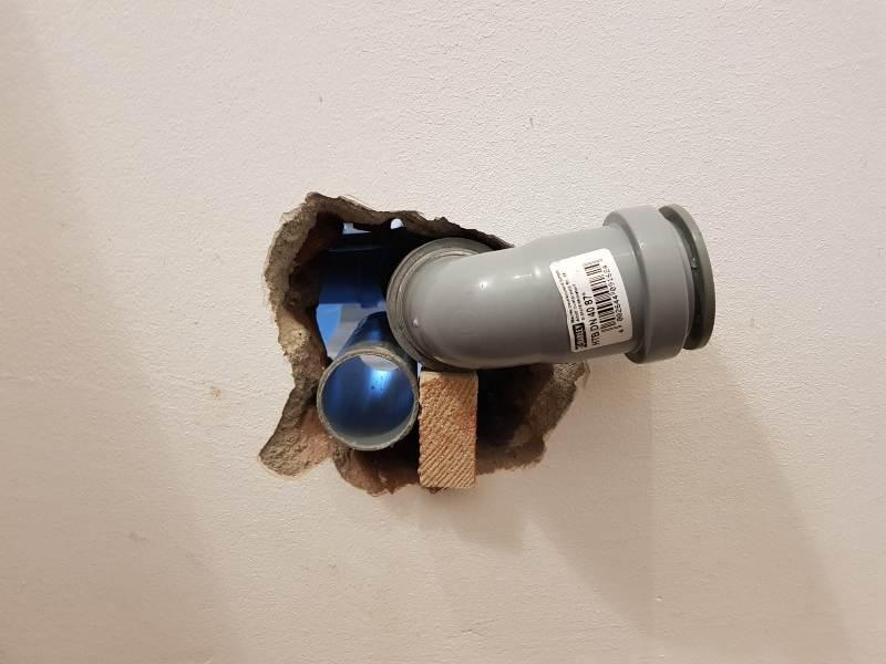

It´s a few days before Christmas. More holes in direction of the kitchen. Water is the goal. Hilti helps. My neighbours start to hate me...
WhatsApp Image 2021-01-04 at 12.39.19.jpeg WhatsApp Image 2021-02-20 at 15.45.25 (1).jpeg 20201123_180527.jpg 20210213_135230.jpg 20210213_135303.jpg

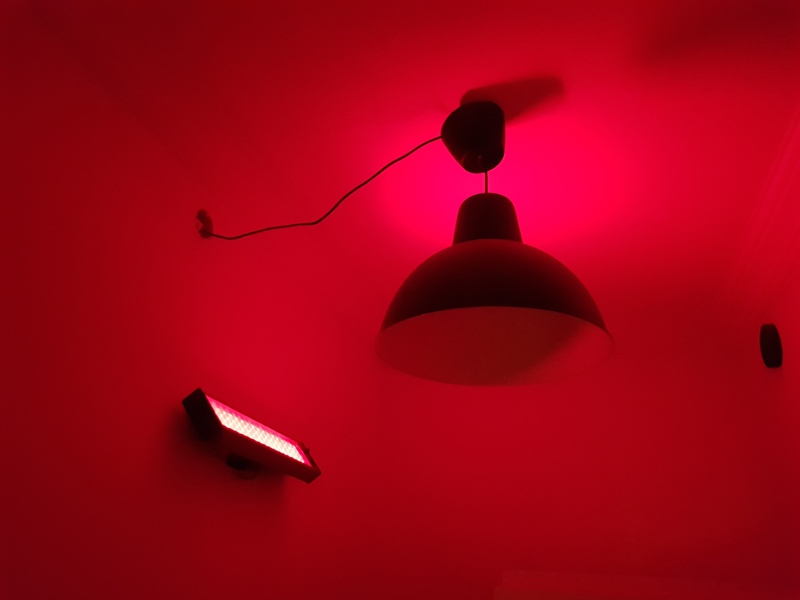

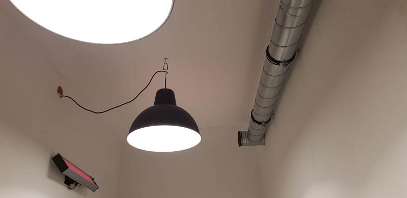

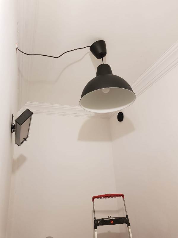

Light - I need lights. Even in a darkroom...

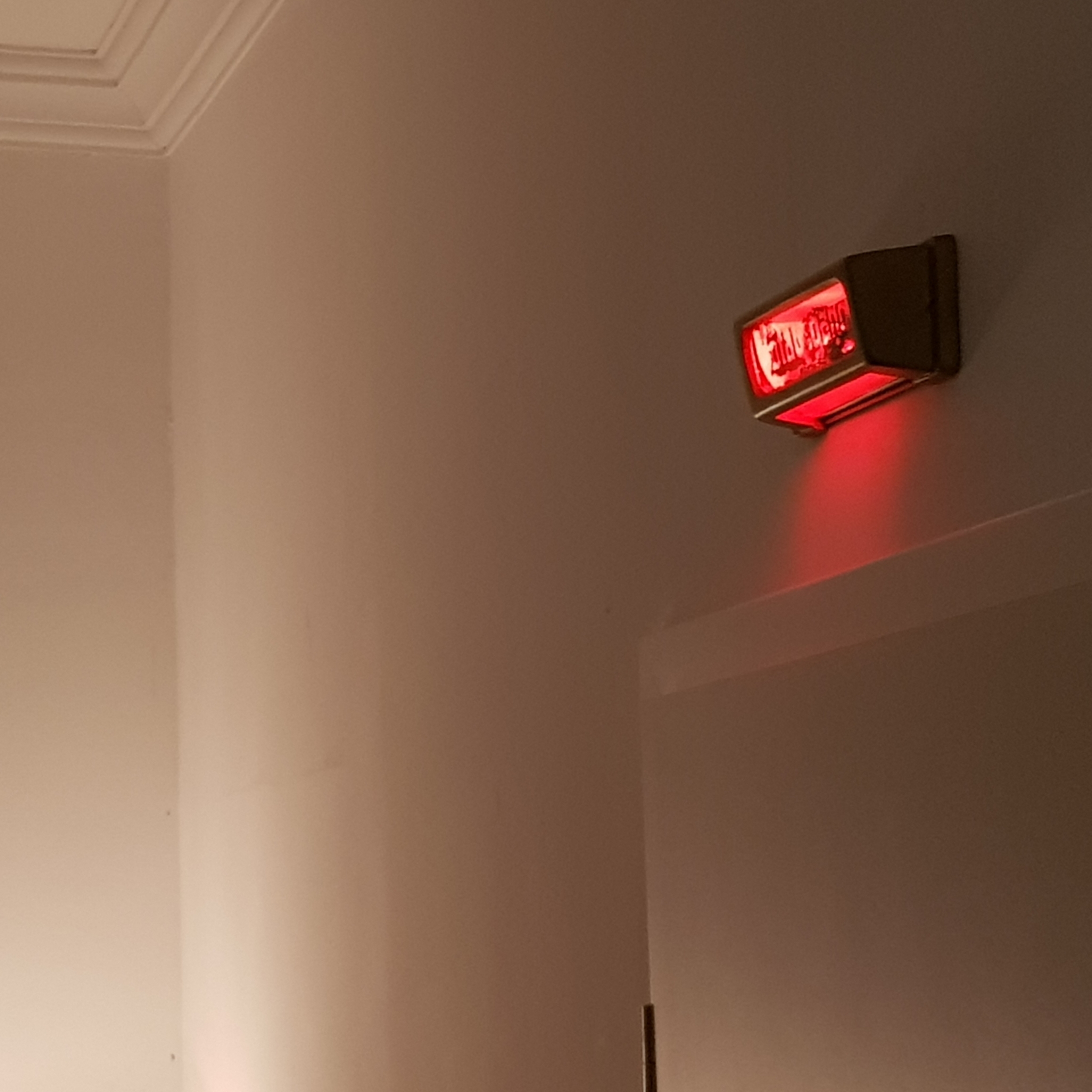

The old emergency exit sign is connected to the red light inside the dr and warns my kids to come in accidentally...

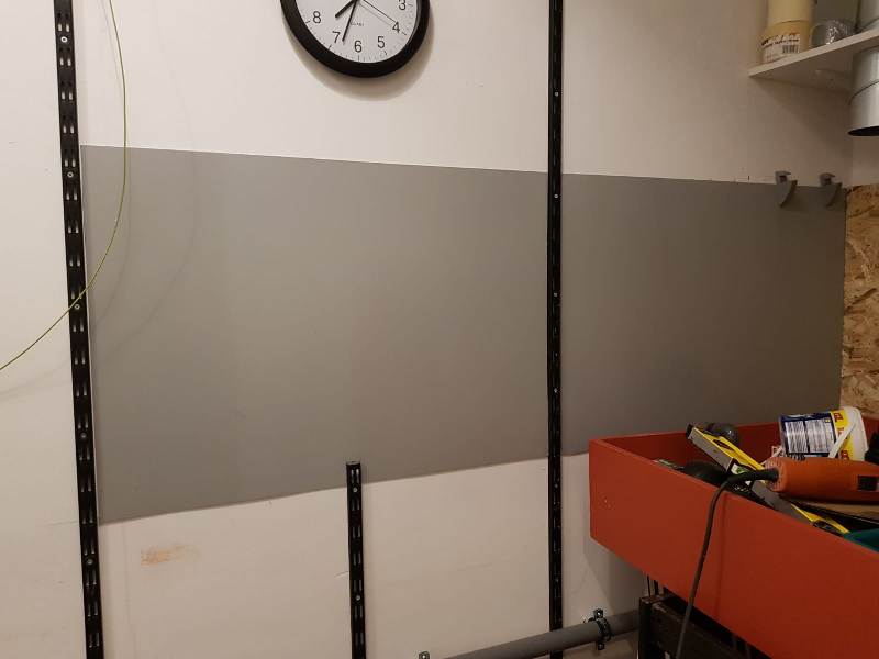

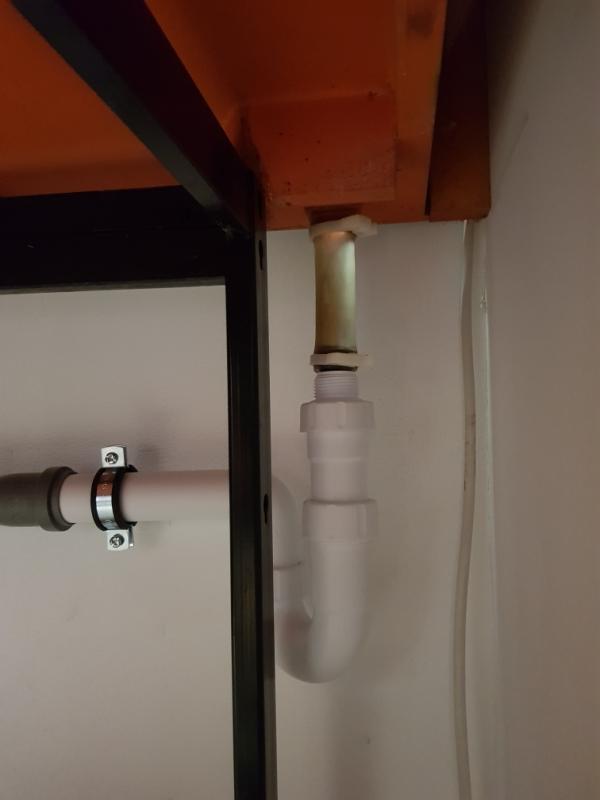

Walls are cladded with 2mm PVC sheet, shelf rack system for the workbench.

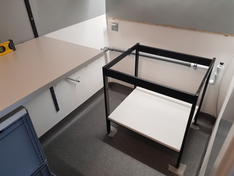

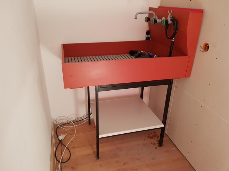

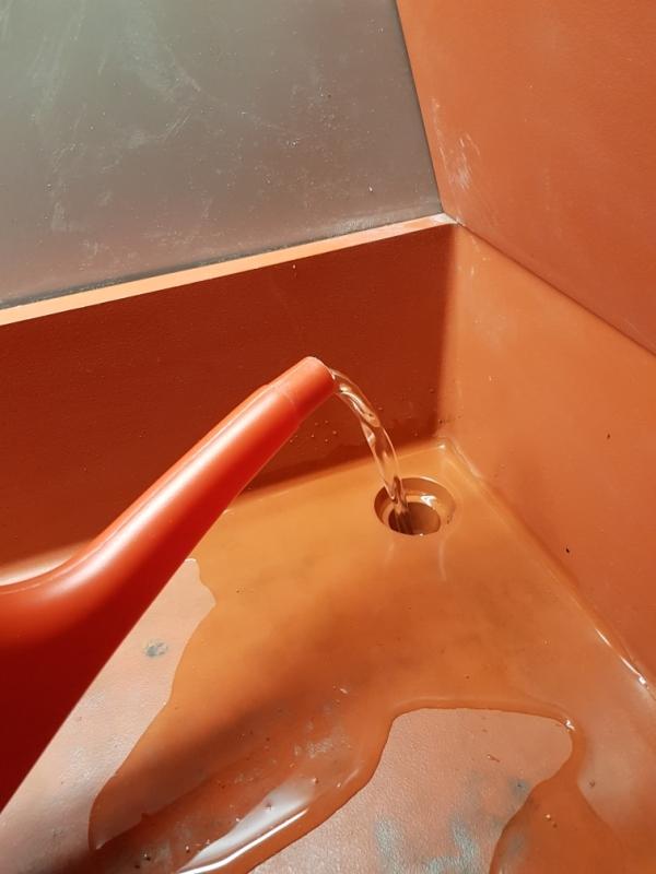

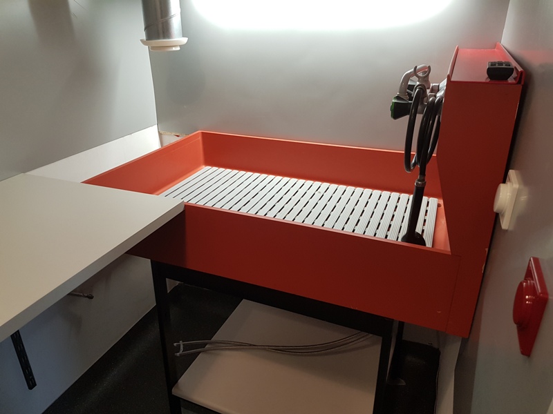

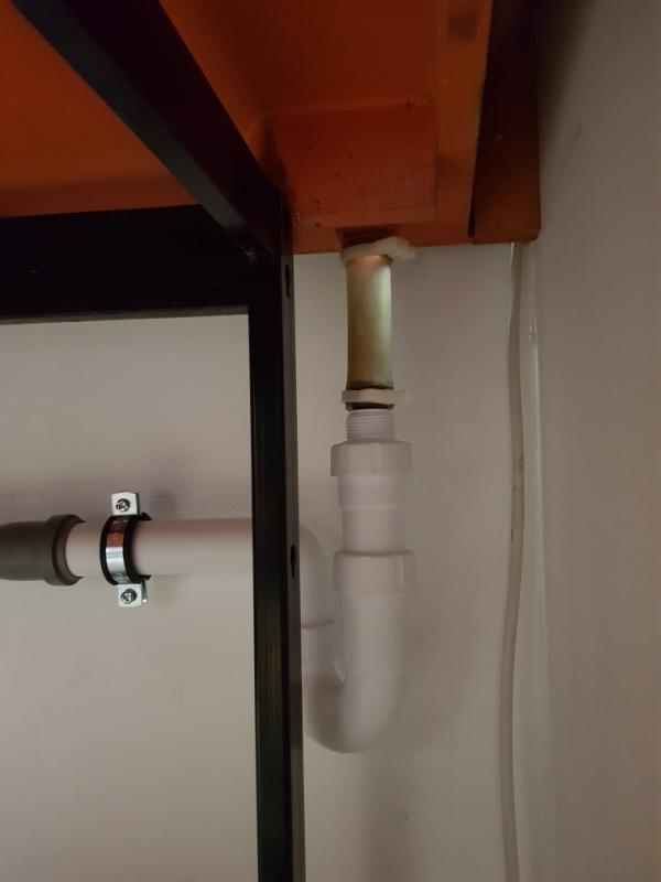

The sink is adjusted to it´s final height.

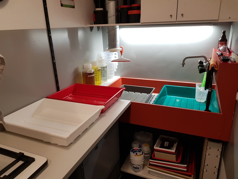

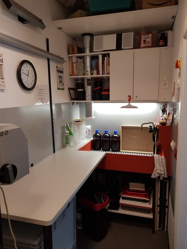

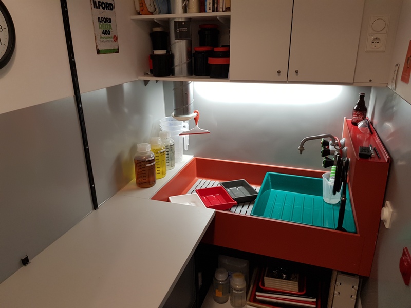

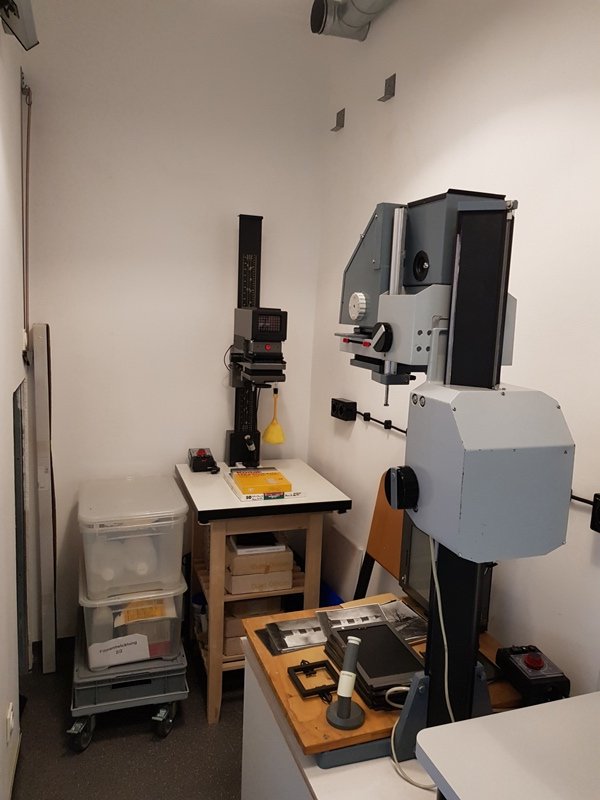

Darkroom - South end:
20210327_113910.jpg 20210327_003949.jpg 20210327_113910.jpg 20210407_124746.jpg

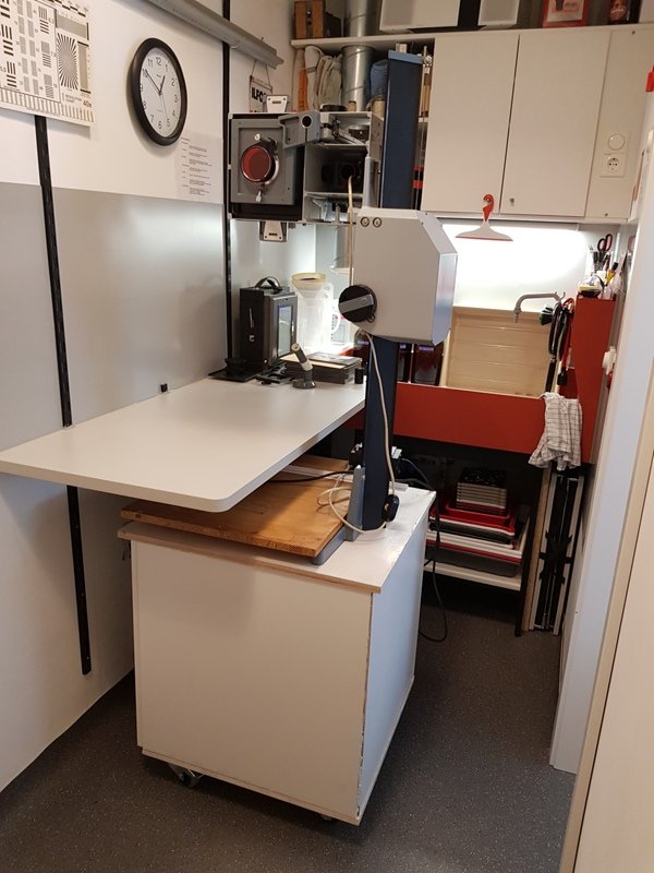

Darkroom - North end:
For large prints I can roll out all enlargers and boxes in a couple of minutes and project horizontally against the wall.
