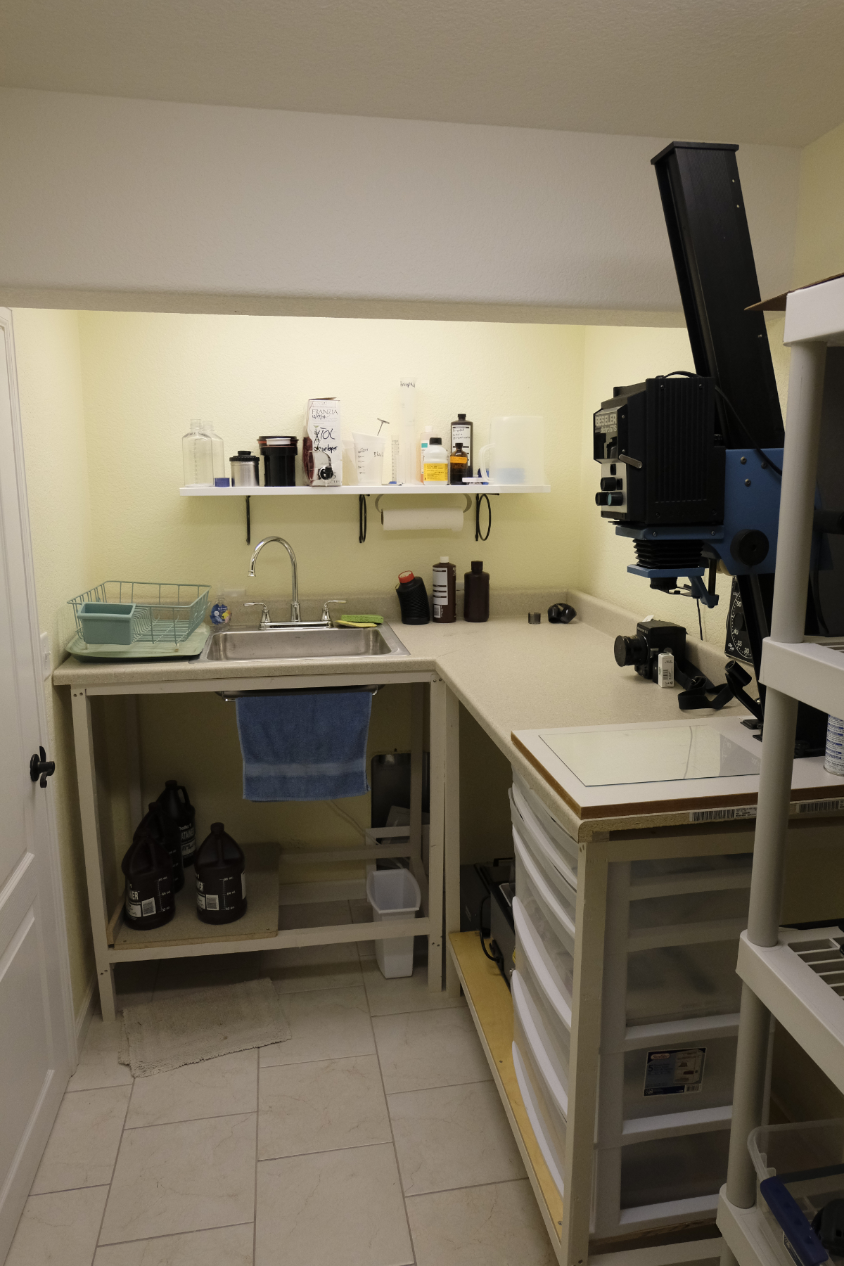

Here's mine. Pretty good set up for doing up to 6x7 cm (Bronica GS-1). Basement laundry room, so the sink just drains down the laundry drain. Noisy, but gets the job done. I had to build the table a bit higher than is typical to get the clearance necessary for the sink hose connections. Of course, I had to find a 3/4" hose to 1/2" facet adapter for the hot and cold supply, but fortunately one of my local plumbing supply houses had them for a couple of bucks each. The plastic cabinet under the enlarger is secured in place, so it does not budge when I open or close the drawers. Otherwise, I get my 35mm, 120 and 4x5 development done in here. Really too small for a 4x5 enlarger if I could even find one.
I particularly appreciate the XTol/Franzia setup. :laugh:

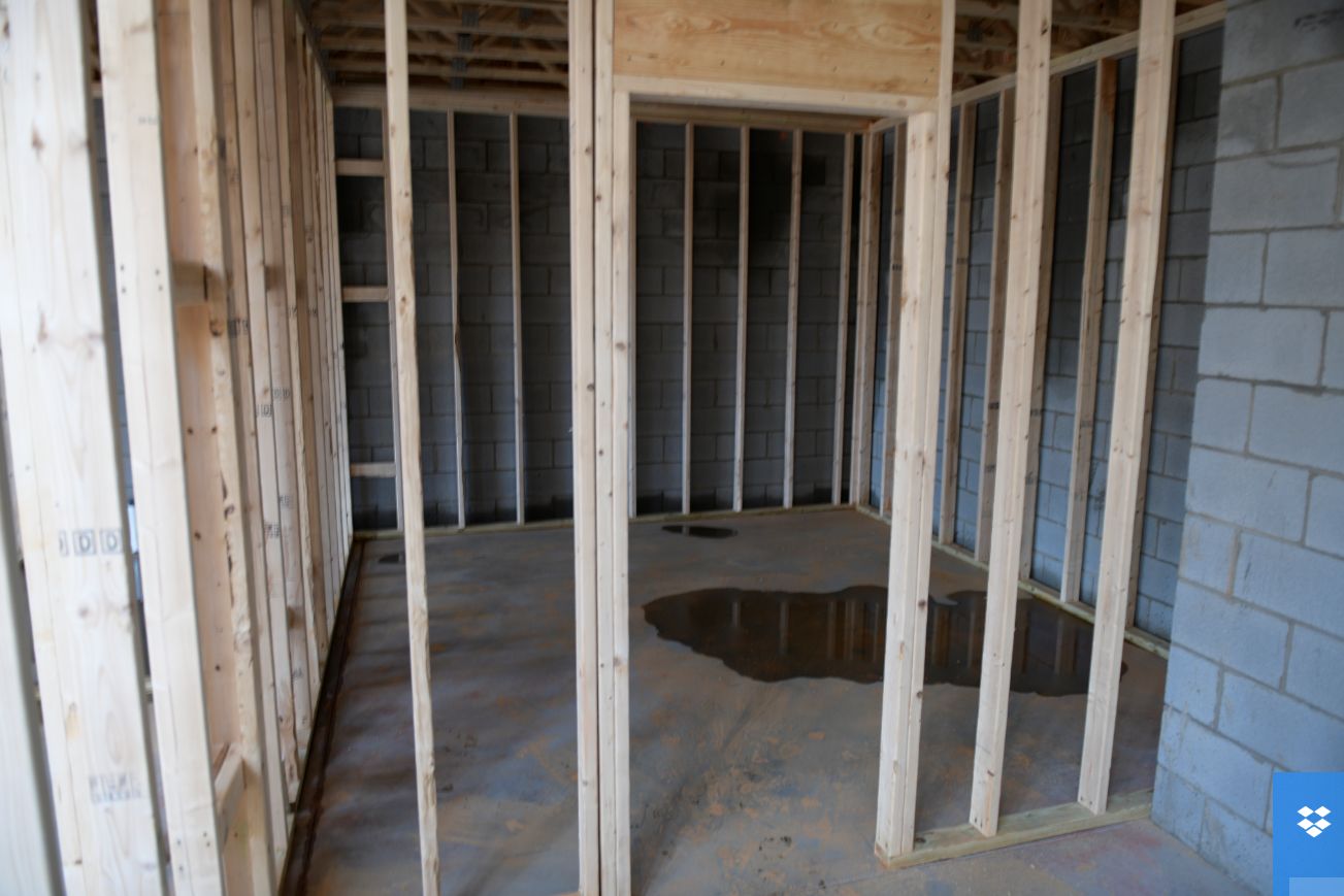

This will be the first a pair of posts now that the new darkroom is close to being fully operational.
The effort to move into the new house and finish the remaining construction, (extensive) drainage, and landscaping took several more months than I had anticipated. Building in the mountains brings additional challenges than when I've previously built homes. To make things more complicated I came out of my brief retirement given a great opportunity to do one more working gig before I toss the towel in for good - so the new darkroom had taken a back seat but it is still progressing, albeit more slowly.
Here is the space during the framing stage.before electrical and plumbing rough-ins. This snap was also taken just before I ripped out the standard-width door framing and changed it to a full-size 36" wide door after I realized the door would have been too narrow to get my leather sofa into the room. The pic was also taken before insulation was installed on all four walls (the exterior walls required special insulation made for the concrete block walls).

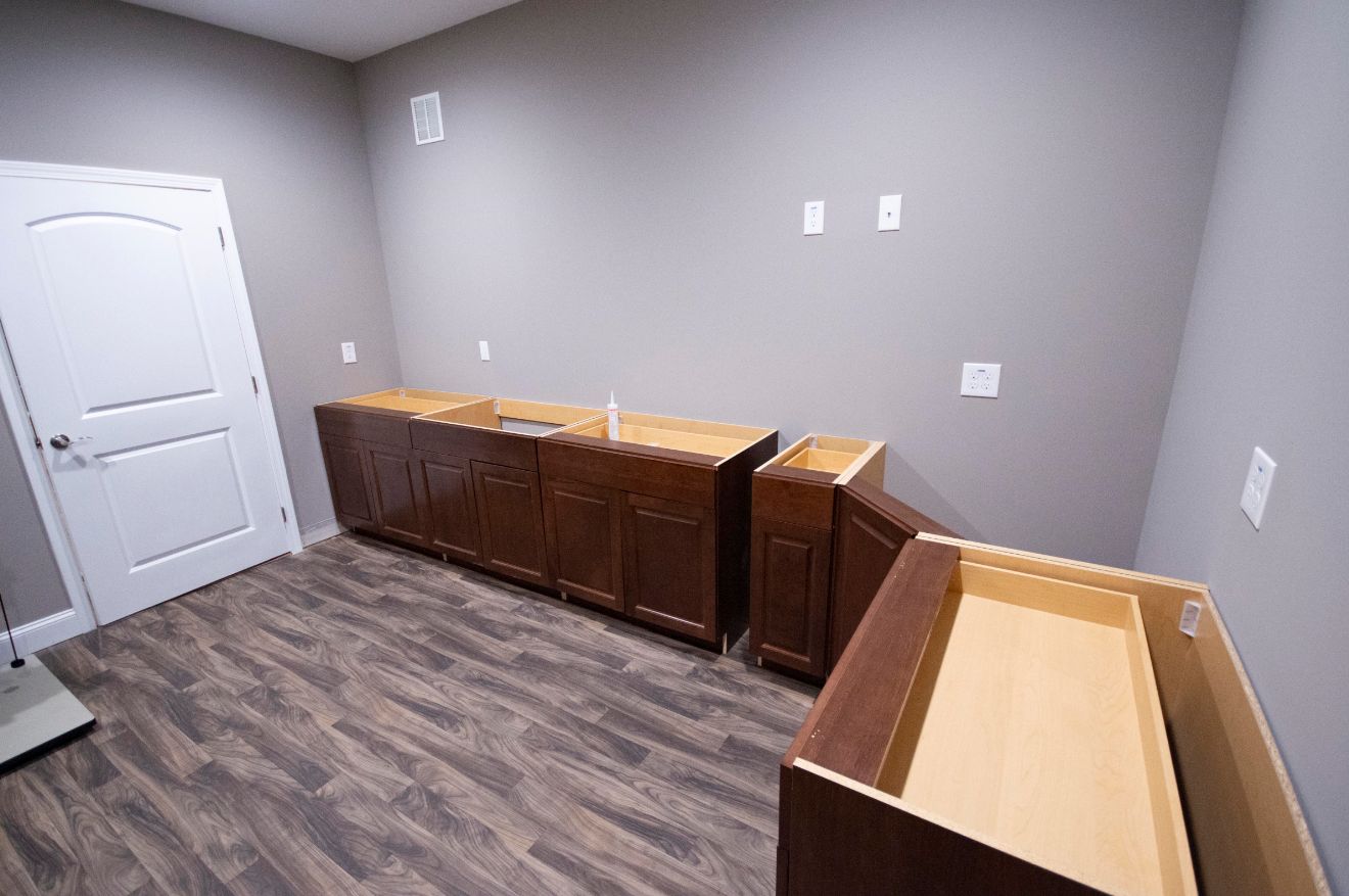

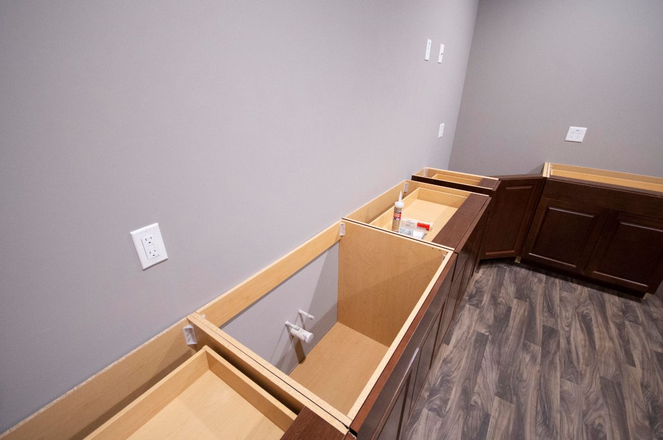

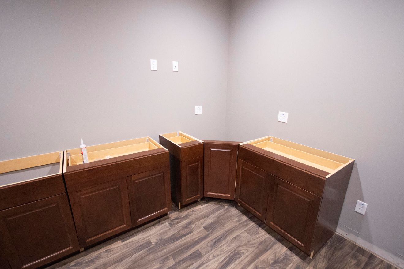

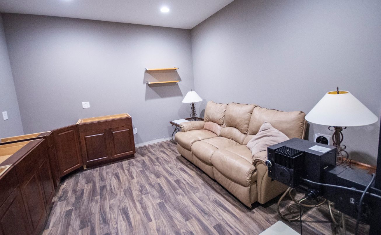

The next few pics were taken after moving in. The first thing was getting the flooring and cabinets in place. These weren't high grade cabinets - just decent pre-assembled stock cabinets from Home Depot.You might recall from my posts a while back that this will be a hybrid wet/dry (mostly dry) darkroom with programmable film and print processors for most work up to 11x14, so I decided I didn't need nor want a traditional long wet sink for typical tray processing. If I ever regret that decision I could reverse the room and take out the sofa, but I doubt I'll ever do that. Beyond 11x14" use a Jobo CPP2 for up to 20x24 and big trays (washer drain pans custom fitted with drains) for mural prints. I am still kicking myself for not grabbing a Fujimoto CP51 I could have picked up two years ago for $100 plus the cost of freight shipping - but it's a beast of a machine that I wouldn't have used as frequently as my CP-32.
So, in went the cabinets first. The room dimensions are almost 14x14 feet square.My aim was to make the room a combination of a darkroom/retreat - hence the leather sofa on one side and pre-wiring for a 50-inch wall-mounted flat screen on the opposite wall along with a blue-tooth enabled Hi-Fi receiver and speakers. I could have added a few more outlets in the room (there are 20 total - all GFI) but I am finding that I have enough - especially the dual quad outlets in the corner where the two enlargers are located. The ceilings are 9 feet high and the recessed LED lighting is on a dimmer switch. I pre-plumbed for a sink and used a 36" sink cabinet for an oversized standard sink as you can see in the 4th snapshot. As for venting I installed a switched built-in ceiling exhaust fan overhead (not visible in these pics). Since I am not typically doing tray processing, I felt could skip a more elaborate exhaust drop, but I can always extend the venting it if I ever change my mind. The exhaust fan is not very noisy either. The flooring is waterproof resilient one piece vinyl, and the room is ultra-light tight as there are no windows and adjacent space leading to the room is also windowless and underground on three sides in the rear of a walk-out basement. Since I had fully insulated the walls being below ground level on three the space maintains a surprisingly constant humidity and constant temperature of around 68 degrees in both the hottest Summer and coldest Winter months, though the adjacent space has vented auxiliary heating/cooling along with integrated de-humidification if needed, but so far I haven't needed to use it even once.
Next up after this post, a more finished view closer to being operational.

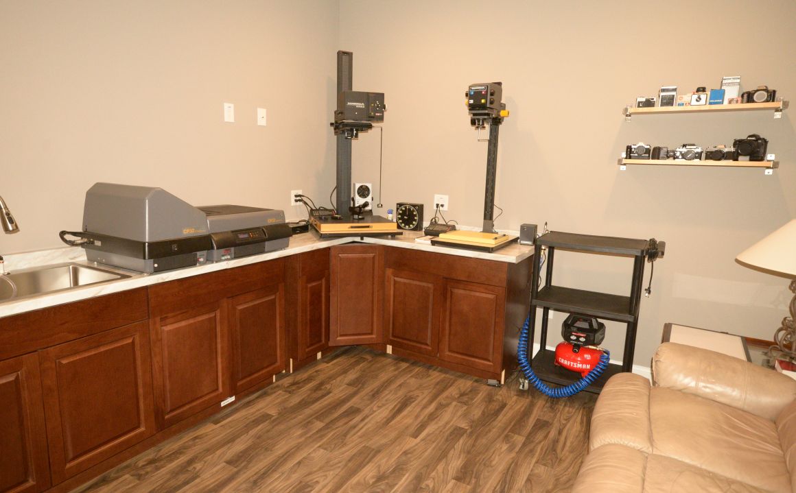

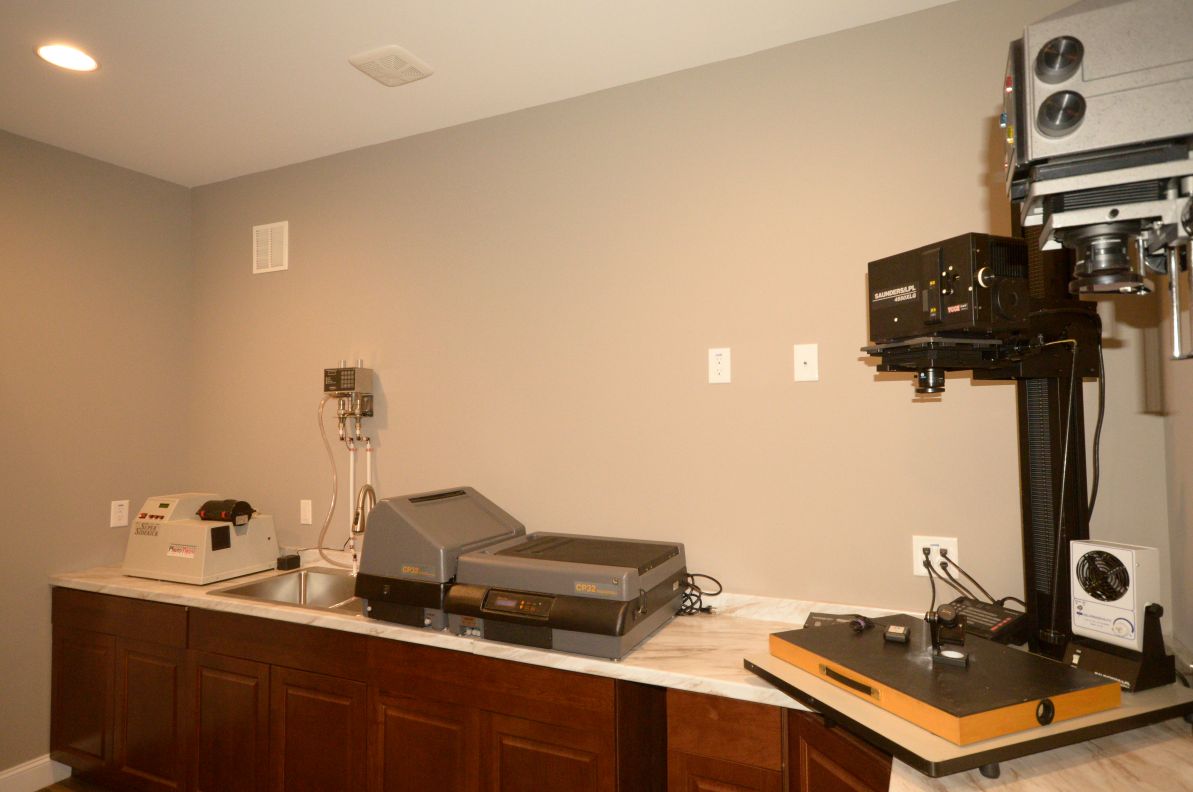

Here's the project in it's current state - almost operational.
In these snapshots the walls look a little warmer but they are really middle gray like the last set of pics I posed earlier (the color balance is a bit off on this set). Due to the counter lip I had to build up the top of the
cabinets a little and have yet to complete attaching the cabinet kick molding along with drawer and cabinet handles. The power and cable outlets high-up on the wall are for the 50" flat screen that goes in next
week.

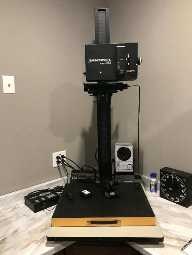

In the corner is the LPL 4550 XLG K&IF VCCE enlarger along with a variety of carriers, masking attachments, fine focus with extender arm etc. The enlarger to the right of the 4550 is an LPL 670MXL dichro
I use almost exclusively for 6x7 which I prefer over the 4550 as it has a medium format AN glass carrier. When I want do color with 4x5 I have to swap out the VCCE module for the dichro module. I have a decent
collection of Componon-S and Rodagon lenses for 6x7, 4x5, and occasional 35mm from my 50 year old negative archive.
Next to 4550 is a Fujimoto CP32 programmable print processor and wash/drying unit.. I also have the CP32 replenishment unit that I have yet to hook up as well as hook up the water intake from the temp control unit for the W/D
unit. Not visible are nicely finished holes and rings in the countertop behind the processors that drain reusable chem from the CP32 into large bottles stored inside the base cabinets underneath.

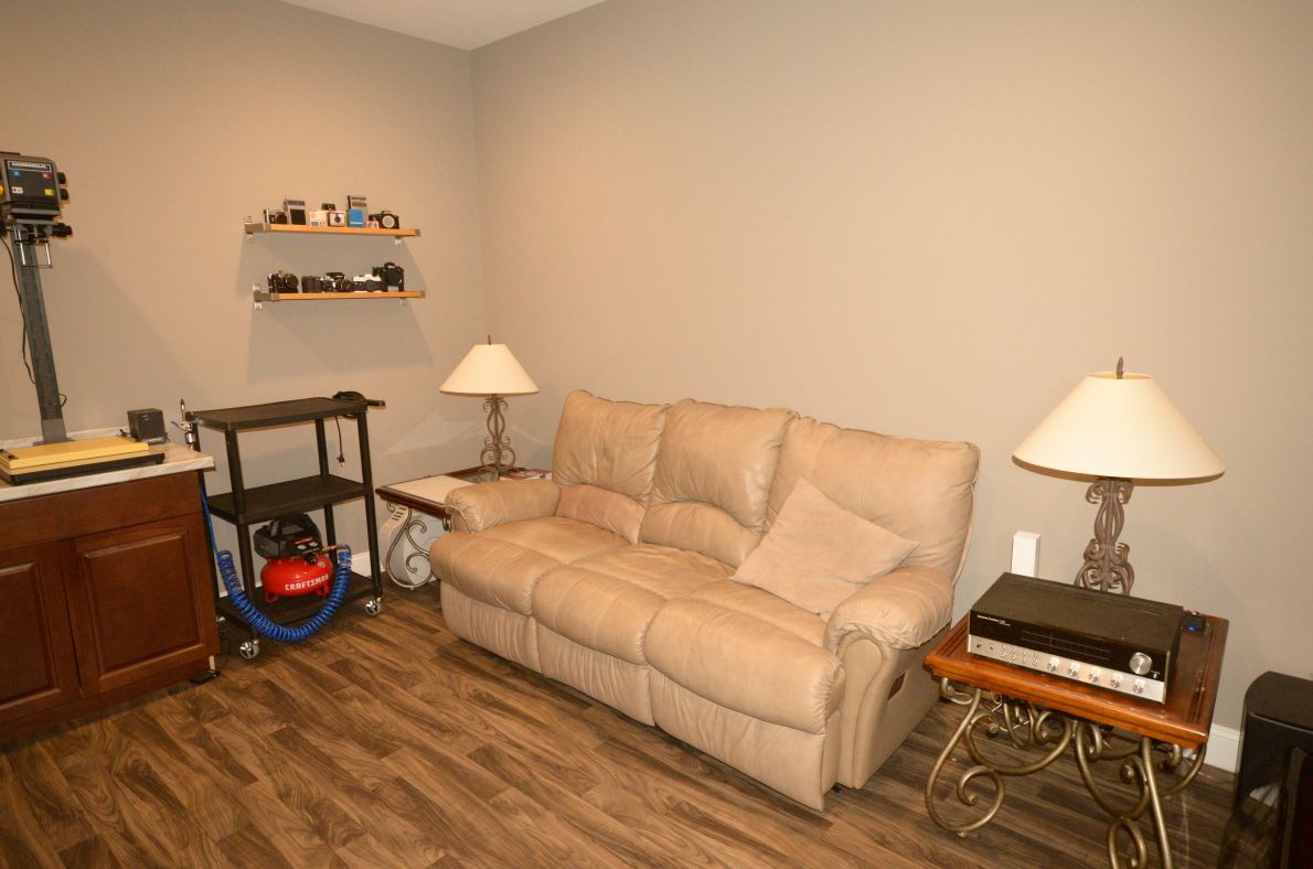

Off to the far right is a large lightweight LED flat panel for reviewing negatives and the tabletop lamps have daylight-balanced LED bulbs for viewing color prints with viewing filters.
The red-belly craftsman unit with the coiled cable on the roller cart is a Craftsman 2.5gal cordless electric adjustable air compressor with an inline filter and air gun.
All of the outlets are GFI.

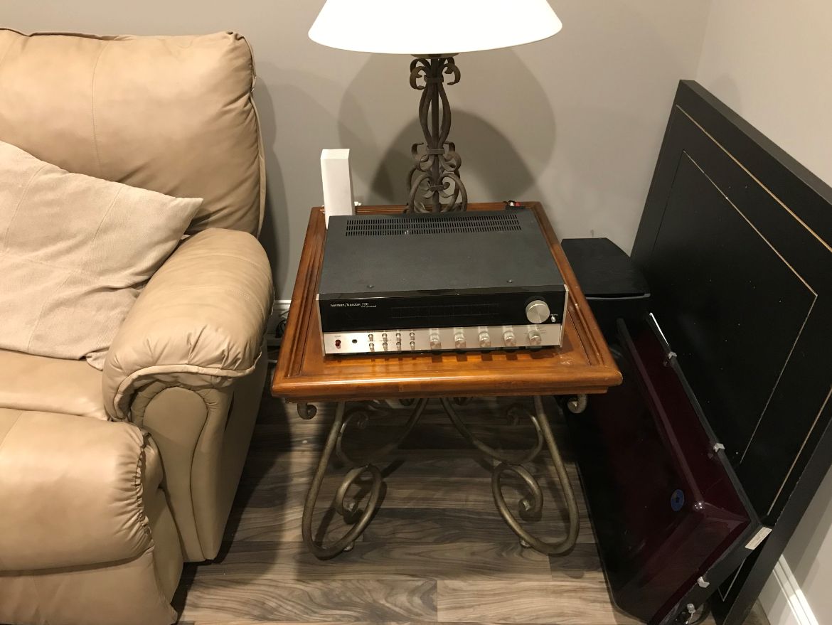

In the foreground to the right is a classic Harmon Kardon HK730 receiver with a bluetooth adapter that I use to stream music to it from my iPhone. It's connected to two Polk audio bookshelf speakers that I
have yet to wall mount. The small white rectangular tower behind the receiver is a wireless Linksys mesh network node for high speed internet. Buried over on the left side of the sofa is a Honeywell Quietcare
True HEPA 17000-S air purifier that covers up to 200sf - nearly the exact sf of the room.
Sitting below the LPL 4550XLG is a ByChrome 16x20 vacuum easel. I have yet to hook it up to the vacuum unit inside the
corner cabinet and foot switch. The white fan thingy is an static eliminator that also helps reduce odors To the left of the
enlarger is a an RH Designs Analyzer Pro f-stop analyzer Sitting on the vacuum easel is a Peak Model 1 grain focuser.

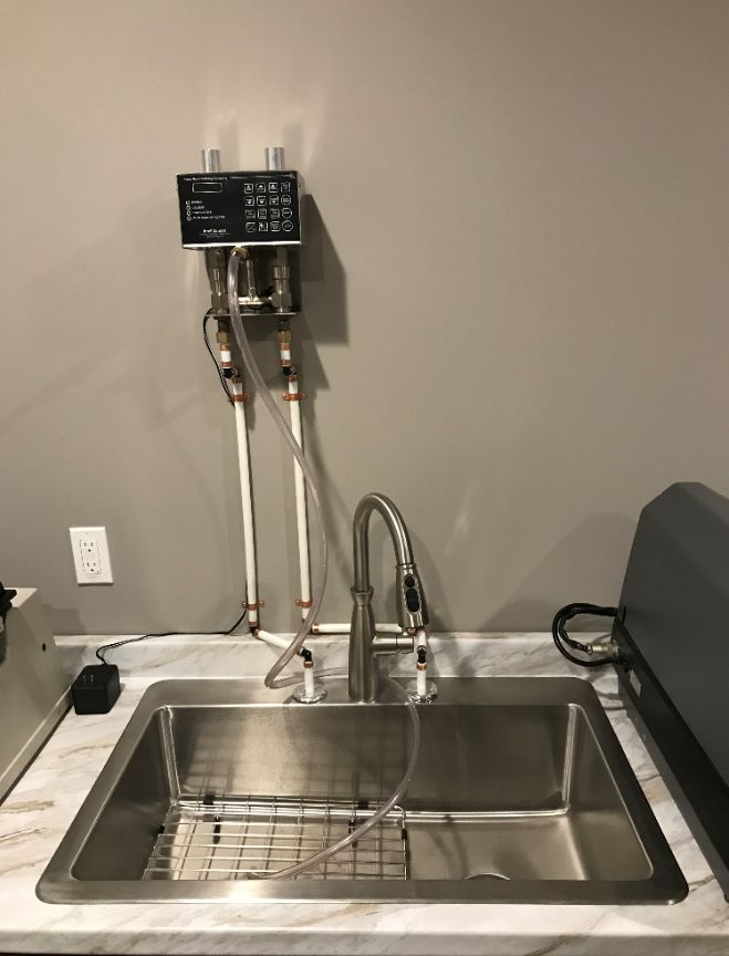

Wall mounted is a Hass K375 Intellifaucet digital temp control unit. Right now I only have a tube temporally hooked
up to the outlet but I plan to add a horizontal set of outlets to tap into it for the Fujimoto, the Sidekick, and the Jobo
CPP2 which is not pictured and sits on a rolling cart just outside the darkroom entrance. The sink is oversized with
17x30" usable area. I already have a water filtration system for the lines for the whole house but I might yet add a H/C
water filtration at the Intellifaucet itself, but so far the main filtration system does a good job.

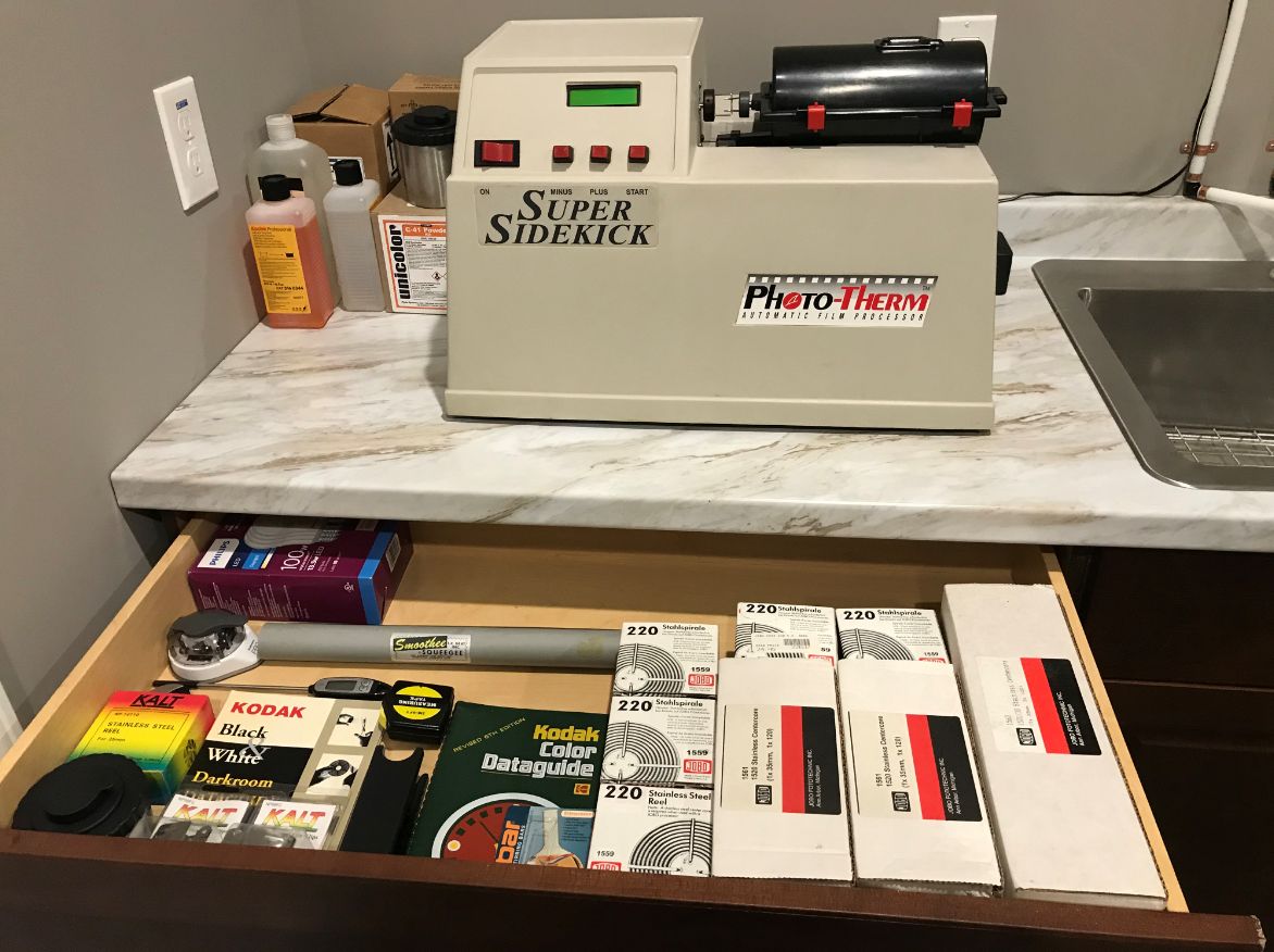

To the left side of the sink is a completely rebuilt PhotoTherm Sidekick SSK8 with automatic and precise water temperature control, programmable processing, and automatic cleaning for 35mm through 4x5.
Again there's a finished access hole in countertop behind the SSK8 where the automatic feed and drain tubes are routed to chem storage bottles inside the base cabinet below. I was lucky to amass a variety
of Sidekick4 and 8 reel tanks, accessories, and parts before PhotoTherm ceased production of new units. Like the Fujimoto I have yet to tap into the Intellifaucet water supply so that I don't have to keep a tank
of water below.

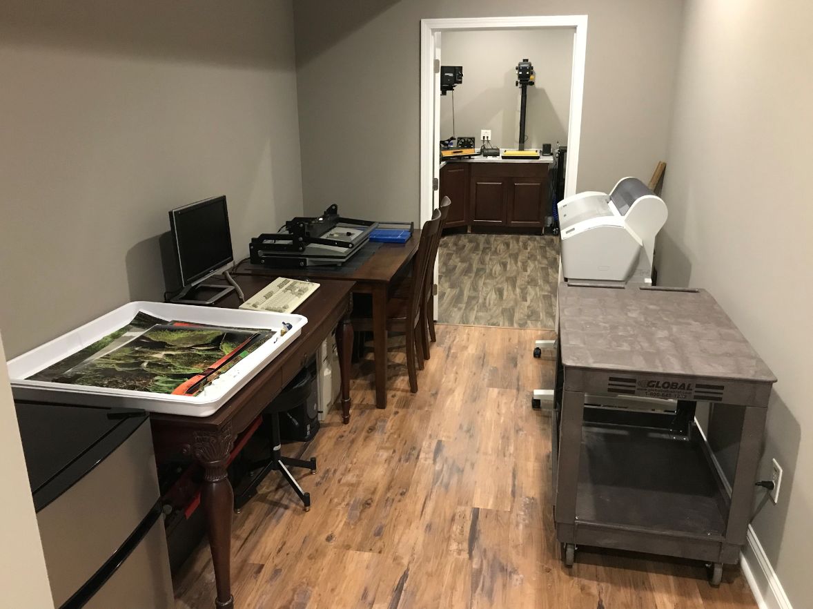

The entrance to the room is yet another back-basement area that is also underground on three sides, ully finished and insulated and has a light trap leading to the finished walk-out basement. To the right
is a wide-format 24" Epson 7880 printer and to the left of a RotoTrimmer and a DK 1350W 18.5 x 23" Masterpiece dry mount press (same as the older Seal 210M). In the lower LH corner is a mini fridge/freezer
for film, ice, and snacks. The oversize trays are refrigerator drain pans for occasional large B&W prints. I have have yet to bore the holes for the tray drains and plan to build a tiered stand to stack them on the
portable cart. Sitting almost out of sight is the Jobo CPP2 processor for occasional 16x20 and 20x24 inch RA-4 print processing. Also not shown is a Prinz warm air timer/blower with plastic cabinet for film
drying (equivalent to a Jobo film drying cabinet), a Stack N Dry Floor Drying Rack (up to 20x24) and a Premier Model T2-C Electric Print Dryer. For print washing I have a 16x20 tray print washer and will
eventually spring for something like a Versalab Archival Print Washer 16x20 with 20x24 adapter or equivalent.
If I had that sofa in my darkroom I don't think my wife would ever get me out of there

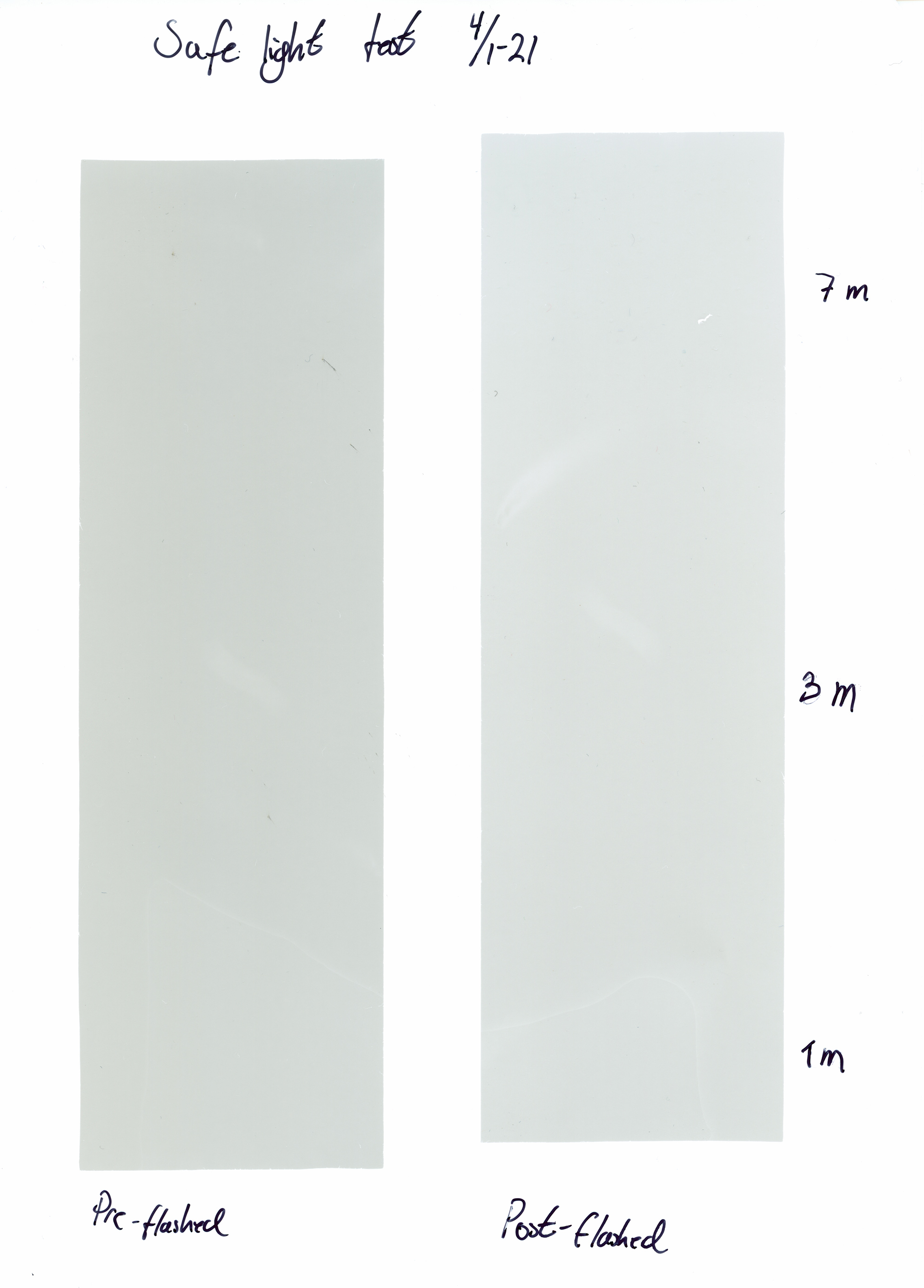

It is however at the stage where it's usable. I did the safelight test, following Greg's excellent video tutorial, and the test came out perfect as far as I can tell. I've attached the result as well as my first two prints. I know that I have a long way to go and a lot to learn, but it's exciting to finally start the journey.
Safe light test 04-01-2021040@0.5x.jpg 19720C10-p01@0.25x.jpg 20201A27-p01@0.5x.jpg

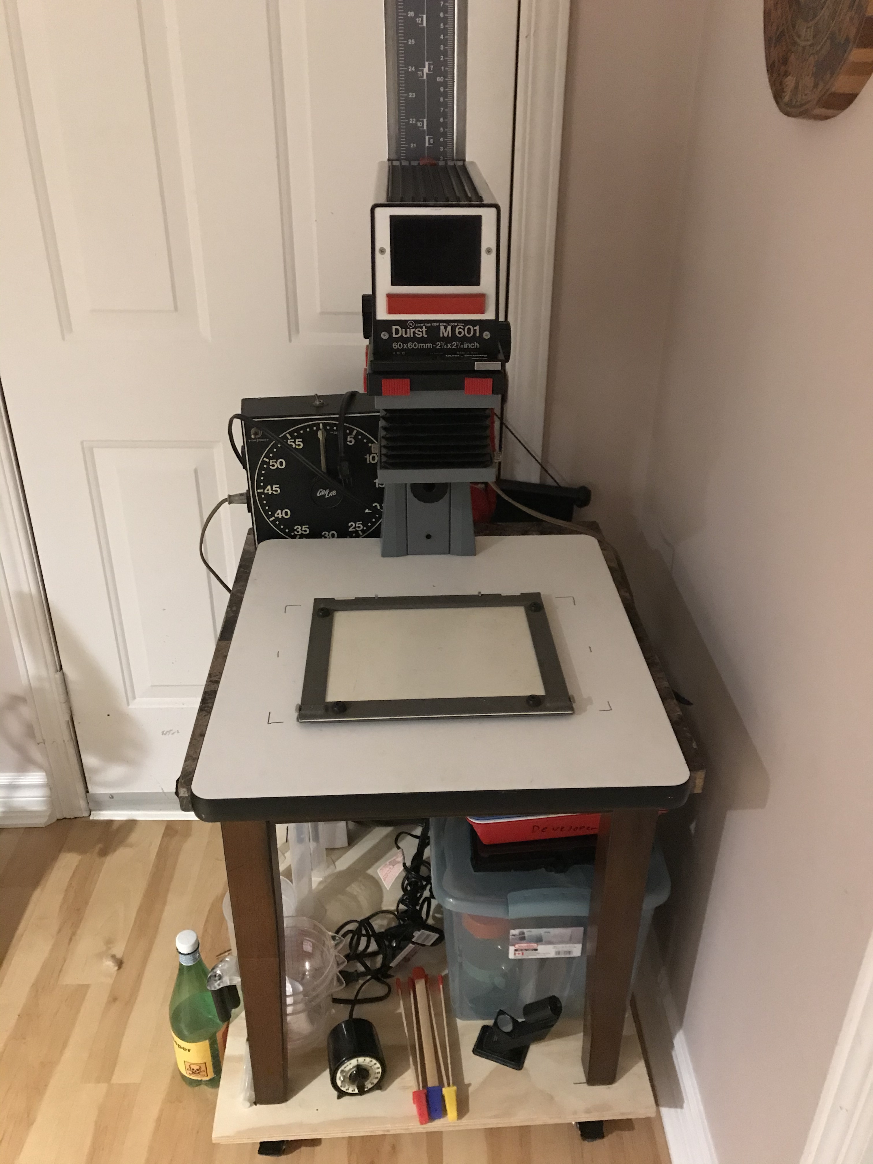

Here is my mobile darkroom! The enlarger sits on a "cart" that I made from a table that I found for free made from particleboard (don't worry, it isn't real marble :wink:) that perfectly fit my enlarger. I then made a platform of sorts for the table made out of 2x2 foot plywood and a 2x3 frame underneath with casters bolted onto it. That was then attached to the bottom of my table. All in, materials cost me about $25 :smile: .
My only concern is the glow in the dark gralab timer, with it being so close, it may fog the paper. Is this an issue other people have found?
My next step is to get one of those paper organizers to be able to stack trays on top of each other.
I have a Master Time-o-Lite timer which has a similar glow-in-the-dark face and have encountered no problems. IMHO it is a better timer than the big one you have behind the Durst. I am curious how you intend to set up a wash tray.
I just take the print upstairs in a tray where I have running water and wash there.
The glow of the timer has not been a problem for me when I print, and I have several along the sink.
That enlarger: I still have my Durst M601 since 1973! I recently saved all of my pennies, nickels and dimes and converted it to a Heiland LED head. If you need spare lamp holder for yours, let me know and I will send it to you for the cost of shipping.
Enjoy your printing sessions!
