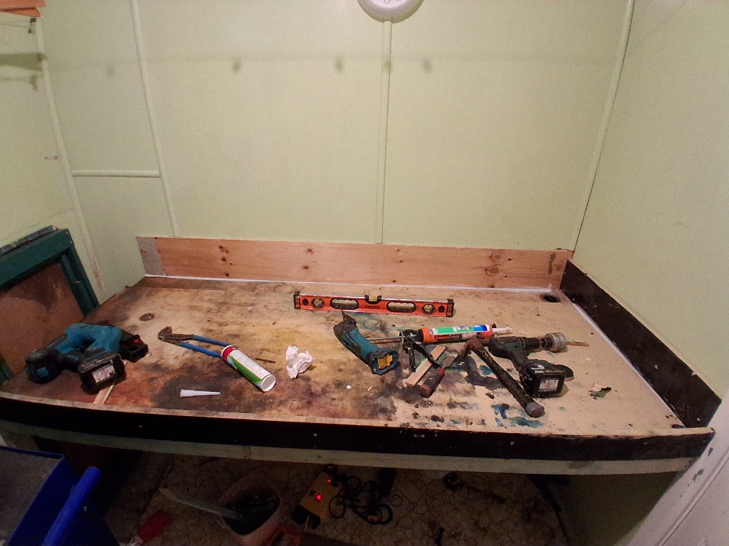

Went from very small to very big, this my third darkroom will have to do as a medium size. A 2000mm x 900mm trough, a Durst 1200 enlarger and some storage.
I need to remove the old concrete laundry tub (heavy), plumb up the new trough and she should be good to go. Already light proofedish the window and door. Need some ventilation, might use some AC, that was great in my last DR.

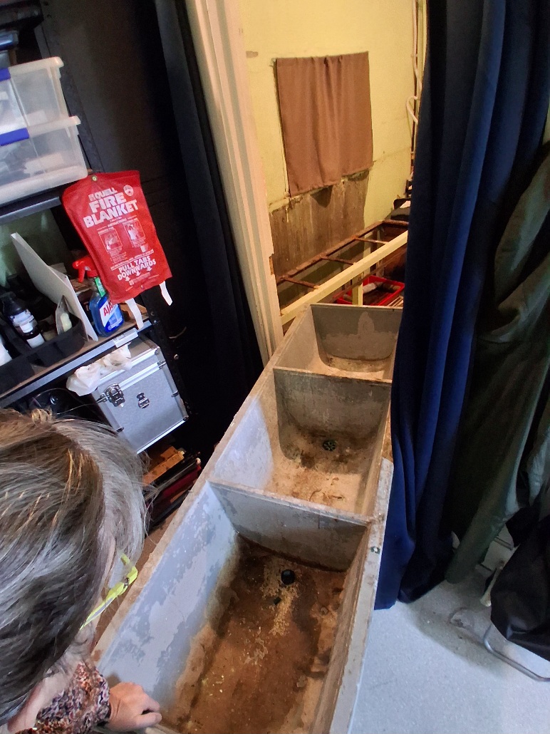

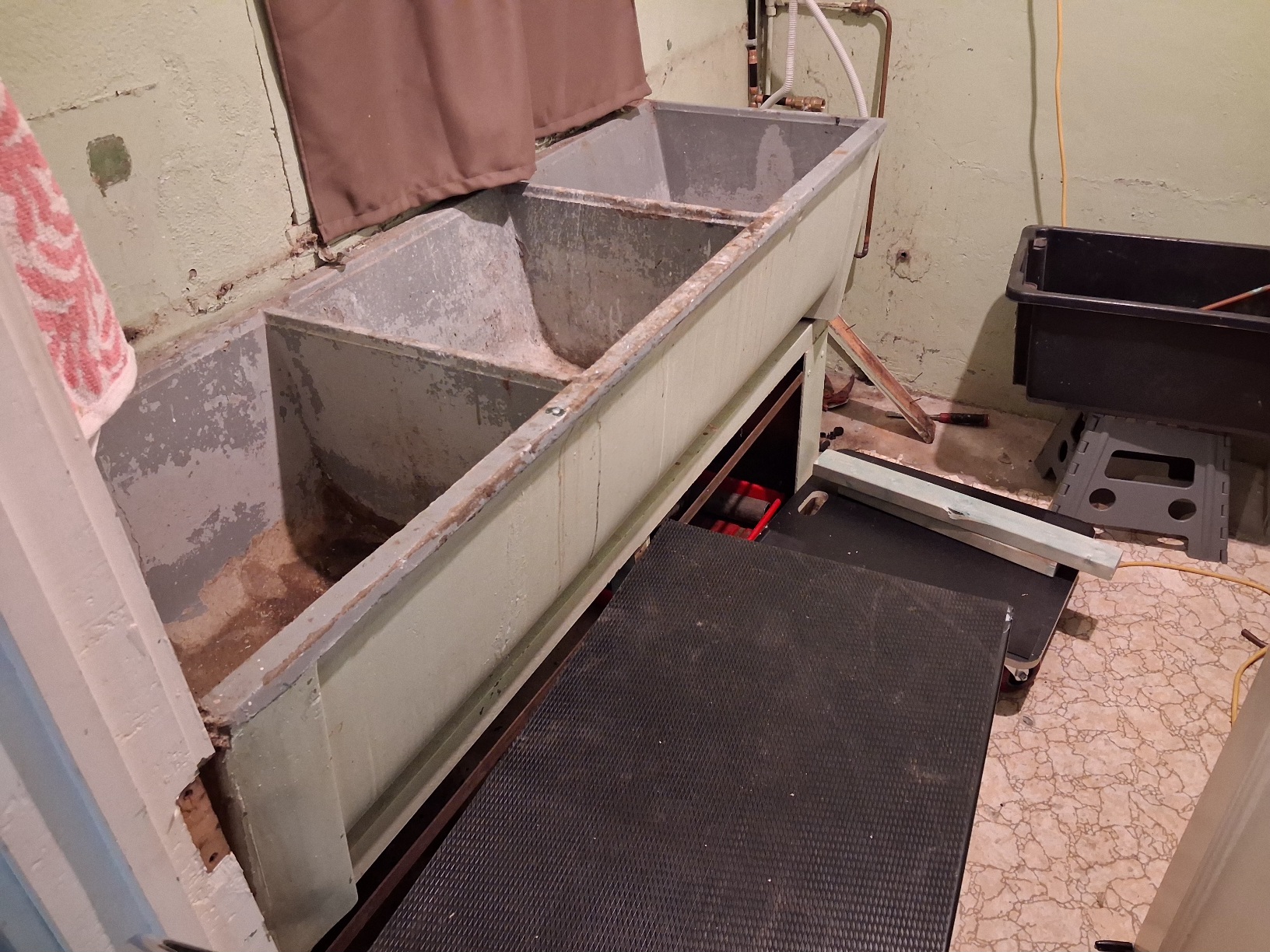

…I need to remove the old concrete laundry tub (heavy)…
Safety glasses and a sledge. Those things are heavy. I figure that the double one in my basement was installed and the house built around it.

I love building darkrooms! Concrete laundry sinks! I started with one.
The first darkroom I worked in had a cement laundry sink that my friend made dividers for out of fiberglass shower panels to convert it to a print washer. He made a standpipe for the drains and he was off to the races.

Well I'm a little over it, the last one was going to be my forever darkroom, so I went all out, then I decided it would be better to move house so I can retire and do fun stuff, except I'm working harder than ever and running out of puff.

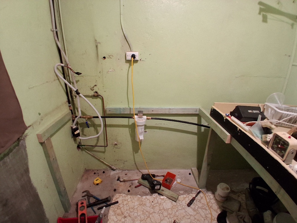

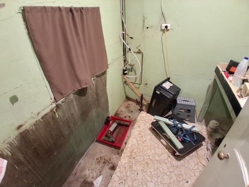

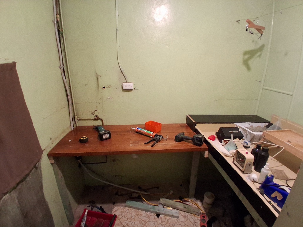

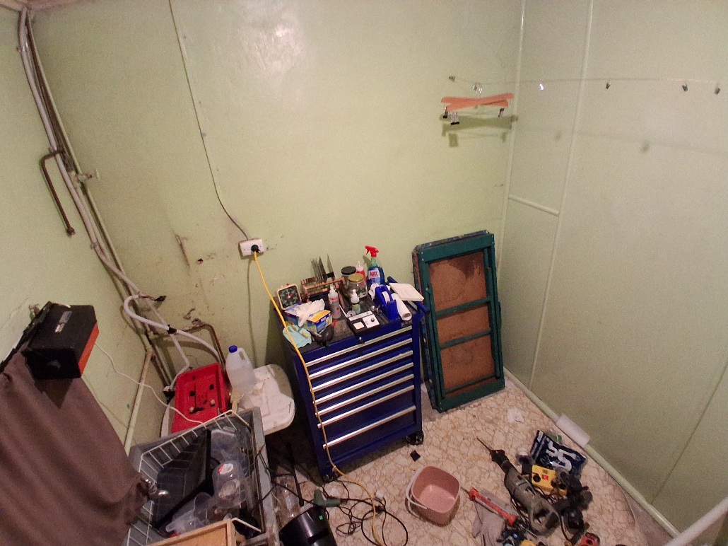

Any how with the help of a platform trolley and my wife, we managed to remove the massive laundry tub without any significant injuries.....and my wife gets a nice garden tub for growing Pansies.
Now I have a place for the Durst.
Just have to do the water, some shelving, lighting, exhaust fan, cooling and heating and I'm done....oh and a sound system. Can't think without music.
