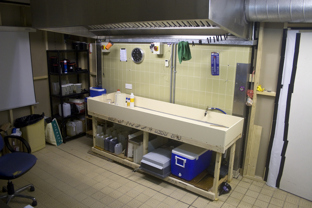

I just finished my first print session in my new darkroom. This is the fifth darkroom that I have built (and hopefully the last). It is smaller than previous darkrooms - 7' x 9', it has an 8' long sink, made of plywood, sealed with marine varnish. There is a lip near the top to hold frames that allow me to keep trays at the height of the top of the sink - so less bending. My CPP2 died, and I replaced it with the new CPE-3 film processor jury still out on that. I kept the revolving door. My enlarger is an Ilford MG600 (Durst Multigraph in disguise), I shoot mostly MF now, with some 4x5 and some 35mm thrown in from time to time.

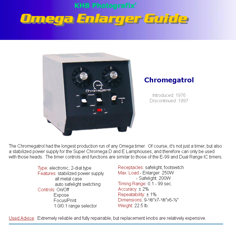

So do they have Chromegatrol combined timer and power supplies?
These: http://www.khbphotografix.com/omega/Timers/Chromegatrol.htm
Chromegatrol II is a combined power supply/timer unit.

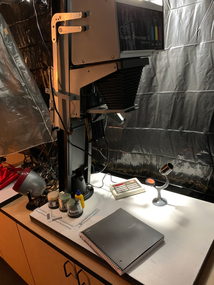

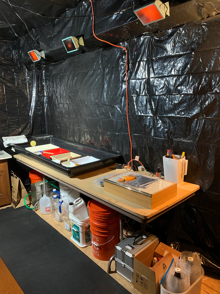

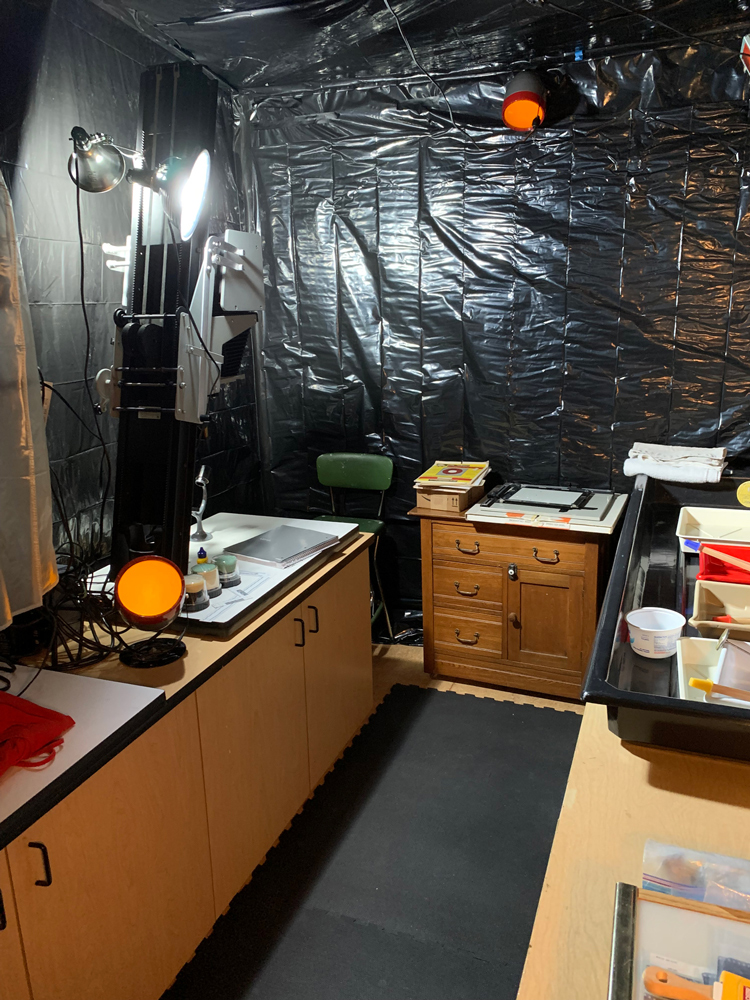

I use the Omega power supply that I believe was standard with the enlarger. Not the one Matt King showed. Not Sure of the timer brand/model/price as it was all free - I’ll post a pic later. It feeds back into the power supply.

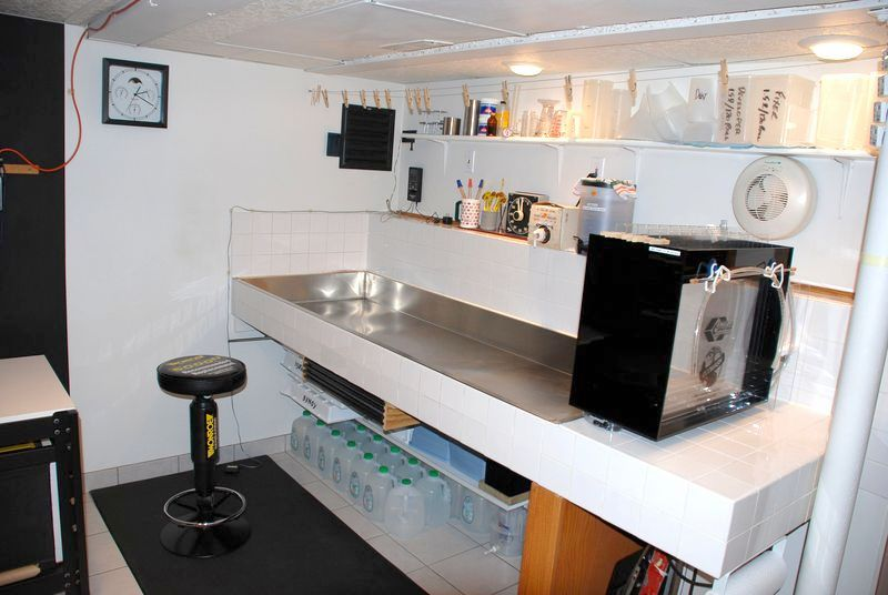

My darkroom, completed this spring after 13 years of waiting. Walls are a double layer of black landscape plastic, power is by extension cord, water by buckets and jugs. Door is a light maze. All the equipment and furniture were free.

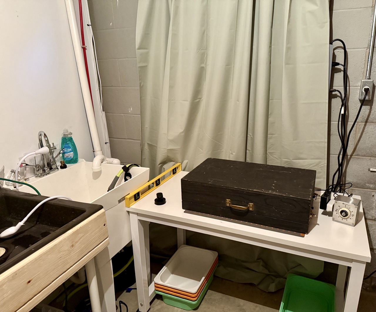

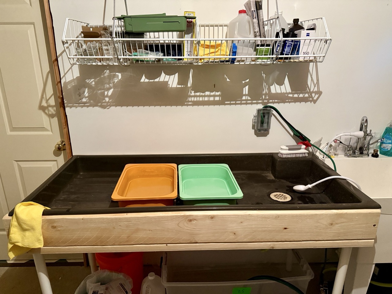

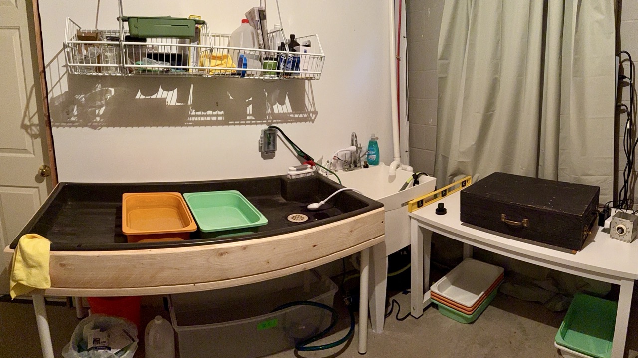

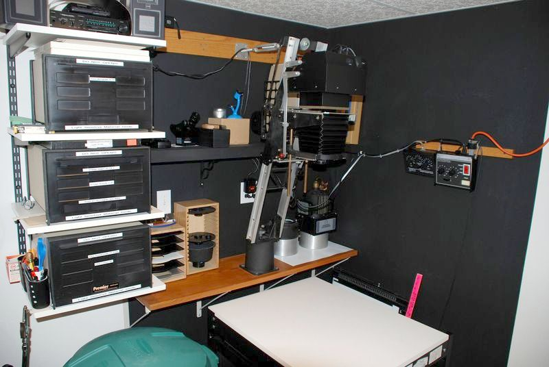

The low-budget, alt-process "dimroom" corner of my basement. The most expensive bits (by far) were the parts that went into the UV box (the black box with the handle). The darkroom sink was $25 locally, the timer was $5 at a Goodwill, the bins are from IKEA ($3/each I think?), and the wire basket shelf was $10 at a closing Joann Fabrics. I'm very pleased with how it turned out.

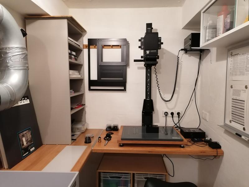

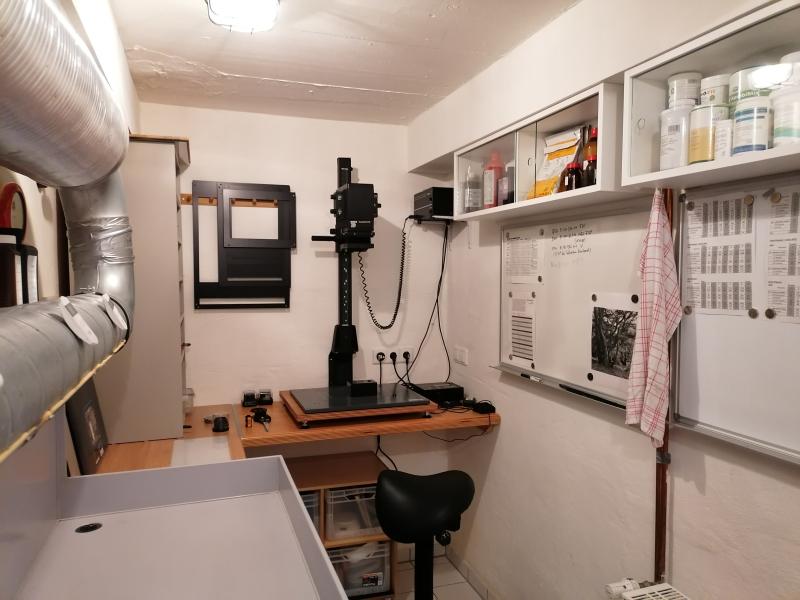

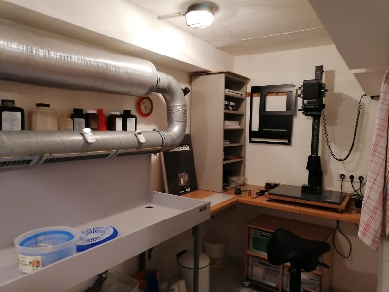

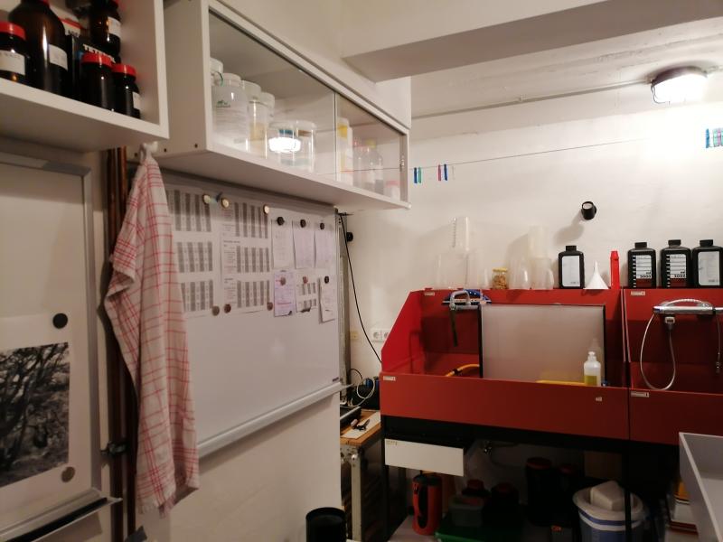

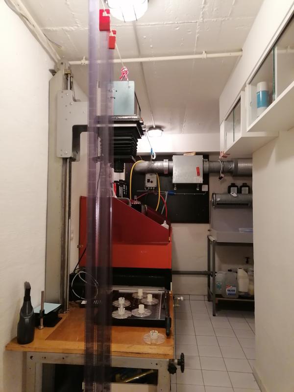

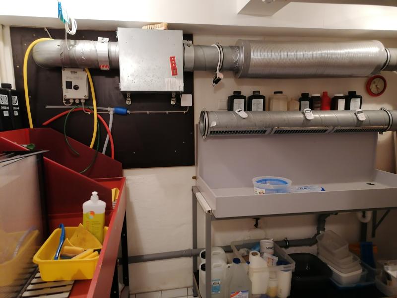

I'd like to show you a tour to my little darkroom. As you my notice the room is L-shaped and located in the basement. I had shown it in the old thread already but this is the latest incarnation. It features hanging cupboards with sliding glass doors for storing of chemicals an other stuff. I hate dust in the darkroom so I try to avoid to have stuff standing around as much as possible.
