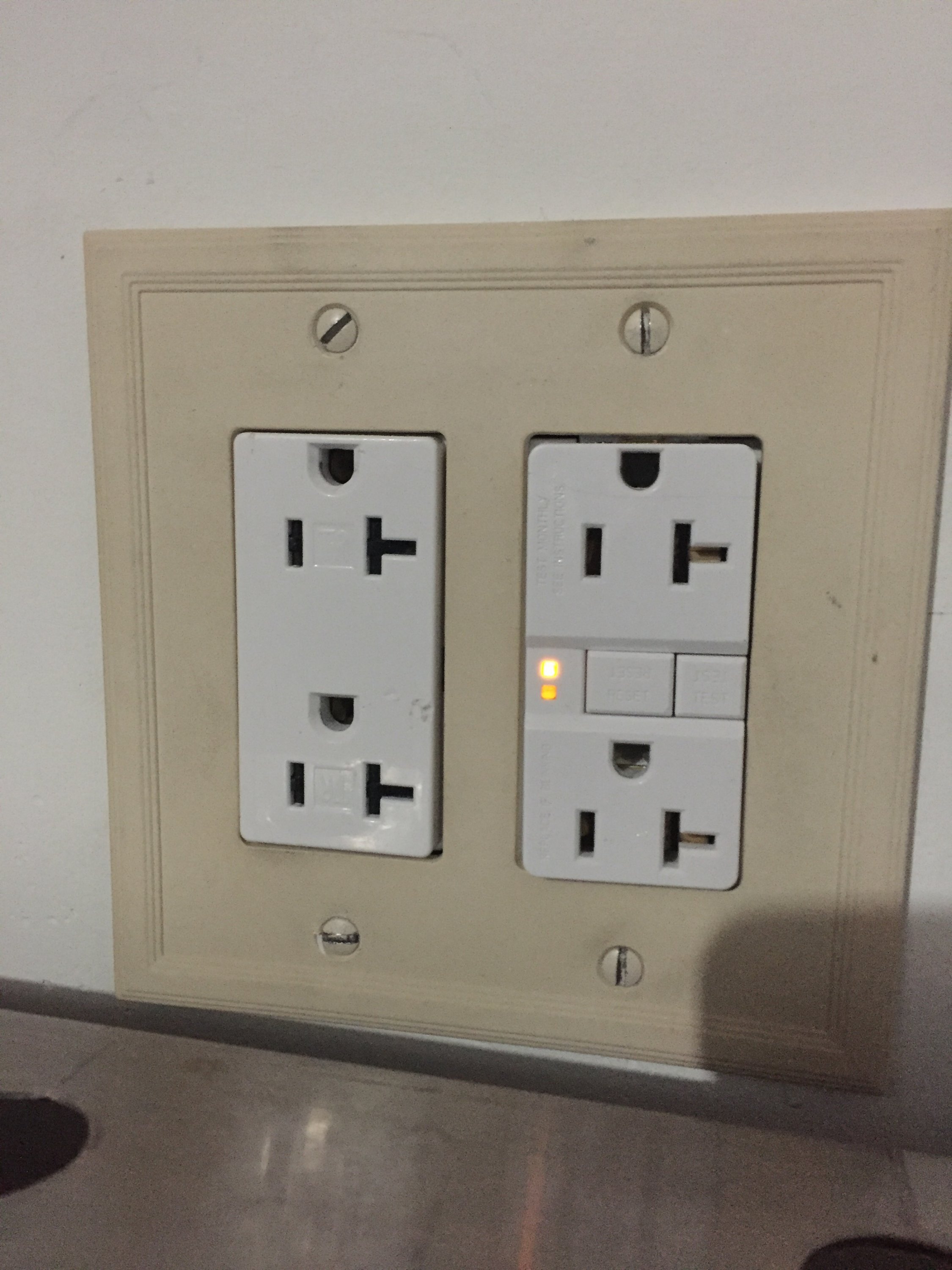

Are those outlets GFI?
If not, I might have a suggestion for a safety improvement, what with all that electrical near a sink.

All outlets in my darkroom are GFI. I put one GFI per double box and they are wired in parallel within the box, so the 2nd outlet is protected as well.

So do the outlets have a circuit breaker? Its weird to me seeing power outlets without switches. Here you need to at least 12" to the side of a sink for a power outlet.
Yes, the circuit breakers are in the main box, but if you are talking about the test and reset buttons for the GFI they are there just hard to see.
Here's a quick snap with the breaker activated and the warning light burning...

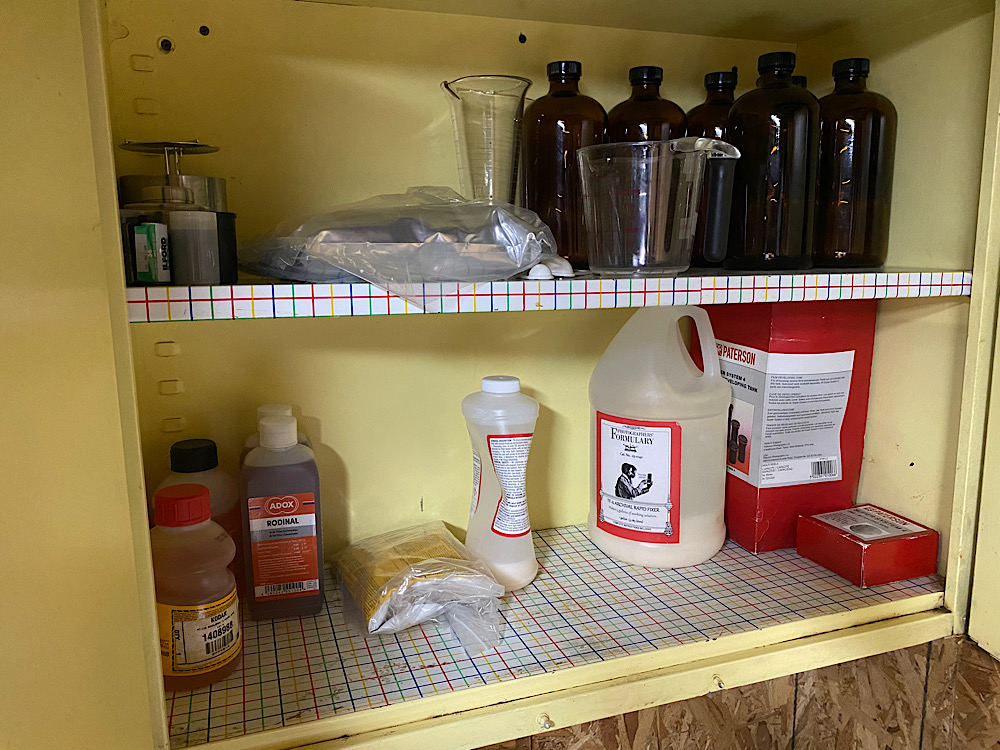

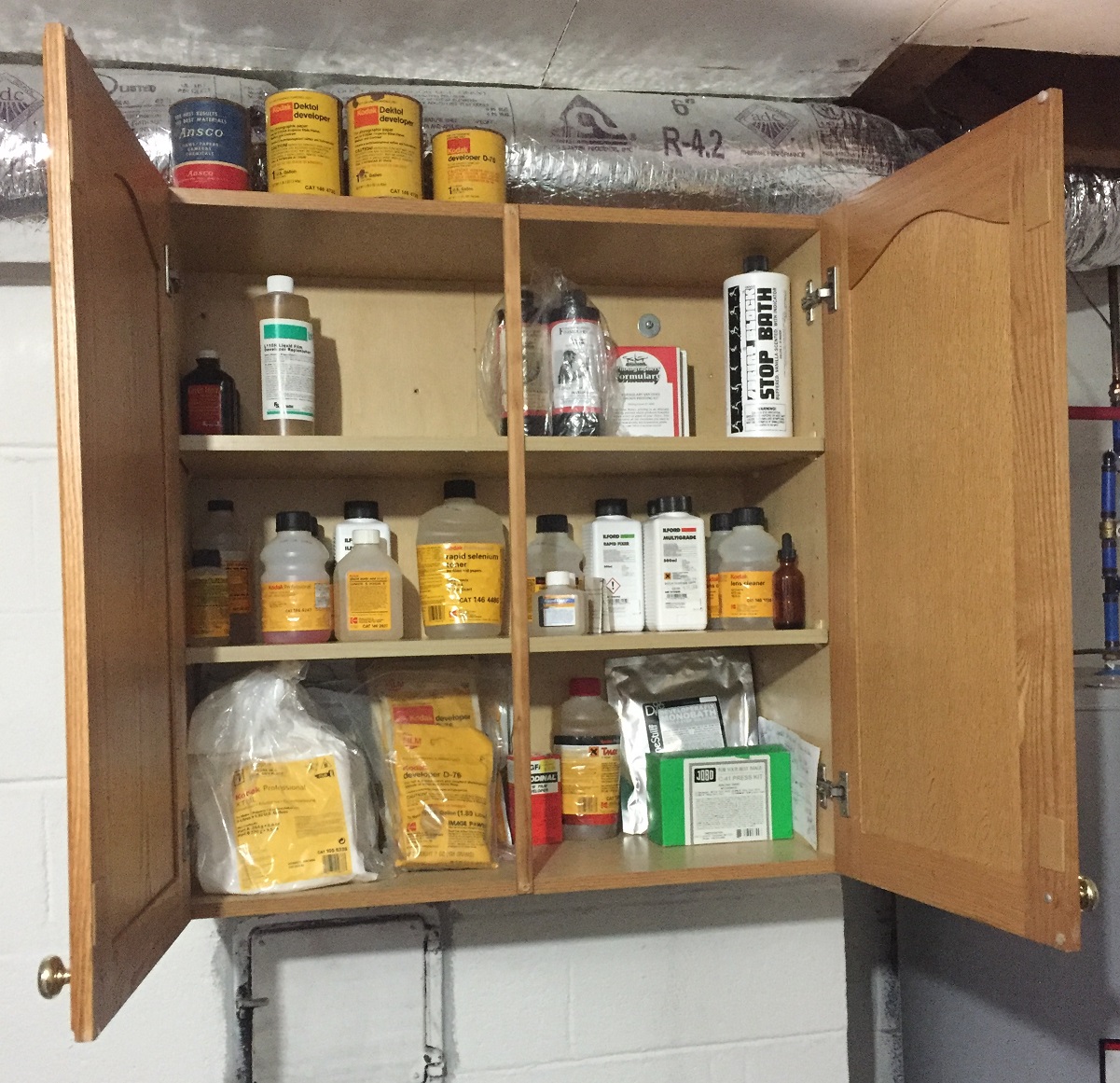

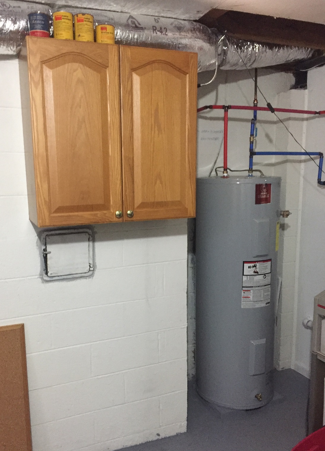

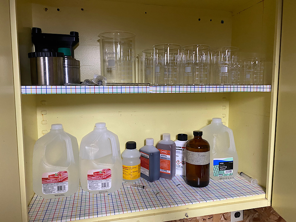

Found a surplus kitchen cabinet that roughly matches my others and now I have a place to store my chemicals.

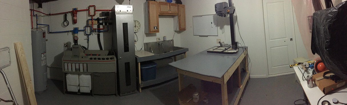

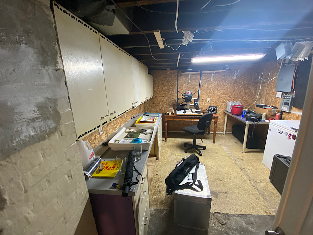

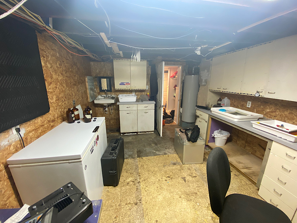

0BD6B2F7-591C-4EFE-87BB-73A0DE0FFCA8.jpeg BA427F90-D9AE-4176-B5FE-5B5F4489CFF6.jpeg D09041DC-773F-4C09-8871-6E22F4598ACA.jpeg 3D463238-414B-4C8E-8A24-62805FCDFAD6.jpeg D3753E59-152A-49A5-AC17-7DCC579F3876.jpeg 97CB97E8-50BC-4AFE-908D-E7A89146694C.jpeg Finally going to post some pictures of my first darkroom. Nothing special but it works for now.

The cabinet space is nice, and was there when I bought the house. I think it was a workshop of some kind for previous owners, and I am guessing those were the old kitchen cabinets. Between those and the sink it was an obvious choice for a darkroom. Give me a few years and it should be a much nicer space to work.

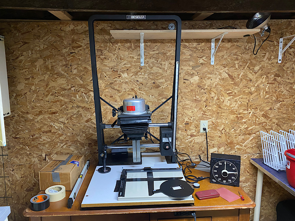

Finally got back to finishing my new space. Have not printed since I broke down my basement darkroom almost a year ago, rebuilt it in the garage. Closed up a small space, very small.... As long as I dont gain weight I should be good. :tongue:
A little bit of cleanup and some safe light testing and Ill be printing by next weekend hopefully.

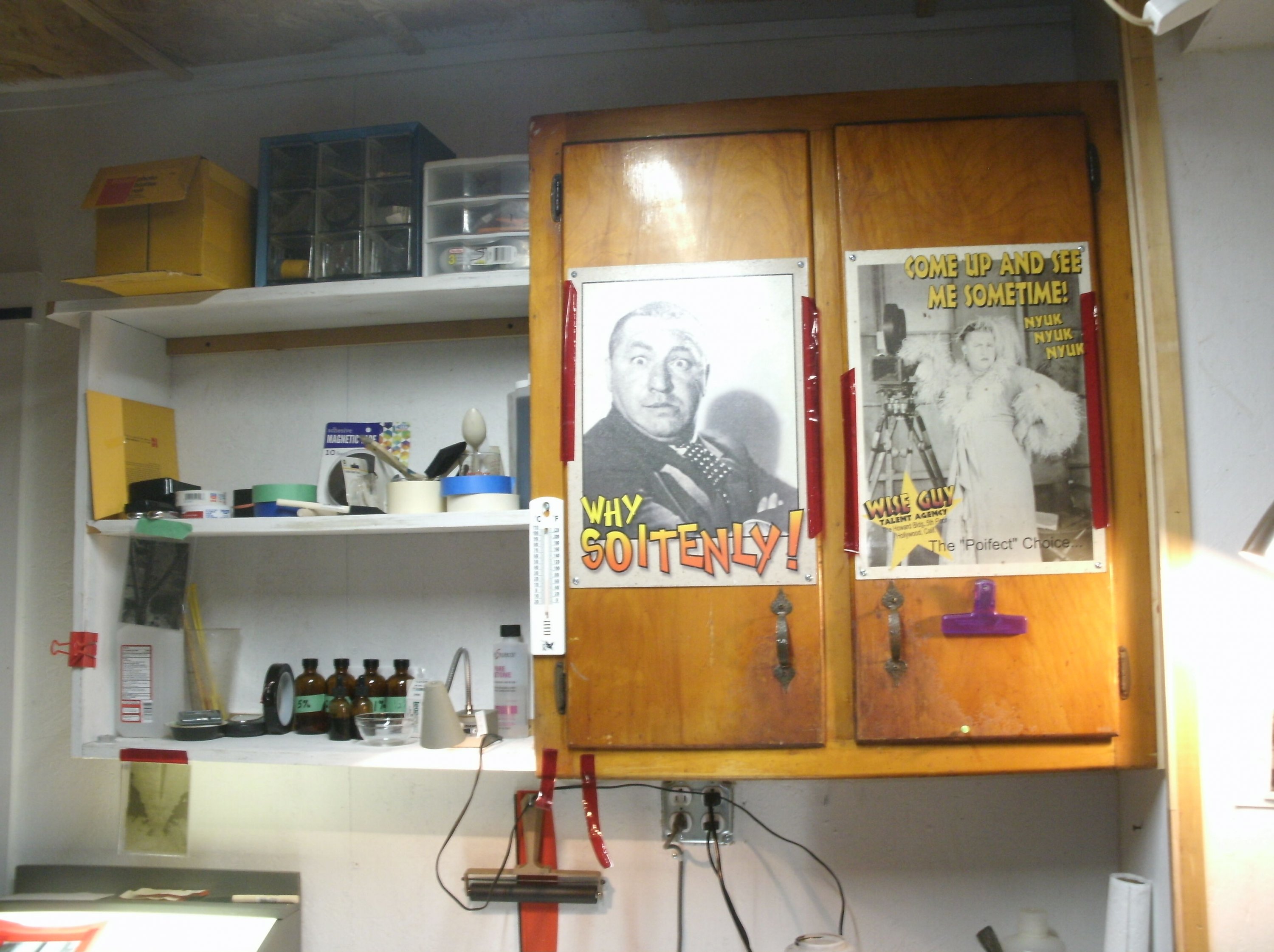

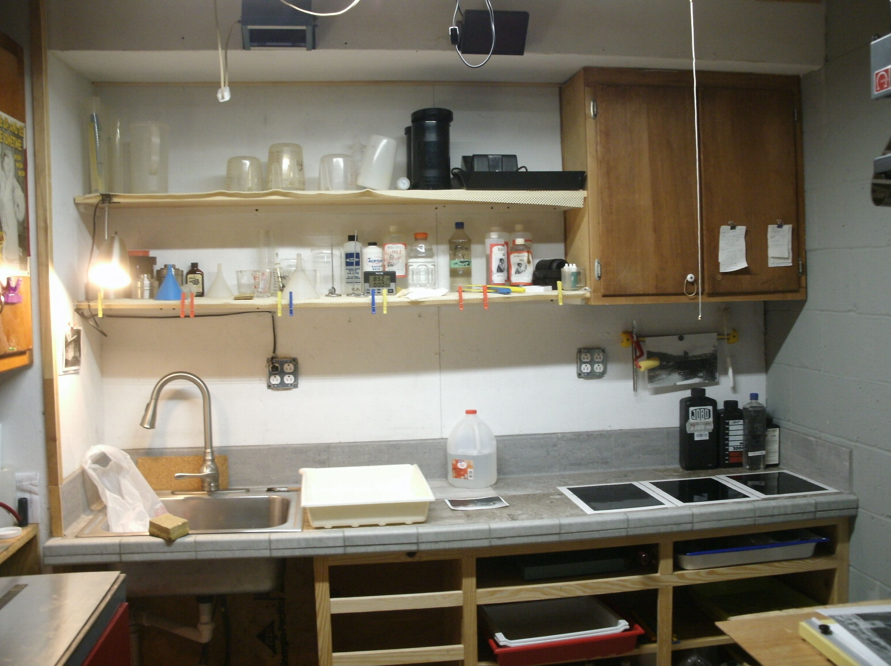

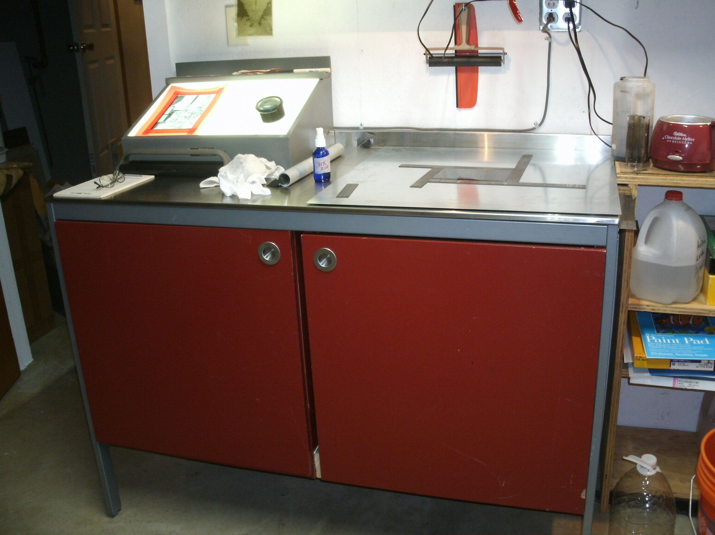

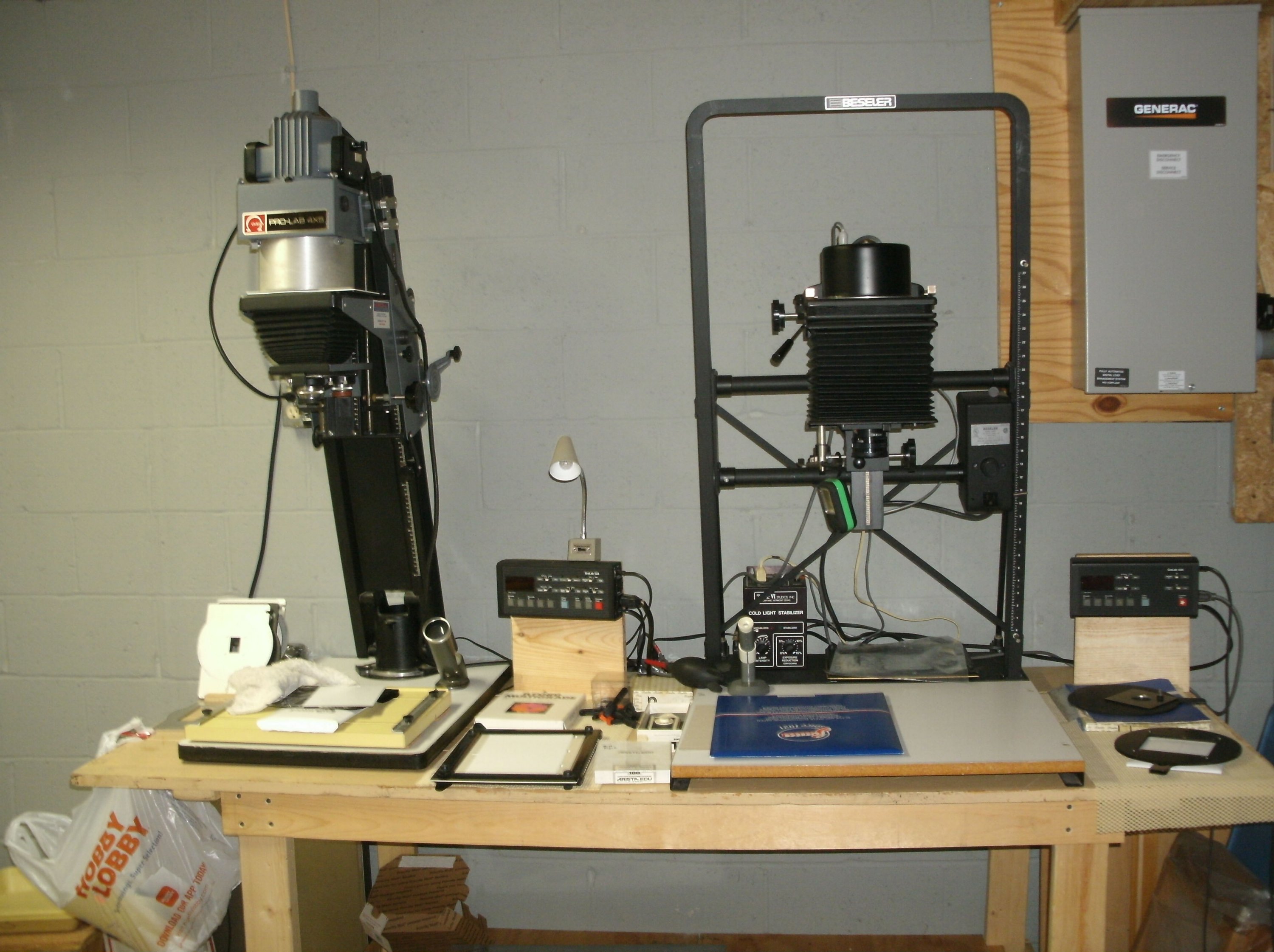

It's a work in progress, functional but far from finished. Most of my work surfaces and cabinets are from the local salvage for cheap and the rest gets built as my health and weather allow. The red cab with stainless top only set me back $20, laminate counter tops $5 each, tiles were ten cents each, and the sink with faucet was $25. Wall cabs set me back $25 for all and I'm making the rest of the base units in the driveway. I still need to run water to the sink.All circuits are on GFCI breakers in the main panel which is in the corner of my DR (to the left of my hot press).

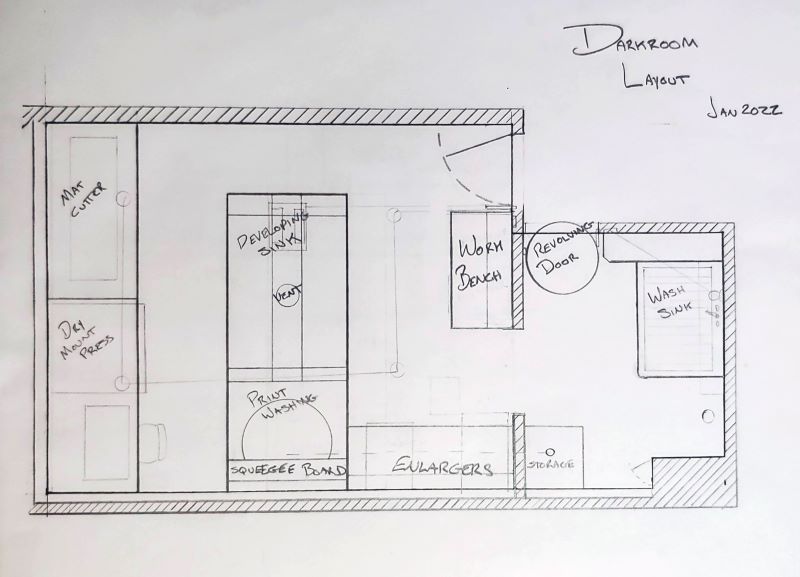

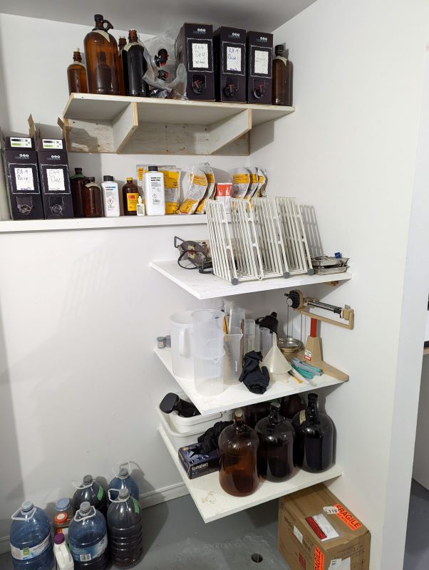

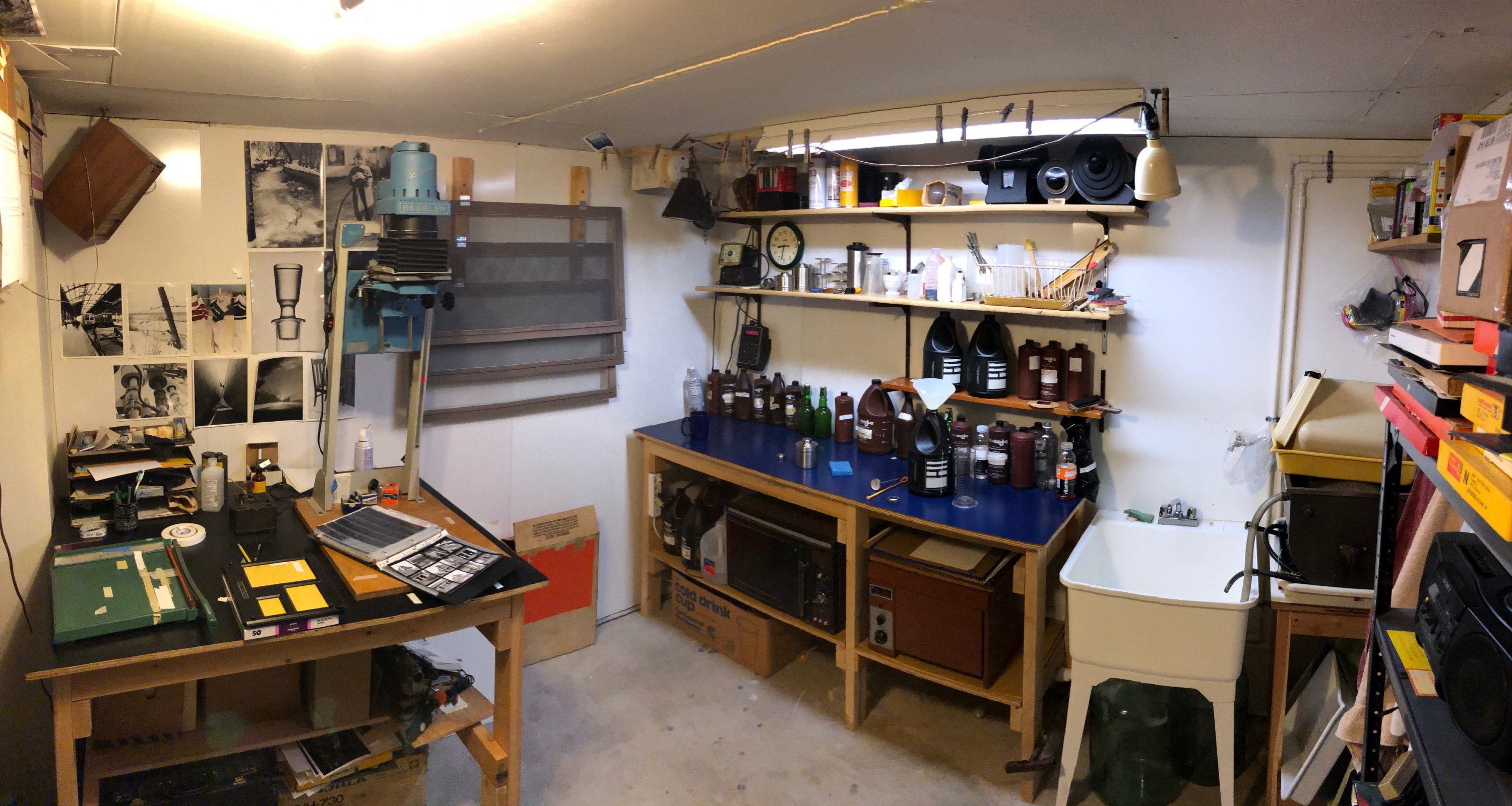

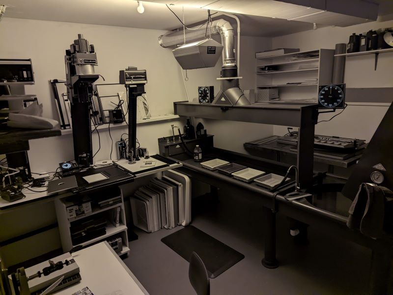

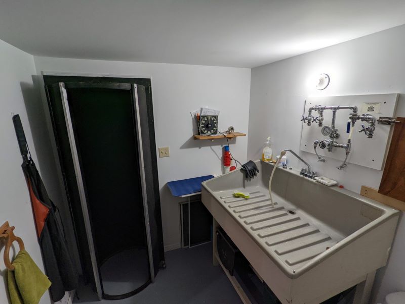

Update of my basement darkroom after the recent reno's. I picked up a cool Sebastien PVC sink from an art school and just had to fit it into my setup.

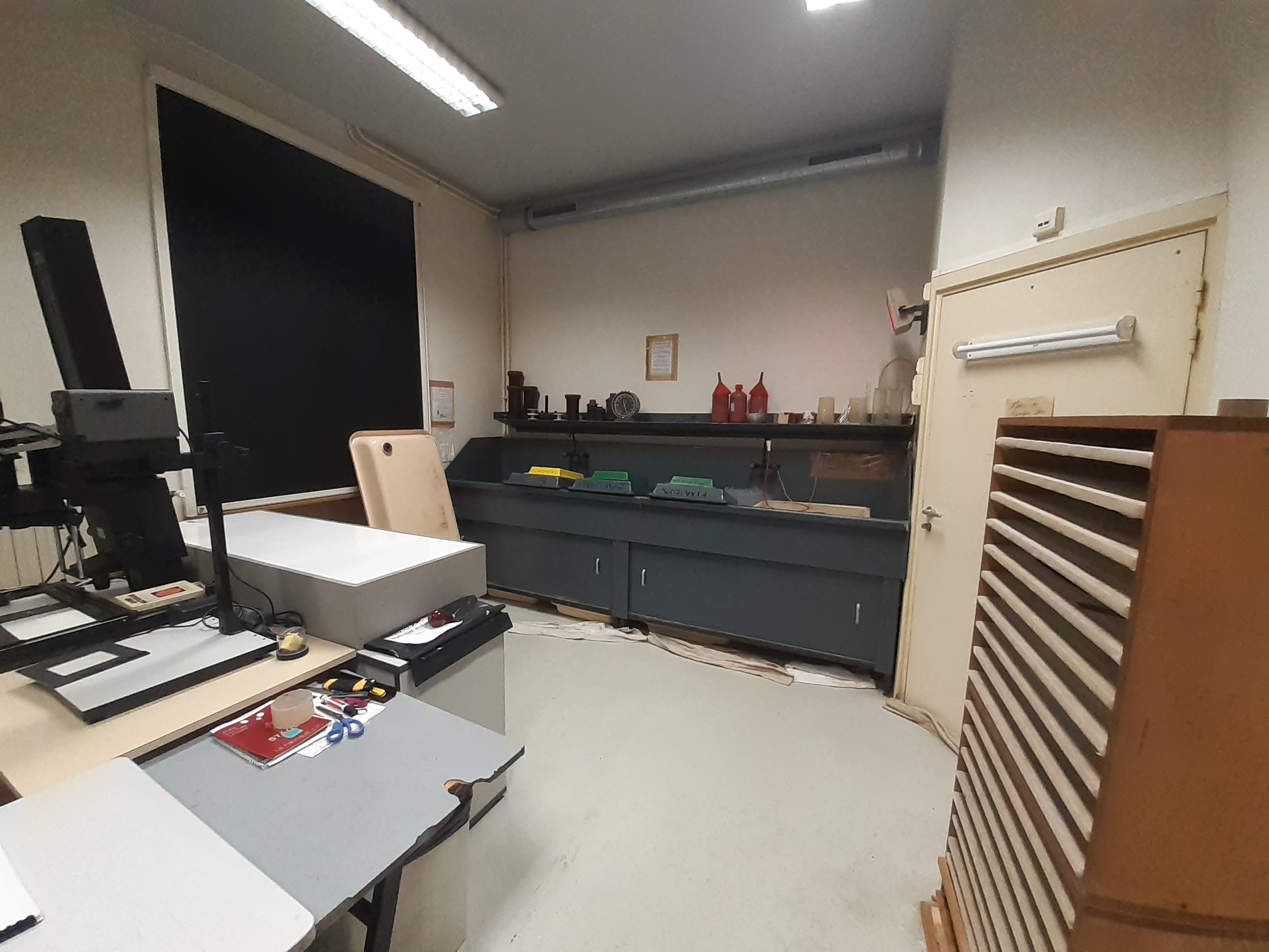

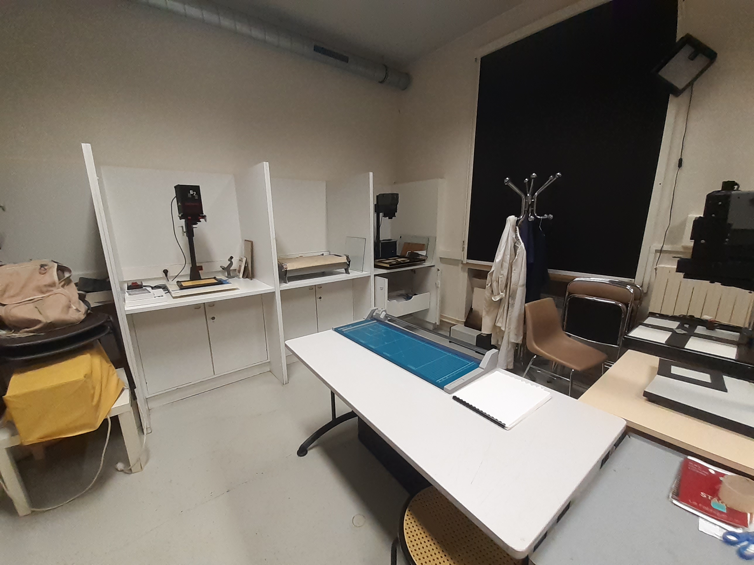

I don't have my own darkroom, but I use a local art school's once a week. As far as a I know there's just one other person who uses it, but I've never crossed paths with him.
Last year, they turned off the hot water to save money. I don't want to even think about what this winter will bring...if you have any suggestions for keeping the chemicals warm (other than body heat...I've done it!), feel free to share!
Presuming the room itself doesn't freeze between sessions, you can pick up a sous vide for as little as about $40 on eBay. Run a tub full of cold water, put your chemical bottles in, and start the sous vide -- go get a cup of coffee or hot cocoa, come back, and your chemicals will be ready to use. It's a compact, fairly lightweight device, smaller than a 2 liter bottle, so easy enough to bring with you or store in a locker if you keep your stuff there.
Where are you located? Does the water run really cold in the winter? I have used an electric kettle to heat up water and then immerse the chemical in beakers (like a bain-marie) to bring them up to 20º. You can do this for film or prints. I will usually use a large metal steam-tray pan for this so I can warm all the solutions to temperature at the same time.
