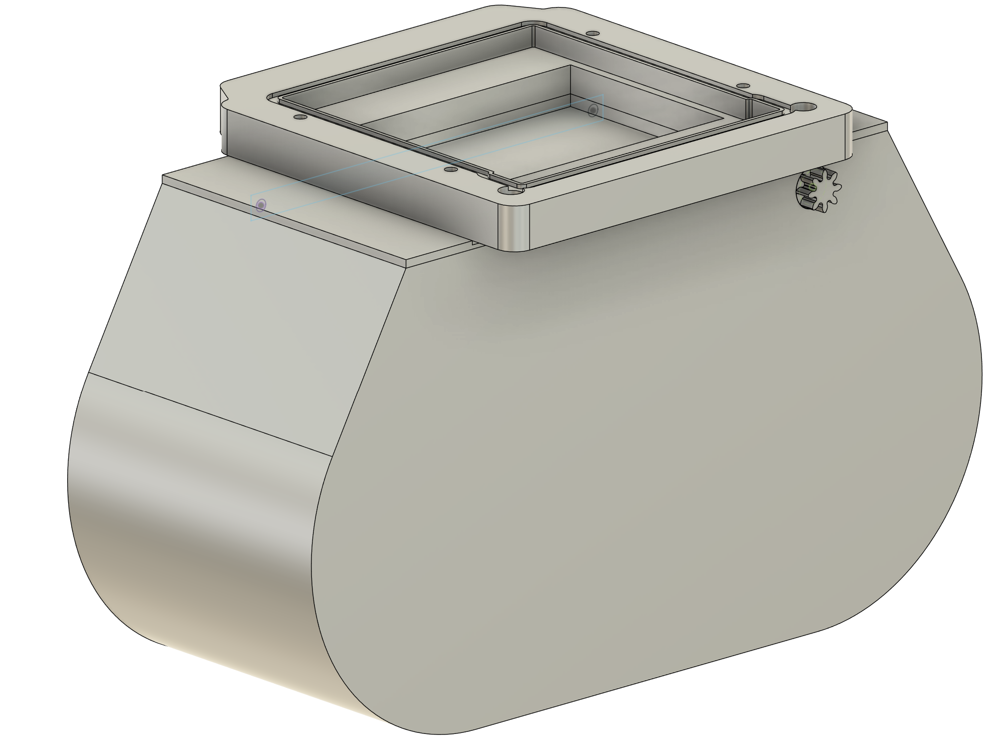

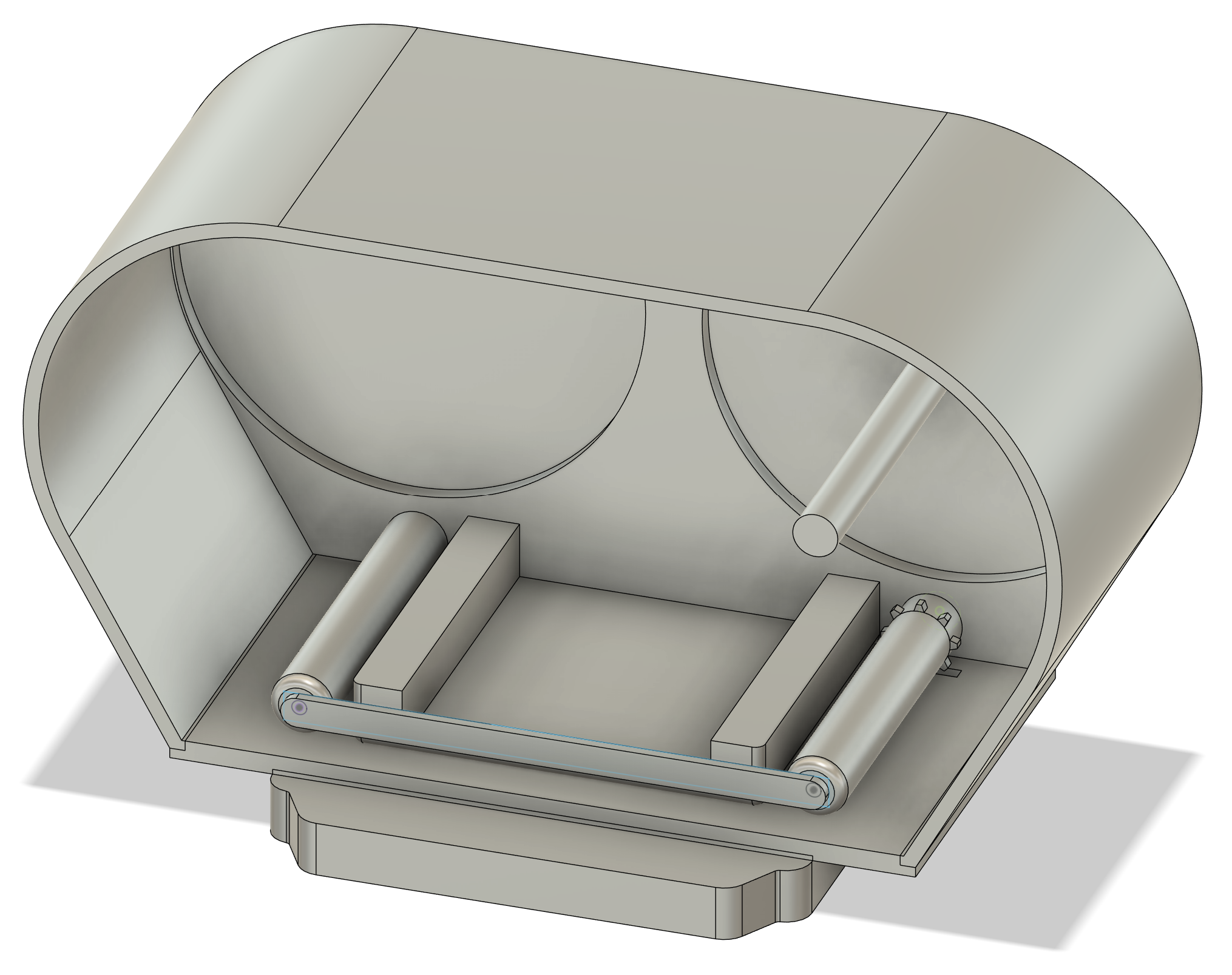

Currently working on a 65mm back for the RB67, it will take 100 ft loads of 65mm film and make approximately 300 51x71mm images on that roll. I am going to see about making an automatic frame advance lockout, but that might end up being too complex for me.
I am also trying to make it compatible with 15 ft cassettes, by way of an adapter, but that may also be rather complex. We’ll see.
