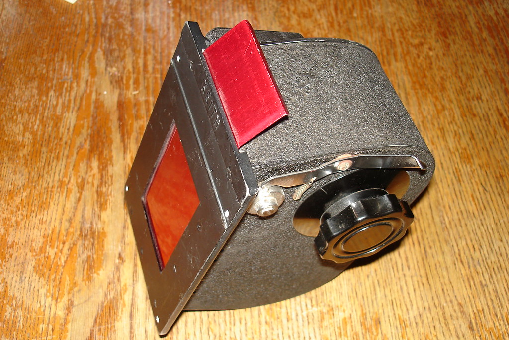

This one I own has a 4x5 Graflok Back on it. I think I paid $35 back then.

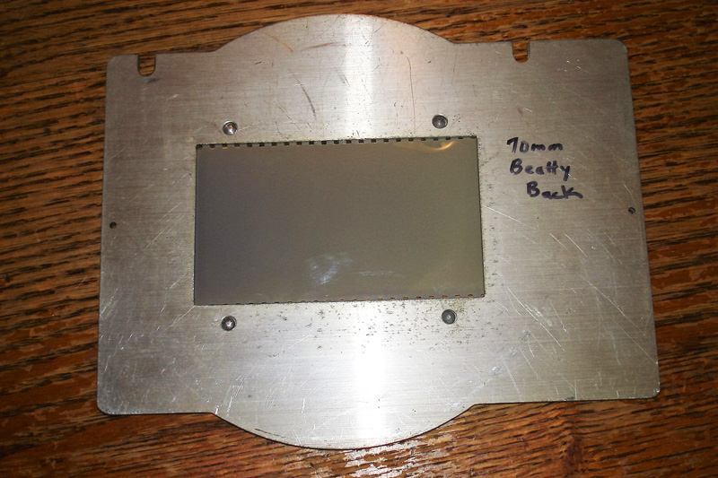

I filed out this Omega 4x5/70mm Carrier to take full frames from my smaller Beatty Coleman. Can see the sprocket holes in the edges of the prints.

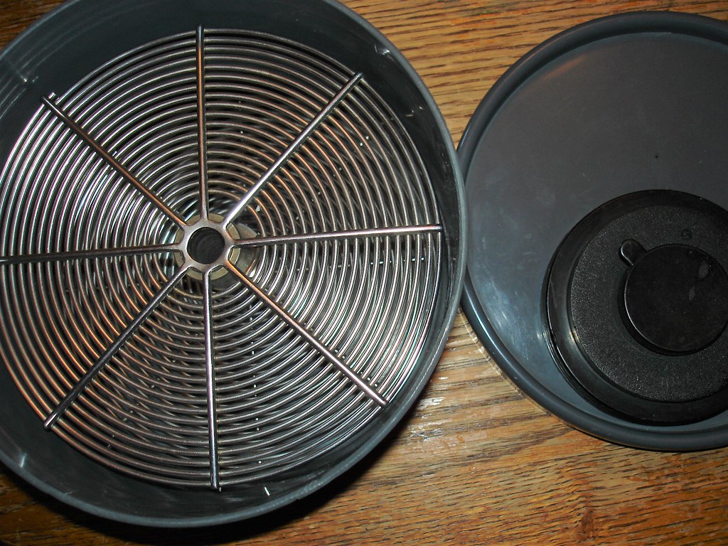

For those of you looking for a 70mm developing reel and accompanying tank:
Wow, AI description spotted. Womp womp.
Also, this doesn’t come with the loader, and it is not going to be possible to load without that… trust me I tried. After about a hour I managed to get maybe 50 ft on there in the light. You will have to build yourself one if you get this.
How were you trying to load film onto this sort of reel? I've seen large crank loaders for this type reel for sale pretty inexpensively from time to time. The loader is bulky but quite lightweight. I have one that I got about 10 years so (with the reel). I don't have the tank though. I ended finding an old Jobo 70mm tank + loader set soon after, so I've not had to mess with loading these big stainless reels, or get into finding a tank. These days I use the crank loader I have to roll film from cans into a bulk loader.
@OrientPoint I do have the loader for it, I think I showed a picture of it earlier in the thread. With that I can load the reel in about 2 minutes. It’s a giant piece of equipment as well though and probably weighs 10 lbs on its own, so it is not light nor small. It’s not like the JOBO loader, which I imagine is what you are thinking of.
I was attempting to load the reel just on a table without the loader to see if it was possible to do, out of curiosity more than anything… it’s really not.
I see your post now. My loader looks like yours. It it large. It is not heavy though. Maybe 3 lbs and seems to be all aluminum. The Jobo loader is plastic and particle board. Feels flimsy, so I'm always concerned I'm going to snap the guide. It works well though (at least until I do manage to break it).

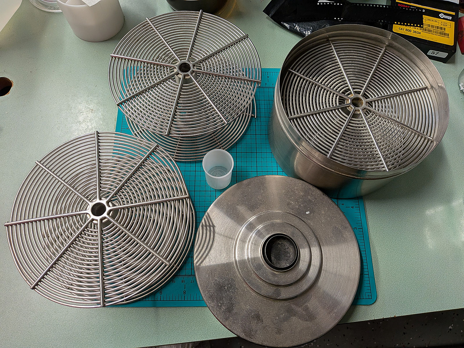

Found me some goodies. Nikor Tank & Reels. Just need to 3d print a cap for the lid.
One reel is a bit worse than the others, but I think it can be salvaged.
If I could just figure out how to get one down to 65mm. But they look pretty solidly built.

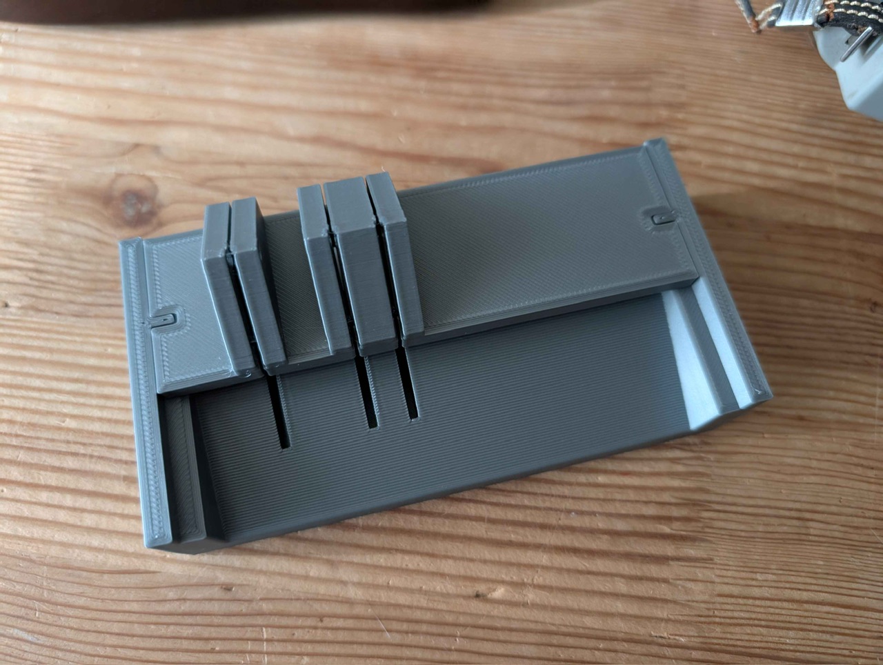

I had a slitter printed for 105mm film, I added a blade for 70mm. Might be a good film to have some fun with.

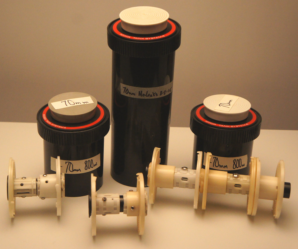

Paterson Olde Tanks Converted to 70mm 24 Exposure Reels No Leaks by Nokton48, on Flickr
I converted these two 120 Paterson Reels, expanding the width, so they will each hold a 24 exposure roll of 70mm film. The large tank holds two rolls of 70mm film, with room for a 35mm roll on top. None of these tanks LEAK. I tested the big one extensively, rolling on a Unicolor Uniroller, and it dosen't drip at all. I've been using these tanks recently again, they are all working really well for me. And I built them from parts I already had around, so repurposed the reels to work easilly with 70mm film.

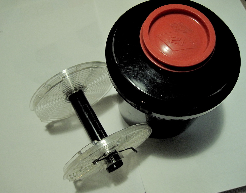

This Nebro reel allows for extra slots to be filed into it's spindle for odd size film. So far I've filed slots for 110, APS, and 70mm. These are in addition to the standard 35mm and 120 slots which are present from new. So this tank is what I've been using to develop 116, 616, and some bulk roll 70mm color film. I established first the liquid level and quantity by filling the tank with water just above the reel and pouring the water out into a measuring beaker to record the milliliters. If you see one of these tanks for sale, grab it.
I didn't know that existed 😳
A member of the forum was selling them for a little while, I think they might be out now, which is unfortunate, otherwise I would snag one more. I’ve shot a little bit of tech pan, and I really like the look.

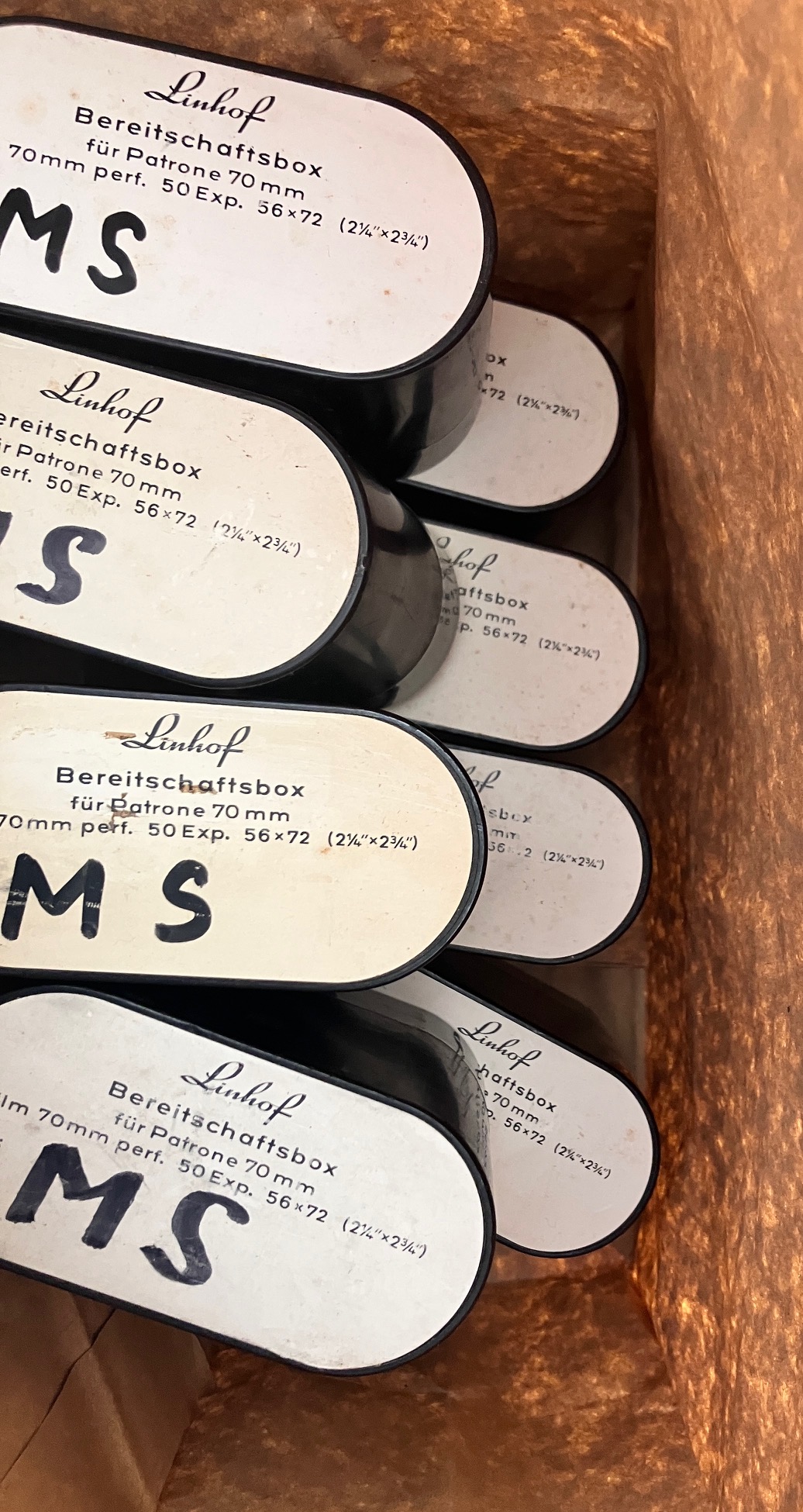

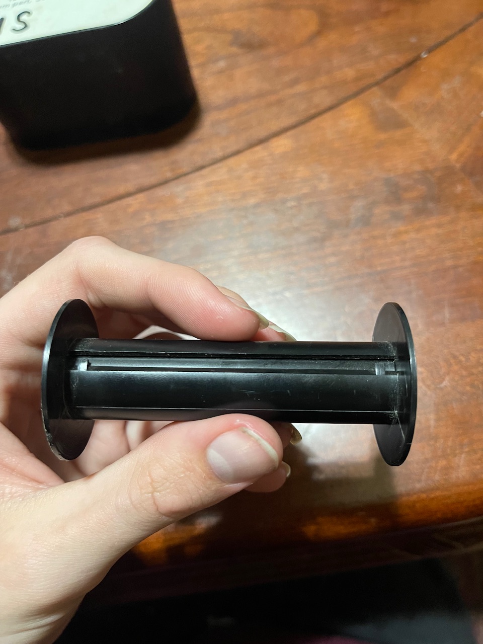

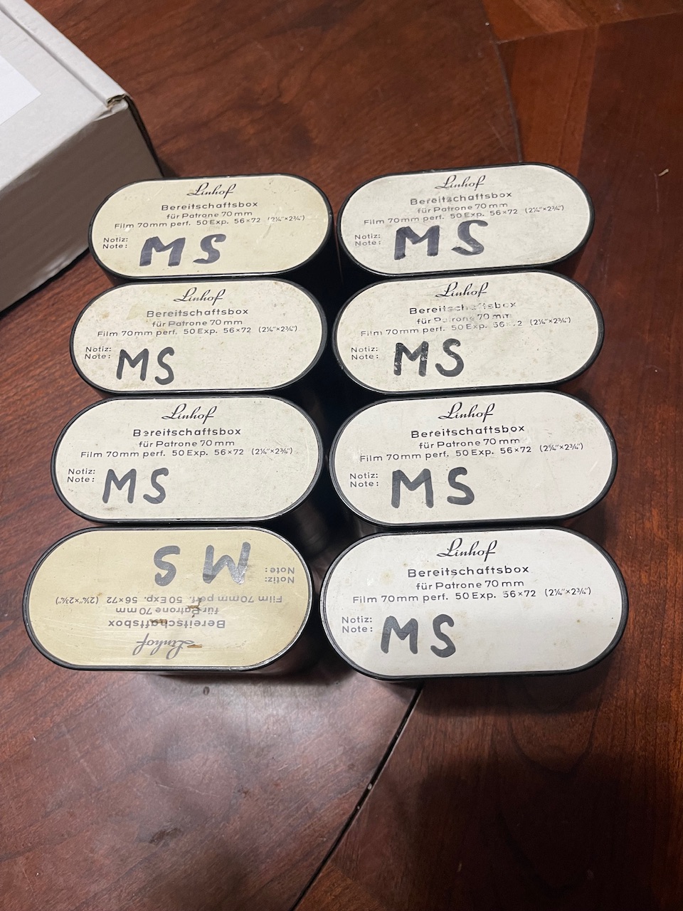

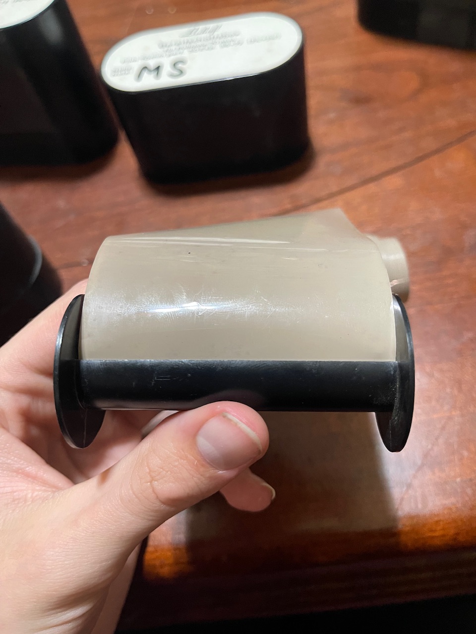

OK, I don’t generally like posting back to back stuff on threads that aren’t mine, but I really wanted to share this because I think it’s neat. I just got the 70 mm cassettes from Italy, and some of the spools inside them are actually very different than any of the 70 mm spools I have seen thus far. Most of them have a spool with a film slot, you simply slide the film into, and no metal clip. Pretty interesting, I don’t think I’ve seen that mentioned anywhere else. That’s actually pretty nice, no need to worry about losing the metal clip.

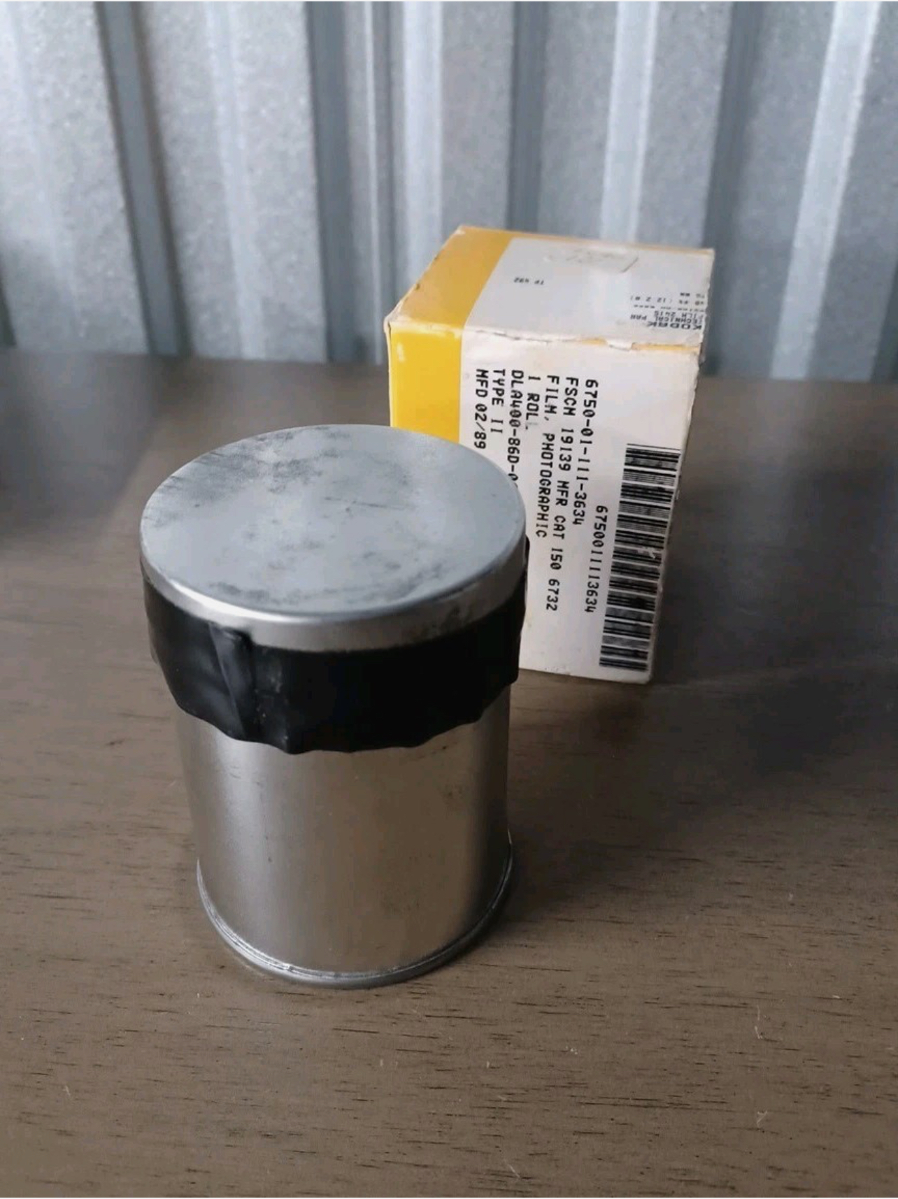

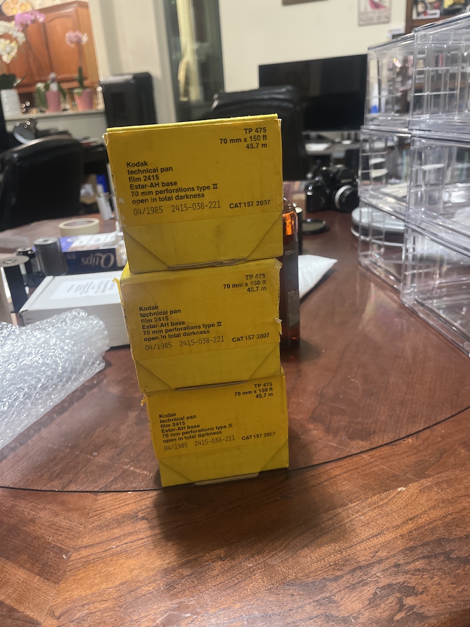

Mail day! After I make some 120 tomorrow I’ll have… still way too much (400 ft), lol. Maybe it could be fun to try and use this film as intended to shoot some astrophotography stuff!
